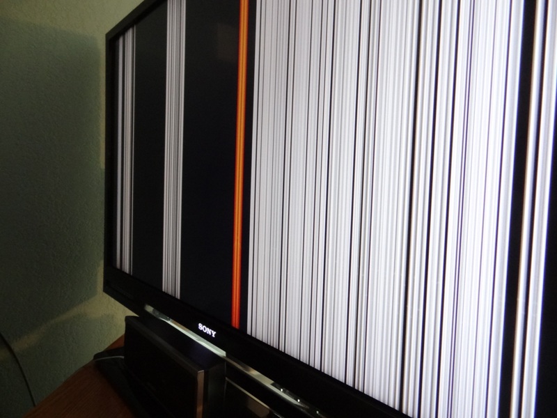

  • cwmcobra
    • Aug 2013
    • 35

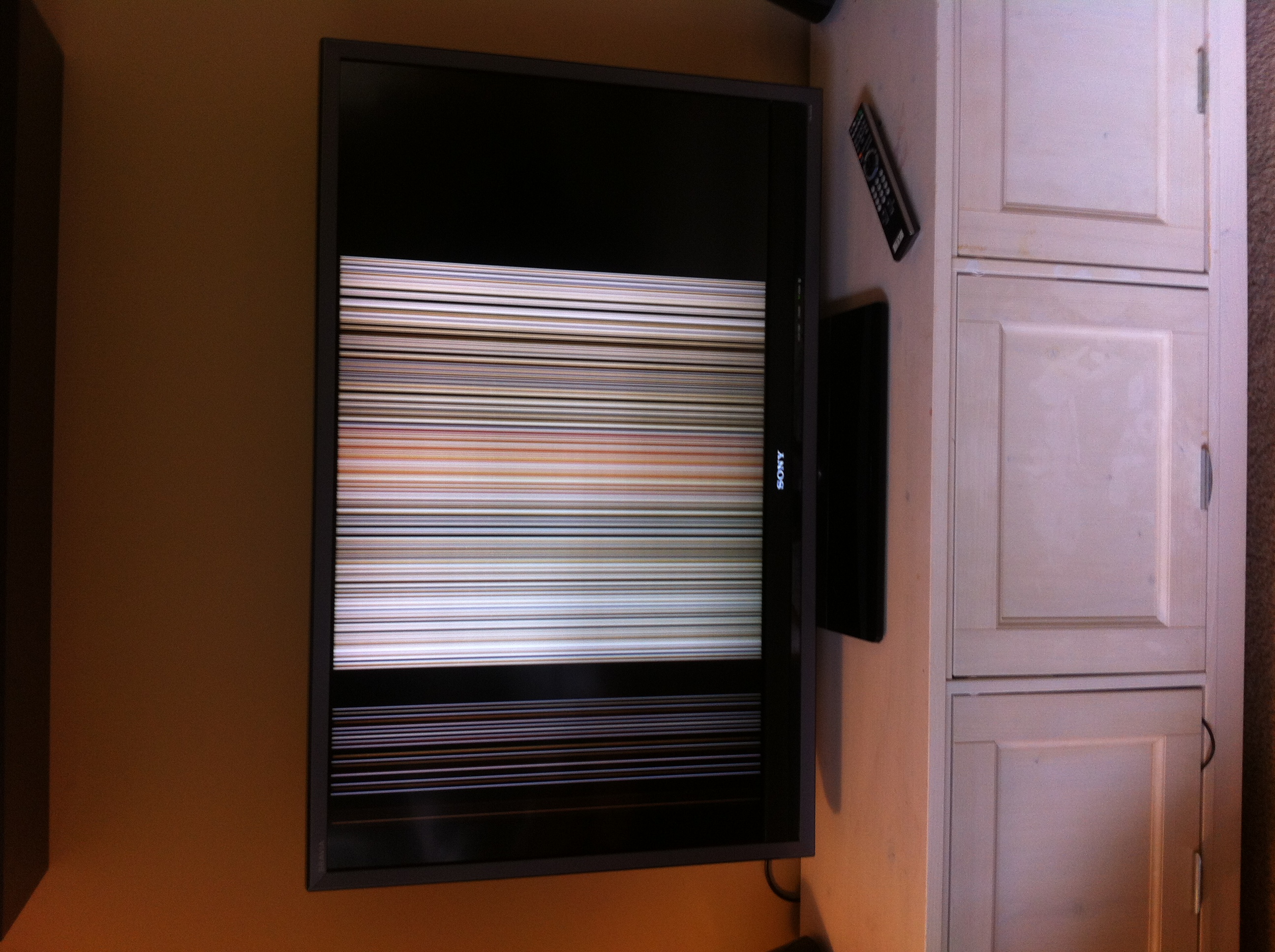

    Sony KDL-46Z4100 another TCON problem?
    My Sony is displaying similar video problems to those I've seen in another recent post here. When I power on, the screen comes up with the black screen with colored vertical lines. Then the screen goes black and comes up with a white background with colored vertical lines. Pictures are attached, including other information about the unit.
    I have reseated the the plugs on the cable from the main board to the TCON and have also reseated the ribbon cables at the top of the TCON. None of that has changed anything, so I suspect the board is bad. Do you agree? If so, I have another dilemma. This board is Sony PN A1564648A and I think I've searched the entire Internet without finding any in stock. How can I find a suitable substitute if this one is no longer available? With all the reported problems, it's hard to believe that they aren't available!
    Thanks for your advice!
    Chuck

    Re: Sony KDL-46Z4100 another TCON problem?
    Unfortunately I think your panel may be bad
      IMO it could be t-con or panel because I've had vertical lines with bad t-con.
          The picture looks like t-con, similiar to mine. This kind of t-con is hard to find.
            Yeah, it looks like a panel problem, but I might try a t-con anyway. The vertical lines would make me want to give it a shot. The t-con for this TV is unusually expensive. From what I can tell, based on your serial number, there isn't a substitute. I know ModusLink PTS rebuilds certain main boards, but they may also be able to rebuild your t-con. Not sure. Since this is a common fault, I'd be looking for a repair service vs. a replacement.

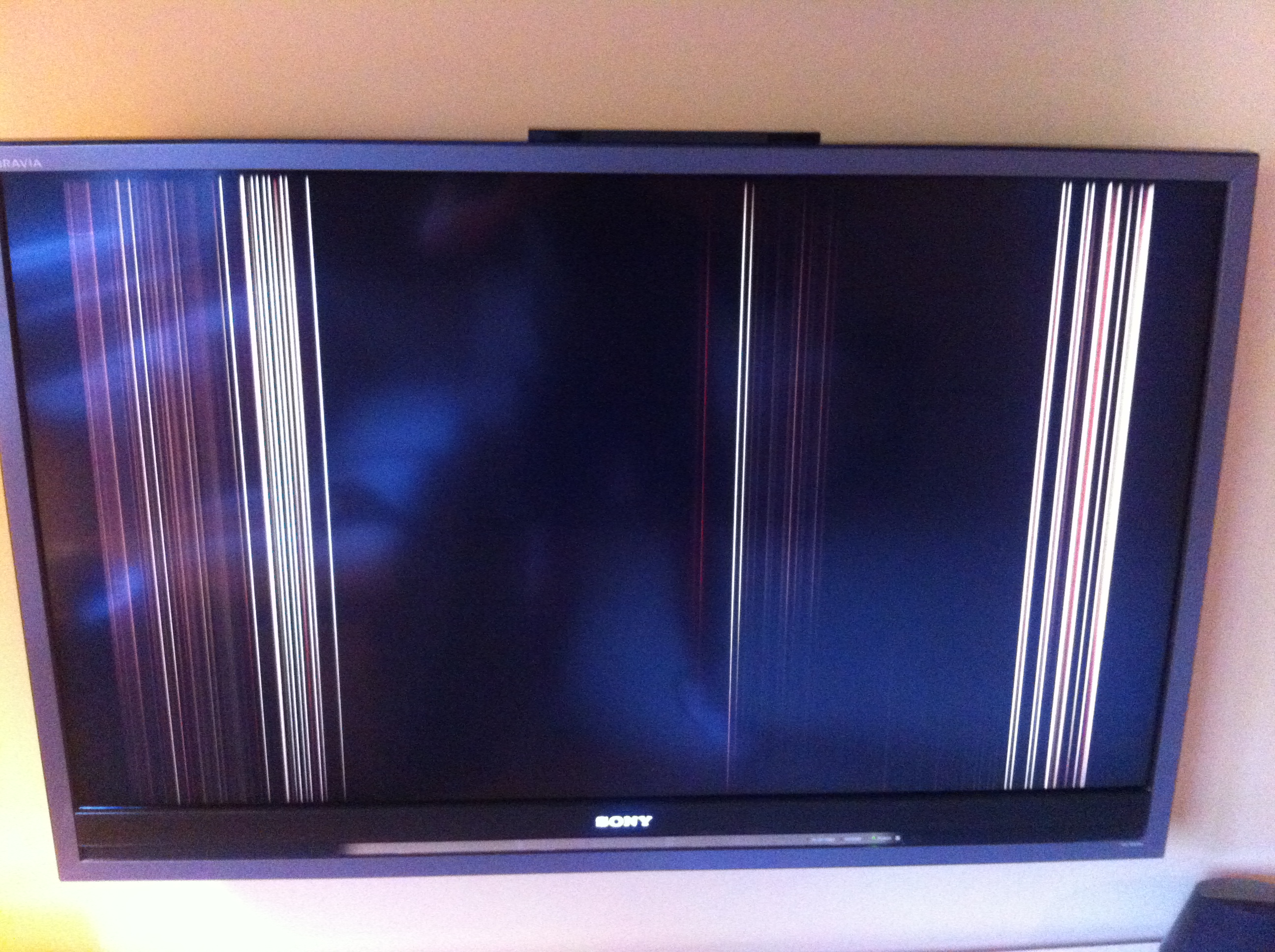

              Seems like there's no good news here. I think I'll buy a cheap new TV and see if I can snag a cheaper T-CON over the coming months. Then if it fixes the Sony, find a new home for one of them. I found a T-CON for $180 and I don't think I want to risk that much when the problem could be the panel.
              Thanks for your help!
              Chuck
              • Th3_uN1Qu3
                Believe in
                • Jul 2010
                • 6031
                • Romania
                If it helps you make a decision, that type of line pattern can't be caused by the panel. When the panel goes it's always thin lines. Also the fact that the horizontal lines disappear (2nd pic) is an indication that it's definitely NOT the panel making them.
                I'd snag a Tcon, even if it's fairly pricey. That's a nice big TV.

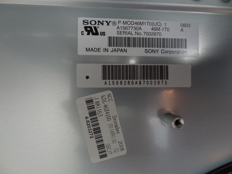

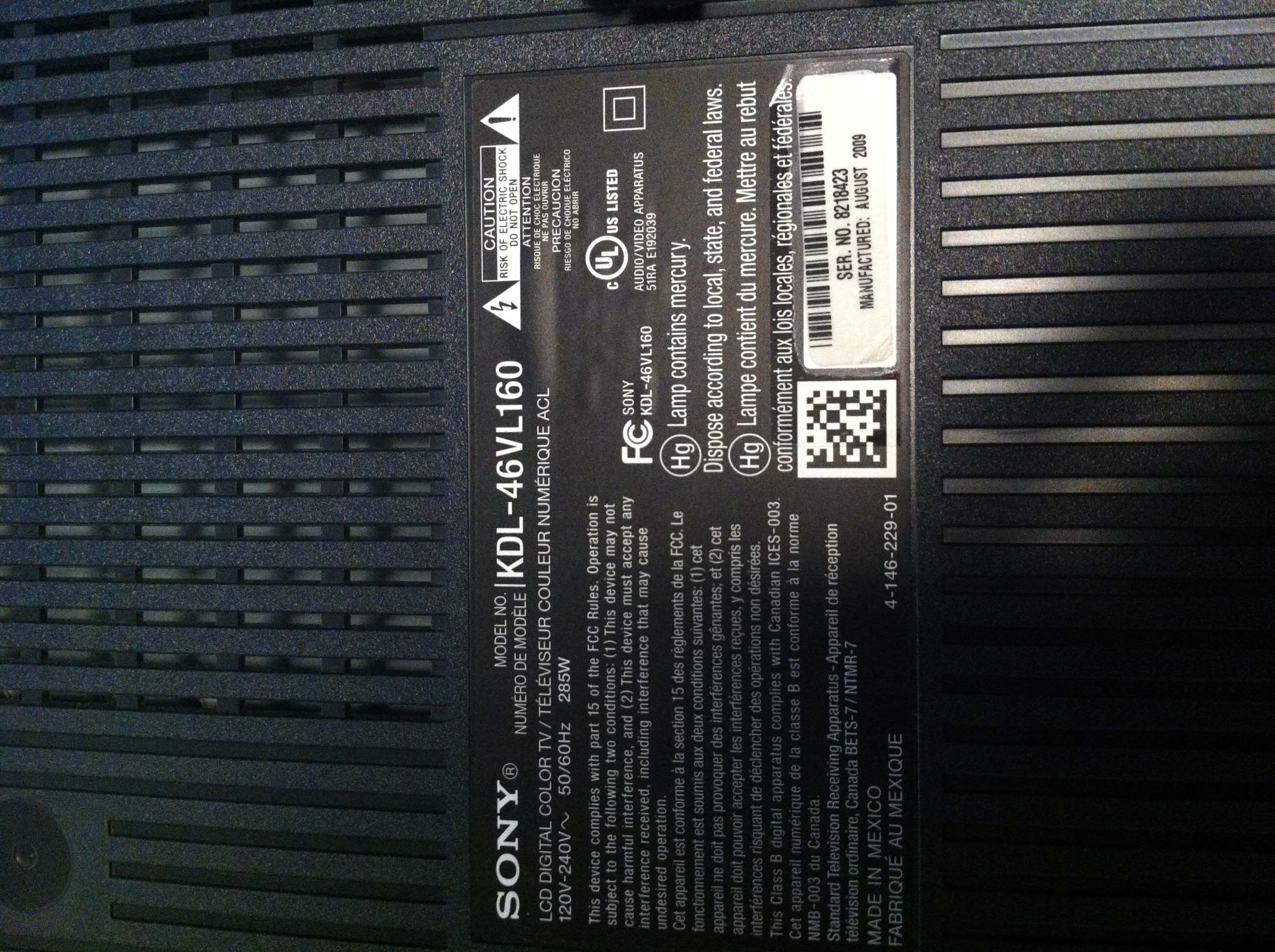

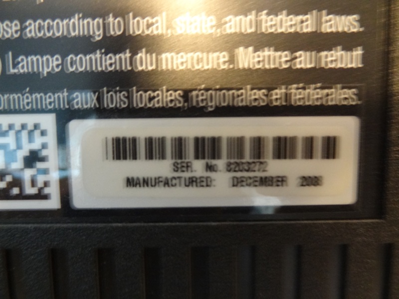

                  • Wtrav8r
                    • Sep 2013
                    • 2
                    • Usa

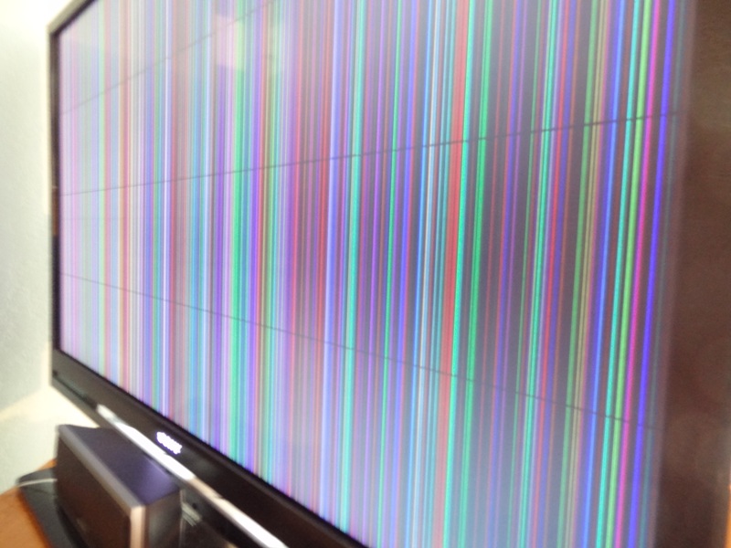

                    Hi Chuck;
                    Thanks for your post, I have almost identical issue with my Sony KDL-46VL160 and it has the same TCON. I can not find a TCON Board either #A1564648A.
                    Any luck with your TV??, any insight would be great. Does anyone have a link to who would make a repair on this TCON if unable to obtain one?
                    My picture did start to freeze for about 5 minutes prior to this occurring, now just multiple vertical colored lines that randomly shift positions. I can not see anything in the back ground.
                    I have uploaded a couple pictures.
                    From what I have read on Badcaps.net I narrowed it down to bad panel (not cost effective to fix) or bad T Con. Any other suggestions from anyone??
                    Rob

                        • truep
                          • Aug 2010
                          • 373
                          I had a Sony 46" with a similar problem, It turned out to be the Main Board.

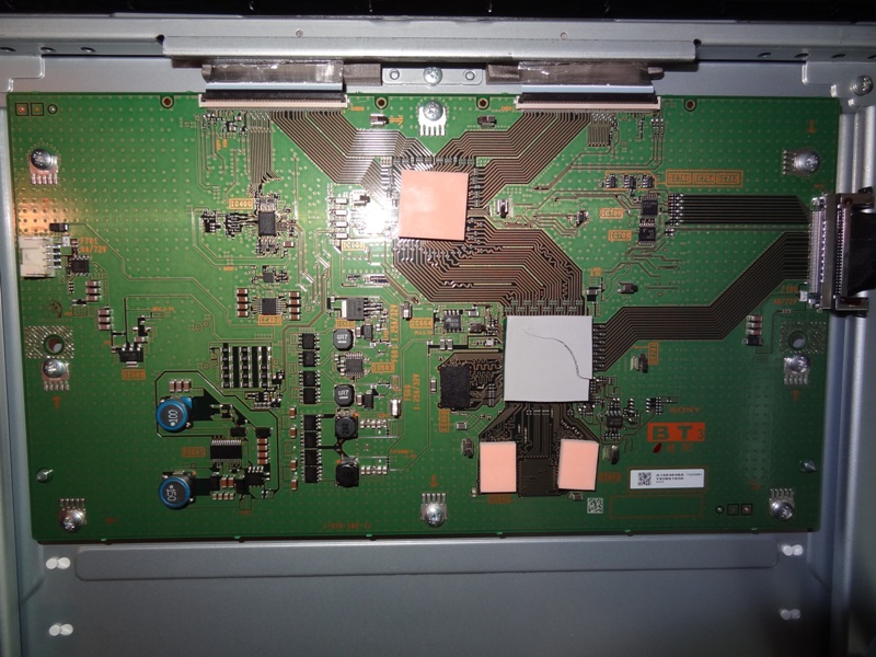

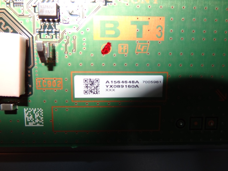

                          • cwmcobra
                            • Aug 2013
                            • 35
                            Progress report: no joy so far!
                            I received the board and carefully installed it. Plugged it in, the set powered on and my first observation is there are no longer any colored vertical bars on the screen. Good news, I thought. BUT, even though I got sound through the speakers from my DTV box, there was no picture. As I was thinking about this, the TV turned itself off and the status light blinked red 14 times repeatedly until I unplugged it. Turned it on again and had the same problem. So, opened it up again and did two things. First, cleaned and reseated the connector on the wire that goes to the main board. Can't get to the actual terminals inside the connector on the board, but worked it into and out of the connector several times hoping to cut through any oxidation that might be preventing contact. I also released the two ribbon cables at the top of the board and did the same. Cleaned all contacts I could get to and reseated the ribbons. Fired it up and continue to have the same problem.
                            I did a quick Internet search and found nothing really conclusive about the cause of the 14 red flashes.
                            So, any advice would be appreciated! Failing good ideas from this group I think I've done all I can to get this thing back in service.
                            Thanks,
                            Chuck
                            • Davheel
                              • Mar 2013
                              • 8
                              According to the Sony Service Manual, 14 times blinking (TCON Error).
                              • cwmcobra
                                • Aug 2013
                                • 35
                                Hmmm......sounds like I got a bad TCON board from China???? Do you think its worth trying another board?
                                Thanks,
                                Chuck
                                  Check the DC voltage on both ends of the T=CON SMD fuse with ref to the chassis ground
                                  • cwmcobra
                                    • Aug 2013
                                    • 35
                                    Thanks Bud. Sorry for the rookie question, but can you tell me where to find that fuse? I don't see any fuses on the T-CON board or on the board with all the inputs and outputs that the TCON is connected to. I have no schematic, etc. :-(
                                    Chuck

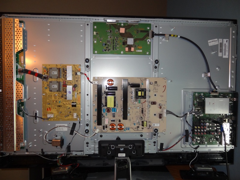

                                      Post a good clear pictures of this replacement T-CON, the fuse should be located close to the LVDS connector (it has the wires that go back to the main board).
                                      Picture in post 1 is not quite clear, it looks like F100, 4A/72V. It also has F701, 4A/72V on the left side of the board. They have white body.
                                      • cwmcobra
                                        • Aug 2013
                                        • 35
                                        Sorry, I'm having trouble uploading the pictures. I'll keep trying....
