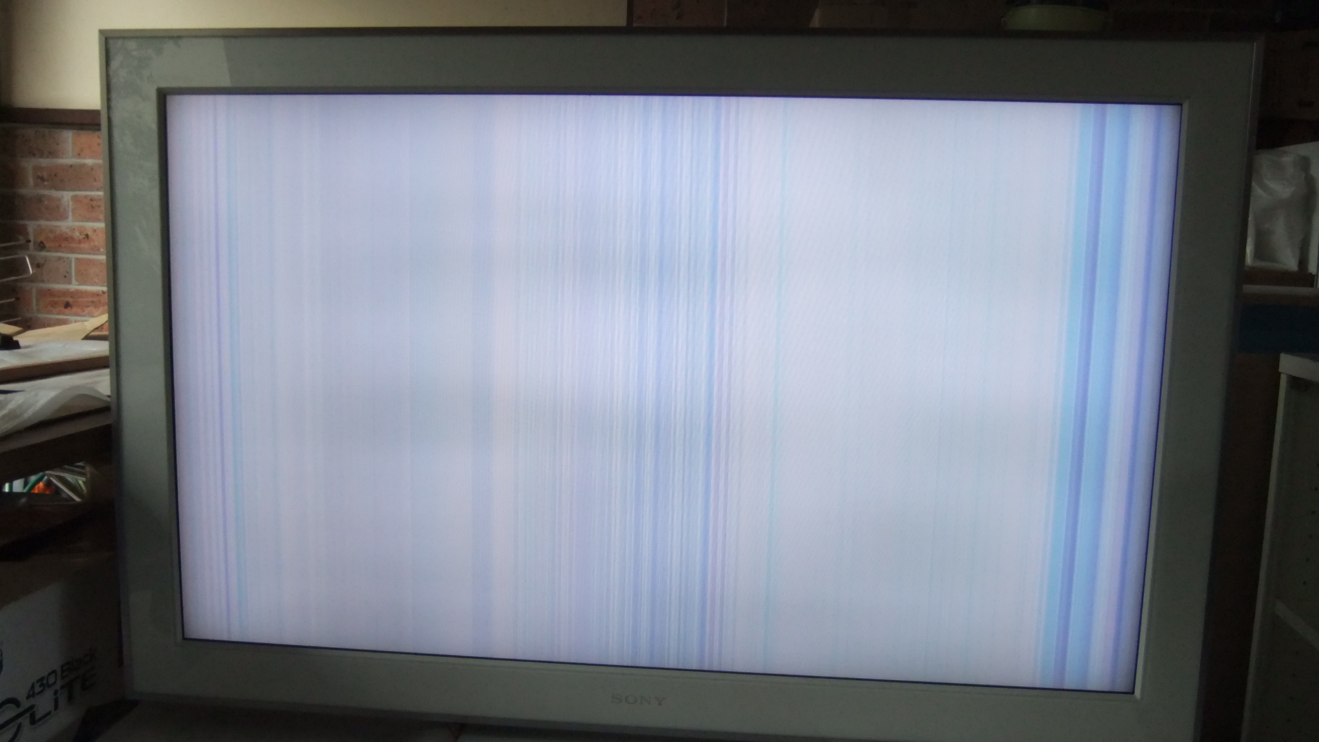

    Hi All
    As is see postings are from 2013, but i thought to give it a shot . I have the same problem with this model Sony KDL 46 Z4100. Vertical colors lines . That's it. Should i look for this chimera of T-CON board ? Just can't afford a new TV now and i'm using a LG 32 inch as a backup...ouch .
    Any feedback is appreciated .
    Thank You
      #42
      Re: Sony KDL-46Z4100 another TCON problem?
      To me, that looks like a bad panel.

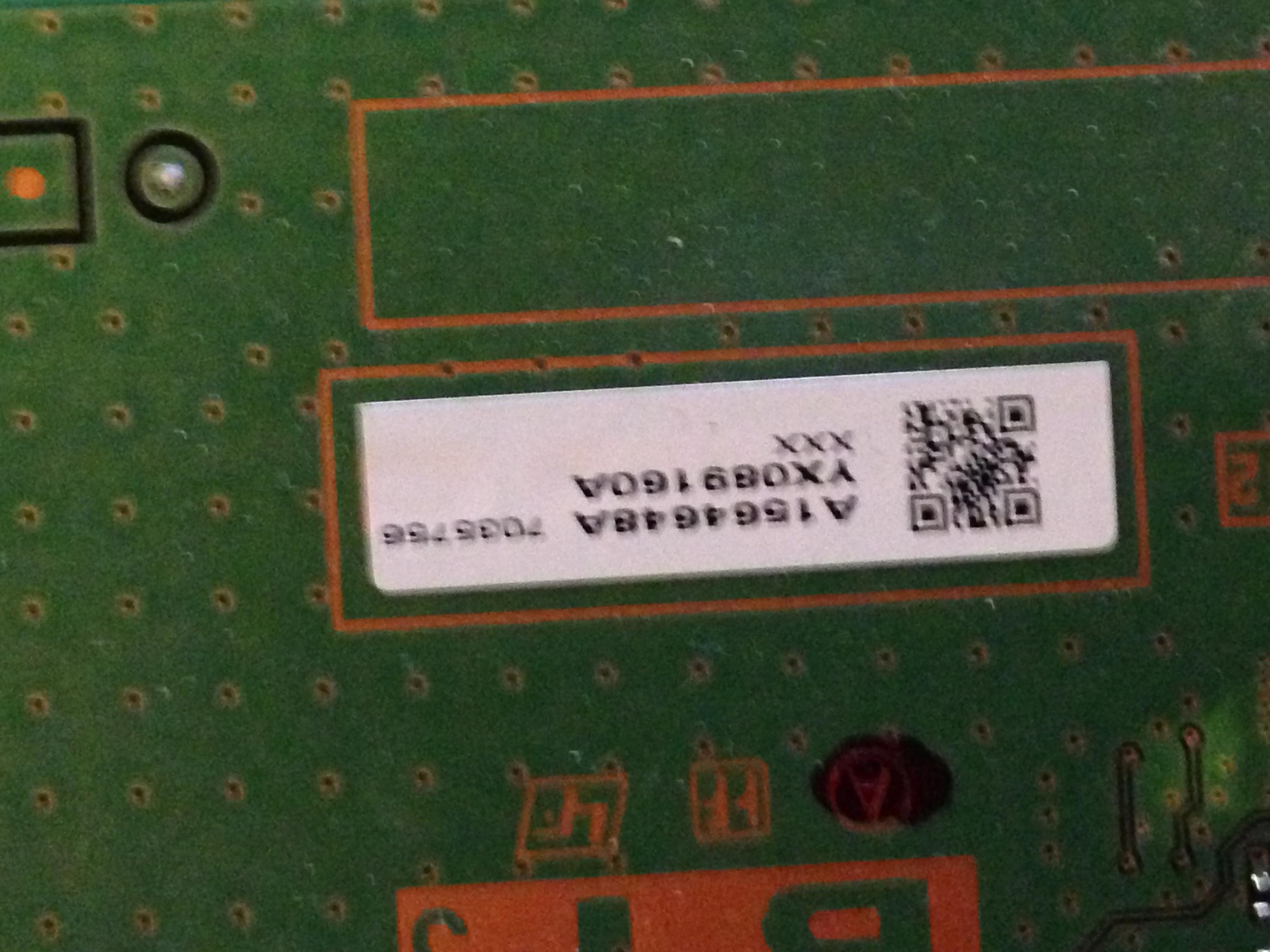

                  KDL-40VL160 also uses A1564648A tcon. If i connect both ribbon connectors, my tv will come on with dark blue screen, then shut off after about 10 secs.
                  If I disconnect one ribbon connector, the tv will come on with half white display and half normal display. This tells me there is a short on the side with the white display.
                  I did resistance checks comparing readings of one ribbon connector to the other. and found a shorted pin on the bad side ribbon connector. When I disconnect the ribbon cable on the bad side and read resistance, the short is on the tcon side and not the panel side of the ribbon cable.
                  I know this is long, but it is one way of isolating one half of the tcon and verifying that the tcon is definitely bad.

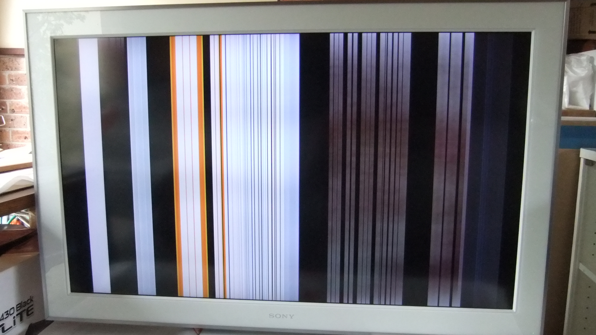

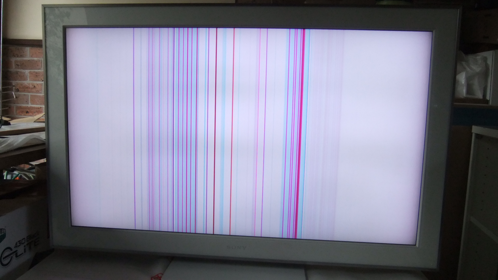

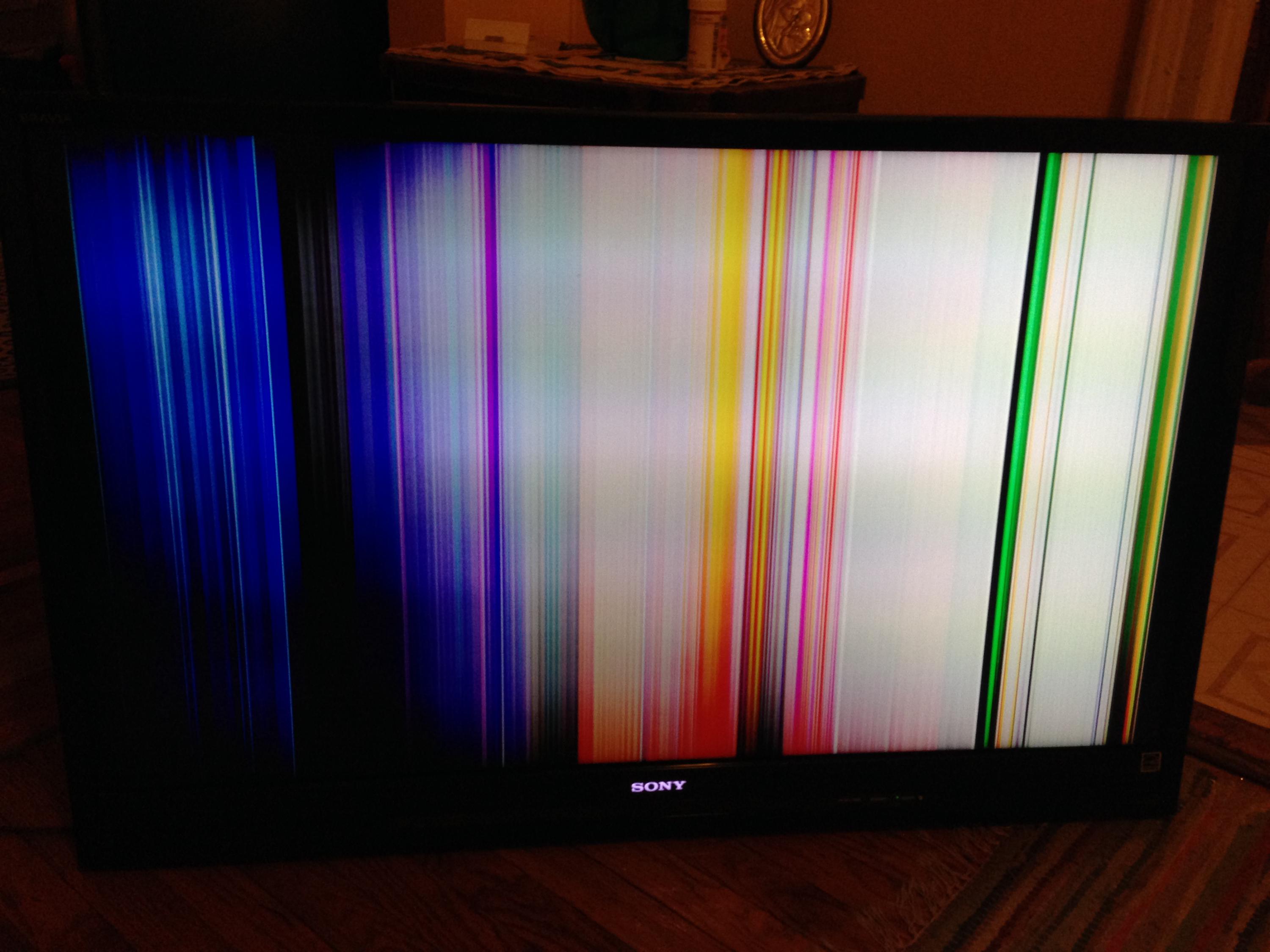

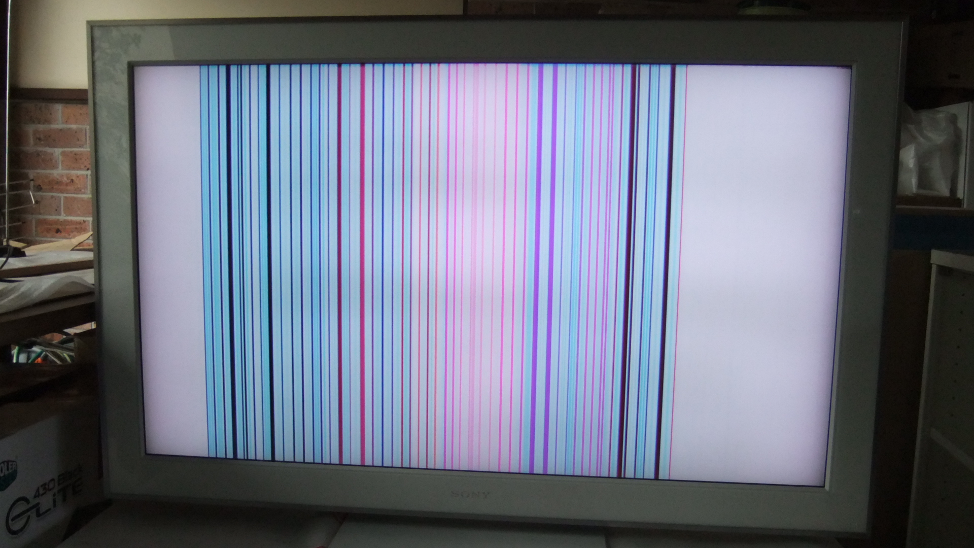

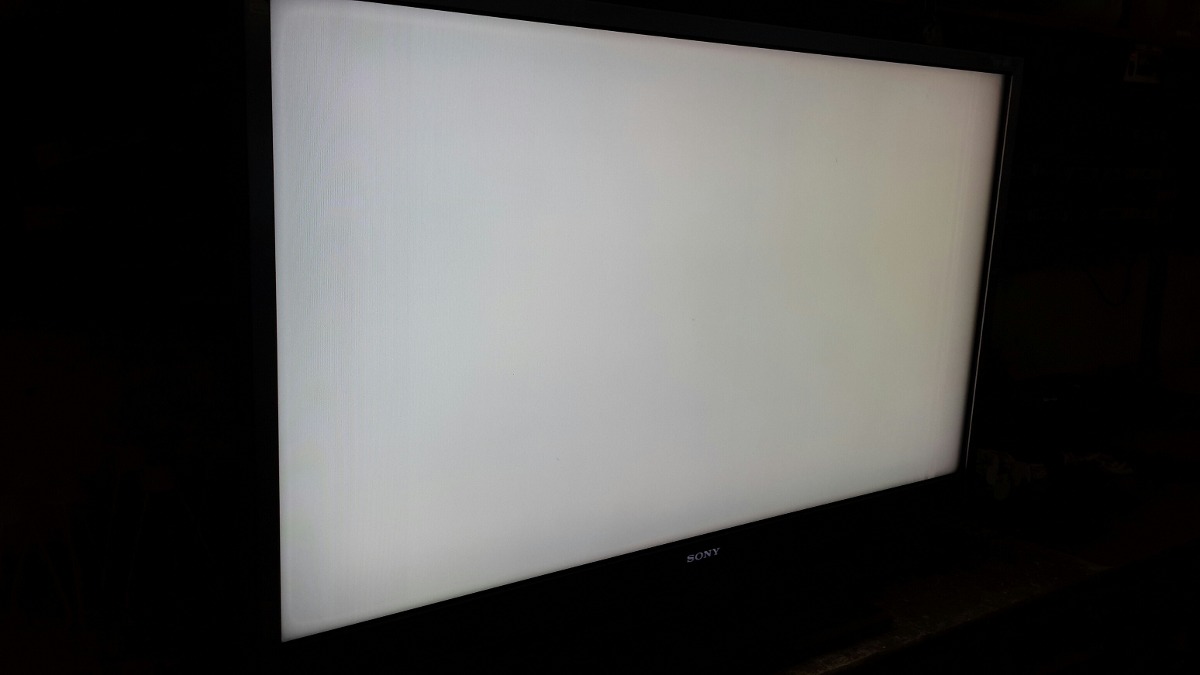

                        Hi, I have attached some images of my TV display, the vertical stripes moves around, does this appears to be a bad panel? Any feedback is appreciated!
                        Thanks.

                                Have already swap T-CON, Main board, cable from Main board to T-CON, so the only thing left is panel, unless someone have other ideas, thanks.

                                  Hey guys, I have this issue with my KDL-46z4100:
                                  When I turn it on the image is white with a strips, and after a minute turns completely white.
                                  Do you think it's a bad TCON? Or a bad panel?

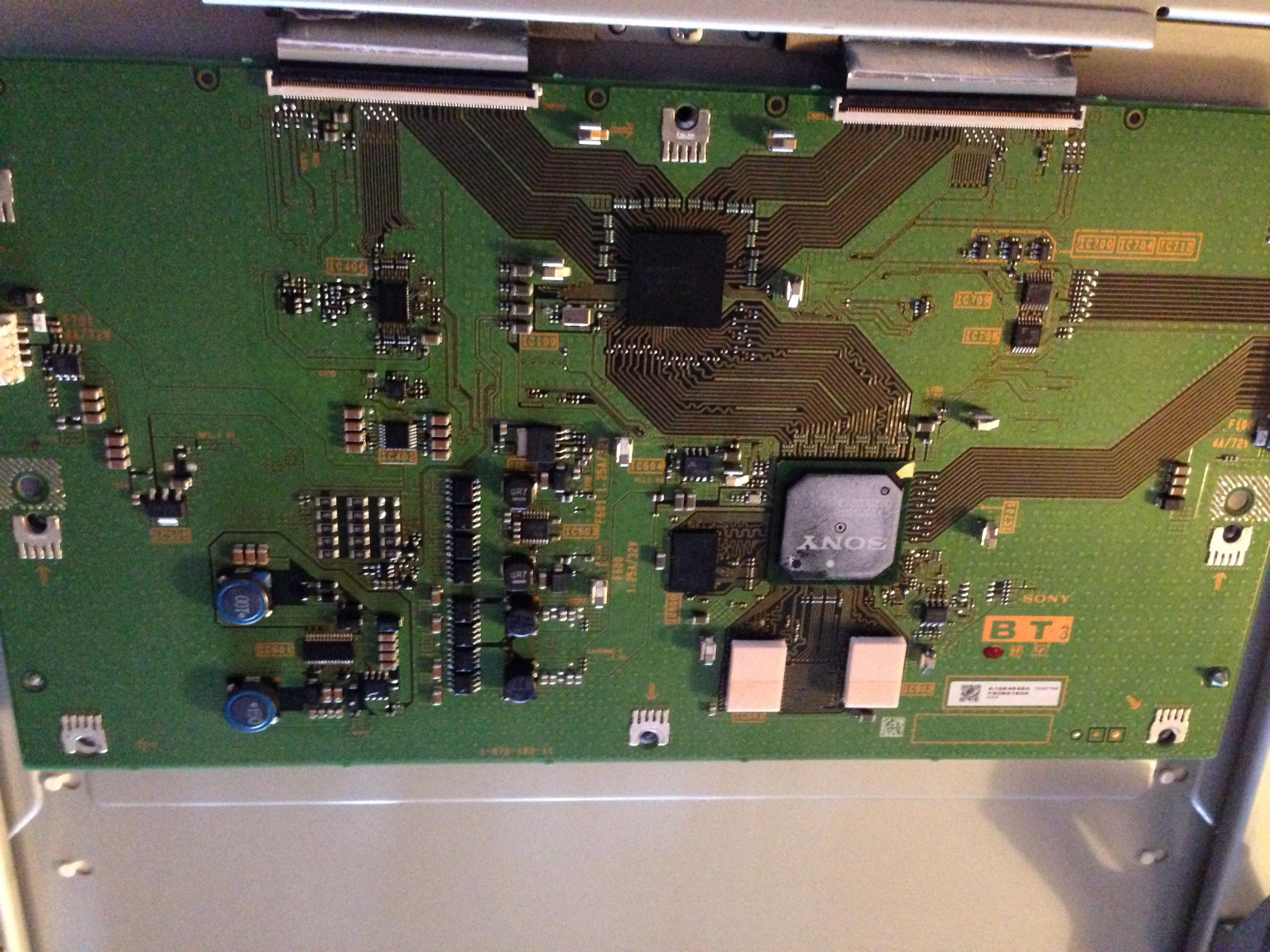

                                        I've dealt with this board a few times now. I have successfully repaired quite a few but they are no walk in the park. On those four dc/dc converter outputs you should be receiving 1.0 volts for the core voltage 3.3 volts 12 volts and 2.2 volts or something to that liking. You can test these at the outputs after each of the 4 black coils. If one DC converter voltage regulator goes bad it will drag down one of the voltages. In order to repair this you need to replace all 8 DC converters including the converter drivers on the opposite side of the board. There will be two of these one for each bank of 4. Along with that replace the 4 diodes. This should get you up and going if you're missing any voltages.
                                        Also noise in one of the stage outputs cause all sorts of problems. Mostly the 1.0v for the cpu and the 3.3v for ddr ram.

                                          Hi, what you mean "opposite side of the board"? Does it mean the bottom side?
                                          What drives those voltage regulators. Thanks.
