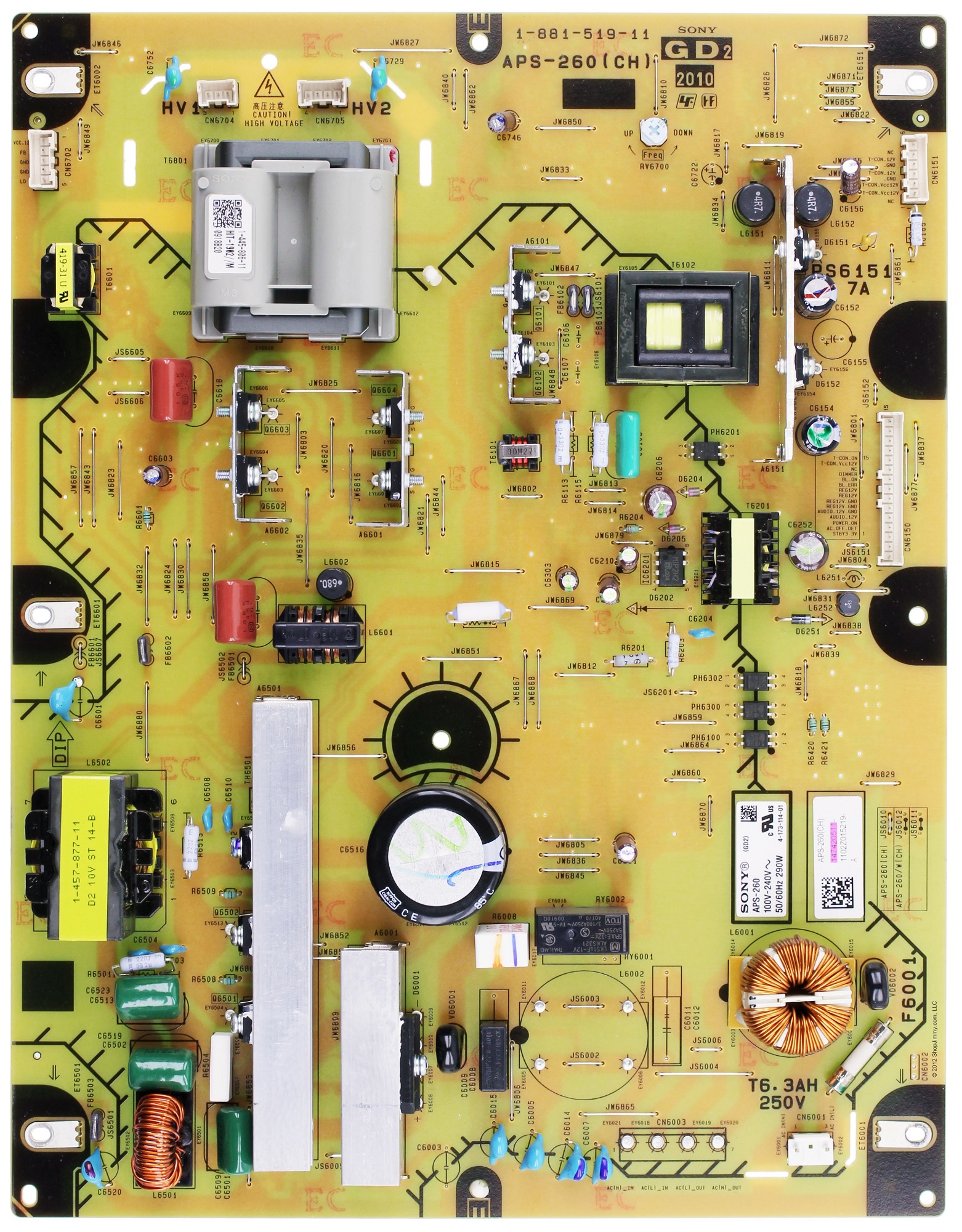

                  This is a shopjimmy picturte. What do you think that would mean 3.3 V at BL_ERROR?
                    Re: Sony KDL-46EX400 2 blink error code
                    I don't know what you mean. My reasoning for my guess is above, but as I said, it's only a guess.

                            I get back again to this TV.
                            Any input would be appreciated. I'm decided that I will have to get to the bottom of this TV.
                            On page 22 on this SM BL_ERROR shows 0V, but that is when the TV in STBY mode?
                            Mainboard sends a 2.7V when I disconnect the wire from the connector. It's not visible when I connect it back to the connector, maybe 0.1V the most.
                            I have placed 3V at the end of the T_Con ON wire and nothing changed. The T_CON 12V turns on with this 3V applied to the T_Con ON wire.
                            Since the mainboard sends the signal to turn on the T_Con, then I'm excluding the mainboard to be the problem here.
                            I'm testing the balancer board right now. Then I will look closely at the PS.
                            Any ideas while I'm at it it would be greatly appreciated.
                            This is an answer to a recently posted idea on the 40EX400 thread.
                            I have tried unplugging the LED/IR LED board. but didn't change a thing. I'm not even sure if it turns on at all completely, without this little board connected. That one maybe works on the 40" size EX400. I can hear the relay clicking on and then off though, but I can't see the code, this way.
                            There is mentioned that the AU12V if it's to high, can trip this error. I'm measuring 12.73V there, that would be to high?

                                  Just the other SONY LCD (other training manual, remember the other SONY we worked on that has bad master inverter board that we spent so much time narrow down to master inverter), the BL_ERROR is the inverted signal of the LD, the LD SIGNAL from Balancer board is fed into the inverter board which has invert Logic circuit that converts the LD HI to LO and that is fed to the main board. if the fault detected by the balancer, the LD will go LO which is then inevrted to HI and that will trigger the ERROR CODE for BL_ERROR.
                                  "So BL_ERR and BL_ON are just used as triggers of the lamps and not necessarily to indicate real errors." That is not correct statement, BL_ERROR is not used to trigger the lamp, it is a generated signal of the failed lamp to tell the main board that some thing is wrong with the lamps. BL_ON is used to turn on the inverter circuit to generated the HIGH voltage to light up the lamps, if the inverter circuit fail to generate the high voltage, then the INVR_ERROR signal will be generated and sent to the main board and generate the INVR_ERROR CODE.
                                  So the bottom line is BL_ERR should be LO in normal operation, HI = BAD (LD is LO, normal LD is around 12VDC).

                                    In that training manual, for the BL_error it shows 0V and I have over 3V there.
                                      3V in standby or when TV is power up, but at this point you will have to fix the 2X code first which has nothing to do with BL_ERROR.
                                        OK, on page 23, you can see 15V Zenner diode that is used for the excessive 12V power supply output detector, if the 12V line goes to 15V, the Zener will be bias on which is then fed to the Latching circuit, same for the 24V power supply which uses 30V Zener for detction.
                                        So 12.73V is not excessive voltage to bias on that 15V Zener.
                                        Excessive PFC and excessive PFC temperature can also trigger 2X code, page 18.
