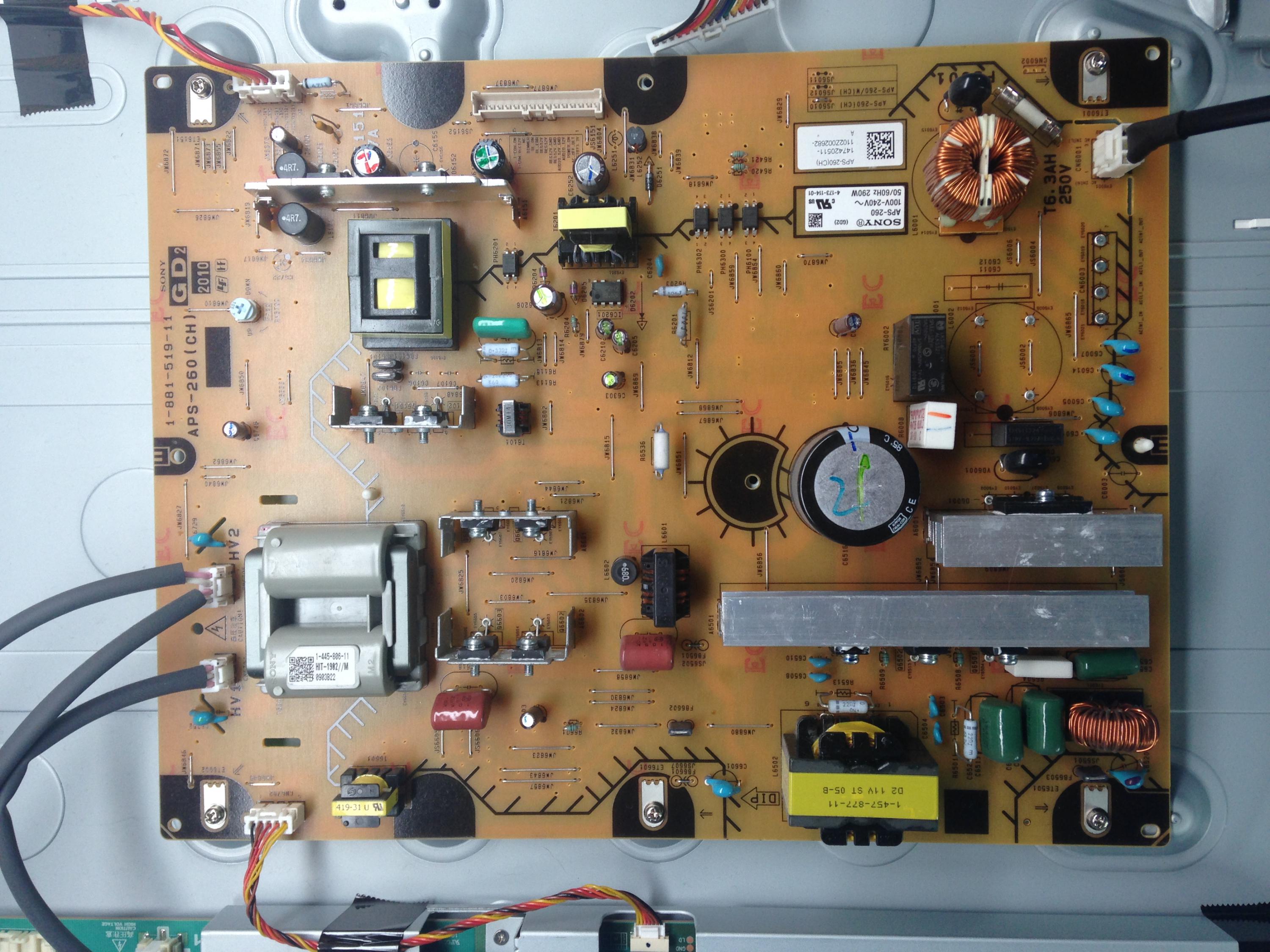

                                Check BAL board on up side behind cooling frame, Fuse F3703 smd 3,15 A blowed.
                                When it`s defective check also the little capacitor between fuse and ground. Most of the time is shorted. Removing the capacitor and replace the fuse and the TV is back working.
                                See picture:
                                I hope this will work. Also when the TV is not give any error but the green led is working check the same positions.
                                Greetings Patrick www.mofix.nl
