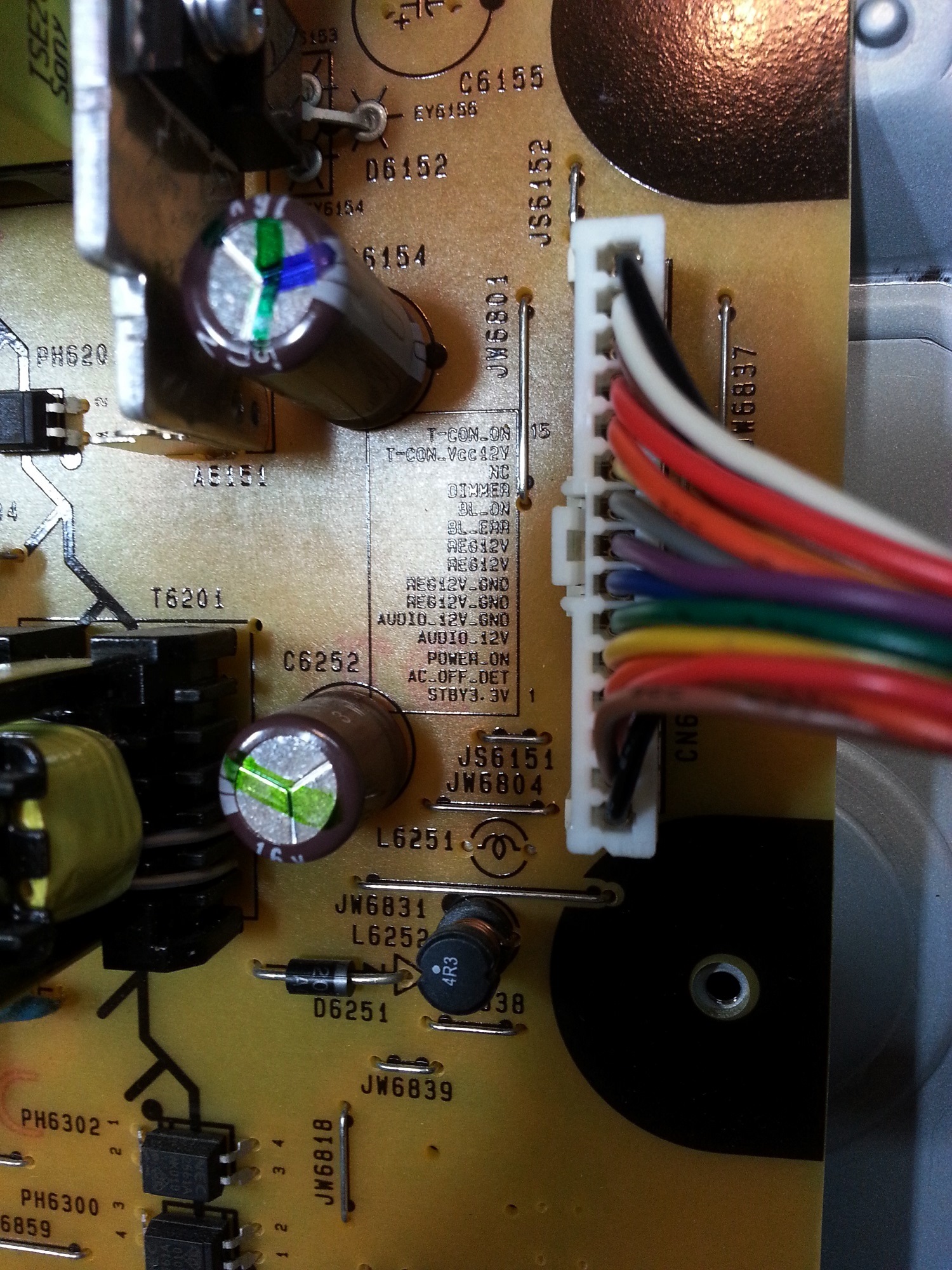

    It seems that It has a BL_Error code, constant 3.3V while it is plugged in.
    It doesn't have any voltage at T_con on or T_con 12V.
    Here are the voltages that I'm getting:
    T_Con_on= 0V
    T_Con_Vcc12V= 0V
    Dimmer= 0.02V off and 2.95V on
    BL_On= 0.01V off and jumps to 0.43V then goes to 0V when on
    BL_Error= 3.333V on and off
    Reg 12V= 0 off and 12.72V on
    Audio 12V= 0V off and 12.73V on
    Pwr On= 0V off and 3.3V on
    AC_Off_Det= 2.78V off and 2.78V on
    STBY 3.3V= 3.3V both ways
    Inverter connector
    Vcc_12V= 12.67 on and 0V off
    FB= 0V on and off
    LO= 12.03V on and 0V off

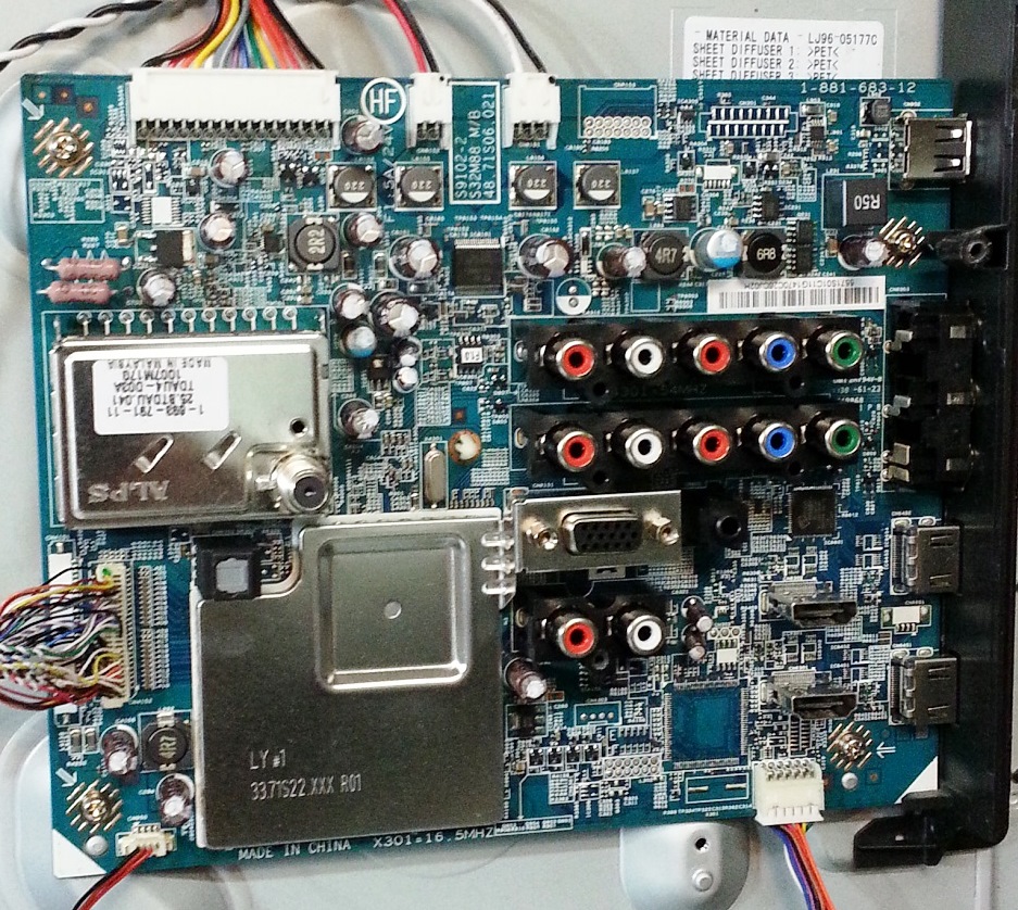

    What is interesting, is that I have replaced the main board with the other TV's bad board and it has the same symptom, 2 blink error code. Now I'm thinking, that main board is not bad after all? Why it was constantly clicking and now with this TV doesn't do that?
    I have made some pictures with my phone, just to start this thread.
    I will make some proper ones tomorrow.

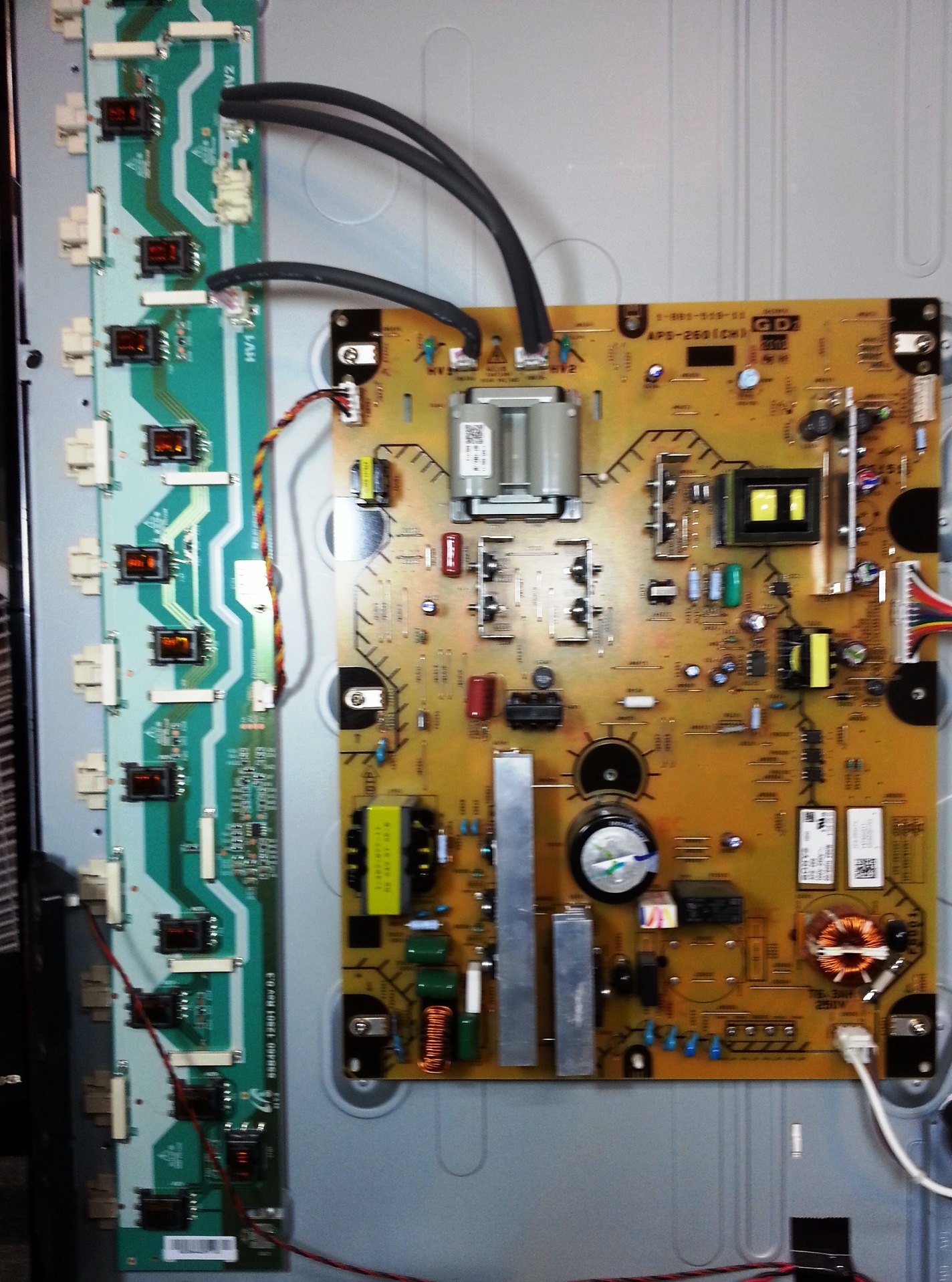

            I know I haven't taken pictures yet, I was busy with other repairs.
            Nobody has any input?
            I have another one for sale, should I just begin swapping boards?
              Re: Sony KDL-46EX400 2 blink error code
              Pictures are very useful in doing repairs have you done any further diagnosis than specified here?

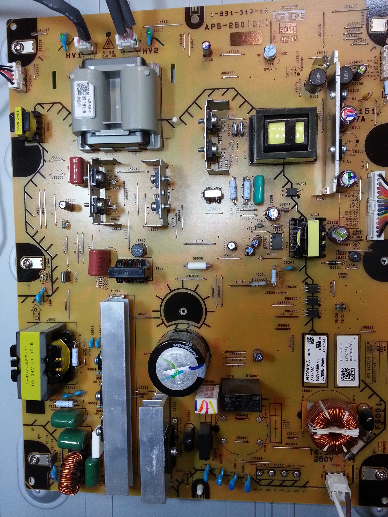

                                        I have downloaded the 46EX402 and it's much closer to what I have.
                                        It seems that Q6151 FET(TPC8119) doesn't output anything.
                                        There is a resistor like IE 7A fuse, before it and there is 12.71V, but nothing comes out before the error kicks in.
