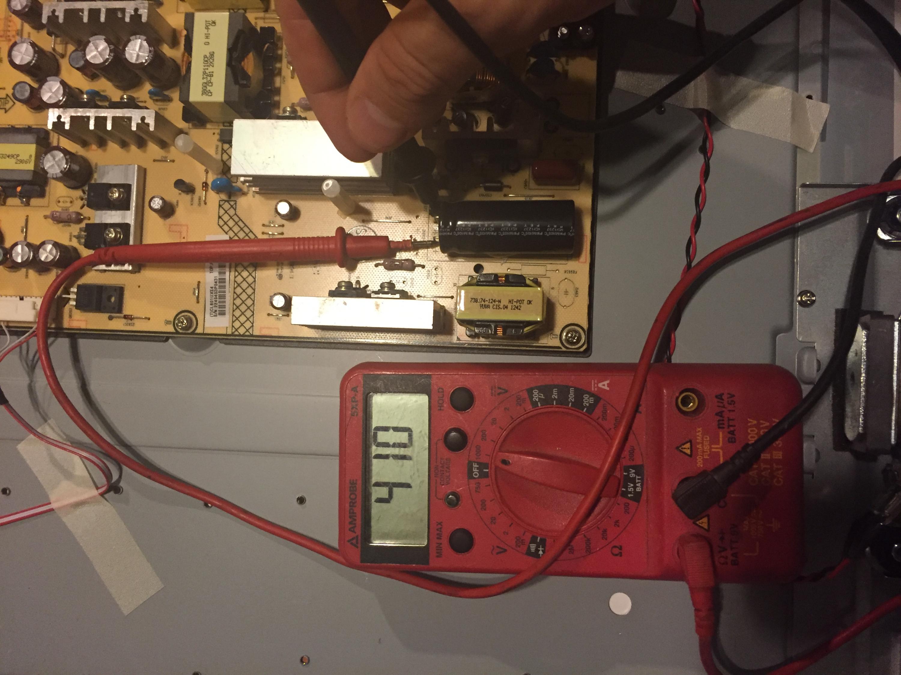

          I got a reading of 410
            #45
            Re: vizio E320-A1 not working
            410VDC? That cannot be true.
            Show the picture of your meter reading.
              #46
              here ya go. I am sure i messed up some setting......
                #47
                I do want to stop and thank you, for being patient and taking time to help me.
                    Try checking 9V battery or AA battery or something.
                    Are you sure the meter is OK?
                    BTW, when you measure those Voltages on the connector of the power supply that goes to the main board, you did have it set to DCV, right?
                    a new 9V battery read 9.5

                              Something is not making sense that you even has 410VDC on the main cap.
