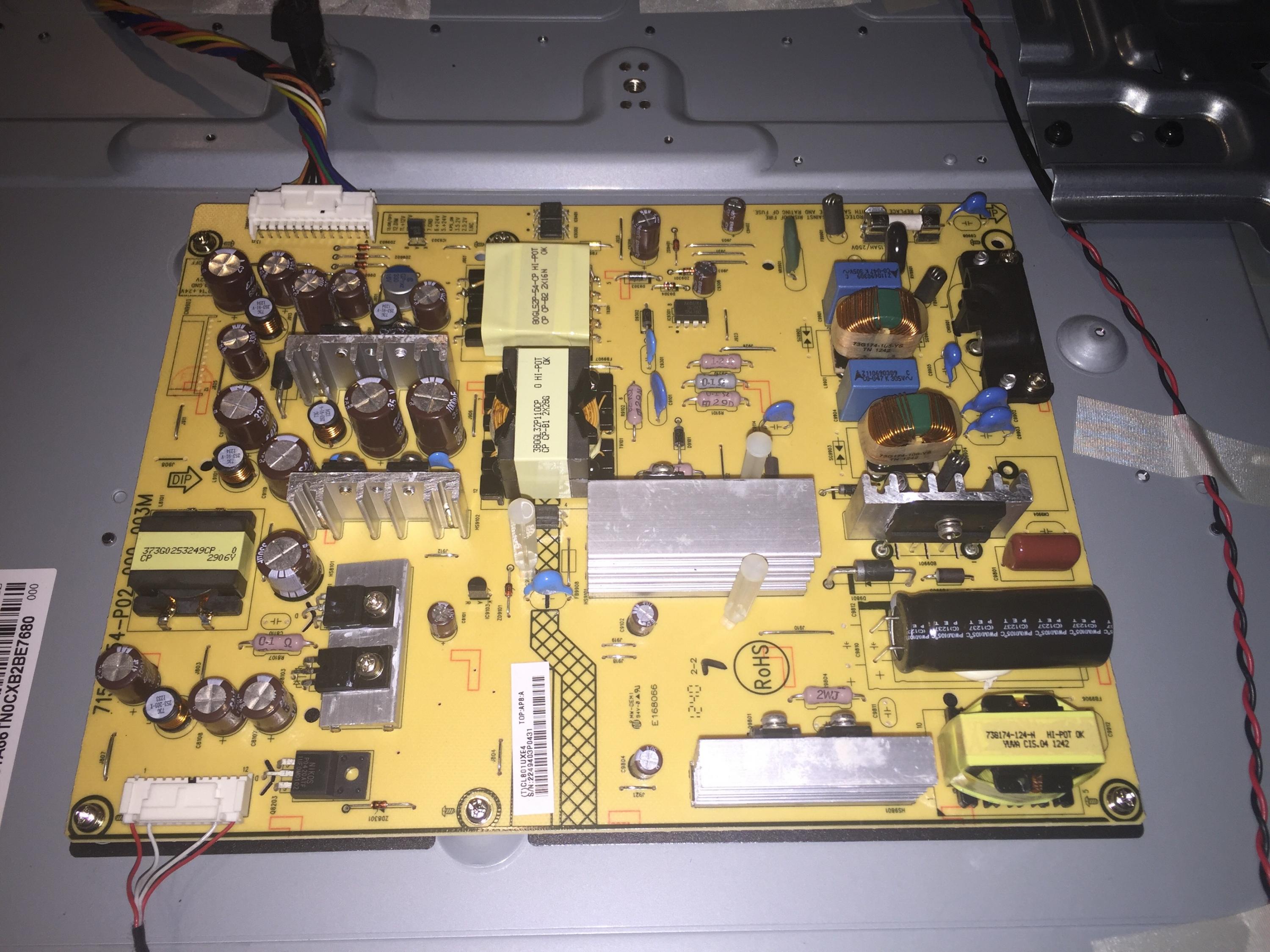

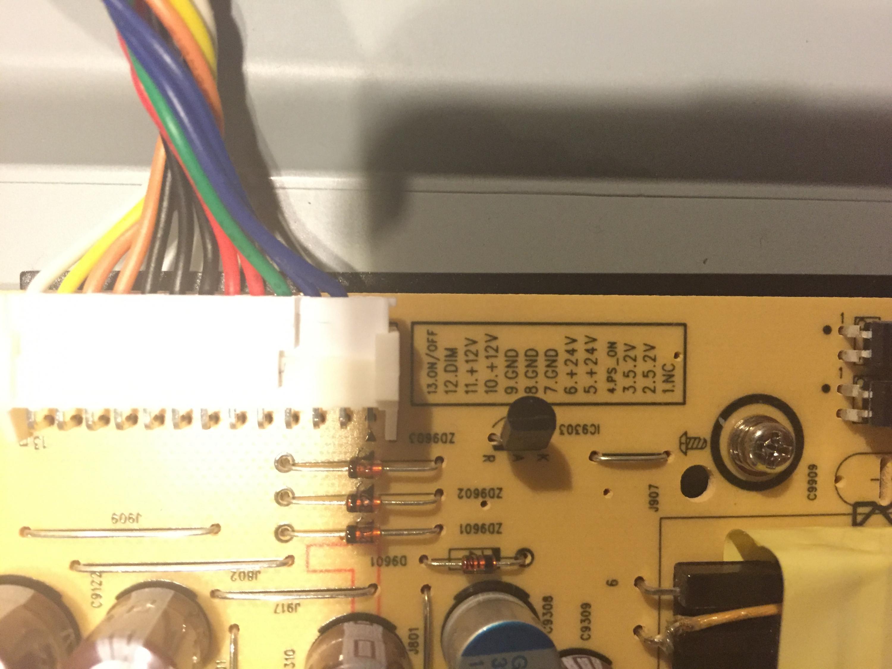

Hello everyone! I know this thread is old but I have another question. I am having the same issue. The TV will not power on at all. No lights, nothing. I am testing with a volt meter on the rainbow colored set of wires going from the power board to the main board and I am not getting any volts. Any info here would be greatly appreciated.

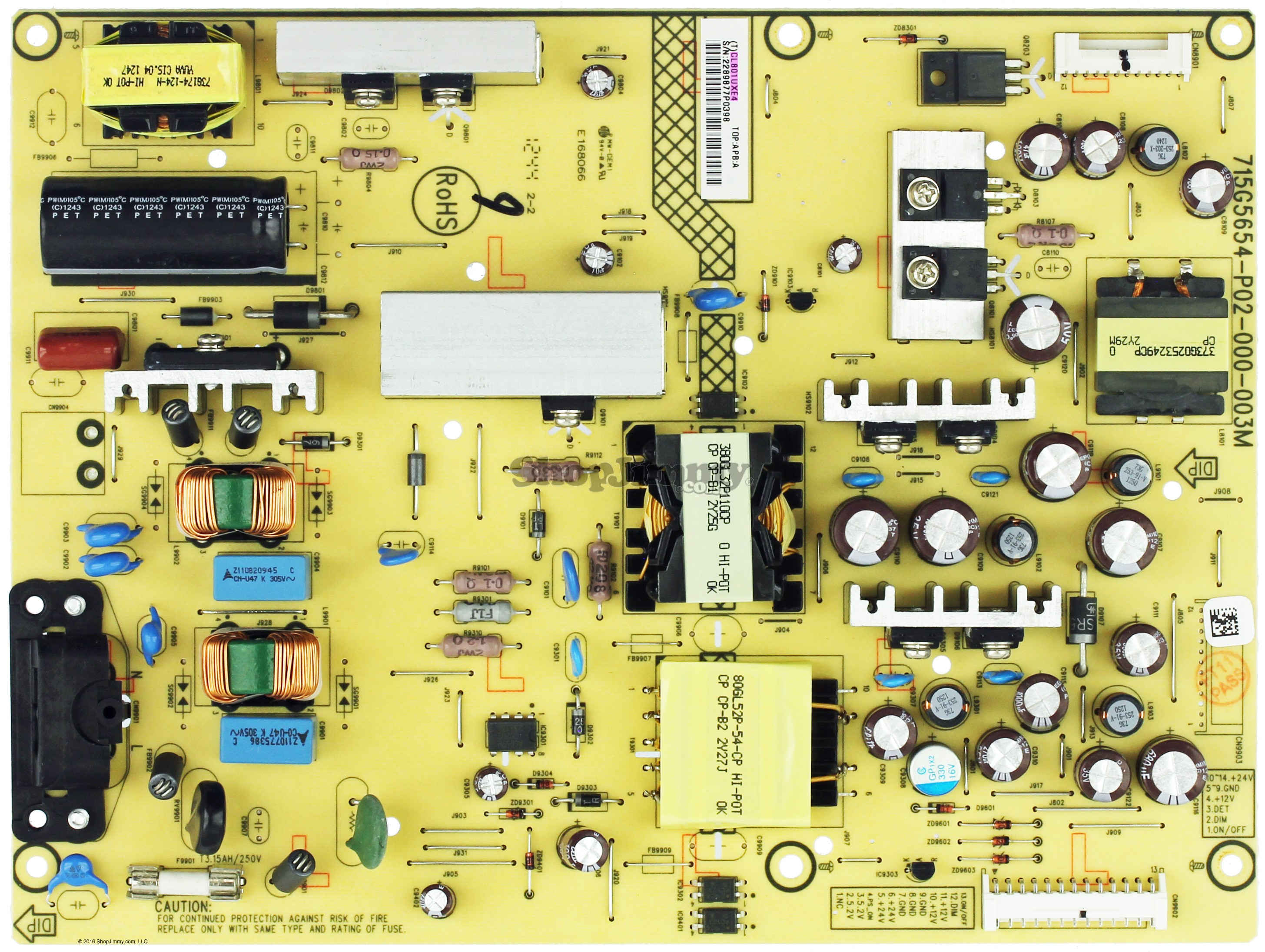

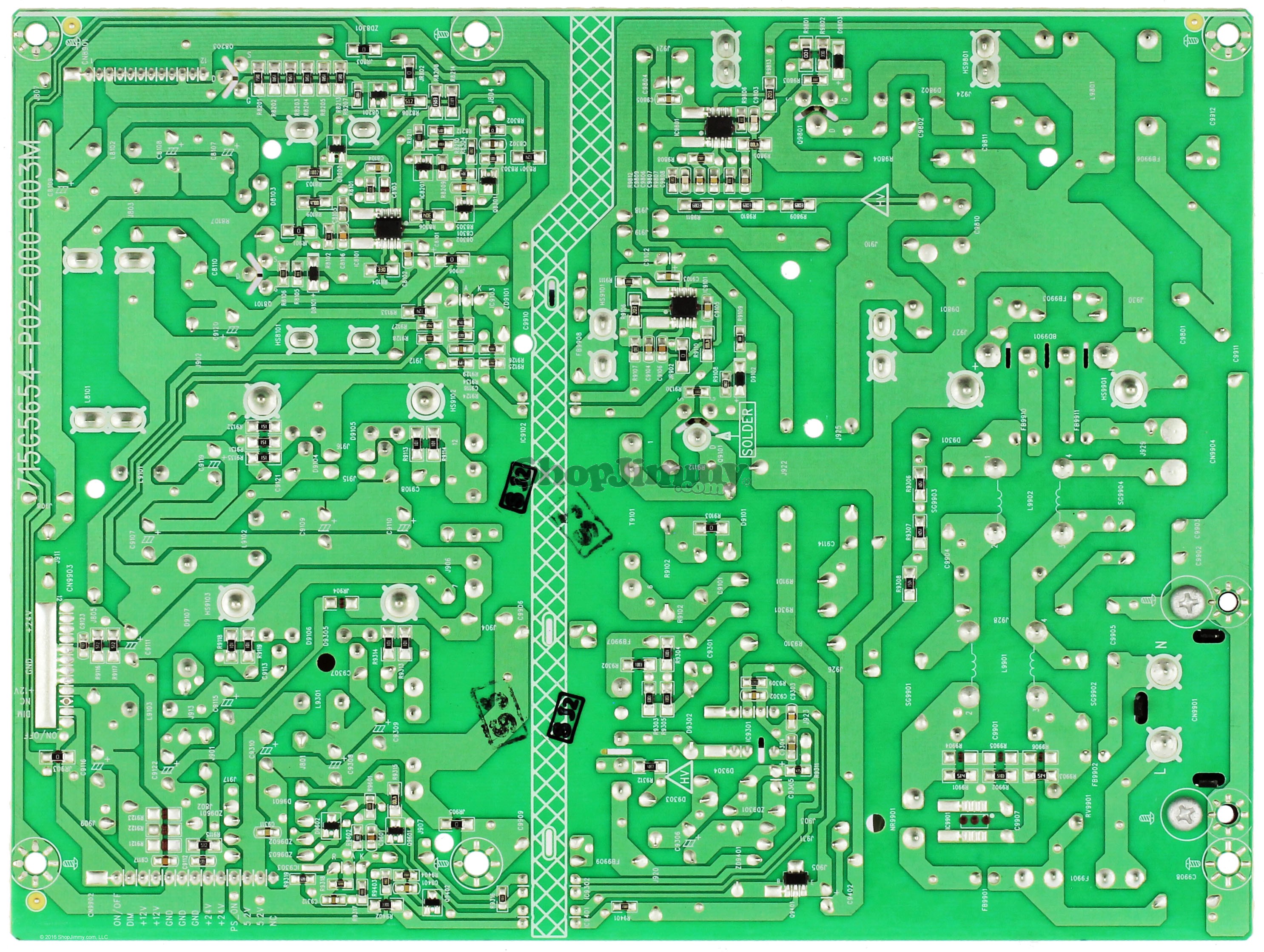

There are two vesrions of the power suply board used in the same model TV and they look almost identical, so your board is the EXACT match to the OP for sure?
See SJ for the exact model you have. http://www.shopjimmy.com/catalogsear...=vizio+E320-A1
Partial part number (CL801UXE3) can be found on a sticker.
Partial part number (CL801UXE3Q) can be found on a sticker.
We are going to troubleshoot using the pictures, so the correct pictures are VERY IMPORTANT!.

Your last post may be a touch over my head. I have the dial on 200V (wavy line over the V). I touch the black to the GND on the 13 pin rainbow wires and I touch the red on the metal of the fuse holder.
tv history. my friend had it for 3 months and one day it just wouldn't cut on. he just gave it to me to look at it. I am now getting around to it. He said he didn't notice a storm or surge around the time it stopped working

Is that the long black horizontal capacitor left of where the plug goes?
