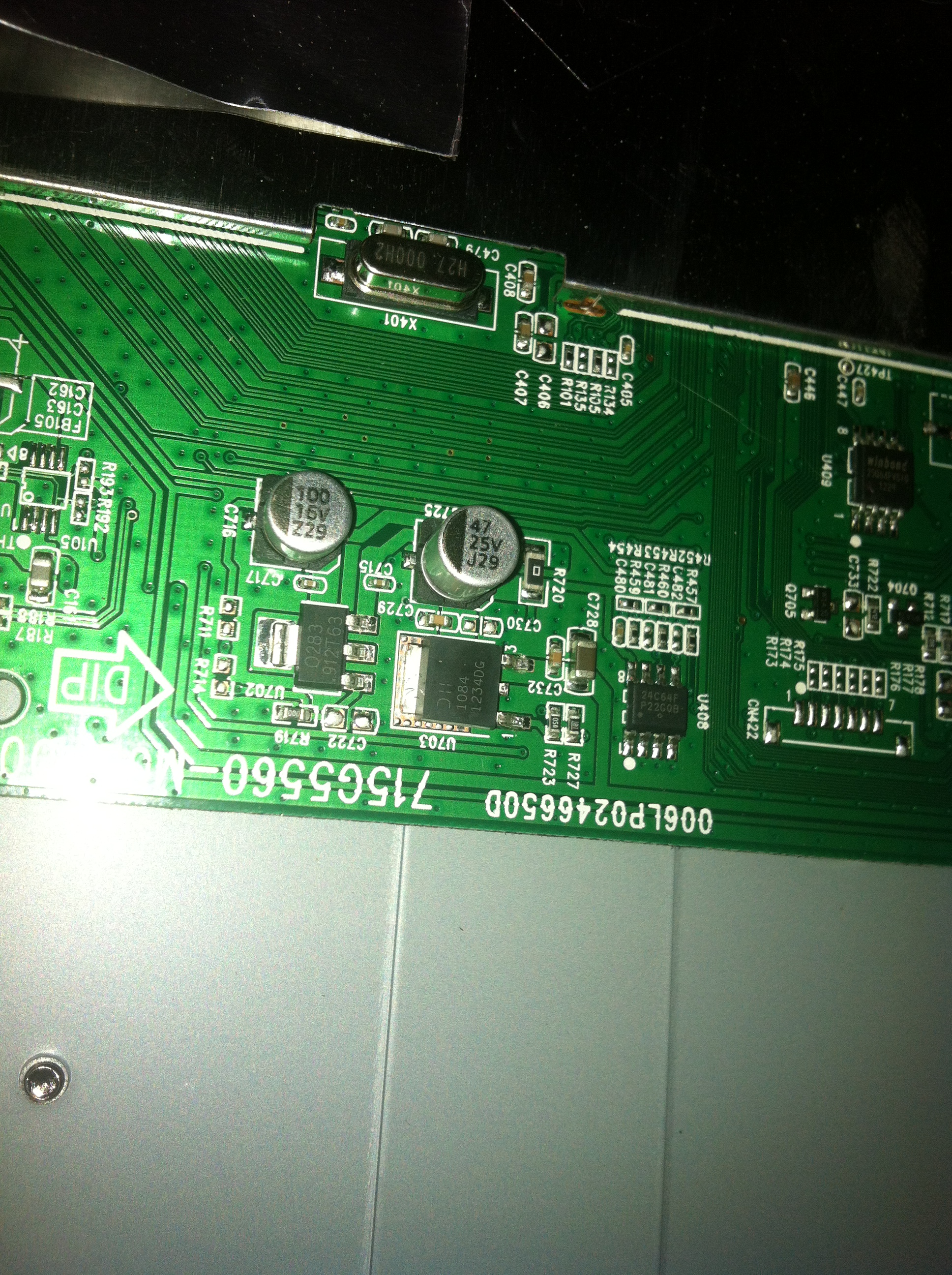

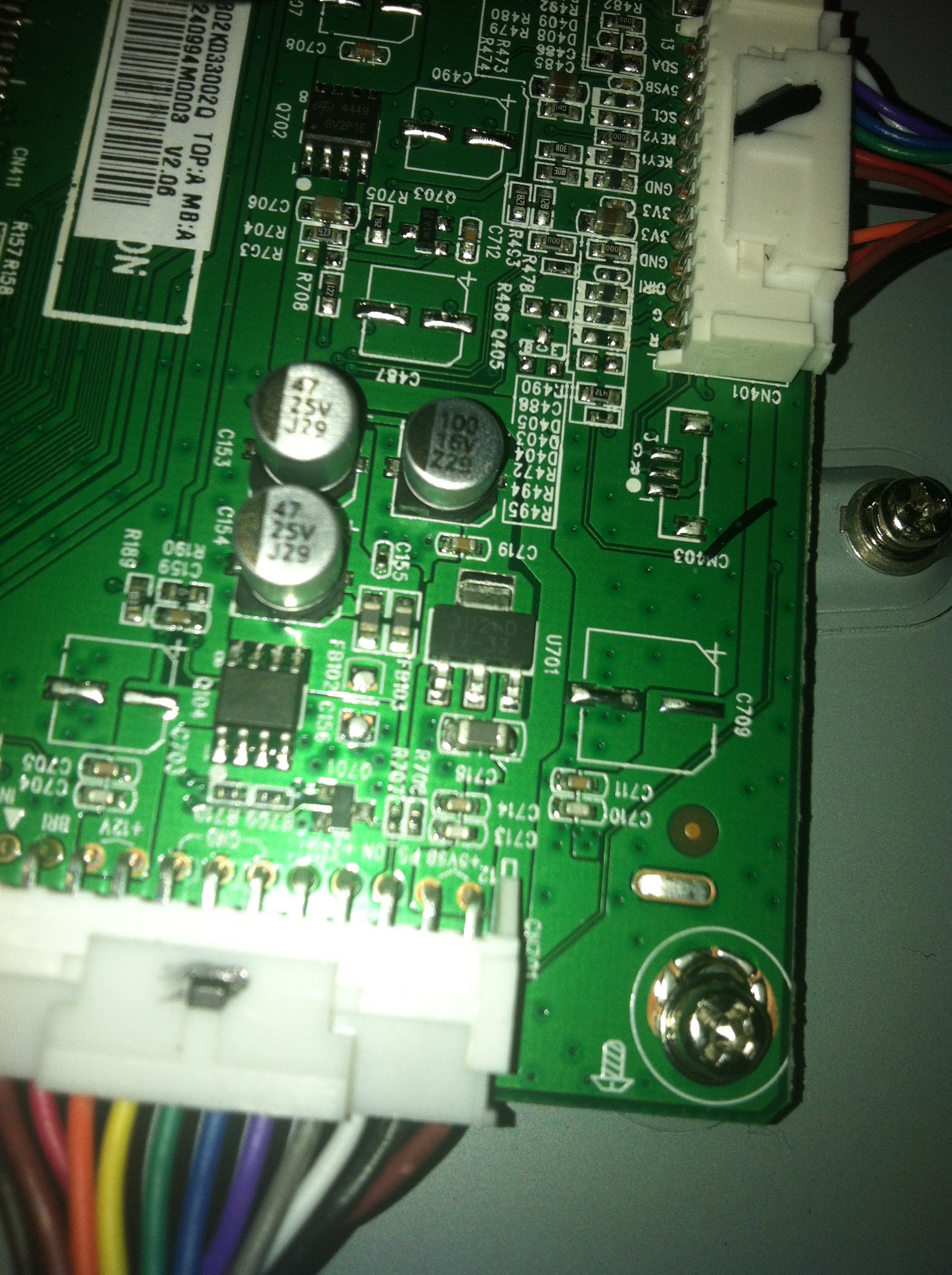

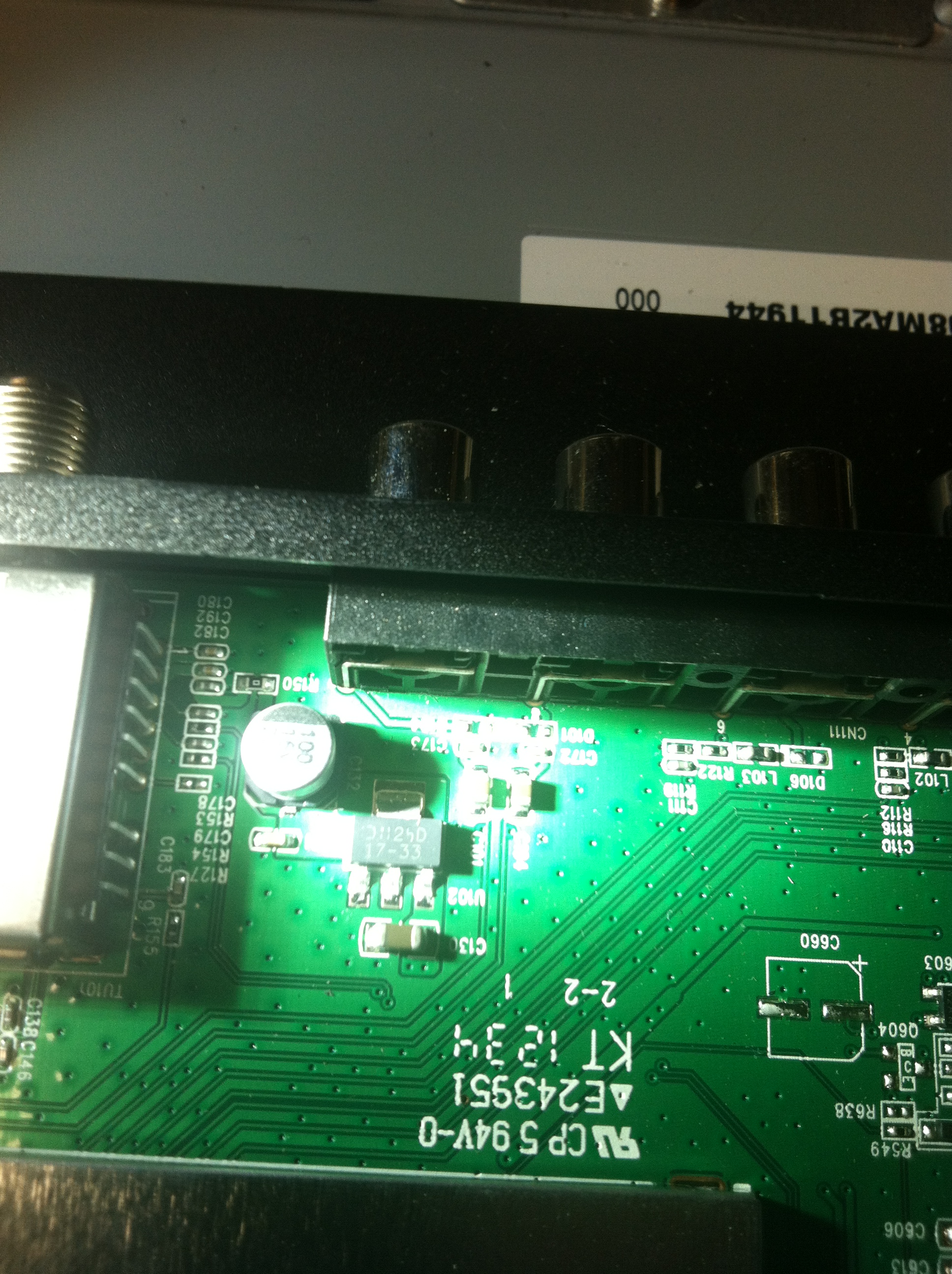

      okay I have retested them
      1084
      1234DG
      pin 1 2.05 volts
      pin 2 3.3 volts
      pin 3 5.23 volts
      connected to the out put of first one is
      0283
      912T63
      pin 1 ground
      pin 2 1.19 volts
      pin 3 3.3 volts
      25D
      17-33
      pin 1 ground
      pin 2 3.29 volts
      pin 3 5.25 volts
      25D
      17-33
      pin 1 ground
      pin 2 3.29 volts
      pin 3 5.23 volts

        Originally posted by mhoward
        0283
        912T63
        pin 1 ground
        pin 2 1.19 volts
        pin 3 3.3 volts
        The above is correct. I was looking at the wrong datasheet. The correct one is
        https://cdn.badcaps-static.com/pdfs/...25e4855b99.pdf
        which specifies it is a fixed 1.2V regulator.

        The above two are good. When you reort just 3.2V it implies 3.200000V. Obviously, when you report 3.29, you can see what a difference it makes.

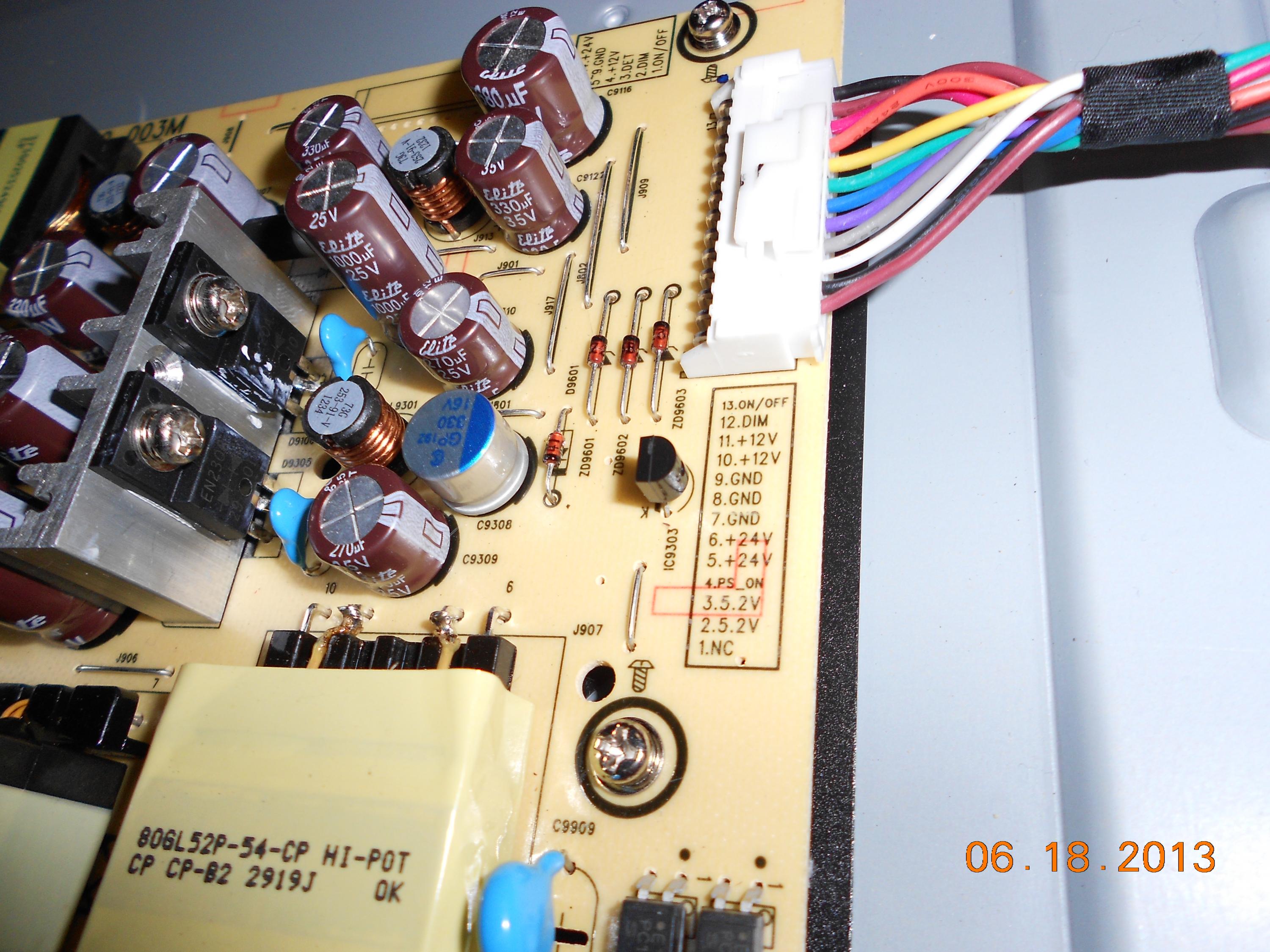

            On the connector from power board to the main board, measure the DC voltages and report them like this.
            pin 1 = legend says 12V, I get 11.99V
            pin 2 = etc

              okay I have
              pin legend reading
              13 on/off 247.5 ohms to ground
              12 Dim 6.78 ohms to ground
              11 +12v 12.38v
              10 +12v 12.38v
              9 GND 0.0 ohms to ground
              8 GND 0.0 ohms to ground
              7 GND 0.0 ohms to ground
              6 +24v 24.75v
              5 +24v 24.75v
              4 ps_on 4.83v
              3 5.2v 5.25v
              2 5.2v 5.25v
              1 nc
              the pin 13 never seems to see any voltage not sure if it will at some point or not, same with the 12 pin for dim

                Pin 13 is likely backlight on/off. If there is no voltage, the backlight will not come on. The main board controls this functionality.

                          Those two signals:bl_on (or ON/OFF) and the backlights dimming control are generated by the main board, that is why there is no backlights even though you have 24V feeding the inverter board. The PS_ON signal from main board is working otherwise you will not get the 24VDC for the inverter board. You will have to work on the main board next, I am not sure if this VIZIO series is one of those with the bad EEPROM pronblem or not.

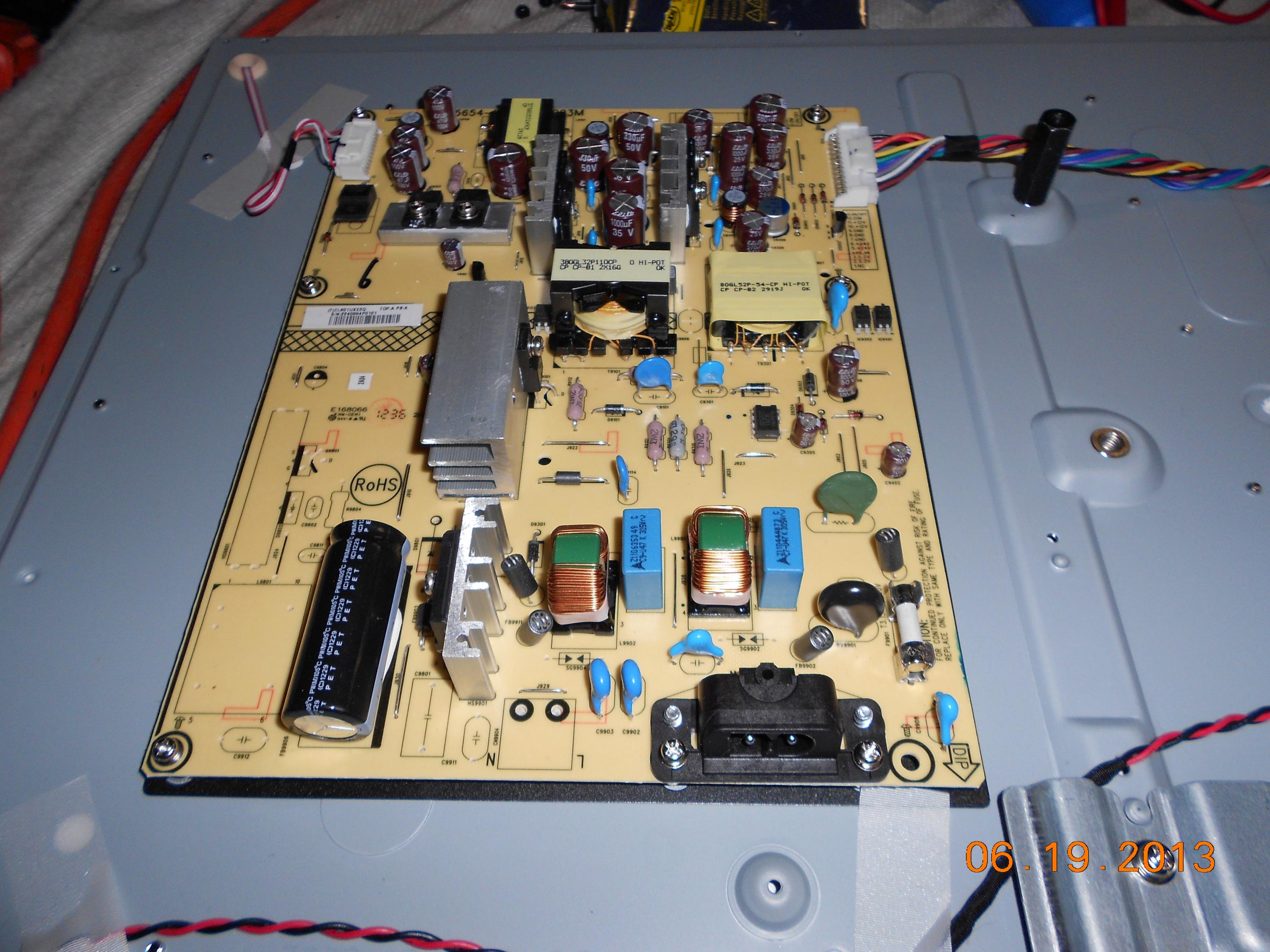

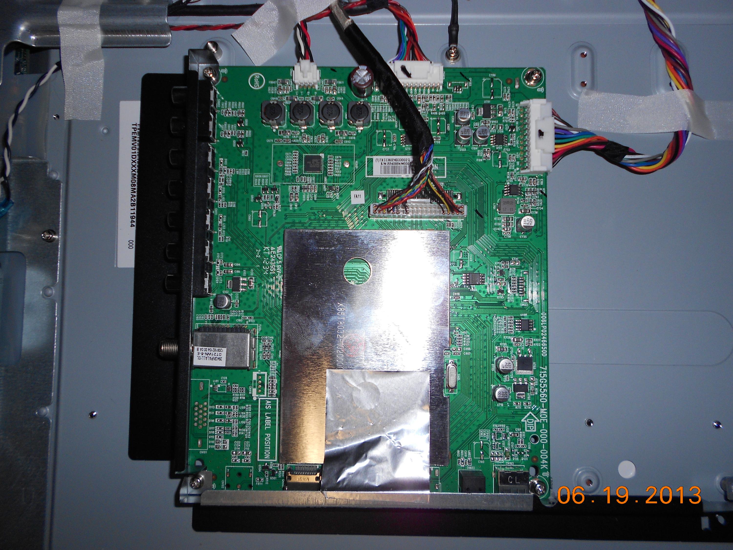

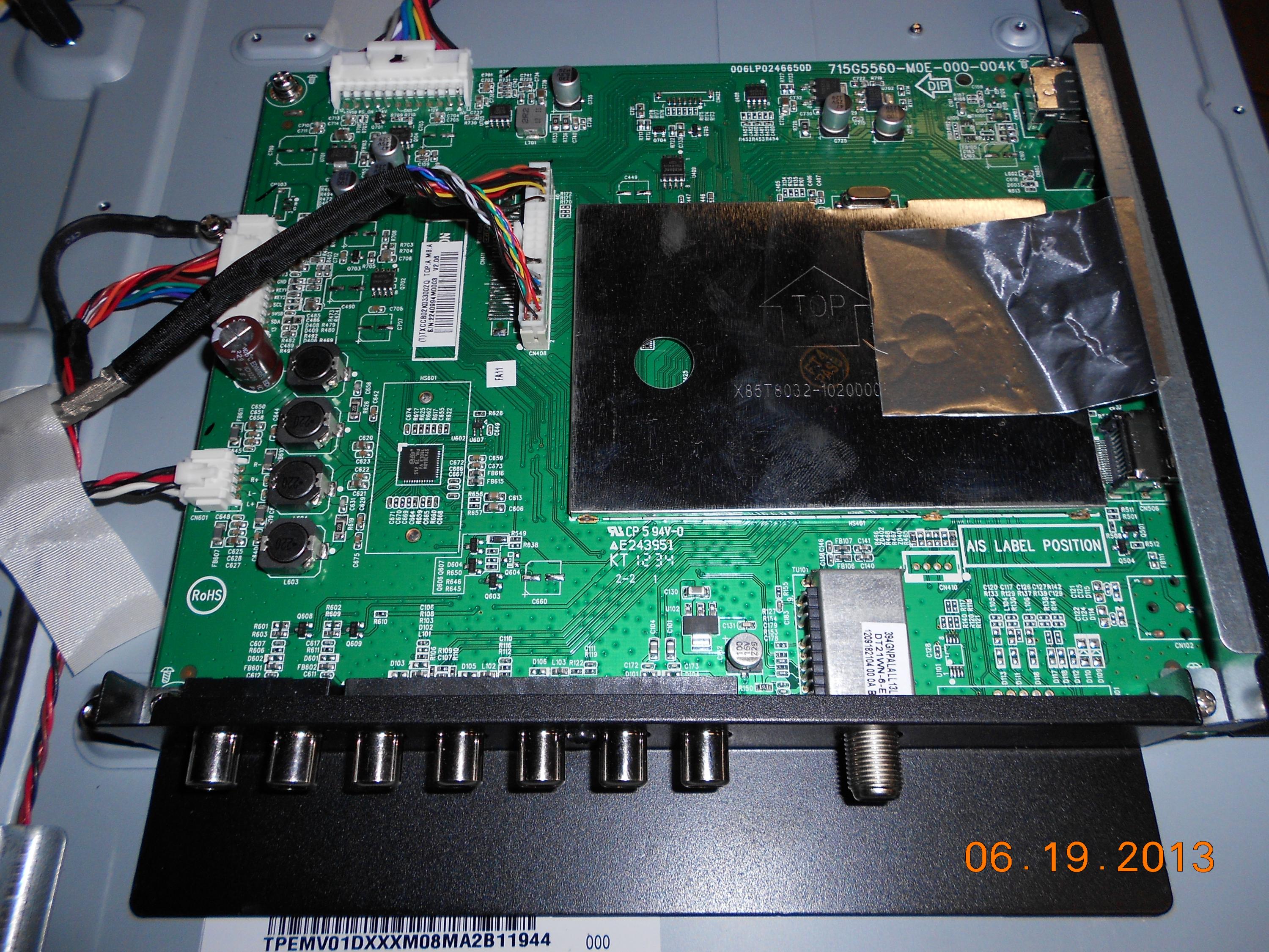

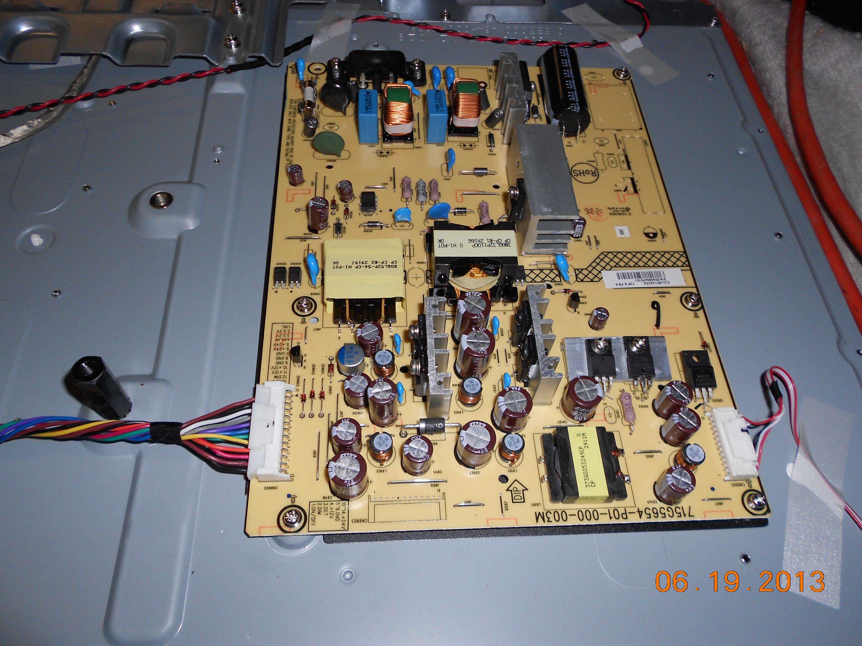

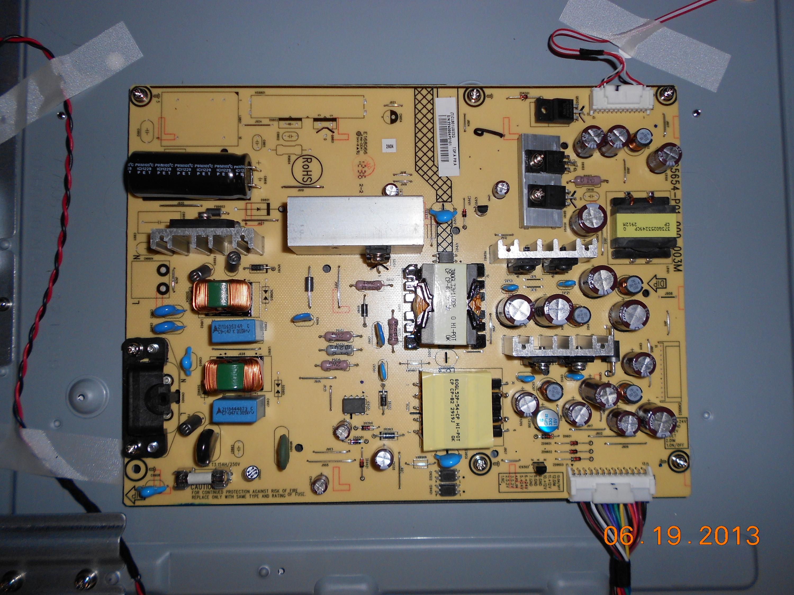

                            this Vizio 32" has LED back-lighting. you need to upload pictures of the power supply and LED driver board section.

                              here is some pics of the power supply and main board

                                    no I ended up just replacing the main board
