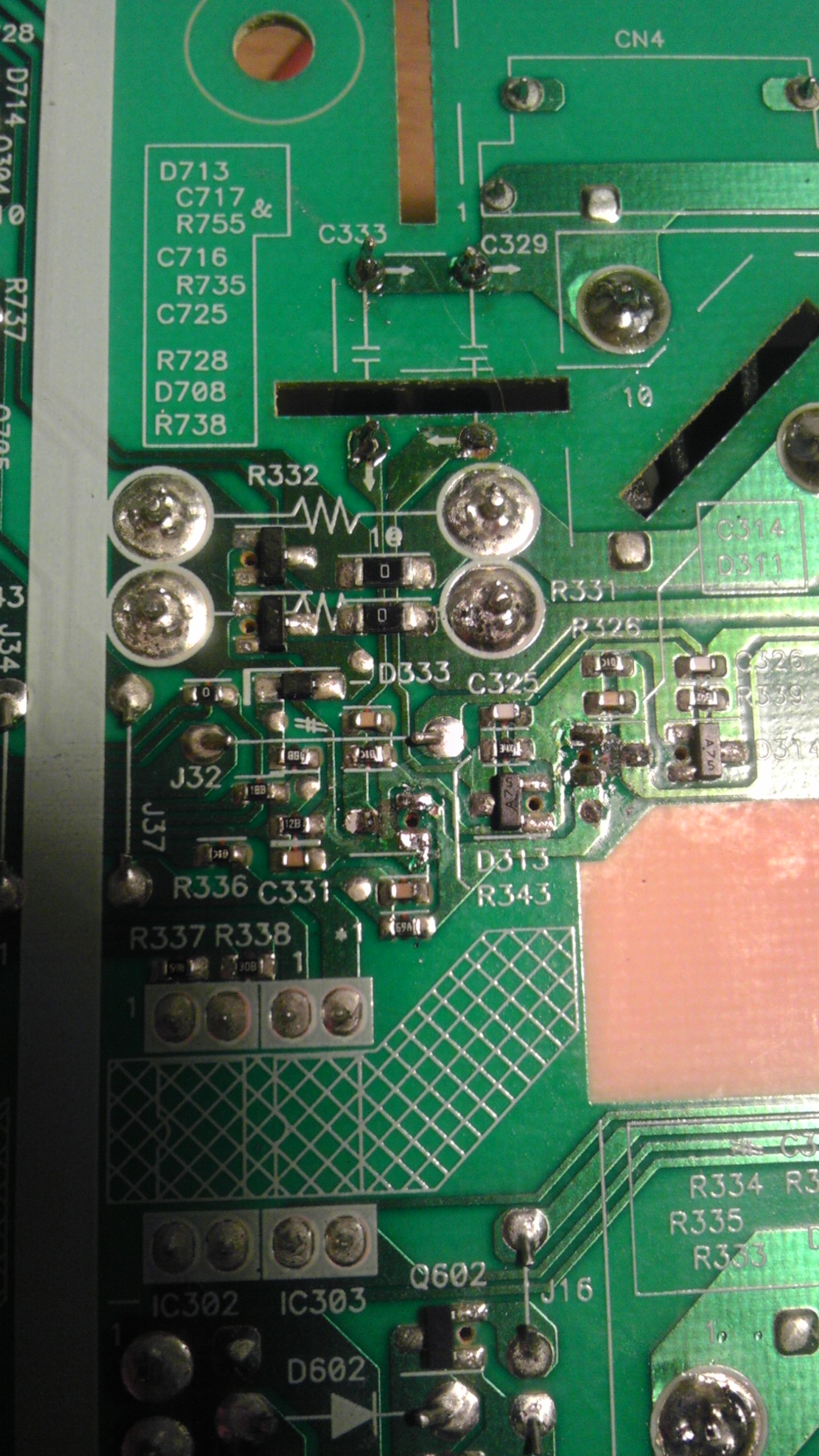

                                    Well, looks like I've joined the no backlight club on this model of Sanyo with the DPS-260LP power supply board.
                                    I found 2 of what I initially thought were SMD transistors that look bad. But these devices are labeled as diodes on the PC board. They have A.7 stamped in the top, with the number 5 sideways on the end.
                                    Any idea what these are? Pic attached.
                                    Thanks in advance, Ray

                                      Re: Sanyo DP42849 Backlight Shutsdown
                                      Well, I replaced several electrolytics around the inverter section with low ESR caps. Checked each one of the old ones with a Peak Electronics ESR meter, they all looked good. But after reassembly the set wouldn't even power on anymore. Thought I'd installed a cap backwards, but that shouldn't have prevented it from powering up, and after checking they were all installed correctly. I had more pressing repairs pending, so I put it aside.
                                      Cleaning the garage this week and decided to put the set back on the bench. Right away I found one of the connectors on the main board was partially unseated. Pushed it in, and now everything works.
                                      One or more of the electrolytics must have been bad, even though they all looked good. I believe this is the most common failure in these inverter circuits.
