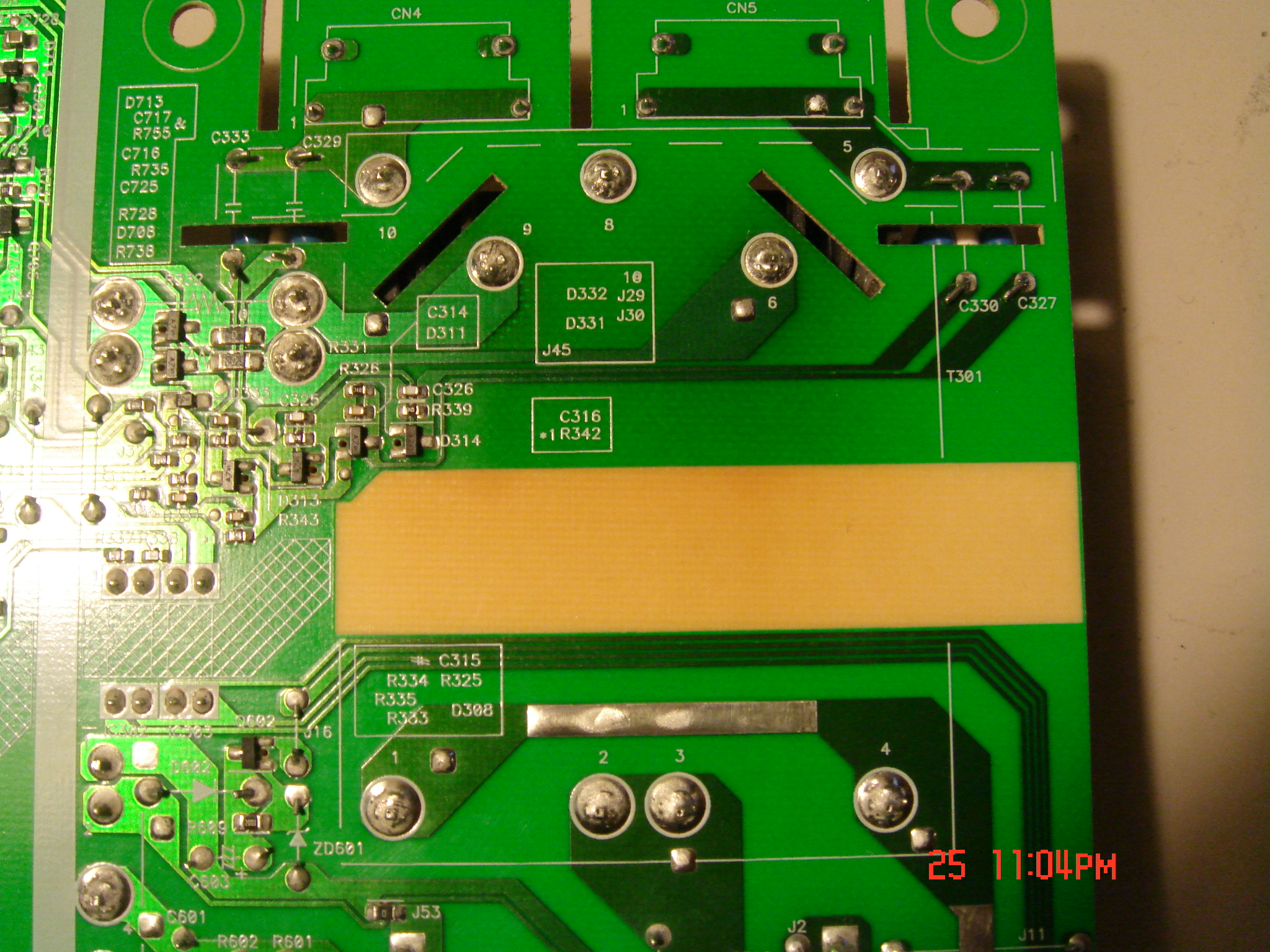

    Here is what I found: This Inverter Transformer has a shorted secondary winding. It has two secondary windings, the shorted one is 27 ohms and the good one is 2.3K ohms. This powersupply board is not available
    I have searched for a replacement and can't find one in my limited search abilities. Anybody know where I could get one?

    Are you sure it has two secondary windings ? could one be the primary.
    This looks like a big transformer that supplies a series of smaller transformers on an inverter board?
    • high-tech
      • Sep 2010
      • 197
      Re: Sanyo DP42849 Backlight Shutsdown
      Yes I'm sure. look just above the transformer and you will see the two plugs where the two backlight harnesses plug into the board.
        The main secondary on this appears to be between pin 5 and 10, and it has only one such secondary.

            well I think it is single secondary. and pins 6 and 9 are for the feed back? If this is true my earlier checks that I thought were 2 windings. I ohmed from pins 9 to 10 and got
            2.3k ohms and pins 5 and 6 and got 27 ohms. the 27 ohm reading should be infinite or open.
              It is single (output) secondary, the other secondary will probably be for monitoring the current.

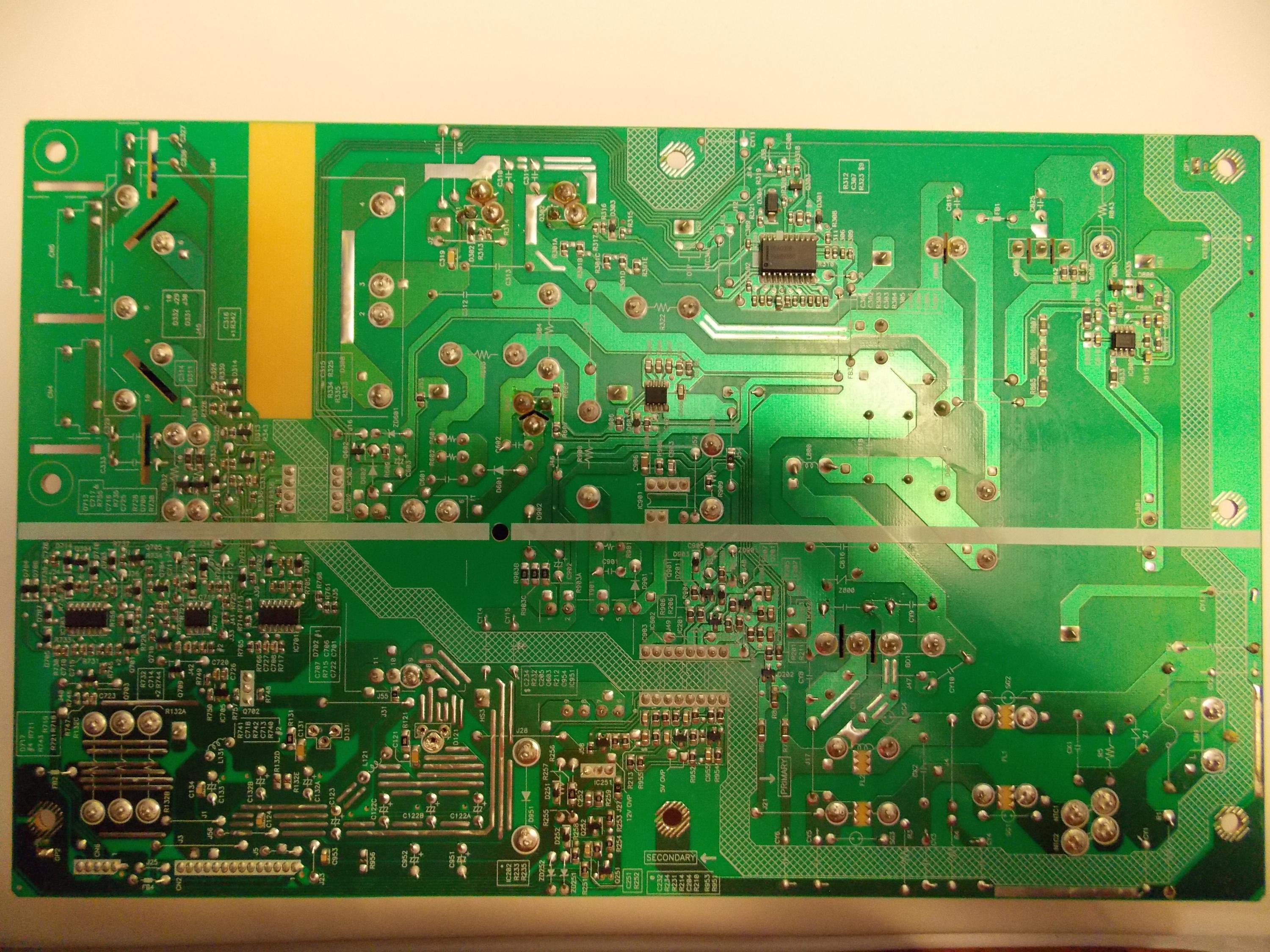

                        Power / Inverter board data - DPS-260LP A, P/N 1AV4U20C41500
                        I have the exact same board with a bit different symptom
                        Upon power on after afew seconds the backlights flash for less than one second
                        Looks as if the rest of the TV is functioning OK with Video and audio
                        Pin 9 to 10 measure 370 Ohms
                        Pin 5 to 6 27 Ohms

                                    • martyparish
                                      • Dec 2012
                                      • 313
                                      Hey guys,
                                      I think there are two options(in my humble opinion)
                                      1) Check this seller out on ebay who is selling "refurbished" PSUs for this TV. $125, but you get $50 core for old board. ($75 ain't too bad I guess)
                                      ebay board
                                      2) Rewind the transformer
