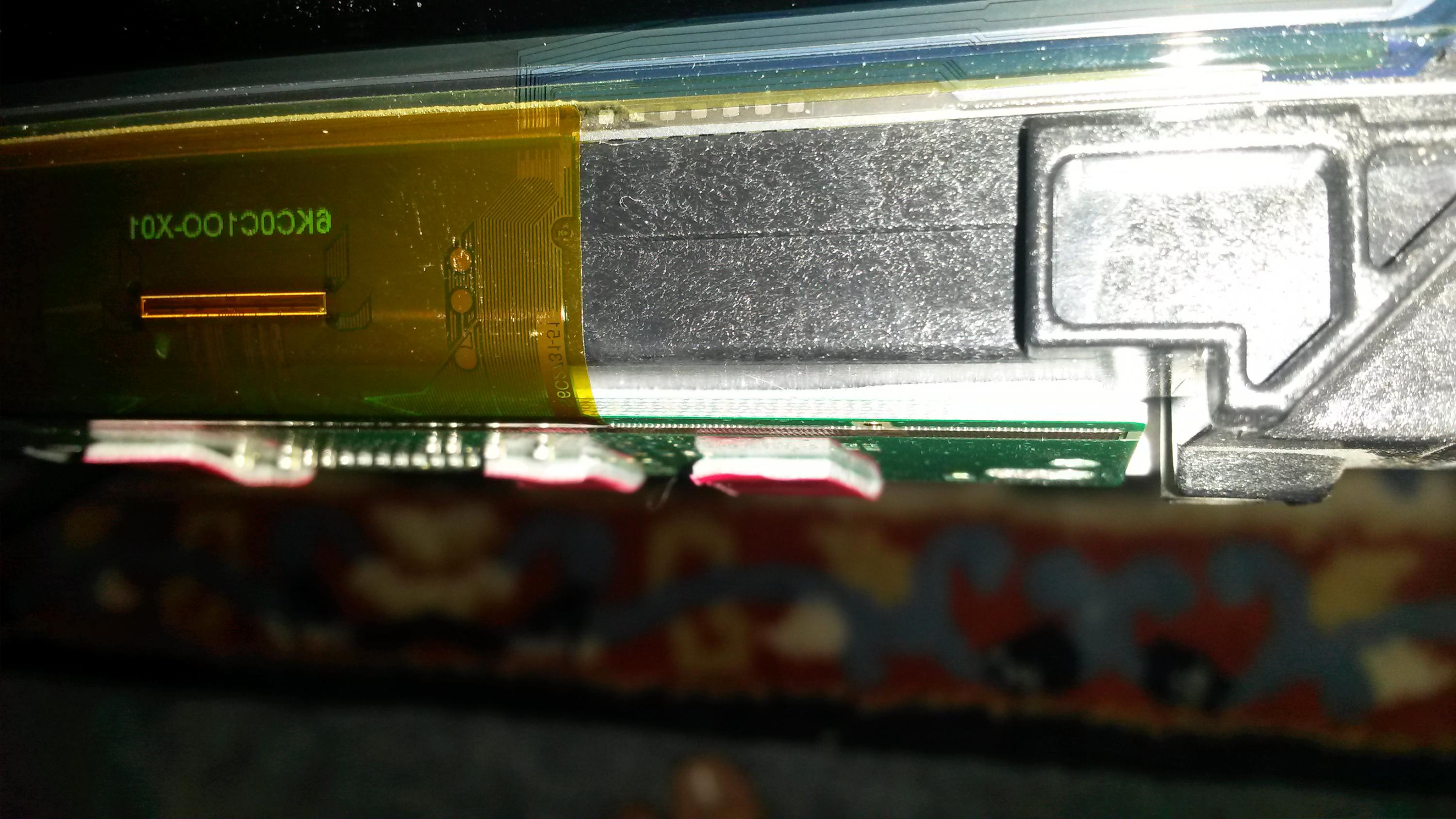

                            I just got a 52 inch 850 series (LN52A850S1F) tv as well. When you turn it on it has a black vertical line through the center of the screen. As the tv warms up it stars to flicker and lines go through the screen horizontally. They start at the bottom and work their way to the top, progressively getting worse. I was thinking T-conn board as well when I saw it. After reading this post I now wonder if is a bonding issue as well. By looking at these pics I would like to get your opinion before I order a t-conn board if y'all don't mind.
                            • stinger381
                              • Apr 2013
                              • 42
                              #94
                              Re: Samsung LN52A530P1FXZA Tab bonding repair
                              Here is what it looks like after about 5 mins.
                              • stinger381
                                • Apr 2013
                                • 42
                                #95
                                After reading several posts today I will attempt to do a tab bonding repair like BudM explains. I have the Tv apart now and have cleaned out all the dust. Just need to find some bonding material to try out. Maybe Radio Shack will have something otherwise I will order some from the net.
                                • stinger381
                                  • Apr 2013
                                  • 42
                                  #96
                                  Well the tab bonding trick did not help me out but on the bright side I got it all back together. While I had it running I unplugged the left side cables on the t-conn and the screen went to color bars. I plugged them back in and the picture came back with horizontal lines. When I un plugged the other side the right side of the screen became crystal clear. Even when I plugged the inside cable back in 3/4 of the scree is perfect when that 4th cable is connected it all goes haywire. I think a t-conn board might actually fix this thing. I will let you know how it goes.
                                    Thanks for the advise. Worked Great, TV has no symptoms anymore, a Samsung 46" LCD (Ln46a550).
                                    I altered the guide a little bit putting one 2 " piece of 3M Mounting tape ( double sided grey foam material)
                                    UNDER the PCB Board with the ribbon cables attached in order to put some tension on the cable and it will pull itself (Instead of push) against the pcb board to make a good connection. I then taped a few pieces from the bottom edge of the pcb board around the corner towards the back of the screen to hold the circuit board flush against the side (because the tape on the back of the board makes it angle out a bit on the bottom)
                                    IMPORTANT: I suggest you take apart the unit and remove plastic case and bezel down to removing the metal frame where you can access the tabs/ribbon cables. Then lay TV on it's back up on a table (or any elevated flat surface) with several inches of bottom side of TV hanging off the edge of the table (so that you have access to power port and to plug for IR sensor/side buttons). PLUG in power button/IR sensor cable and plug in power cord.
                                    TEST WHICH TAB\RIBBON IS BAD BEFORE YOU TRY AND FIX!!
                                    THIS WILL SAVE YOU FRUSTRATION!!!! HERE'S HOW:
                                    With the tabs accessible and TV powered on, you can simply press lightly /wiggle against where the ribbon cables meet the circuit board. BE CAREFUL DON'T ELECTROCUTE YOURSELF!! It will be very easy to tell which one/s are bad by touching it lightly.
                                    Then simply put pad over or under pcb depending on which fixes the problem better.
                                    I'll try and post pictures to help explain.
                                    **********THIS GUIDE IS BASED ON MY SAMSUNG 46" LCD. WHEN DISSEMBLING YOUR TV, THE STEPS OF TAKING IT APART AND LOCATING TABS MAY DIFFER, BUT THE CONCEPT IS THE SAME****************
