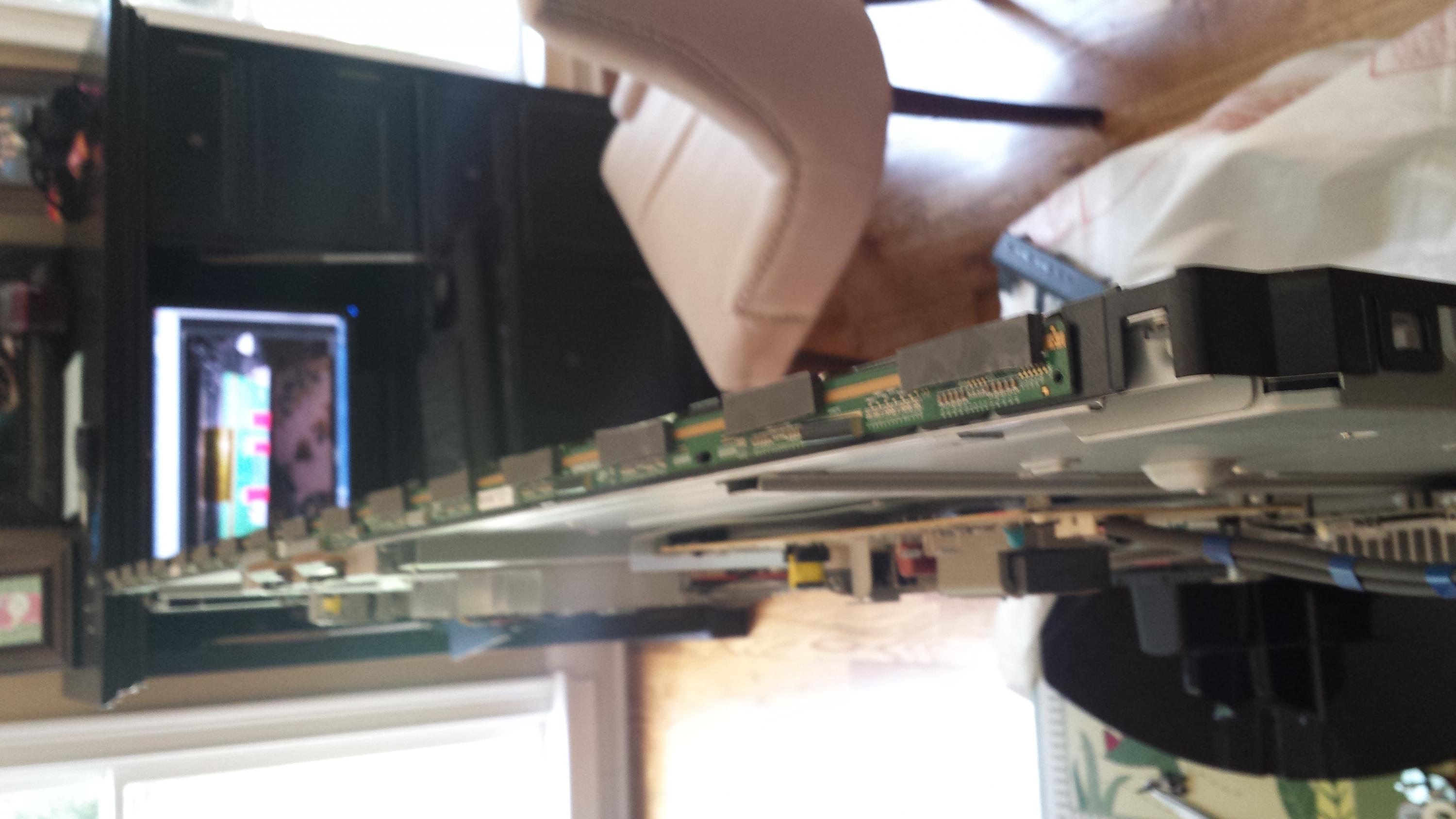

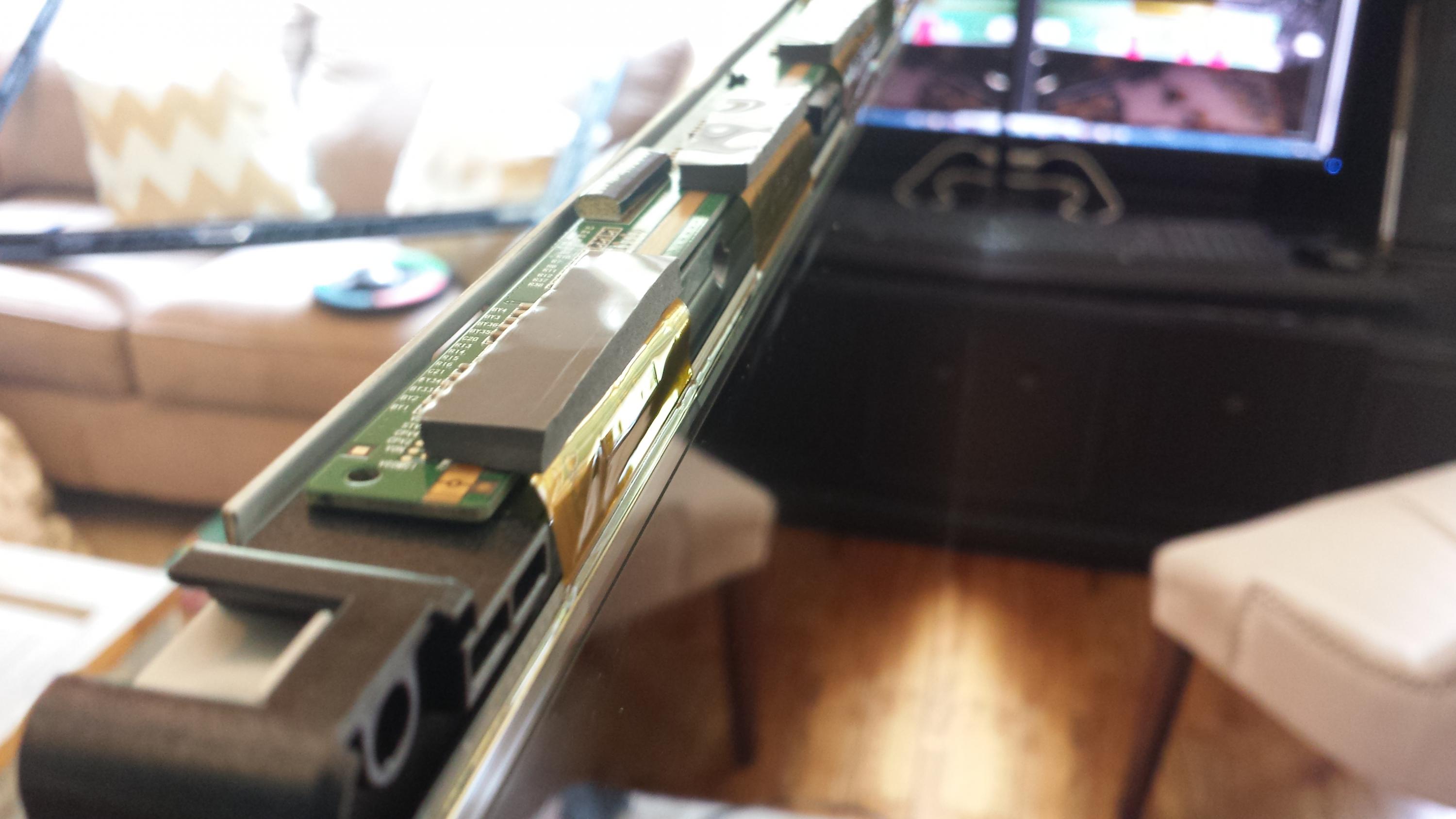

          • kneeman
            • Jul 2015
            • 30
            #125
            Re: Samsung LN52A530P1FXZA Tab bonding repair
            Hi, got no response so here is what I did if anyone else cares reading this.
            Ordered four pads that are 4"x4" .125" thick. Only needed one though.
            I noticed the gold tabs are all along the entire circuit board length so I wasn't sure if it was ok to have the pads touching the areas where there were no connections. I carefully cut the pads the exact width of the tabs. I noticed some cut the tabs narrower and just put them in the center of the tab. Not sure why they did that. Maybe it is better that way. I don't know.
            I also didn't wrap the pad over the corner to the front of the TV screen. I didn't see a reason to. There is just a ribbon cable there that goes into the led panel, no connection.
            After assembly you can look at the gap between the tv and the metal frame and see that the new pads are definitely being contacted by the frame. The circuit boards have "gaskets" on them already. I assume they are just to make sure the metal frame won't contact the circuit board, but anyway they almost contact the metal frame now, the new pads I put on are a tad thicker. Of course I put the top of the metal frame back on first so the new pads wouldn't get pushed off when assembling.
            Photos below. Works so far. My problem was thin black horizontal lines mainly on the top and bottom that would flicker and go away after 30 minutes.
            If this fix fails I will post again. If not know it is working.
            Not I have to take apart another Sony with a bad Samsung LED light strip in it.

                • Moreno83
                  • Jun 2014
                  • 2008
                  • The Netherlands
                  #128
                  Thx for the pictures! I have not read though the whole thread but what does it do? Just pressure on the tabs? It would look like a temporary fix if the tab has come off......

                          • paulstef
                            • Dec 2013
                            • 724
                            #133
                            Originally posted by budm
                            http://s807.photobucket.com/user/bud...?sort=3&page=1
                            The SONY KDL-52VL150 which was done in Dec 2012 is still going strong, 3 years now, same for this 52" Samsung which was done in Jan 2013.
                            I don't quite get what you have done here. Is the issue a detached tab bond or is it overheating of the IC? Why use the transfer pad if a detached bond is the problem? Just wondering if this is similar to my problem: https://www.badcaps.net/forum/showth...058#post616058
                              #134
                              The silicone pads can handle the heat better than rubber bumpers, and stay in place well, the foam does not work well in heated condition and will shrink or do not stay in place, the pad also transfer the heat form the ICs to the frame.
                              • paulstef
                                • Dec 2013
                                • 724
                                #135
                                So the problem in your case was IC failure due to overheat?
                                  #136
                                  ICs were fine if they were bad I would not be able to fix them, the tab bonding were bad and to keep the ICs at lower temperature the pads help transfer the heat to the frame.

                                      • kneeman
                                        • Jul 2015
                                        • 30
                                        #139
                                        FWIW. If anyone reads this thread, look up about 10 posts and you will see photos I posted of how I carefully cut the silicone pads to the correct size. Maybe I should have just haphazzardly cut larger pads that overlapped a lot like other people did. After a few months the lines came back in my set when I first turn it one. I can push a corner of the set and the lines go away.
                                        I will order some more of the stuff and redo it I guess cutting larger pads this time. They seem to be quite snug when I put the metal frame over them. Unless this material has memory and has loosened up some after being squeezed a few months they should still be tight.
