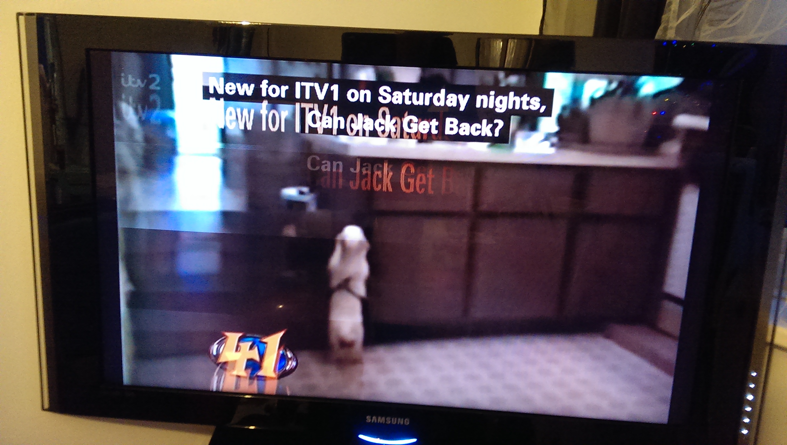

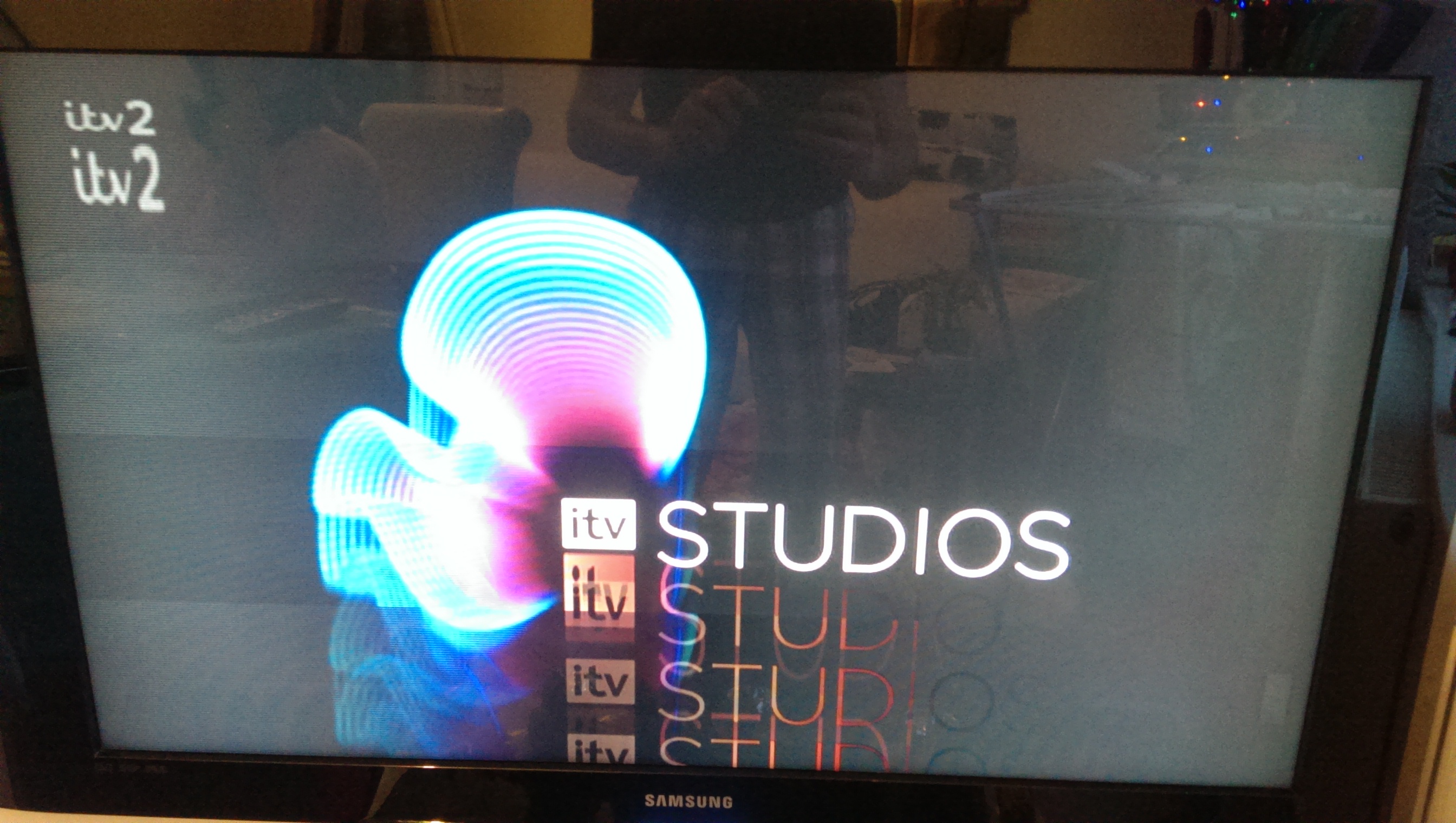

                      I have a Samsung LE40F86BDX/XEU TV that is displaying a double image once I turn it on.
                      After a few minutes the image gets clear but sometimes still gets that doubled image one over the other.
                      I've been researching on this issue and seems that could be a defective tcon board or a tab bonding issue...
                      As an expert on the matter can you advise me?
                      All the best and best regards.
                        #71
                        Re: Samsung LN52A530P1FXZA Tab bonding repair
                        Definitely tab bonds. If you don't leave it too long you may be able to fix this. Though with these panels, I've only seen about a 40 to 50% success rate in repairing them.

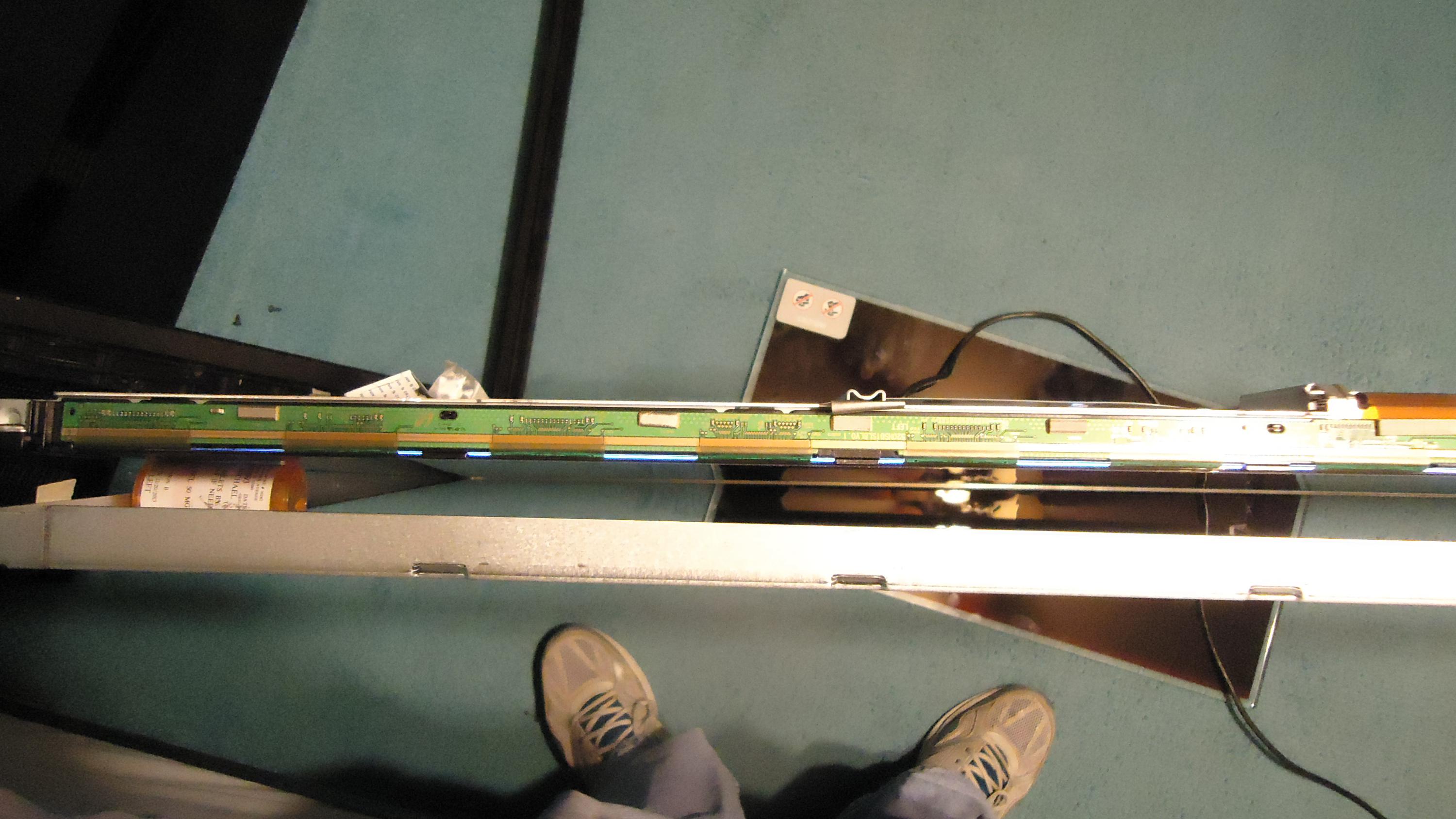

                          thanks for your help, cheers.
                            #73
                            You need to get it to the point where you can take off the front plastic frame by essentially removing both the front and back plastic casing from the TV. Then, with that, remove the metal framing around the front of the LCD panel to access the tab bonds. Follow Budm's steps in applying the tab shim, on these it is usually the left or right bondings.

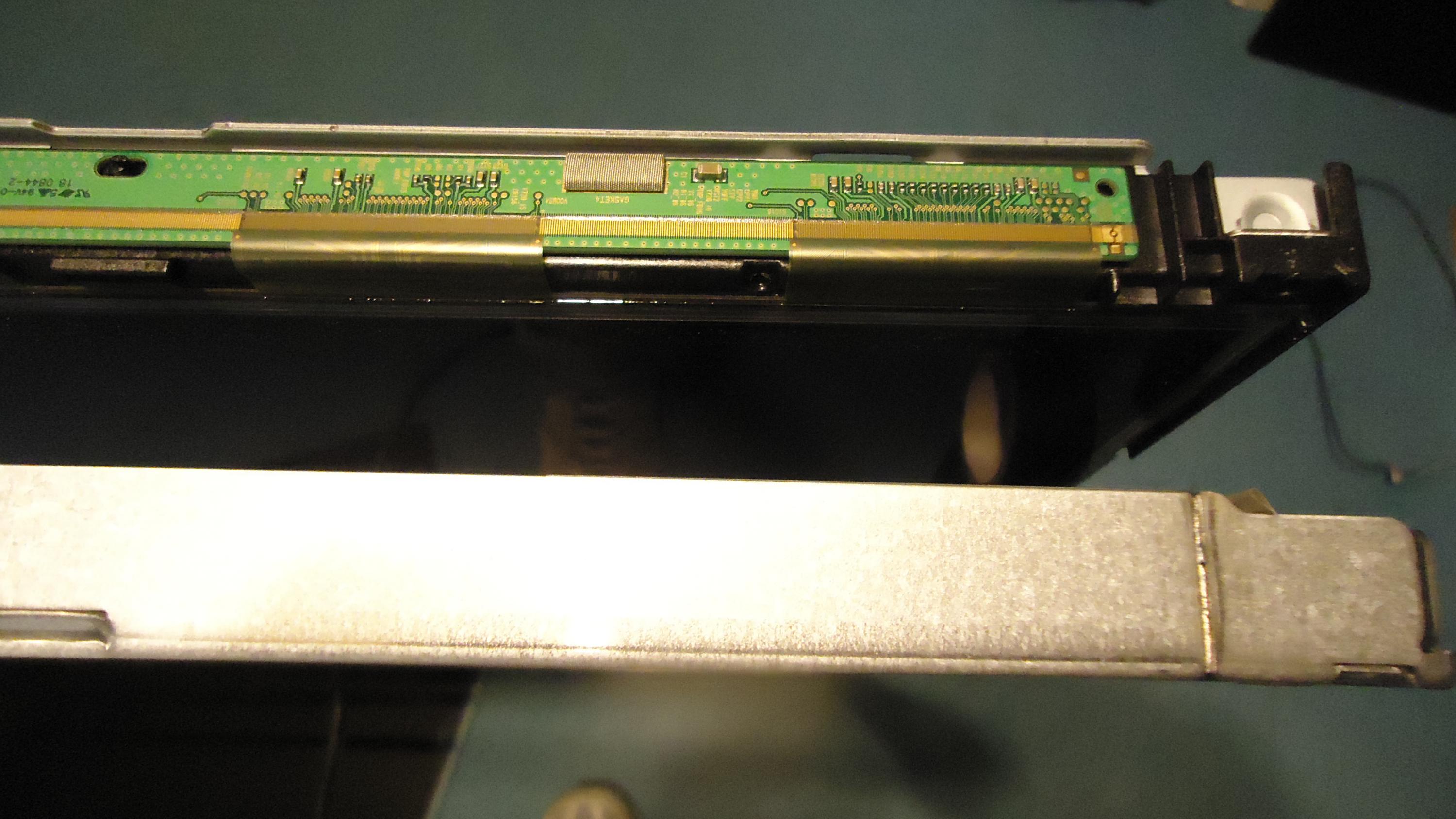

                                        Do you have a picture of how you placed the pad under the chip? I'm opening up my 52" and I've read in another forum this also has been working for other folks.

                                          I fix tab bonds with the panel standing up on its base so much easier.
