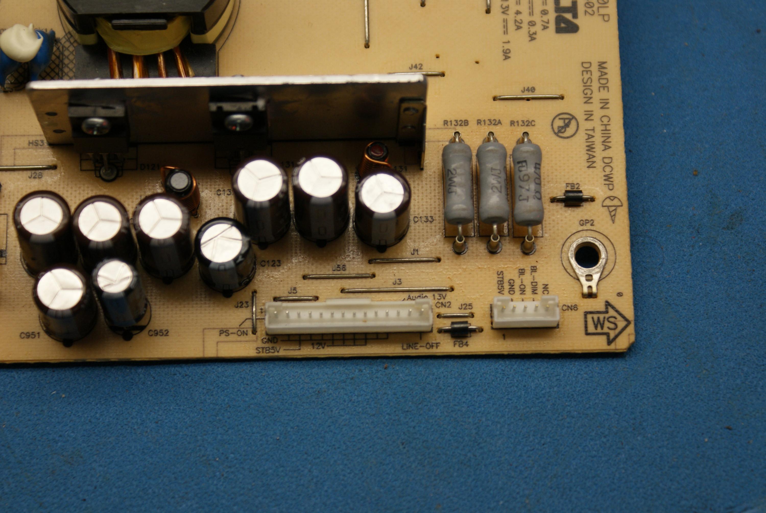

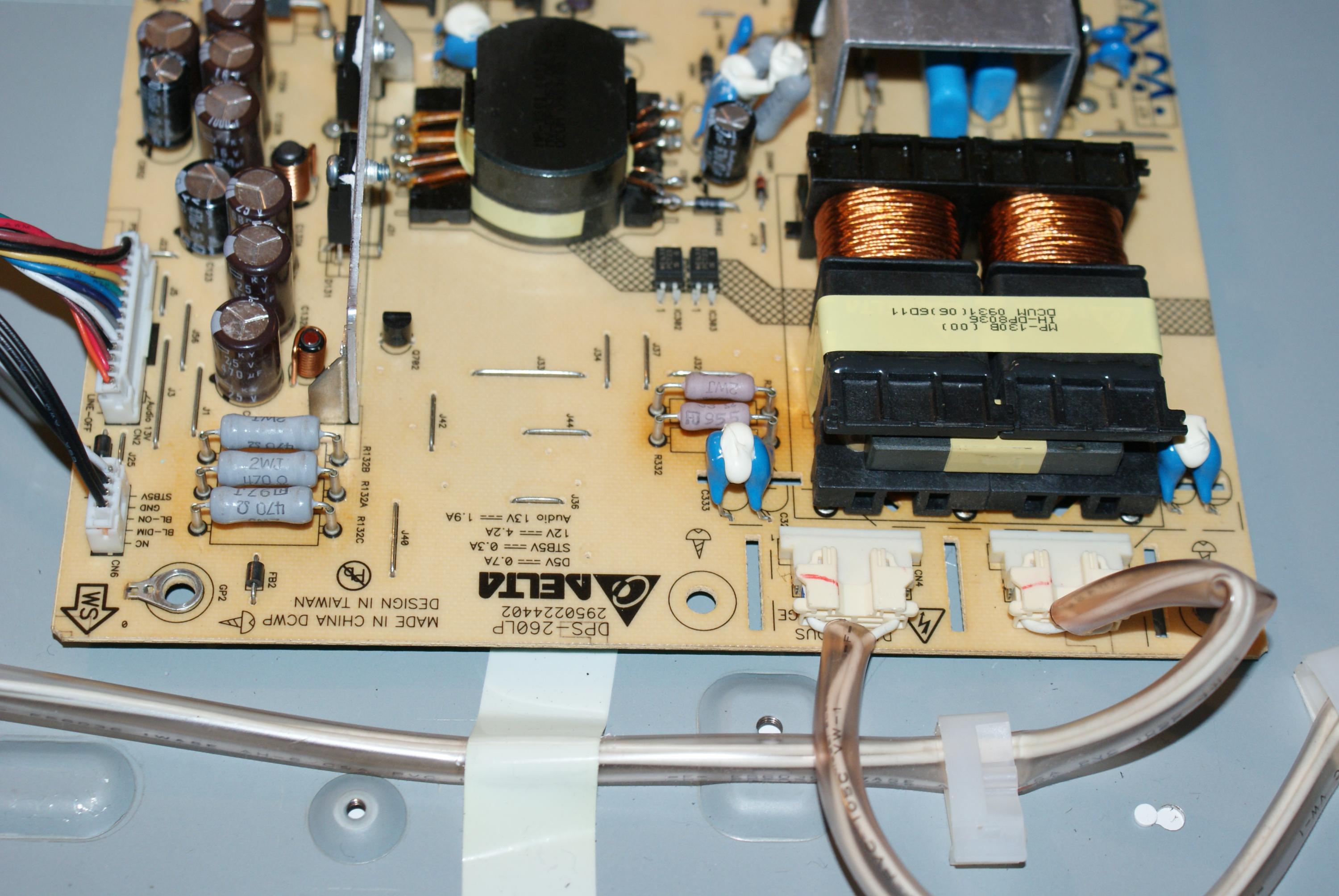

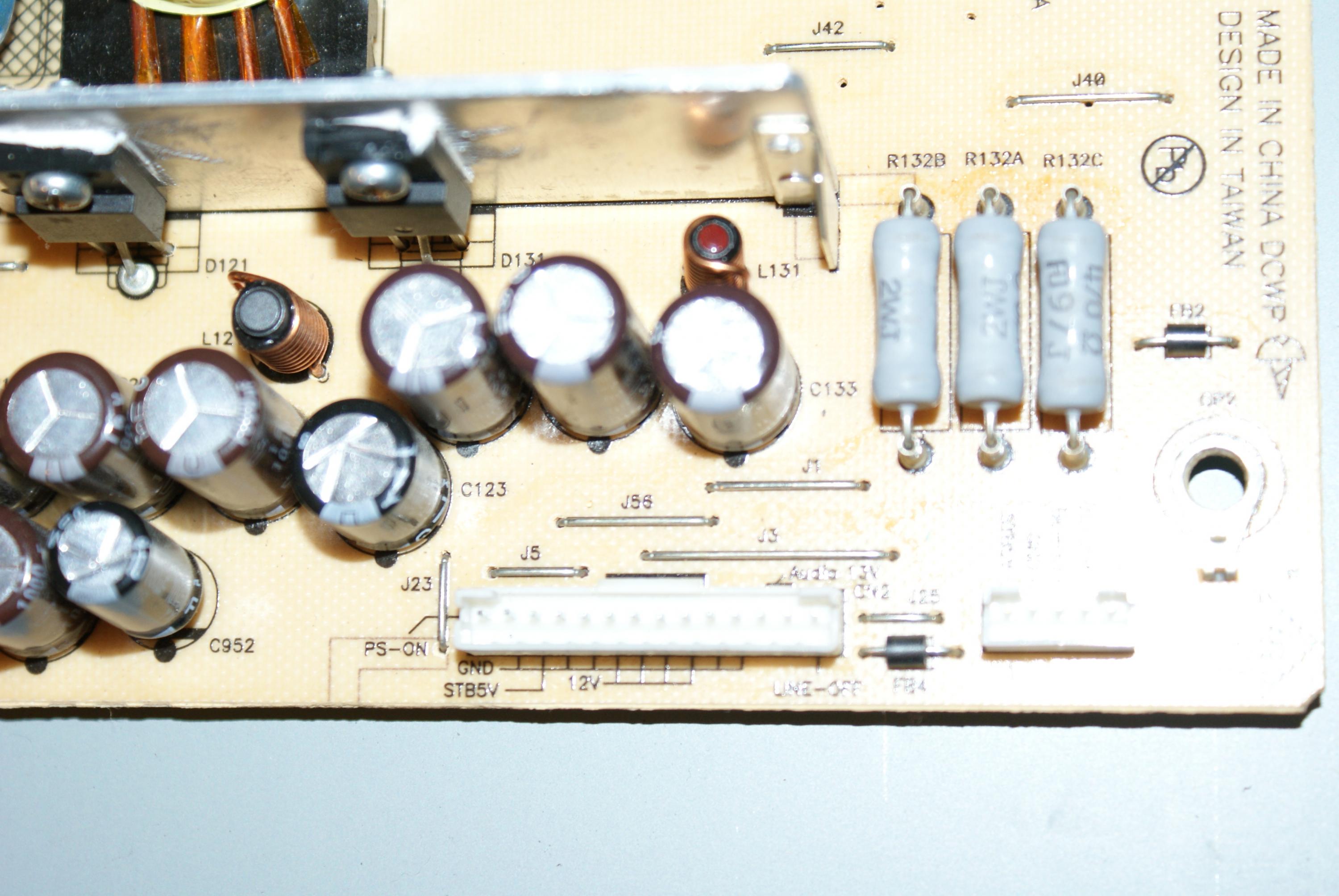

            #45
            Re: sanyo no back ligth
            Originally posted by budm
            By the way, Can I get the picture of this connector so I can clearly see the label on the pins? Right now the wires are blocking out the labels.
            ok. sorry i was busy today

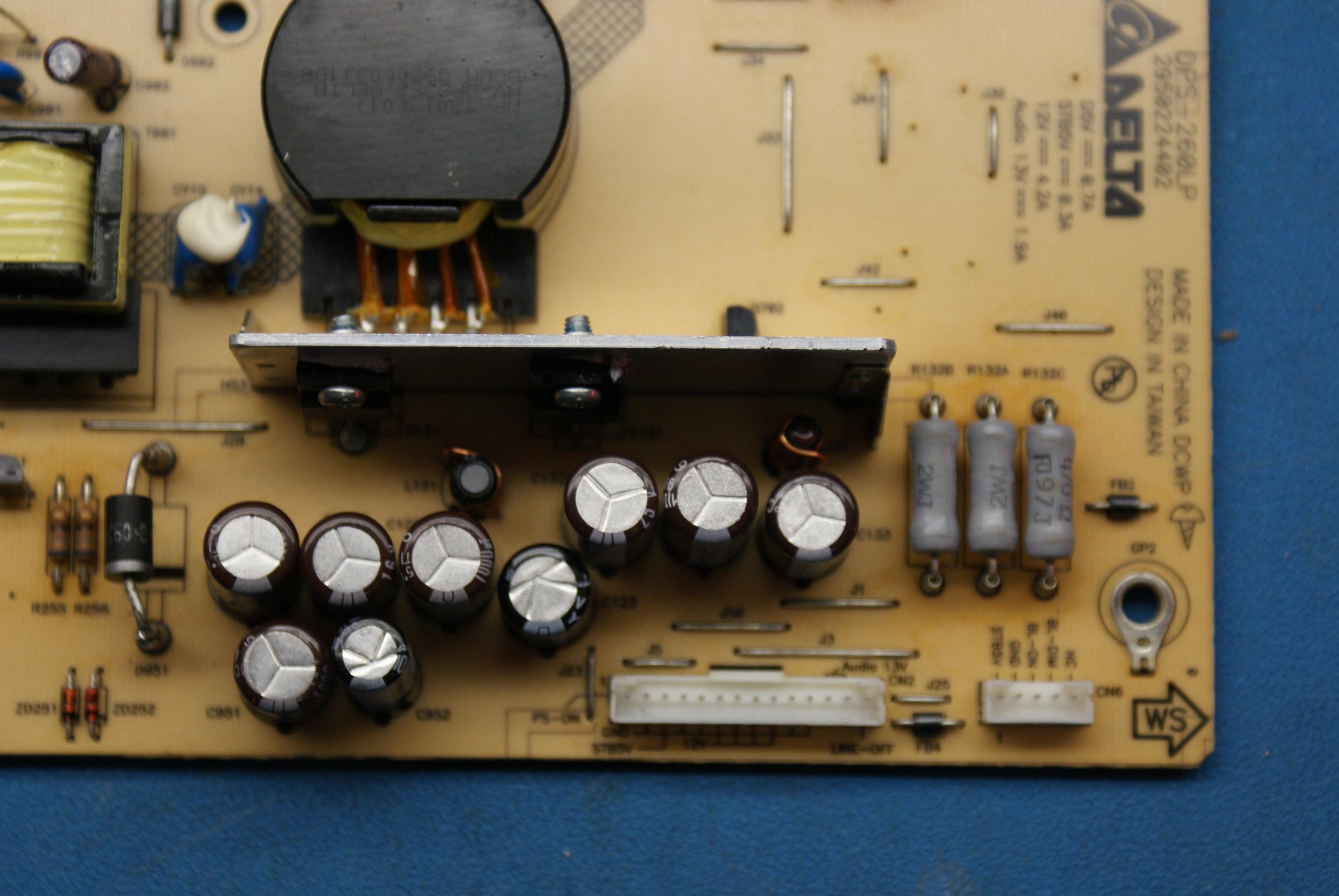

                  #48
                  can anyone help me with my sanyo dp42849
                  • MisterD
                    • Oct 2012
                    • 668
                    #49
                    Can you please move your camera around to the other side of this connector, you may have to unplug the connector so we can see the voltages printed on the board, the wires are in the way. please look at the area where the red circle is drawn around it. that's what budm is asking to see up close without the wires in the way. Thanks.

                        #51
                        is this pic. good?
                        • MisterD
                          • Oct 2012
                          • 668
                          #52
                          It's blurry but is what we need to see, can you try again to get a clearer picture of it. Thanks.
                          Looks like going from left to right.. GND, STB5V, 12V and Line Off

                                #55
                                is this one good?
                                • MisterD
                                  • Oct 2012
                                  • 668
                                  #56
                                  Originally posted by ealequi
                                  is this one good?
                                  Yes, very good. thank you. hopefully budm will be back on here to help you.

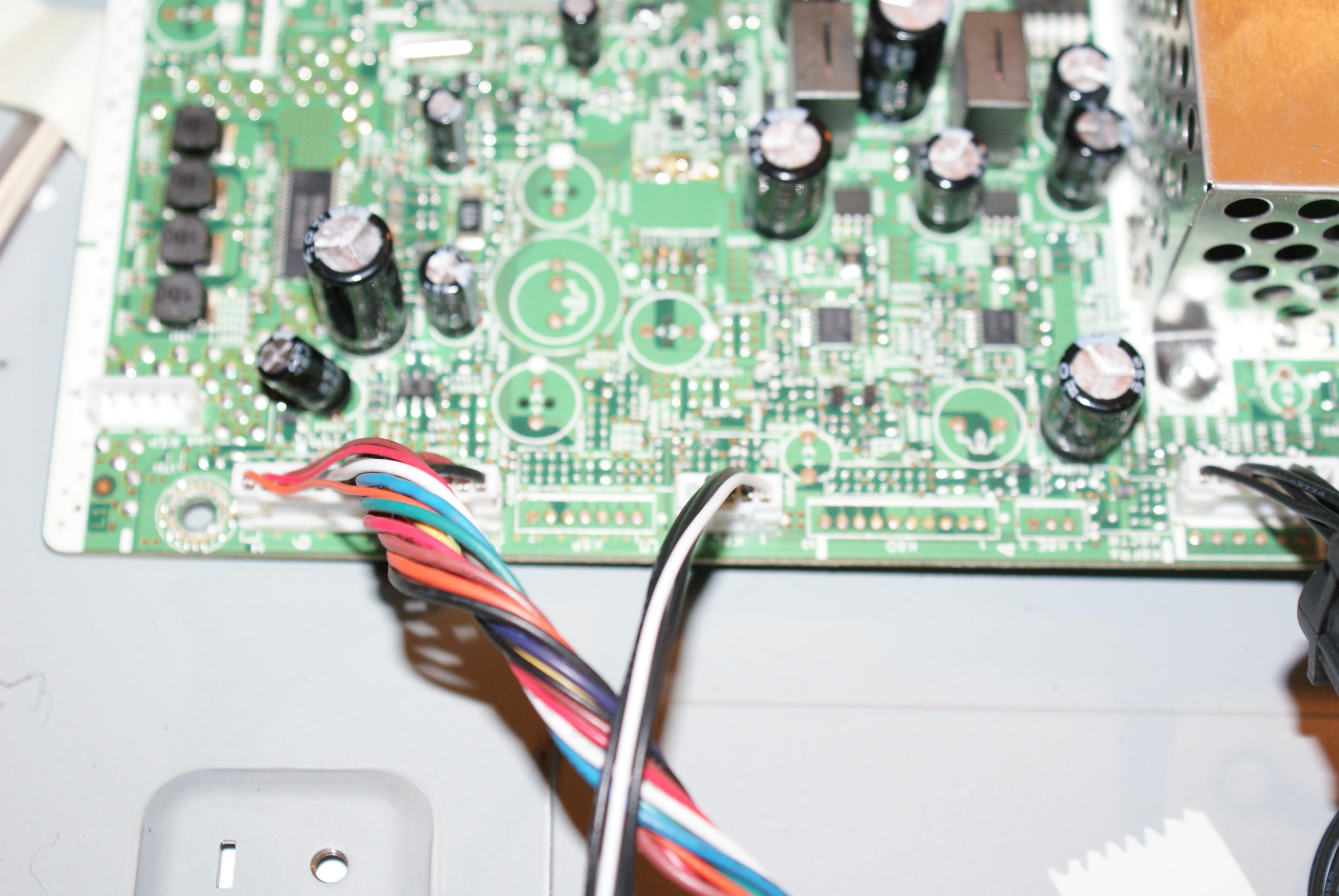

                                    #57
                                    i be here.thanks
                                    • MisterD
                                      • Oct 2012
                                      • 668

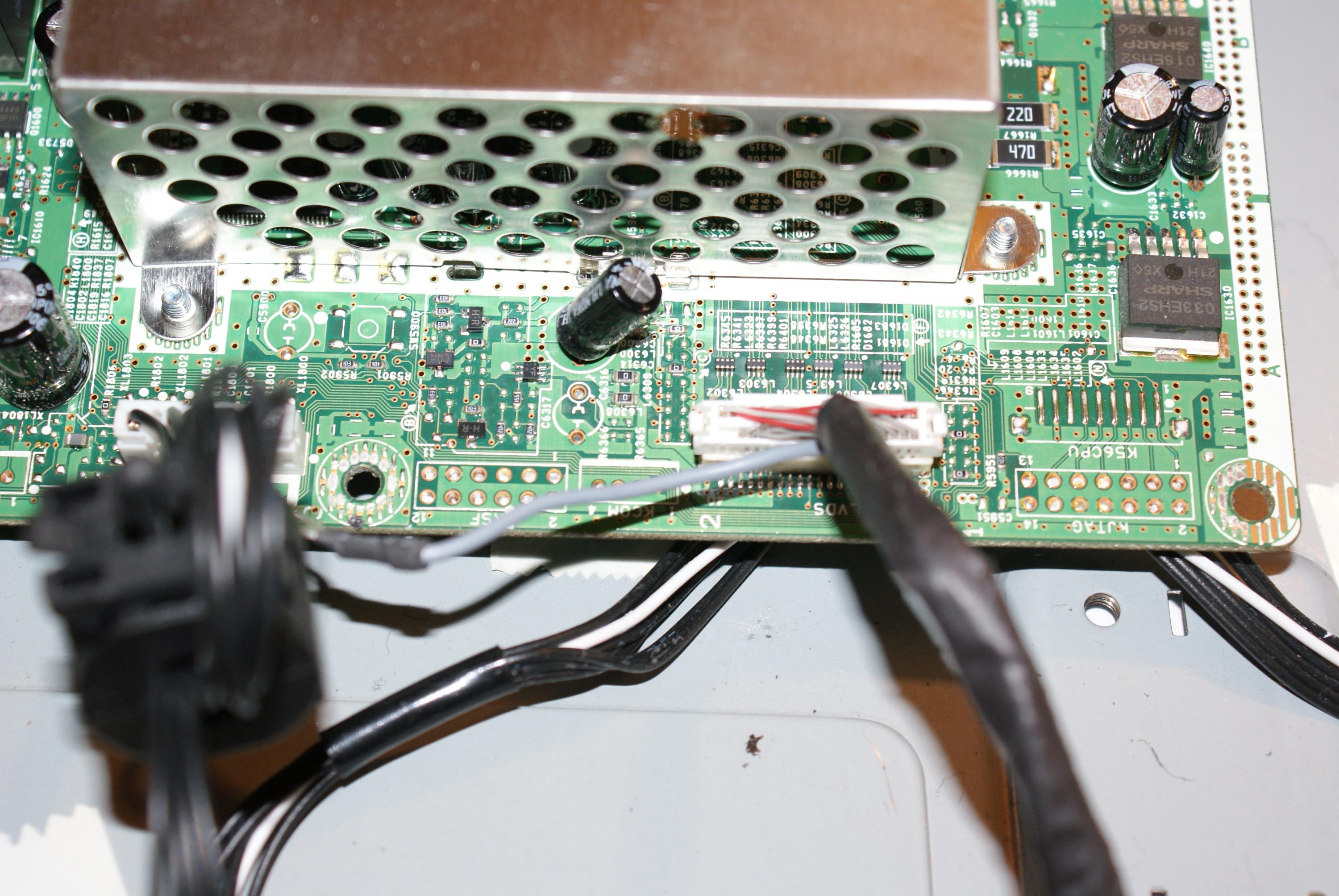

                                      #58
                                      i be here.thanks
                                      I think there's a good possibility that your Main Board is bad and not sending the correct signal to the power supply to turn on the Backlights since that voltage is too low on BL_ON only 1.3V and should be closer to 3v, but please wait for more replies to see what others think.
