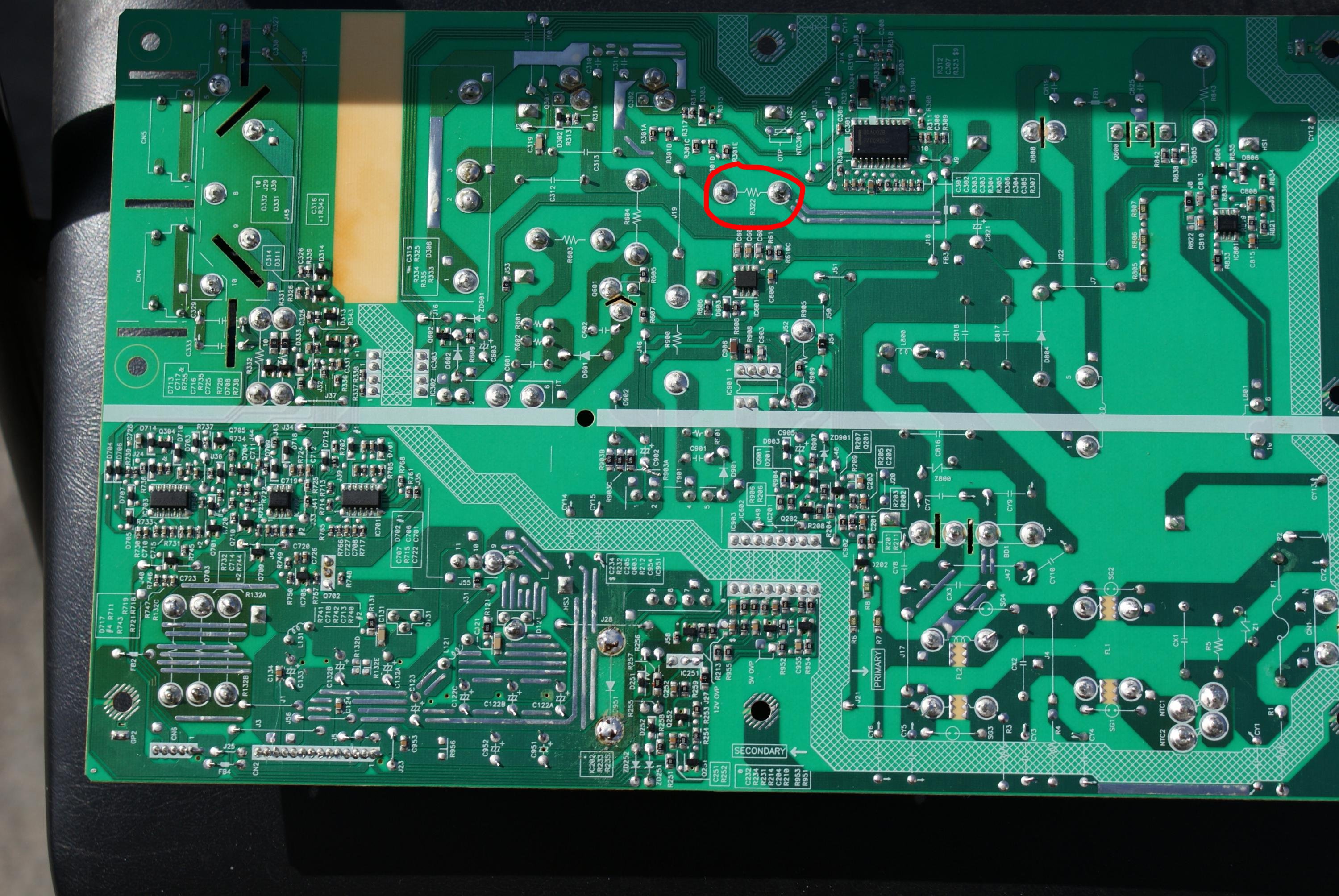

                                Originally posted by selldoor View Post
                                Pic is very good one of the best I have seen for some time.
                                If you pan along the white line in the middle to the hole
                                Just below the hole there are 3 resistors and next to them
                                C902 Just below that there is an odd bit of solder?
                                May not be doing any harm but can you check it out.
                                I agree with selldoor that looks like solder to me and not dust, it appears that someone may have been soldering something and some of the hot solder dripped there, I recommend examining the bottom of this board very close and with the power off and TV Unpugged, brush off anything that looks like that.
                                    i already did.
