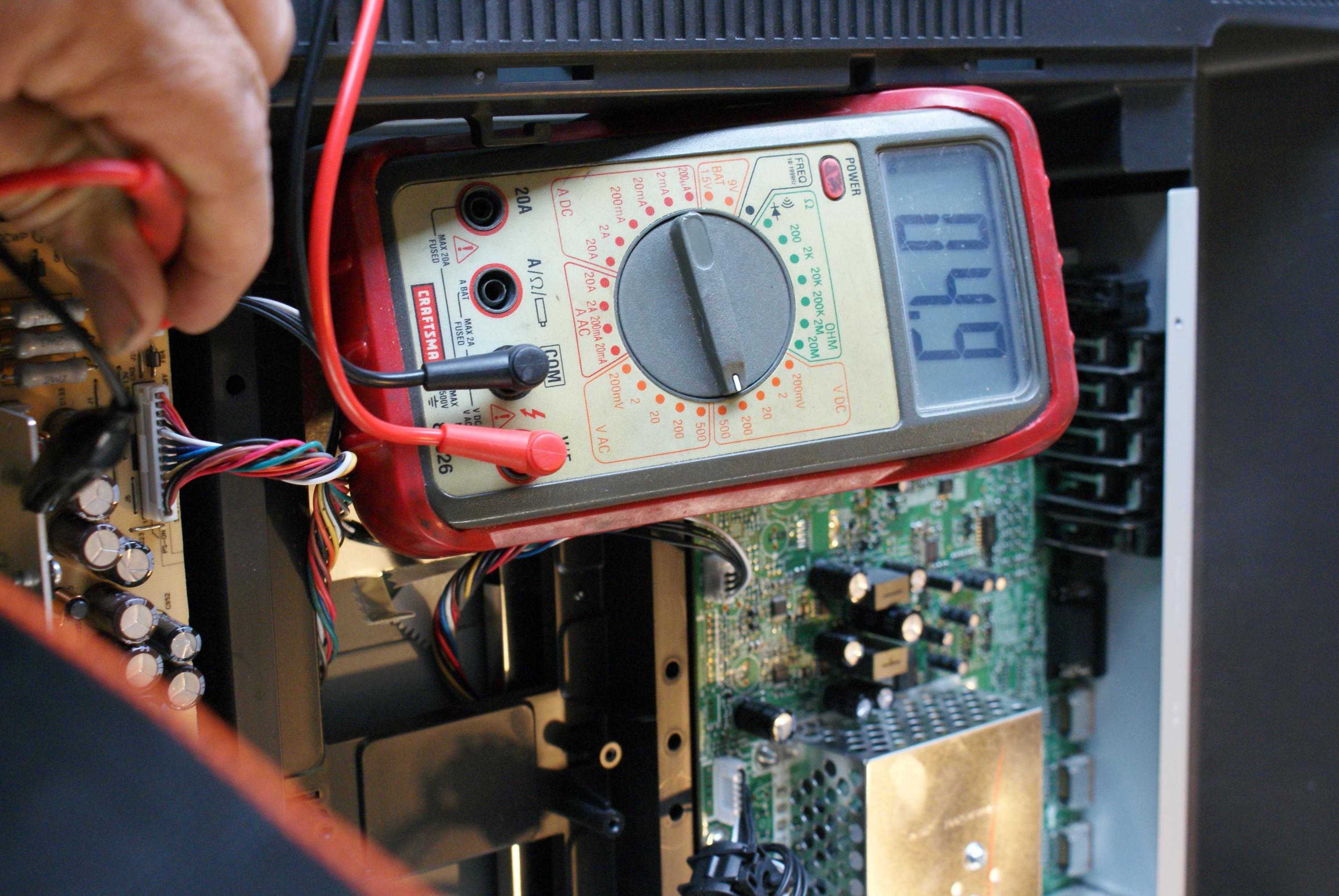

          Something is wrong with your meter if 5V measures 9.4V.
            Re: sanyo no back ligth
            Make sure you have the black negative wire hooked to the metal chassis of the TV, are the black and red wires plugged into the correct ports on the meter itself? can you post a picture of the meter with the two wires plugged in? and also show where you have the dial set? Thanks
                look that i was putting it in the wrong ground. in the black cables there was no reading

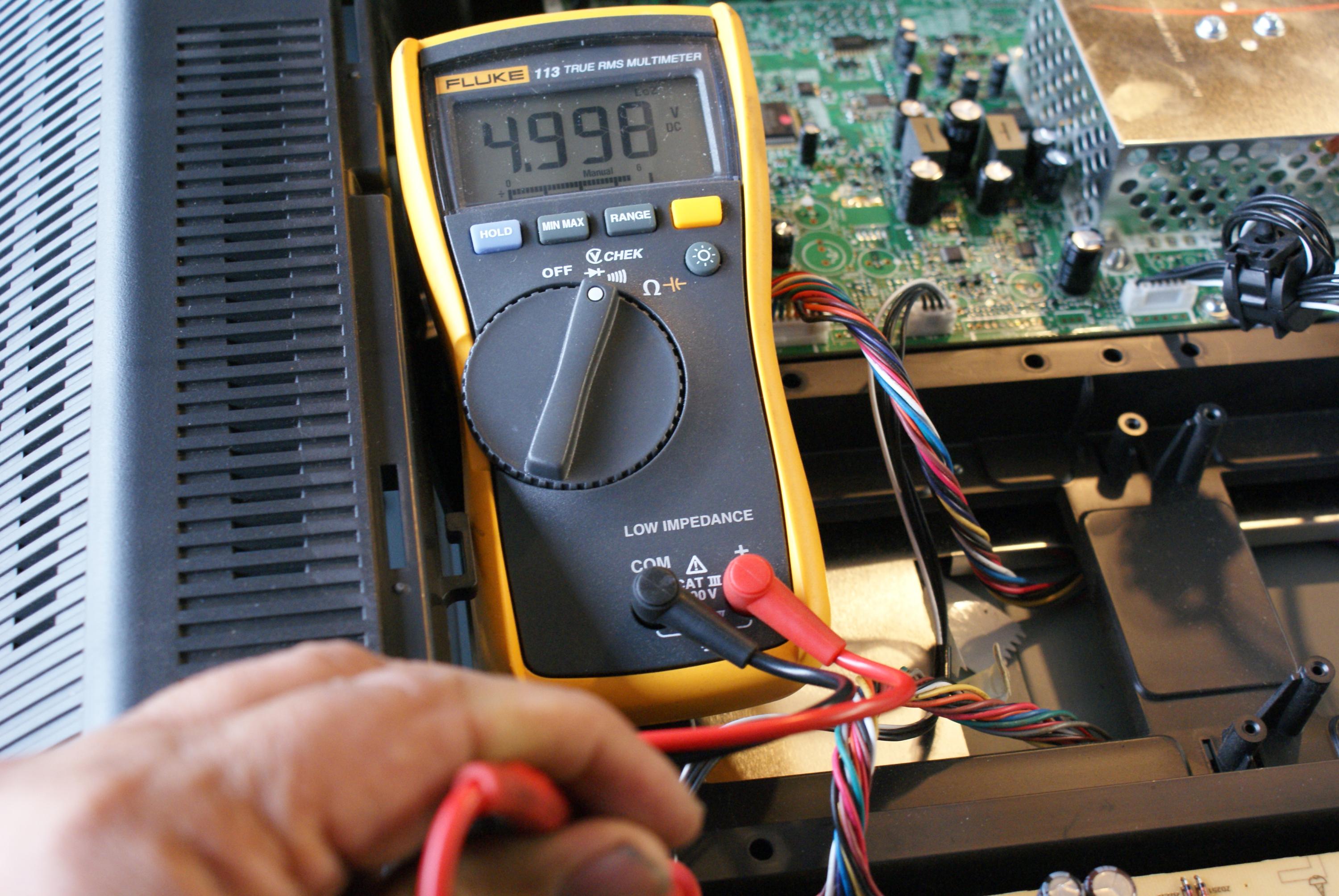

                      bl_on 1.3
                      bl_dim 3.2
                      5vstb 5.v

                          OK, suspect the inverter portion of P/S. As it is being told to turn on and brightness is set correctly.
                          There is usually a separate fuse on the combo boards.

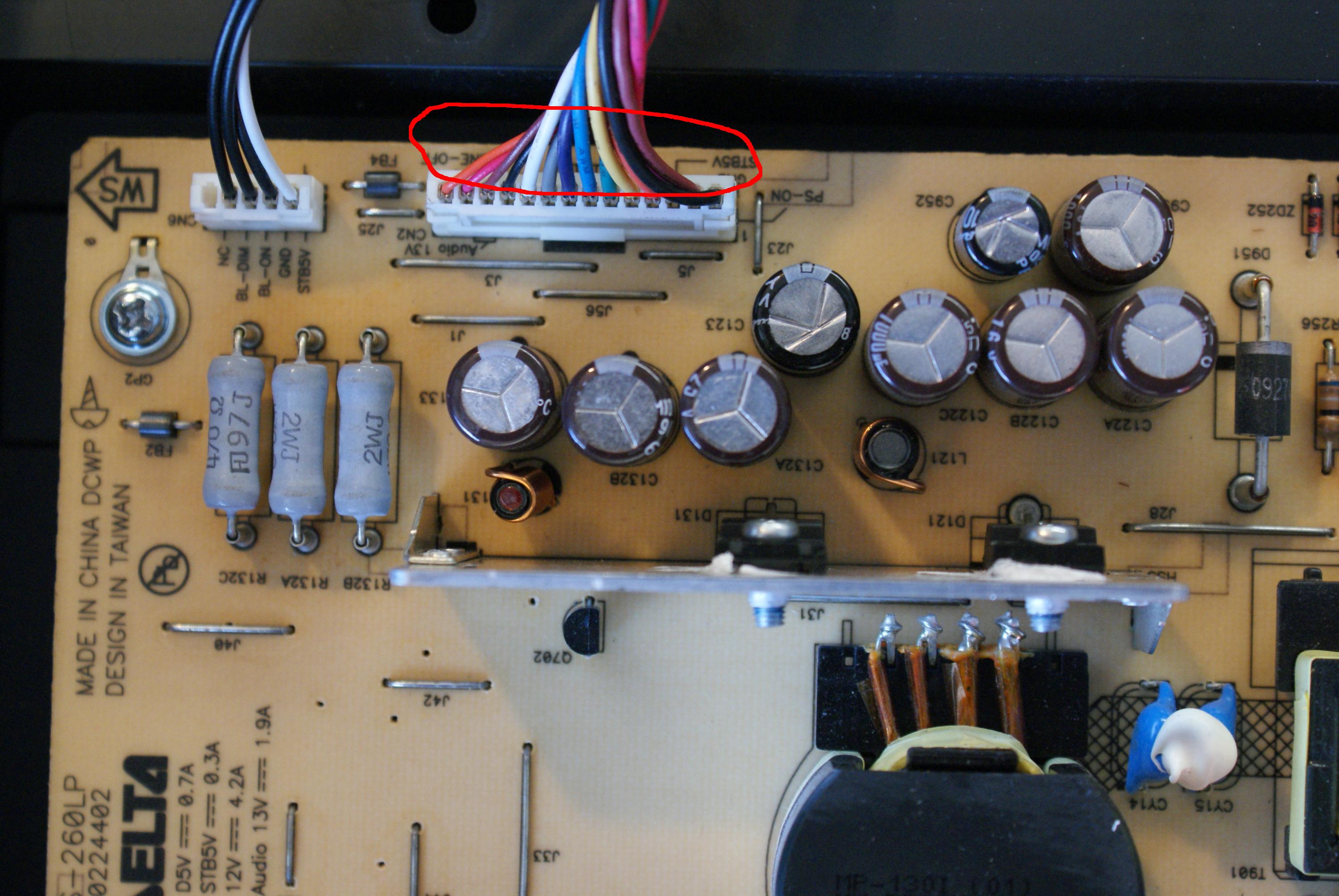

                              Can you get a picture of the whole of the bottom of the power supply, green side?

                                "bl_on = 1.3" that does not look right, I expect >2.5V.
                                  #36
                                  what that mean?
                                    #37
                                    It means the signal from the main board is too low to turn on the baclights inverter.

                                        By the way, Can I get the picture of this connector so I can clearly see the label on the pins? Right now the wires are blocking out the labels.
