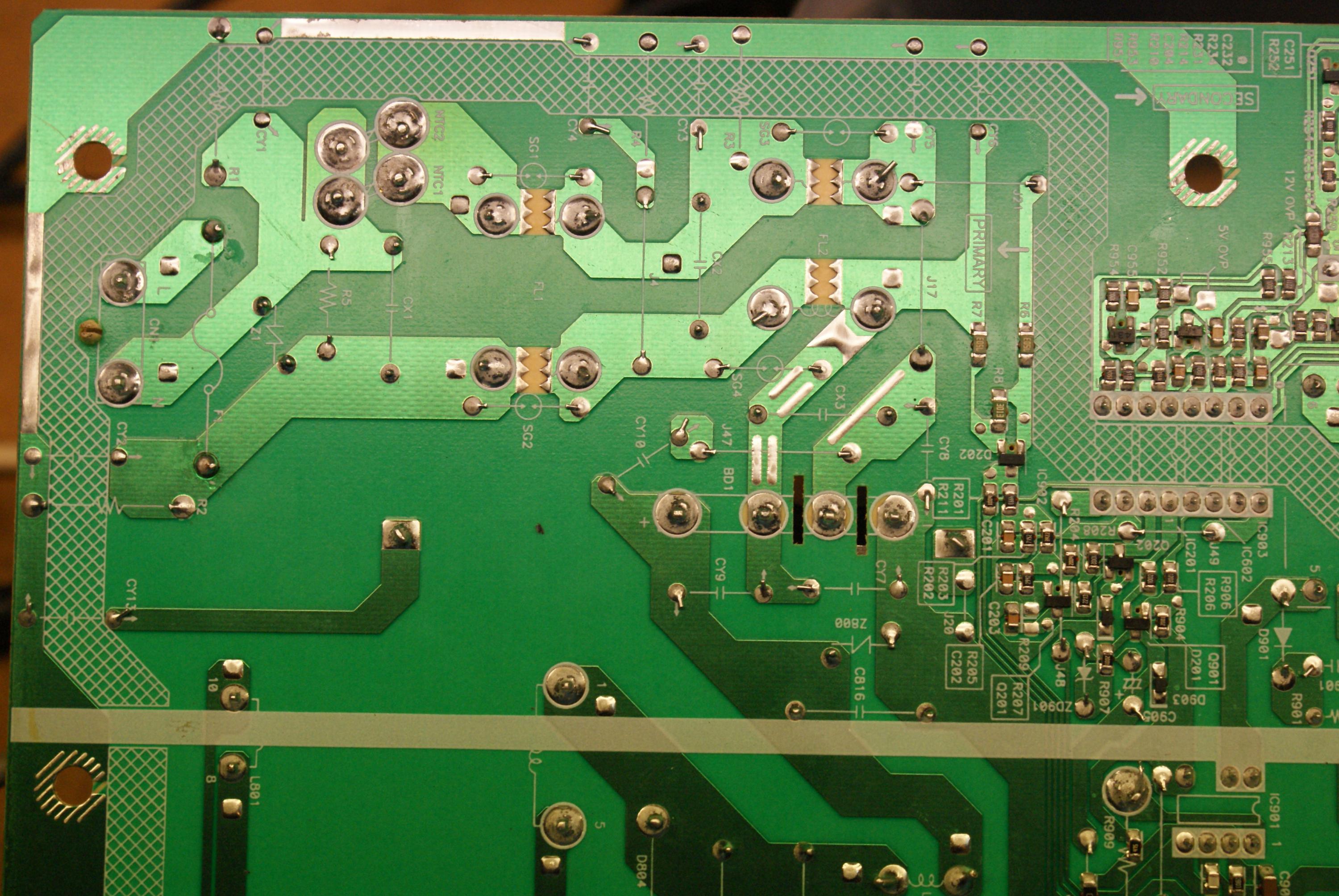

    Off topic a bit - I have a question for Budm Or Tom66. On the bottom of the board (Pic post 70) Pan along the bottom edge t the midpoint hole then up slightly there are two points marked OVP 12v and OVP 5v - OVP means Over voltage protection? but are those actual components or what? Cant see anything to correspond on the top of the board.

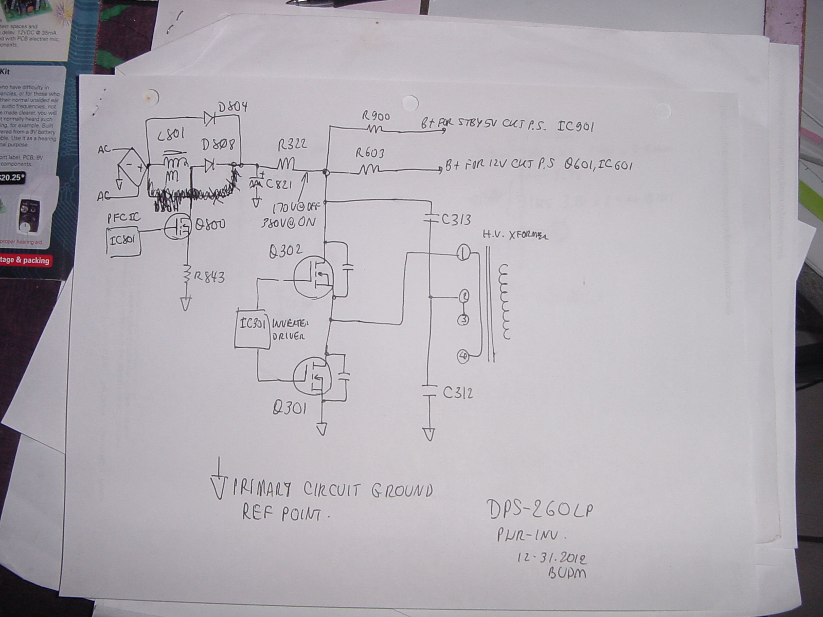

      OK. please check the fusible resistor R322 that feed the B+ to the inverter transformer driving circuit.
      You may as well check the other two fusible resistors at R332 .

                      Yes, he tested R322 which is the main fusible resistor in this instance.
                      The fault is probably on the IC which drives the MOSFETs.

                        By the way the BL_ON at 1.7V is OK, I look at the circuit, it is fed by the 3.3V power supply for the switched transistor Q1805 of the main board. So you can splice the BL_ON wire back together and make sure to remove the 1K resistor from CN6.
                        The power supply board uses PFC Voltage booster, so he needs to check the voltage on th capacitor C821, it should have 170VDC when TV is off and about 380~390VDC when V is ON.

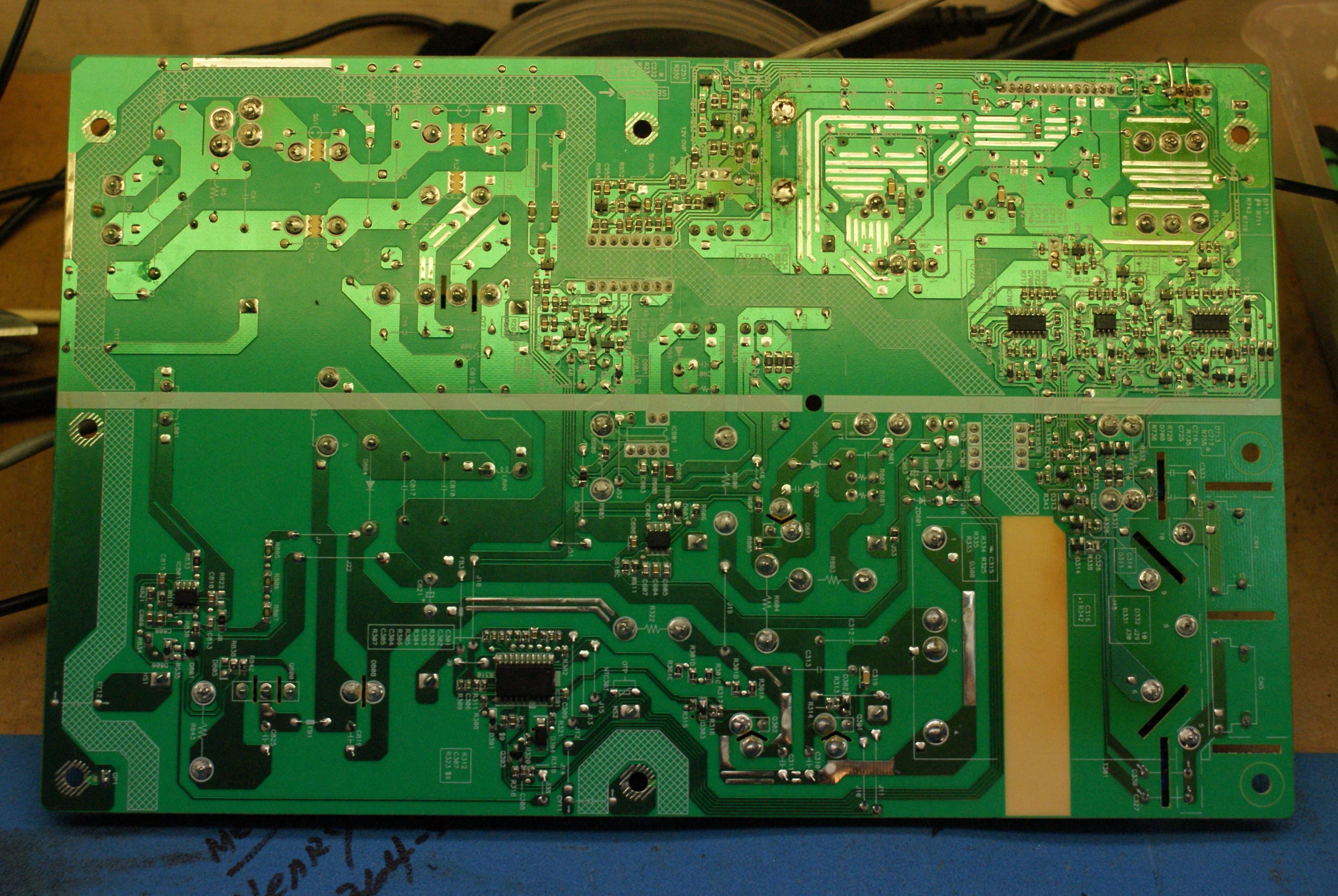

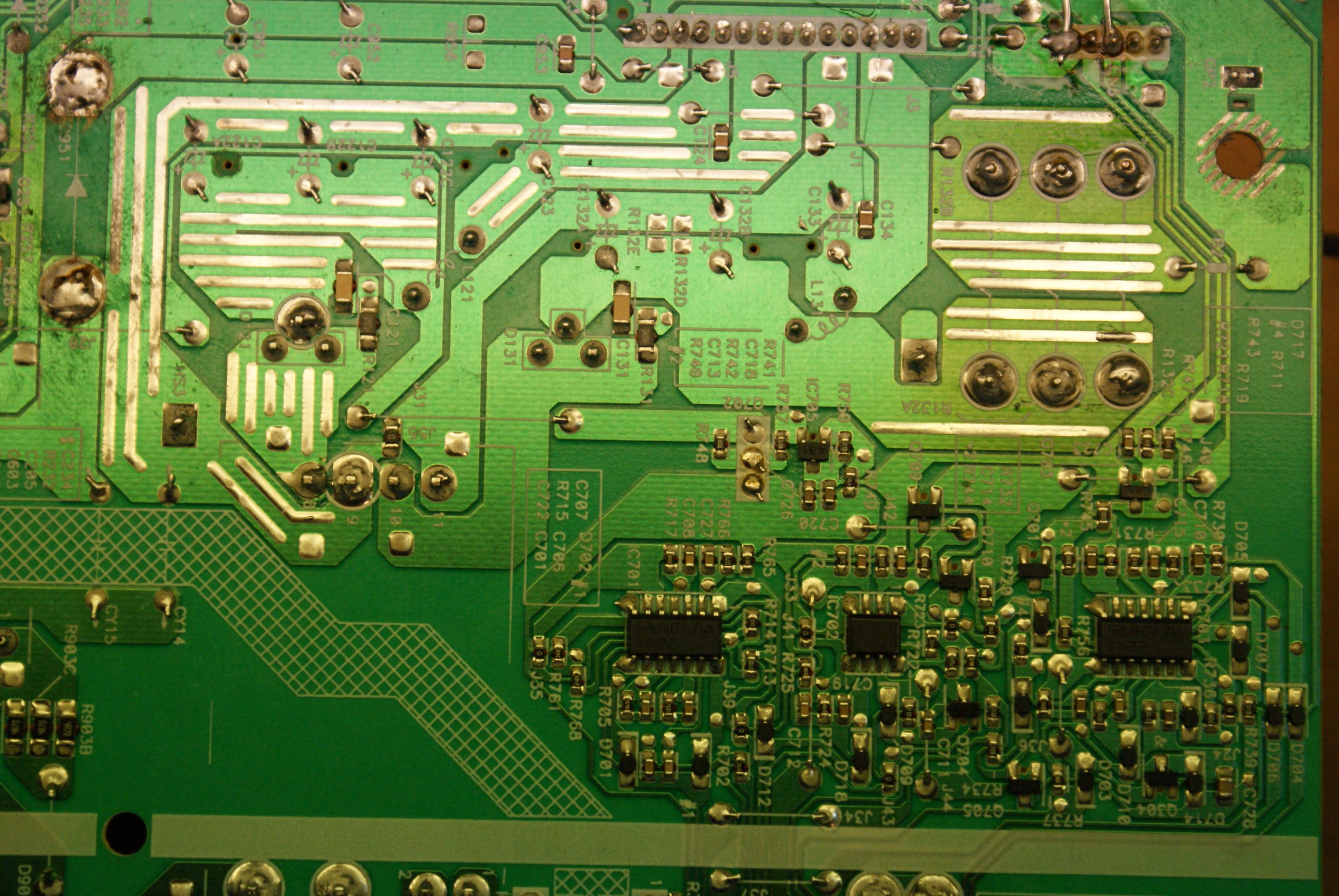

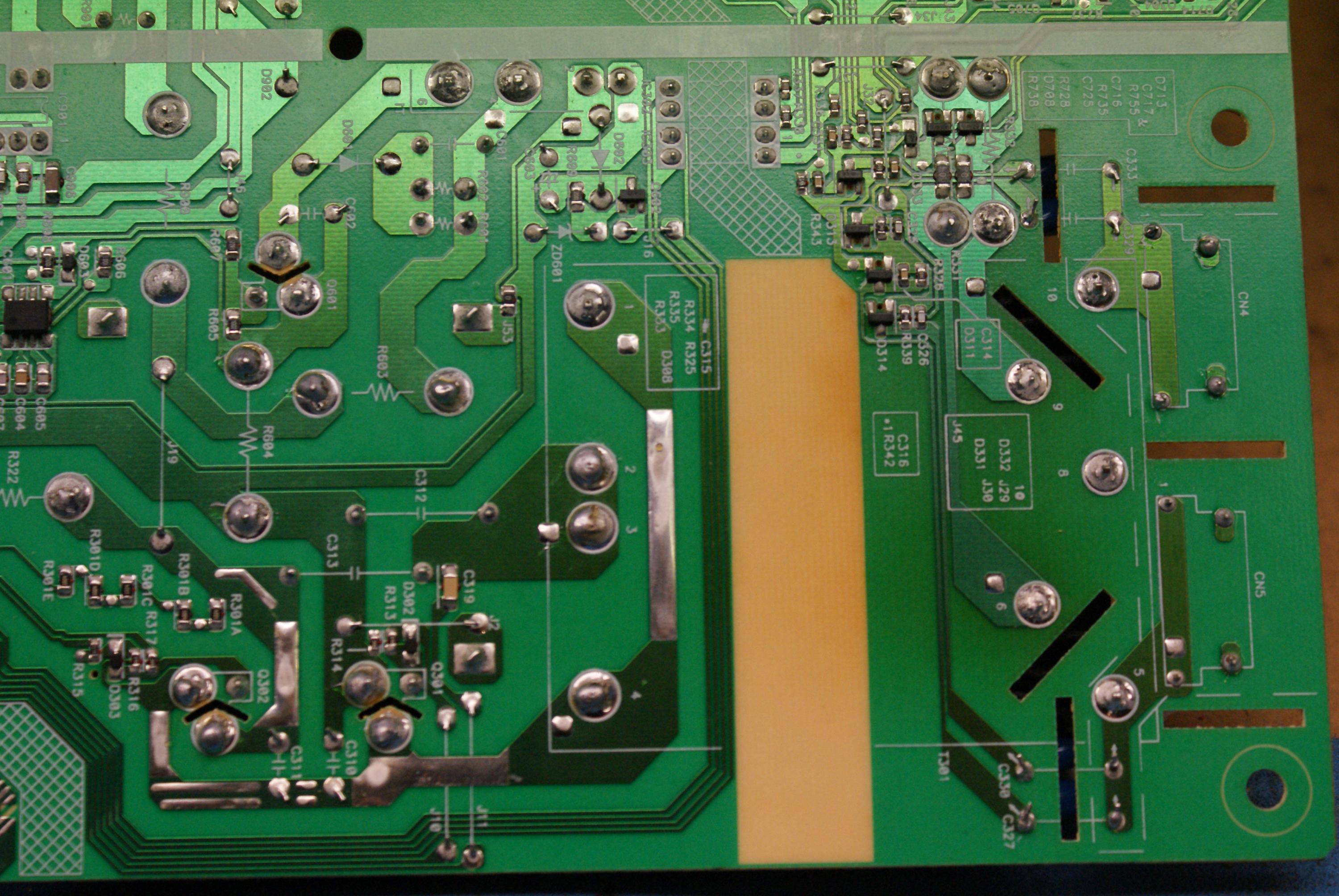

                            Please take more pictures.
                              Re: sanyo no back ligth
                              see post 140

                                R322 was tested at 3 ohms. Given the lead resistance from a typical DMM, that seems like a good fusible resistor.
                                  I wasnt sure about the soldering on that resistor - How about a voltage reading at both ends ?
                                    I trace out the board, R322 is the main fusible resistor that feeds other fusible resistor for the 5V SMPS, and also the 12v SMPS circuits, so it must be OK.

                                      Per diagram and look at the bottom of your board, check C312.
