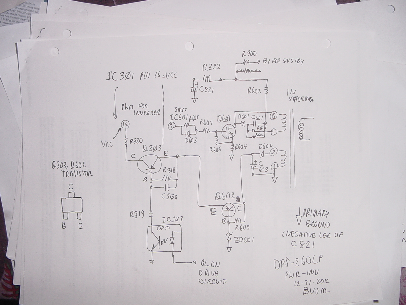

    OK, the last set of pictures, some are really good, some are kind of dark and yellowish/greenish pictures.
    But I am able to trace out how the PWM IC for the backlights inverter gets its power from.
    It is generated by the AUX winding of the 12v power supply. the output is fed through first voltage regulator circuits (Q602, Zener Diode ZD601), the output of the regulator then is fed to the switched transistor Q303 which is turn on by the OPTO IC 303 when the BL_ON (BL-SW) is applied.
    So we need to find out if we are getting the VCC on pin 16 of the PWM IC301.
    We still need the P/N of those IC's.
    You will need to find the way to measure the voltages.
    Make sure to use the negative leg of C821 as your GROUND REF.
    Check ZD601, Q602, Q303, R320.

            hey i am here. i am testing it. for me it take forever, want to make sure i dont mess something else. i will give you the result withing minute.

              This is very strange. none of the one you ask me to test has power pin 16 on ic301, zd601,q303, r320,q602. i check the meter in other resistant and it is working.

                  "This is very strange. none of the one you ask me to test has power pin 16 on ic301, zd601,q303, r320,q602. i check the meter in other resistant and it is working." I do not understand this statement. I want resistance reading, especially the Zener diode and the transistors to make sure they are not shorted out first, if they are bad , then the voltage reading will be next. Step by step.
                  And the parts are on the bottom side of the board plus they are also on the hot (deadly side of the circuits, must be real careful) you will have to have the board power up with the lamps connected just in case the inverter circuits kick on, you do want high voltage arcing.
                  "it is working" what is working?

                    Okay, Did you hook the negative probe of your volt meter to the negative lead of the Capacitor C821 on the power supply board? it must be hooked here for the ground connection otherwise it will not give you any voltages, and please leave it there for checking these voltages bud has asked for? these are DC Voltages not resistance. Then you will remove the negative probe from C821 and make sure the power is off then check resistance of the other components as you normally would.

                              And by the way, what are the IC P/N I request so we will know what operating voltage on pin 16 should be (now I assume that the line I trace from the pictures is correct)

                                ok this is what i got zd601 =.6, pin 16 on IC 301 with ground on c821 = beep but not reading, Q602=.6, Q303=.6 on e, 1.7 on b, R603 and R320 beep but not reading. Nothing, not even beep on C809,C808,R805,R806,R807

                                  OK take the DC voltage reading next. With TV plugged in and power switch activated.

                                        All those solder pads for the SMD Zener, transistors, resistors are on the bottom side of the board, you cannot access them from the top side of the board.
