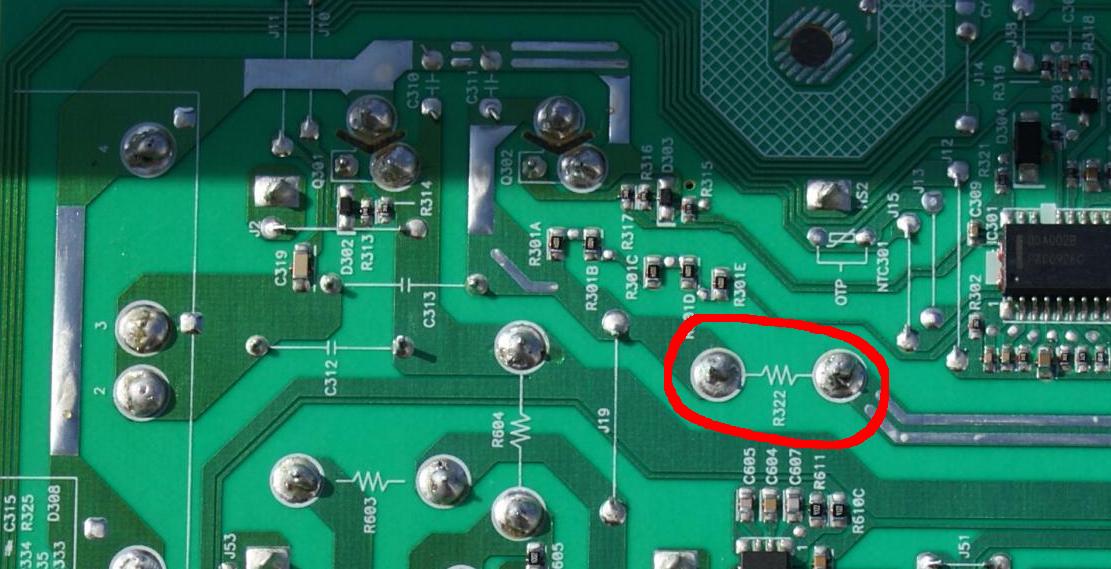

                              Well at this point we have verify that the backlights are not working not due to the main board problem but due to your bad power supply/inverter combo board problem or due to bad lamps.
                              We do not have the diagram to troubleshoot down to component level, but I want to make sure that you DID NOT EVEN SEE THE SCREEN FLASH for seconds? The problem is now down to either bad board or bad lamps, with one or two bad lamps I will expect to see the screen lights up for seconds then shutdown if the inverter board is OK, but if the inverter board is bad it may not even try to light up the screen at all, this is where you have to make the decision if you will want to try ordering the new power supply-inverter board to find out if it will fix the problem or not.

                                          OK. please check the fusible resistor R322 that feed the B+ to the inverter transformer driving circuit.
