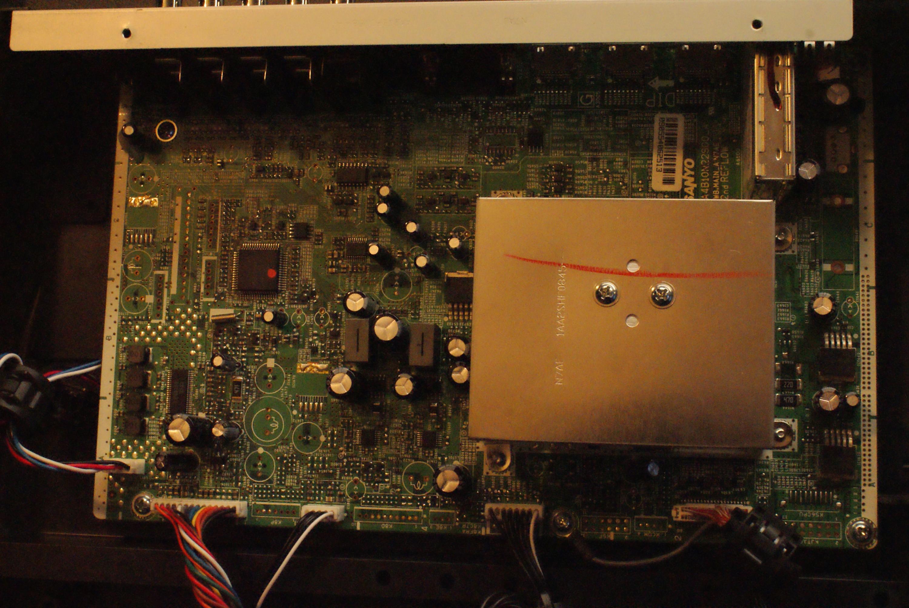

    I have a sanyo dp42647 when i turn it on there is a black screen with sound. If i put a flashligth close to the screen i can see the video. Any idea?
  • Pentium4
    CapXon Be Gone
    • Sep 2011
    • 3741
    Re: sanyo no back ligth
    It's 100 times easier if you post close up clear pictures of all the boards and have a multimeter ready for troubleshooting

                sorry. this is the main board, not the red one
                • MisterD
                  • Oct 2012
                  • 668

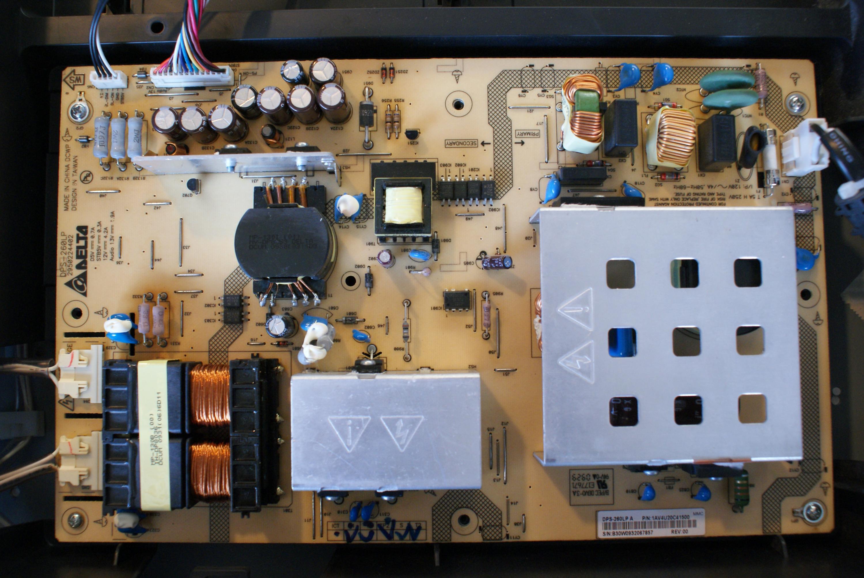

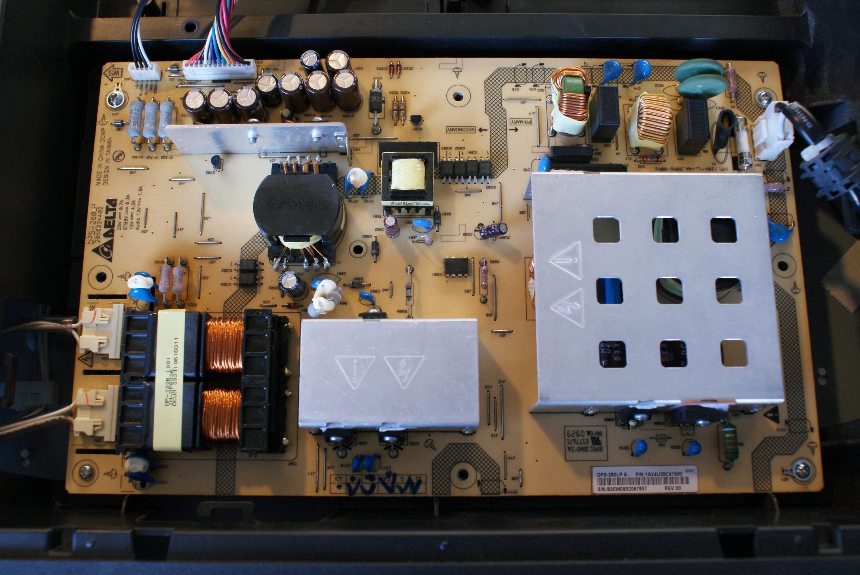

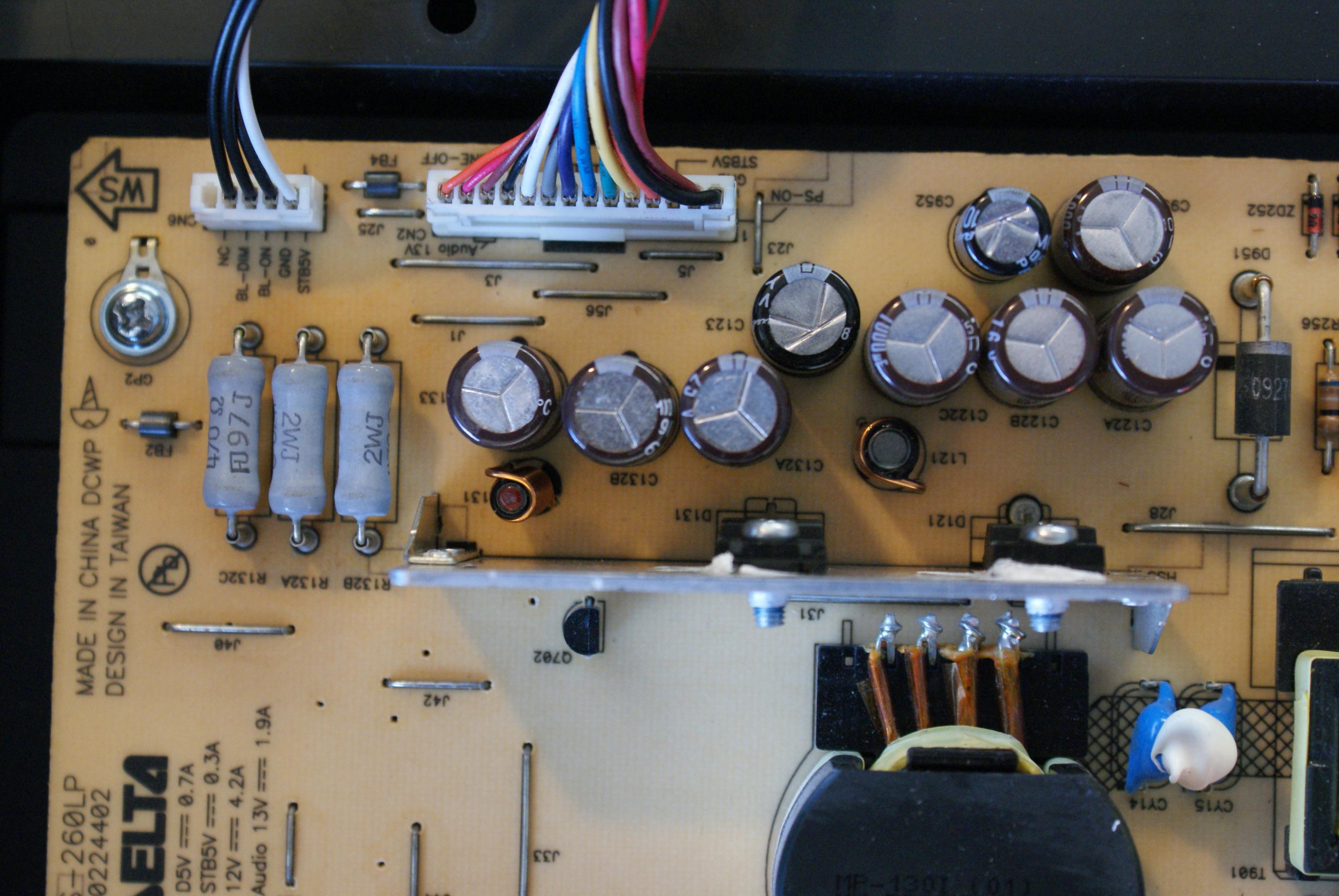

                  I suggest that you post the Model Number and also take some closeup pictures of the white connectors on the power supply board and be sure that the picture shows the markings on the circuit board at the connector that tells us which pin is which, usually the markings are Stby, PSON, BL_ON, 3.3V, 5V, 12V, 24V.

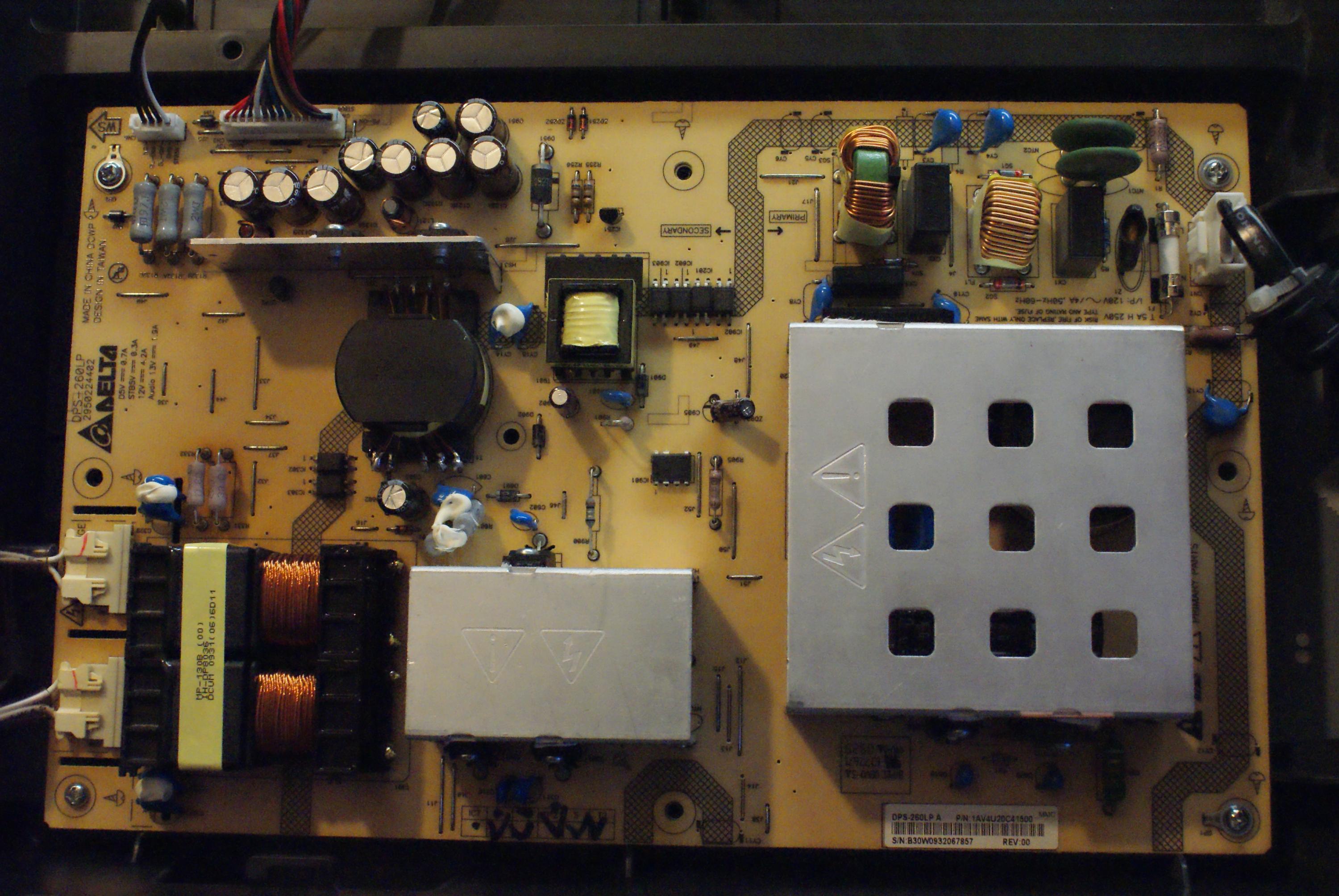

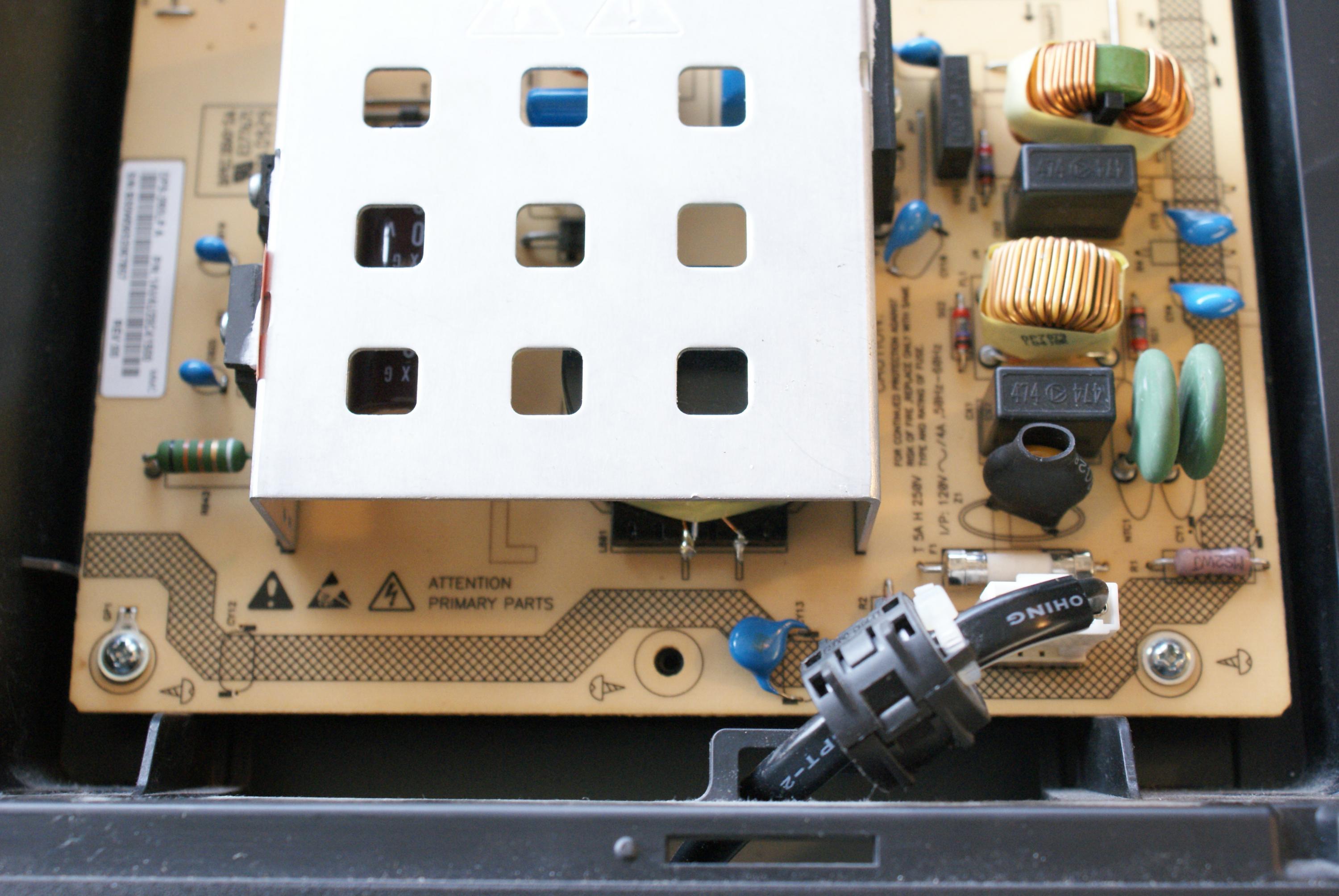

                    Also post a good focused photo of the bottom of your power board.

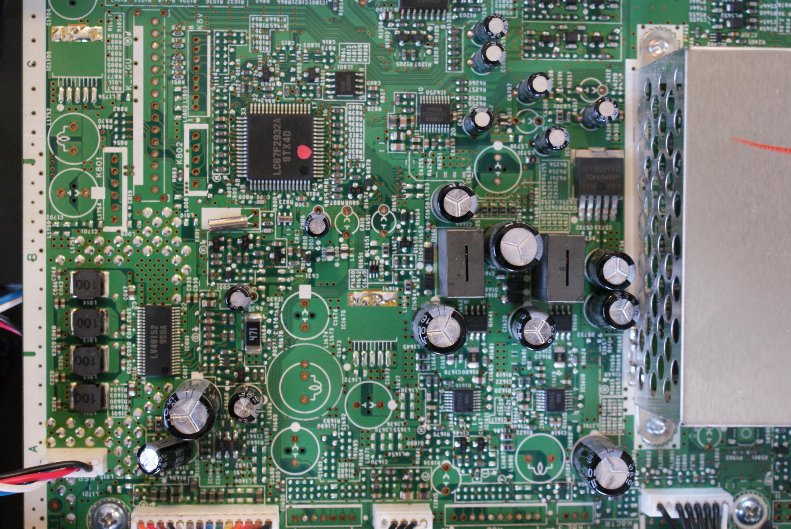

                        Ok this are the new picture for the sanyo DP42647
                        • ealequi
                          • Dec 2012
                          • 212
                          • usa

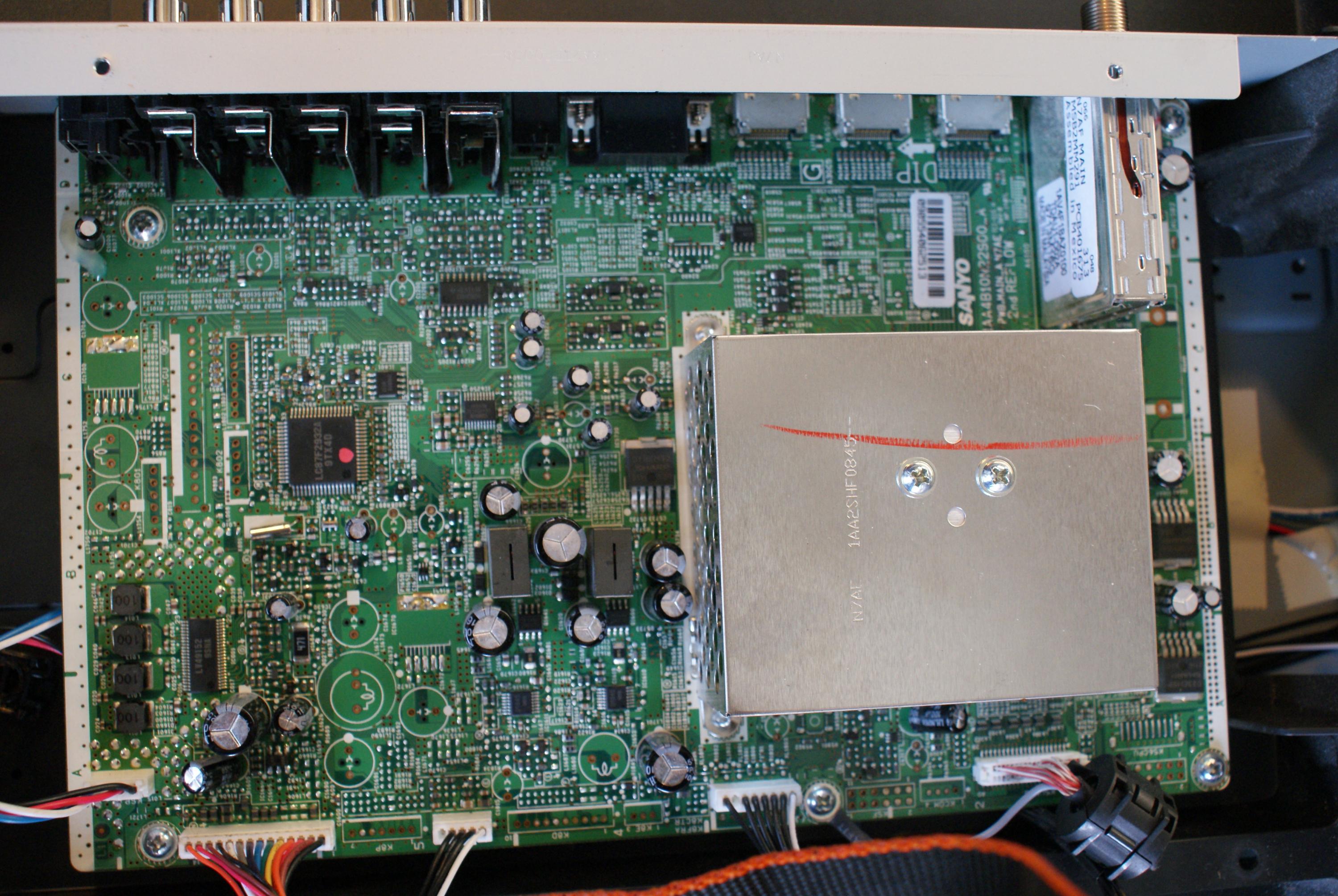

                          • jetadm123
                            • 2169
                            Need a photo of the bottom of the power board.

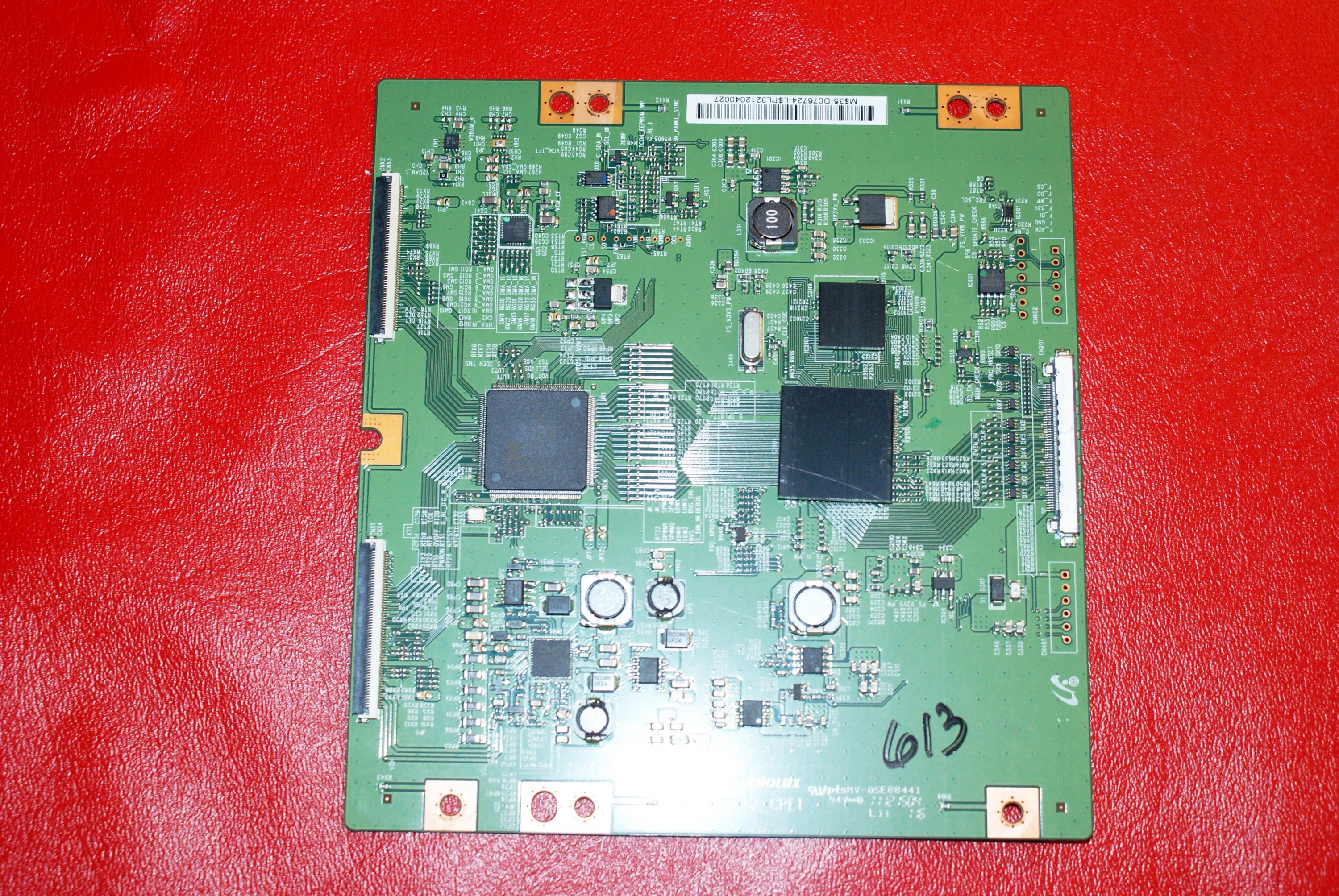

                                  • ealequi
                                    • Dec 2012
                                    • 212
                                    • usa
                                    No. this has no inverter board. just the t-con board
                                      with the tv powered on, check the voltage on the small white connector that has the 3 black and 1 white wire, it's near the edge of the power supply board, I see it is labeled BL_ON, hook a volt meter with the black probe to chassis ground and use the red probe at the connector making sure it touches the metal part where the wire goes in, set your meter to DC Volts, report the voltage reading back here.
