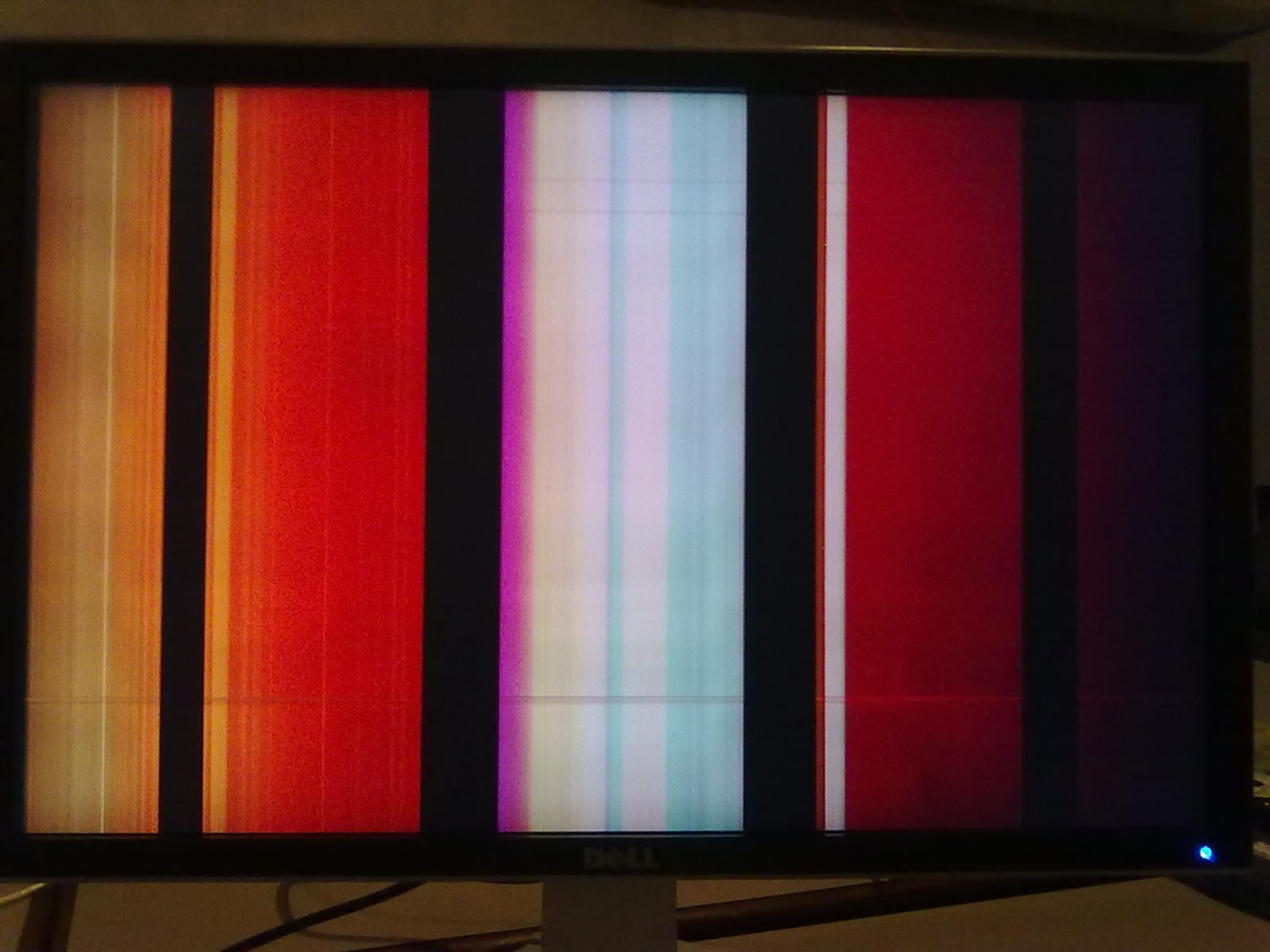

    Got a Dell 3007WFP with a broken screen not sure if anything else was wrong with it. Placed another lcd in it and this is what I got, any suggestions?

    If its not the screen itself, then the t-con is likely bad.
    However, bad capacitors or corrupted EEPROM on the mainboard could cause this too, but rarely.

      Re: Dell 3007WFP Crazy Picture
      Was the new screen from another Dell 3007WFP or from something else? If from something else, it just may not be compatible even if the connector on the t-con fits.

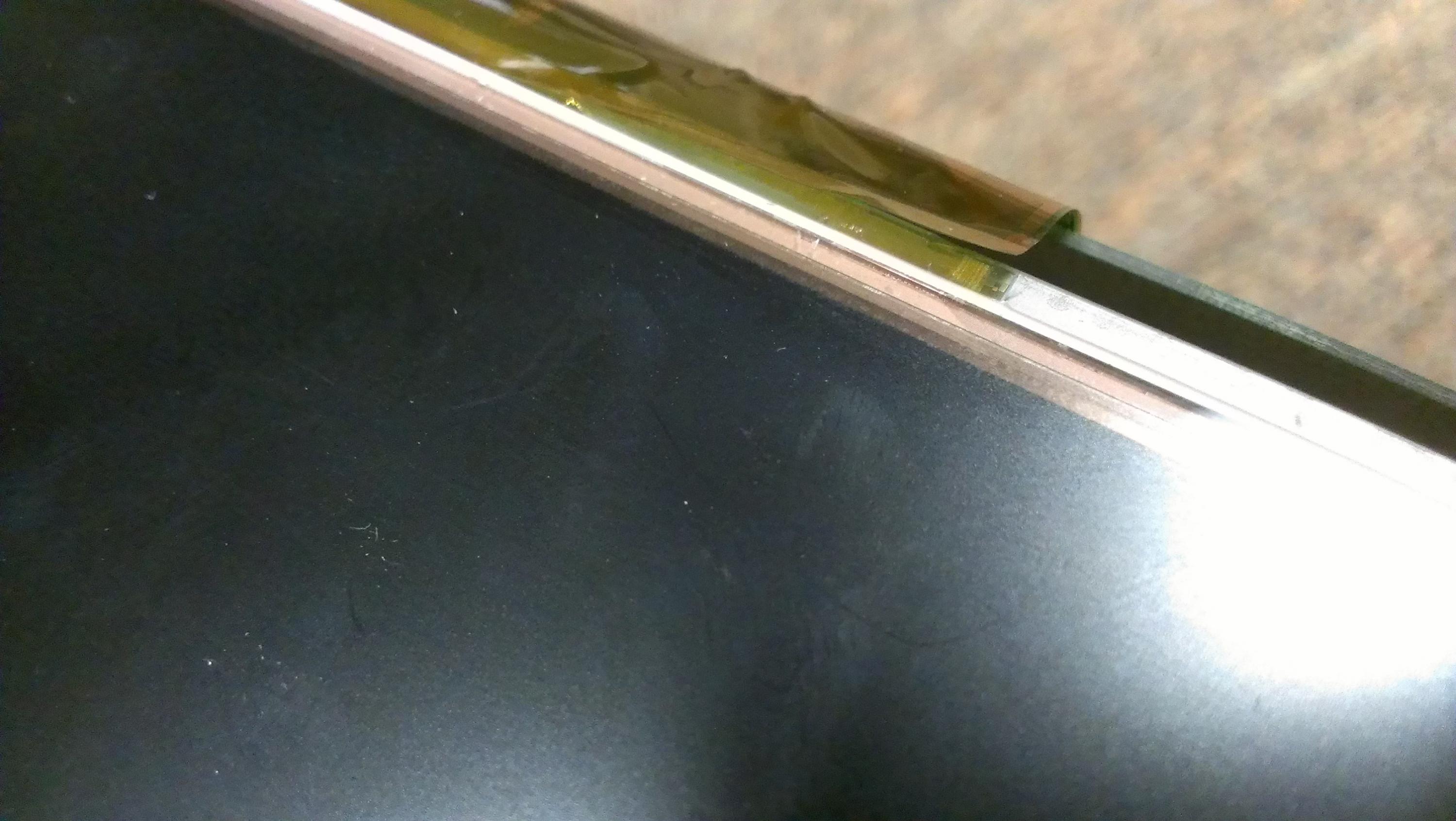

        Ok can someone tell me if this could be the reason for the picture displayed above.

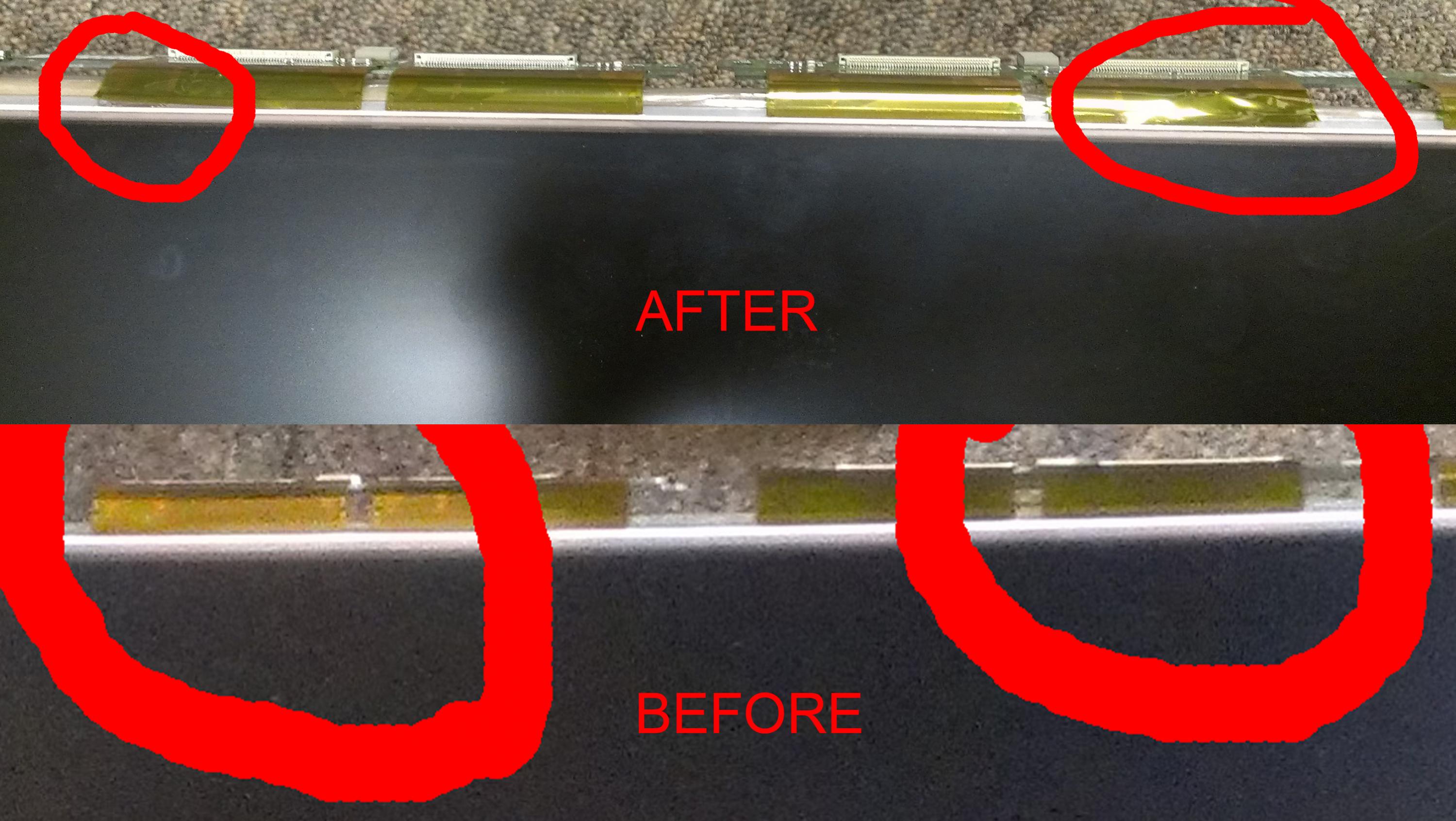

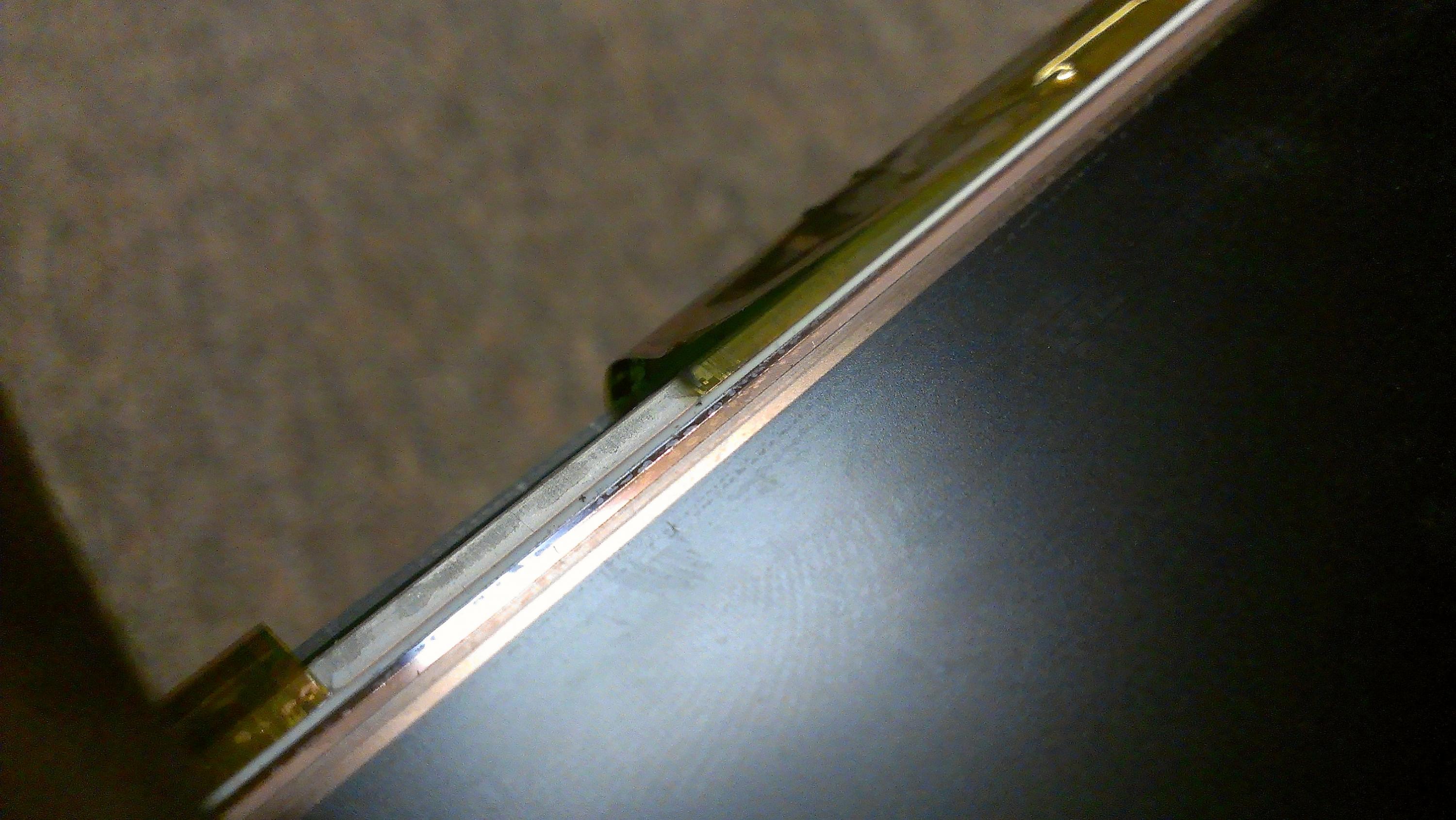

          The bonding between the flexible circuit board and the LCD panel is lifted! Not sure if you can press it back down and make it stay down. That will make Vertical lines on the screen.
            Yep, that is definitely a problem!
              Thanks bud and ben for your input. The before picture is the way the screen look when my company sold it. Our customer is returning the screen because they are getting the picture that's shown on the screen at the top of this post. When they returned it the after pictures show it's condition. With the finger prints that are clearly shown on the screen and the positioning showing directly over the 2 problem areas we are guessing that the installer damaged the flex boards during installation. The customer said he had a professional come out and he told him the screen had bad chips??? Shouldn't he have noticed the 2 areas that are circled?
