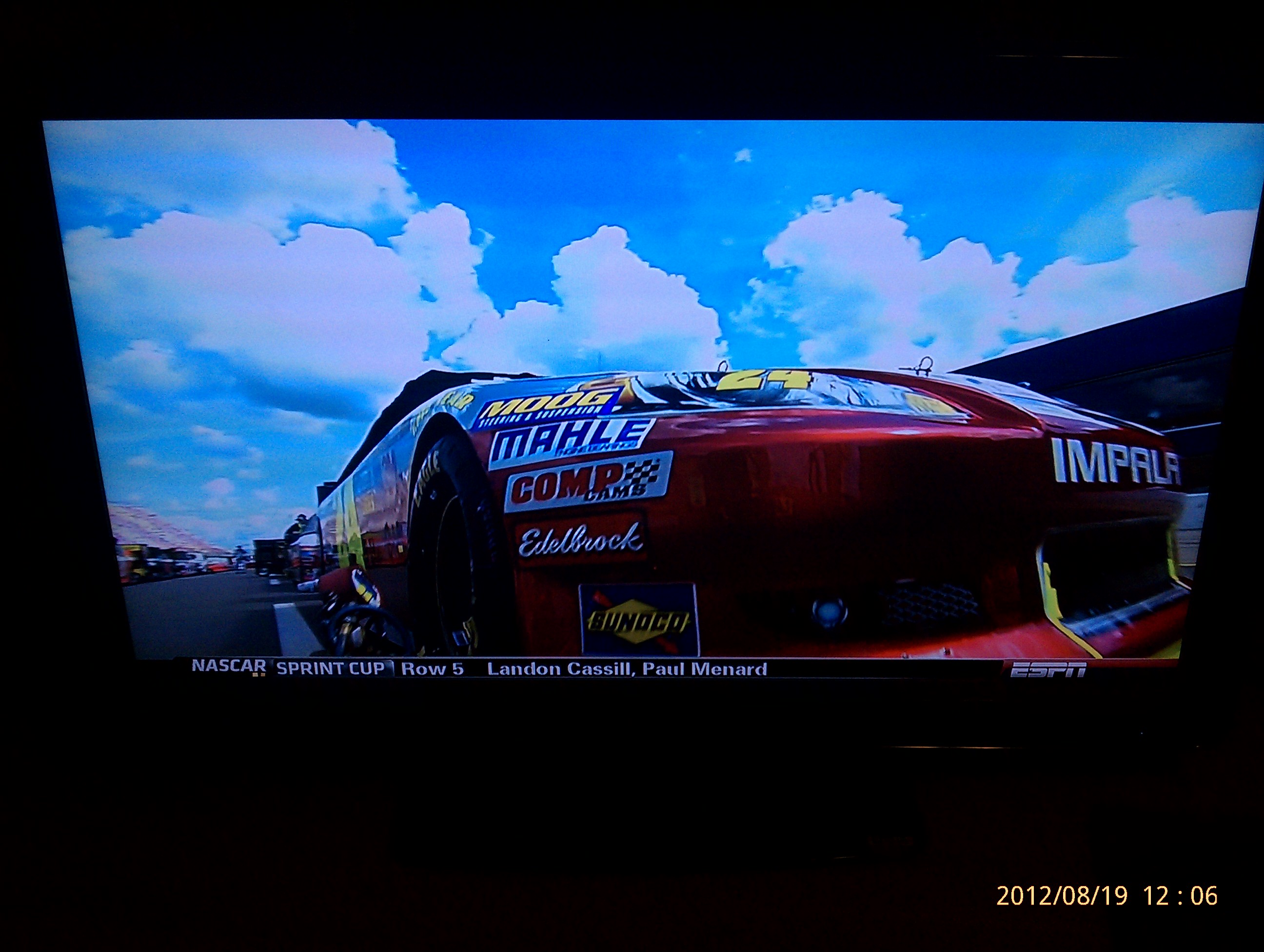

                                  T-Con board arrived today and I just finished installing....
                                  TV is working!
                                  I hope the XD part fixes yours
                                  Good luck!

                                      Replaced the little SMD fuse labeled XD with
                                      http://www.digikey.com/product-detai...60CT-ND/521358
                                      and success! TV now has video.
                                      The audio sounds horrible though not sure if speakers were blown when I got it. I thought maybe had to put back cover on because there is some part of the speakers built in to the back cover but it didn't help.
                                      But glad the video is up and running because still had not been able to locate a T-Con board replacement.
                                      Thanks to all who helped with this one!
                                      If anyone knows anything about the audio please let me know!
                                      My bad part of the speaker system is on the back cover and 4 screws on bottom need to be tightened to make contact, sound is working normally now!
