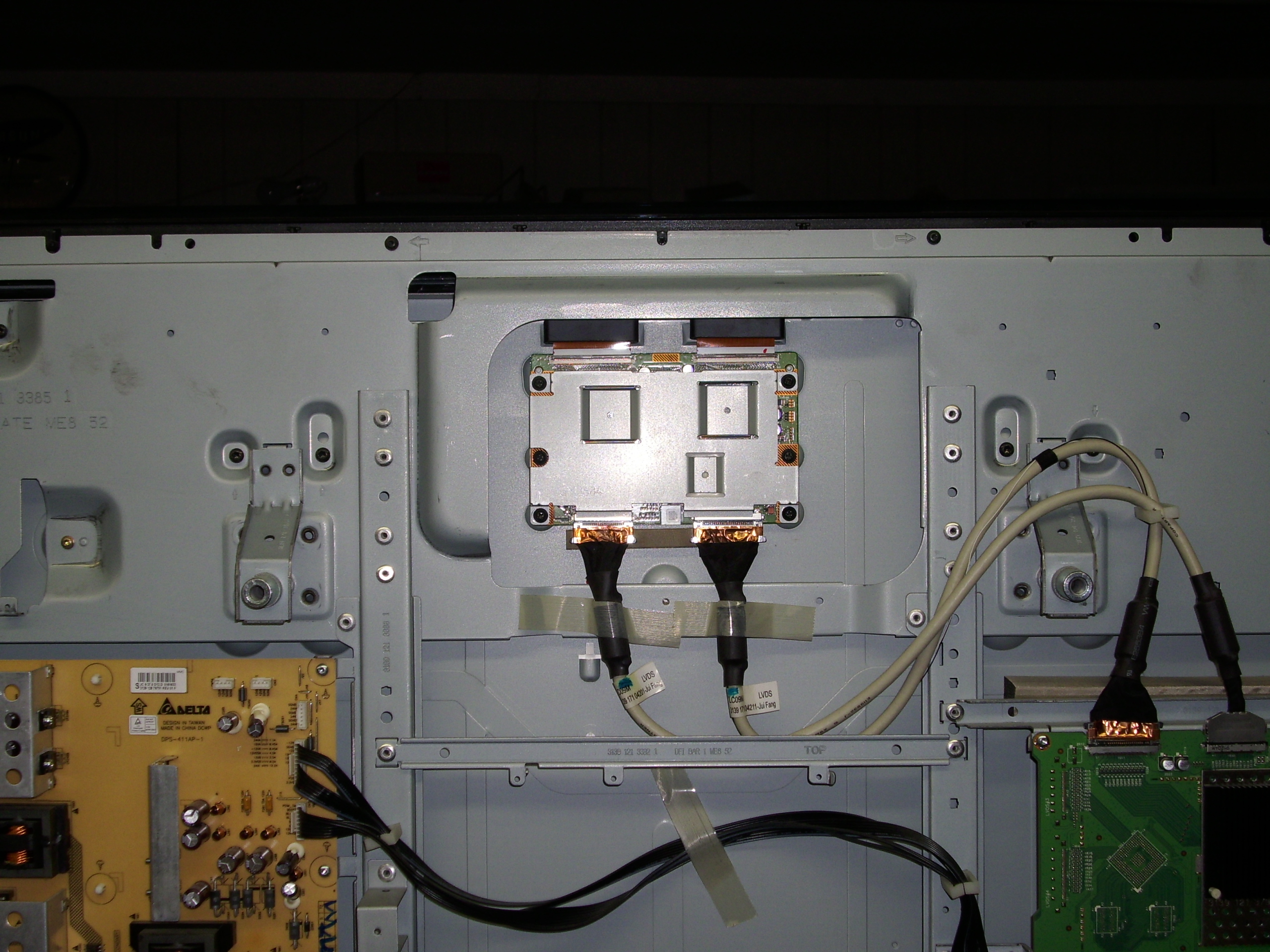

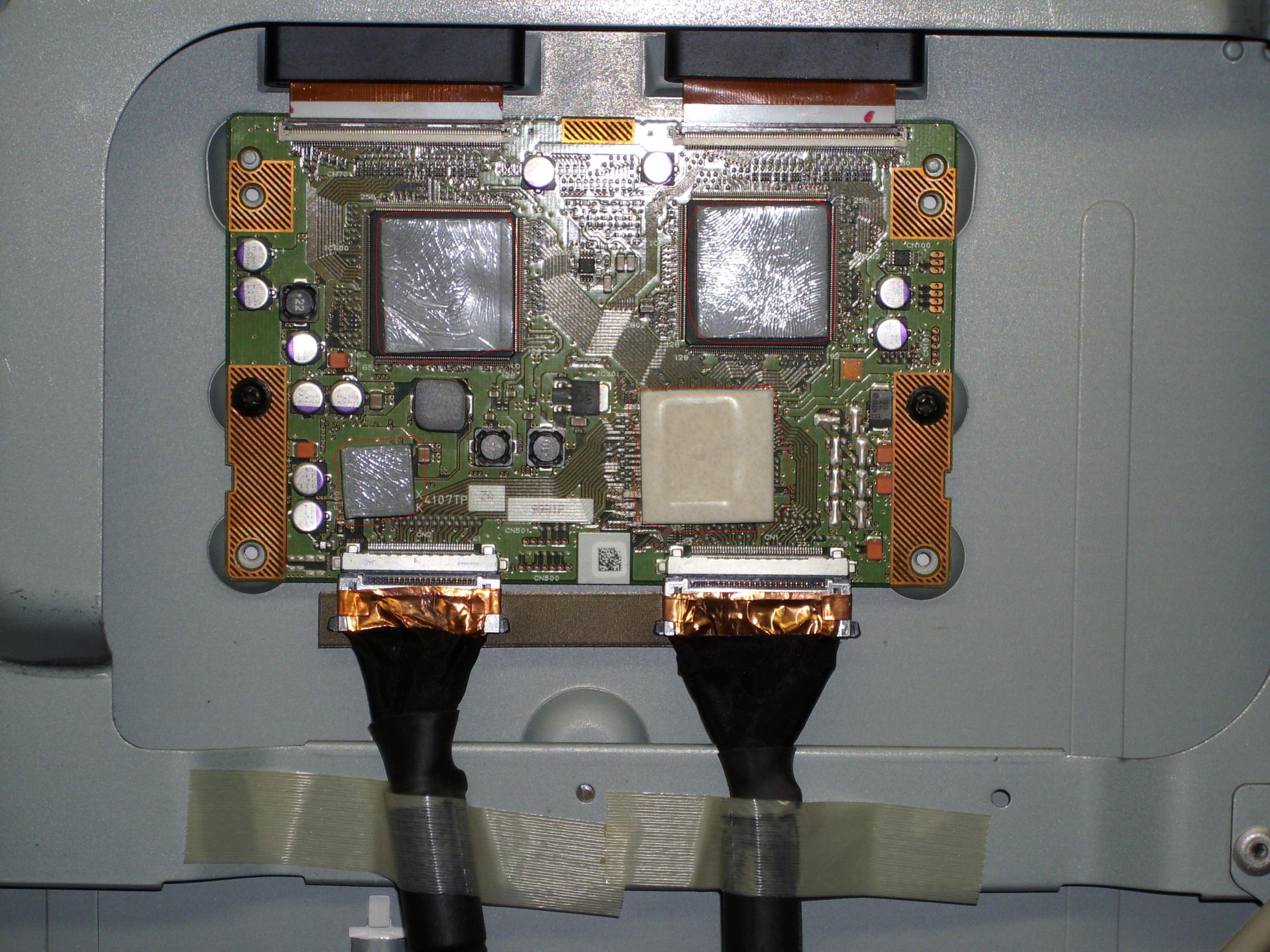

                  #128
                  Re: Philips 52PFL5704D/F7 Sound and Backlight, No Video.
                  Here's tip you can try on a repair for these T-Con board which more likely are very hard to find if one can and also most likely will never be available for part purchase from Philips or Sharp.Here's the method we have used.
                  (1) remove the metal shield from T-con
                  (2) remove the T-con from panel
                  (3) remove all four thermal heat transfer pads from T-con board
                  (4) we used tin pan that would hold T-con and use Acetone cleaner and pour
                  in pan to amount that would just cover top T-con let board sit for about 2/3 min.
                  (5) remove T-con and use tooth brush rub entire top and then bottom vigorously to clean both top and bottom.
                  (6) let dry for 30- 45 min reinstall T-con back to panel
                  (7) reinstall thermal heat transfer pads back from where previously remove
                  (8) reinstall ribbon connector and cables,reinstall metal shield
                  (9) turn on and bench test
                  Now our theory of whats happening is the oily residue after period of time from the thermal heat transfer pad is getting on the board and becoming some what of resistive coating and shunting the 3.3 volt source for the T-con
                  Ron Driver,BSEE,CET,ISCET,NESDA
                        So I got this TV and have this problem. I've cleaned the board in 91% alcohol and with a toothbrush twice, as it worked for awhile then on the next power on (I tried turning it back on after it being on for a couple of hours) and the screen would turn on for a split second and fade to black. The second time I took the TCON board off I looked at all 5 of the thermal pads more closely and noticed that it looked like whoever put together this TV only took off one side of the protective layer of each thermal pad. So the 3 gray pads had a thin plastic layer on one side, and the 2 white pads had a hard to remove paper? layer on one side. I recommend using a razor blade to get the paper off. I assume those aren't any kind of electrical insulator, I took them off and everything is fine. The TV still had this issue after doing that though, so I strapped a 120mm computer case fan and spliced the wires with a computer front panel (LED/power/reset) lead and hooked it into one of the two empty 4 pin connectors on the TV's power supply. Now the fan kicks on and off with the TV. I just got done doing this, I'll let you know if it makes any difference, the "heatsink" is nice and cool to the touch now though so if there is any problem still I doubt it will be heat related.
                        • tibimakai
                          • Jan 2012
                          • 3680
                          #132
                          I have found the same plastic layer, but on both sides of those thermal pad.
                          I have put thermal paste on every surface and installed a CPU heat sink on the shield and it was running like a champ.
