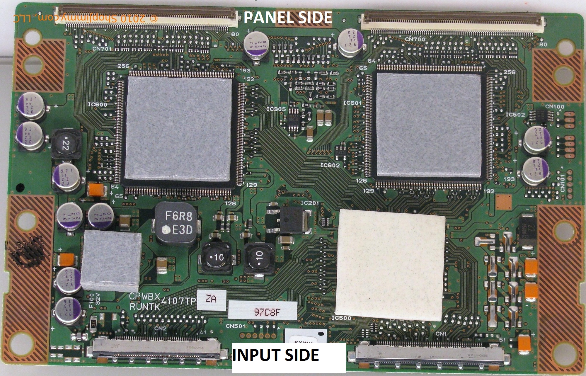

      Re: Philips 52PFL5704D/F7 Sound and Backlight, No Video.
      Great. Now I know. Do you see CN2 with lots of little silver dots next to it, below "RUNTK"? Connect the ground probe of your scope to the brown copper exposed to the LEFT of these. Then carefully touch and hot the probe on the dot. Press AUTO on the scope (cheating, but it will work for now.) Do you see anything? If so, the main board is probably sending data but the T-con isn't listening.
      If you don't get anything, try the a few other dots until you get something. But if you still don't get anything, the main board is faulty.

        #83
        Also you have 12v on at the fuse but no voltage at IC201 right? So it would appear that something on the T-Con is shorted..

                            #93
                            I have reconnected the panel ribbons and the TV started right up.
                            Explain this one.
                            I have noticed that all the processors on the T-con are running very hot. I have reinstalled the shield to take over from that heat, but it doesn't seem enough.
                            Now I have put a fan on top of it and let it run and see if it will fail this way.
                            I took some pictures with the scope screen. I will post it in a bit.

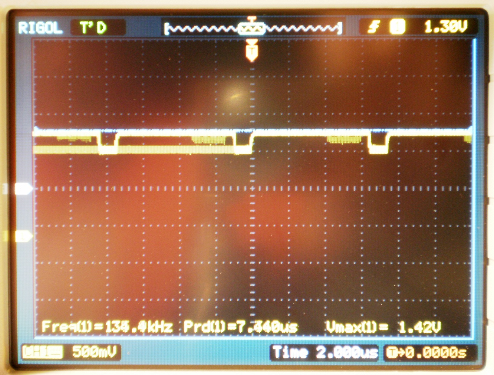

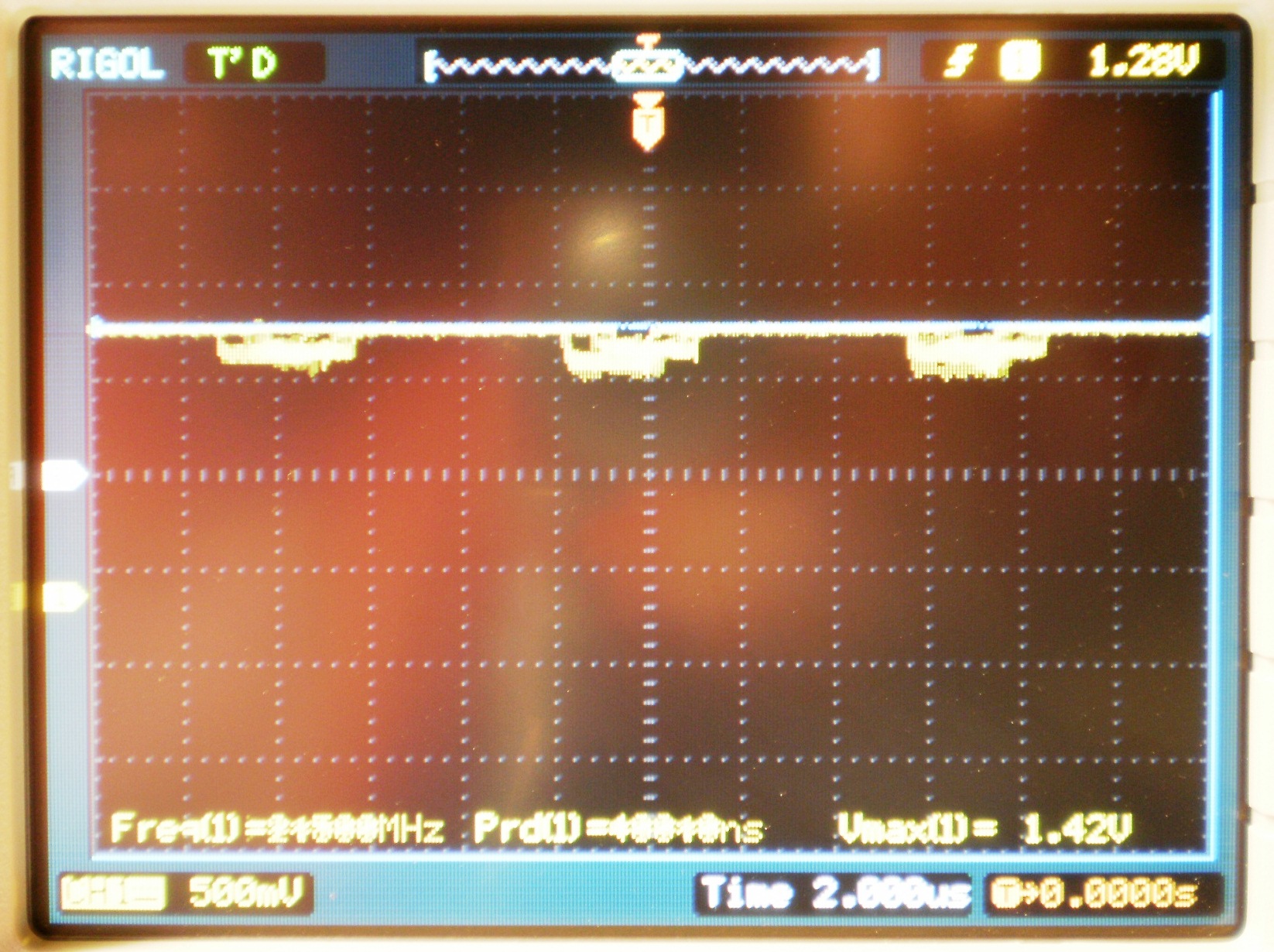

                              #94
                              Here are the pictures when it wasn't working(no video signal either).

                                  #96
                                  I have left it overnight(9-00PM-6:00AM) with a fan pointed upwards at the TV(TV vertically with removed back cover and the fan-Tornado- pointed up) and in the morning it was still running.
                                  I will install some heatsink and see how it will work. I think that I have some PC CPU heatsink around the house and see what happens with that.
                                  The mainboard processor it gets pretty hot too.
