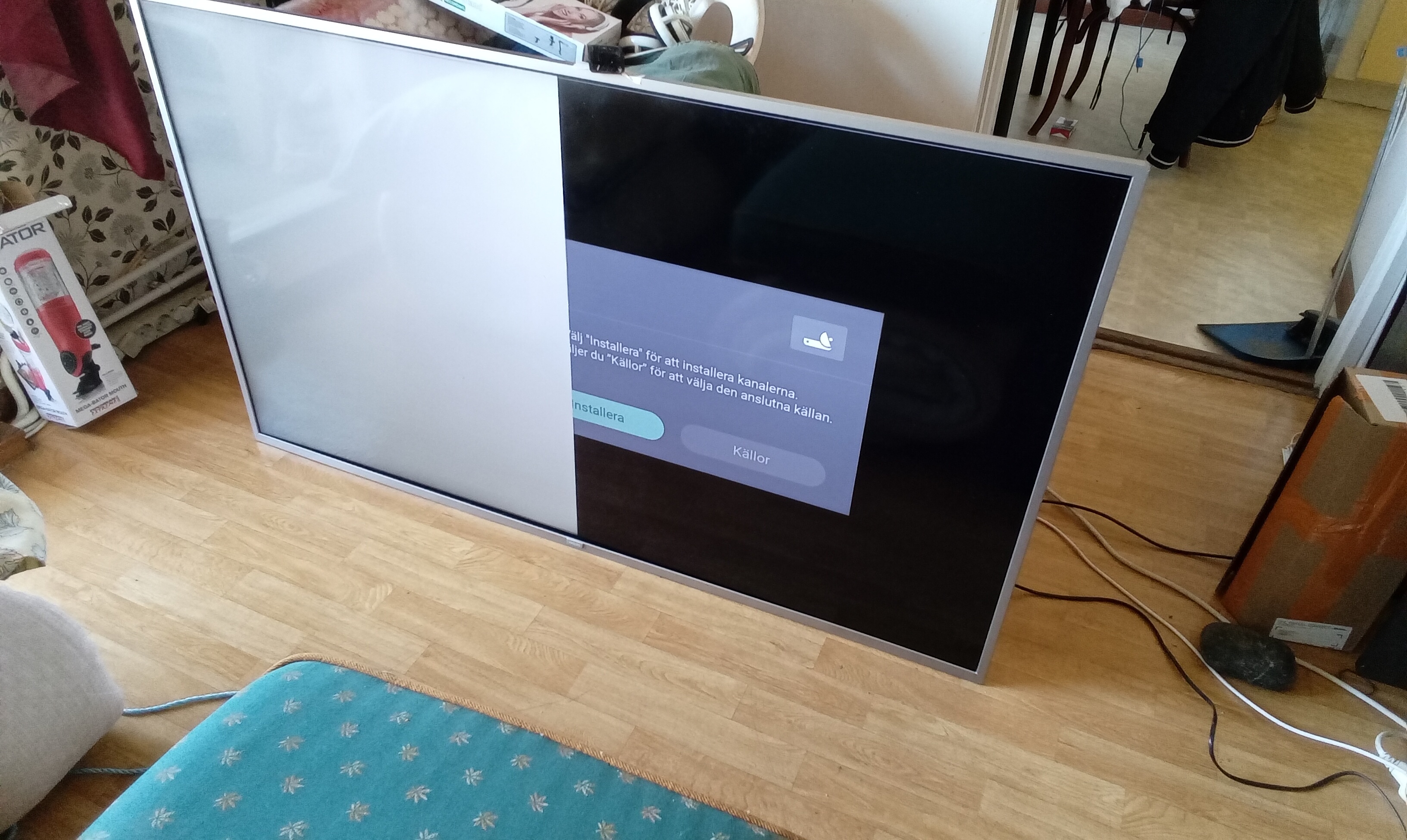

PHILIPS 58PUS7555/12 Backlight Sound ON Only Halv Screen

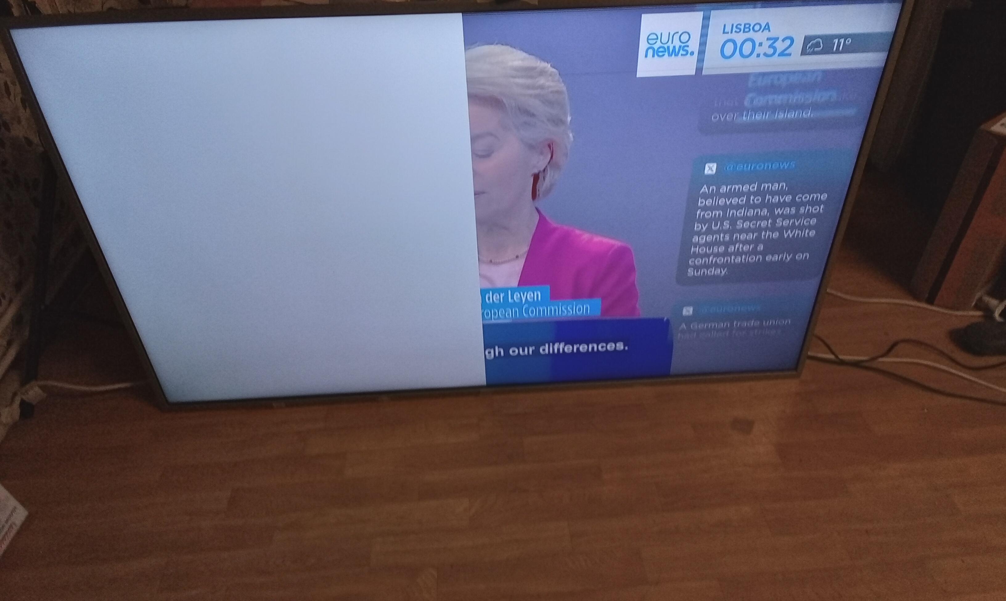

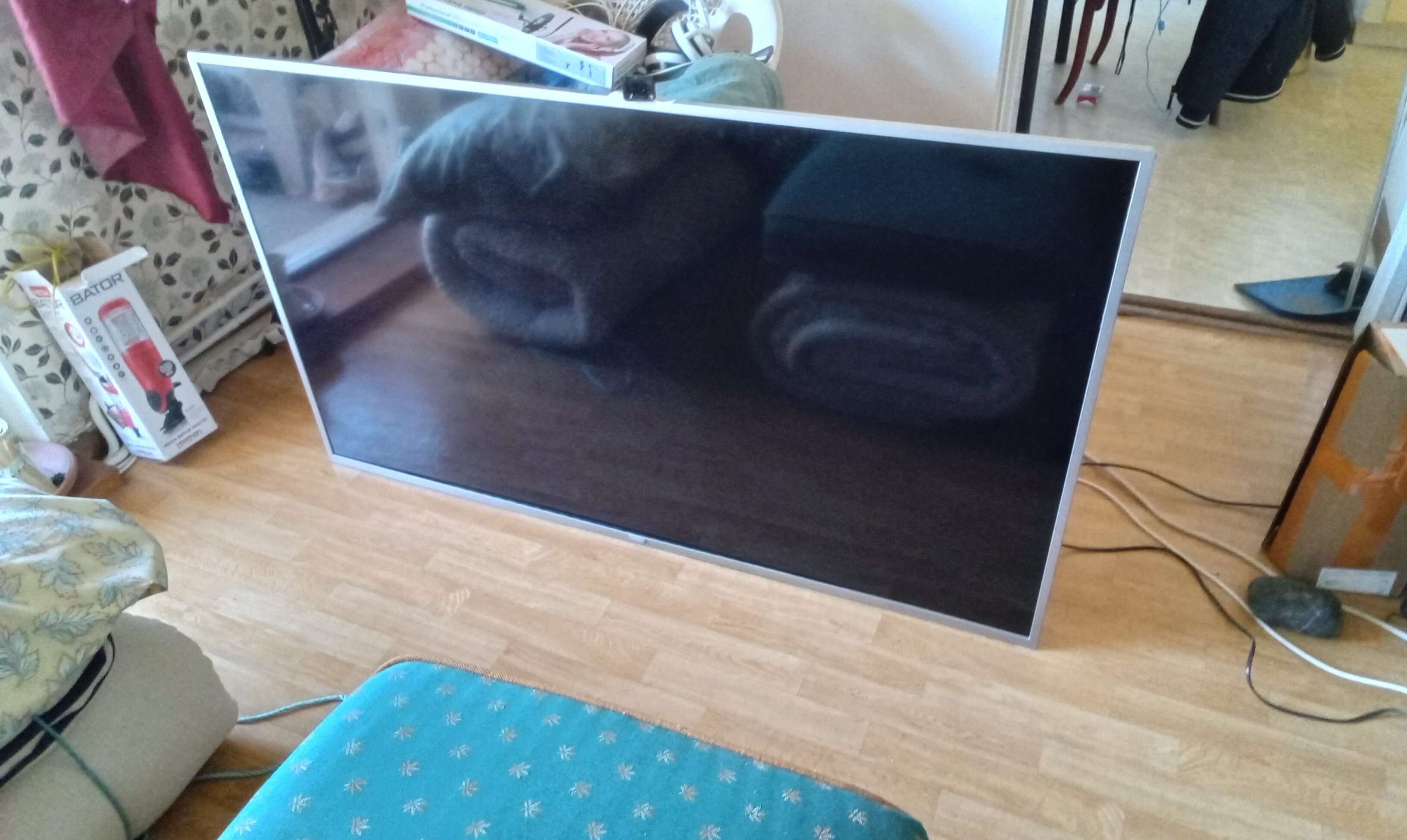

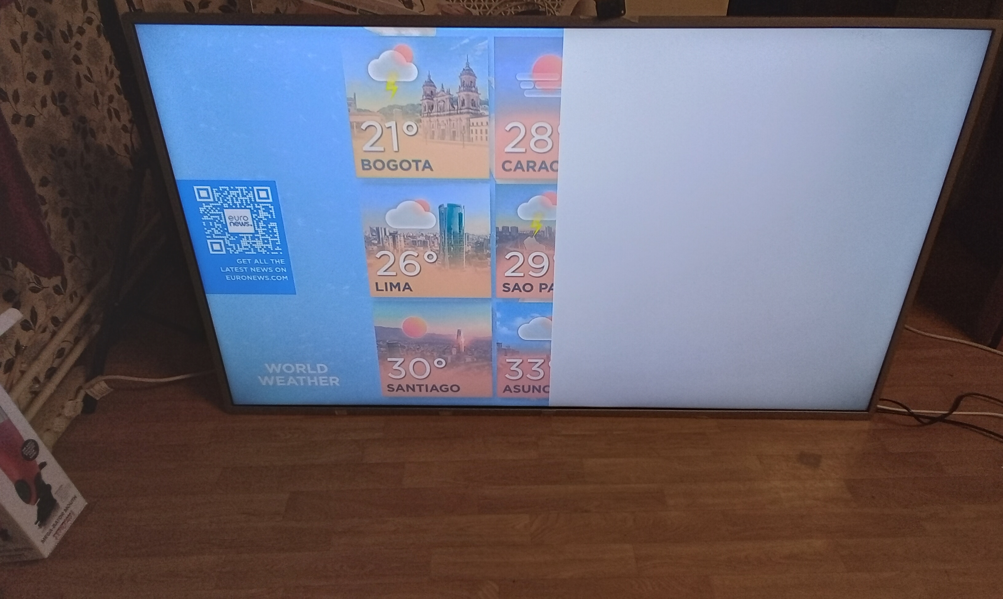

    when i power on the TV is black ,Do I remove the right or the left ribbon I get respectively the right or the left half screen working
    Do I disconnect the plug from the power supply, no backlight
    Thought the backlight would light up when you remove the plug from the power supply but no
    What could be wrong if both halves work separately?​

      Well, from the photo you can see that the problem is on the left side, on the right it is clearly visible (black color, so black).

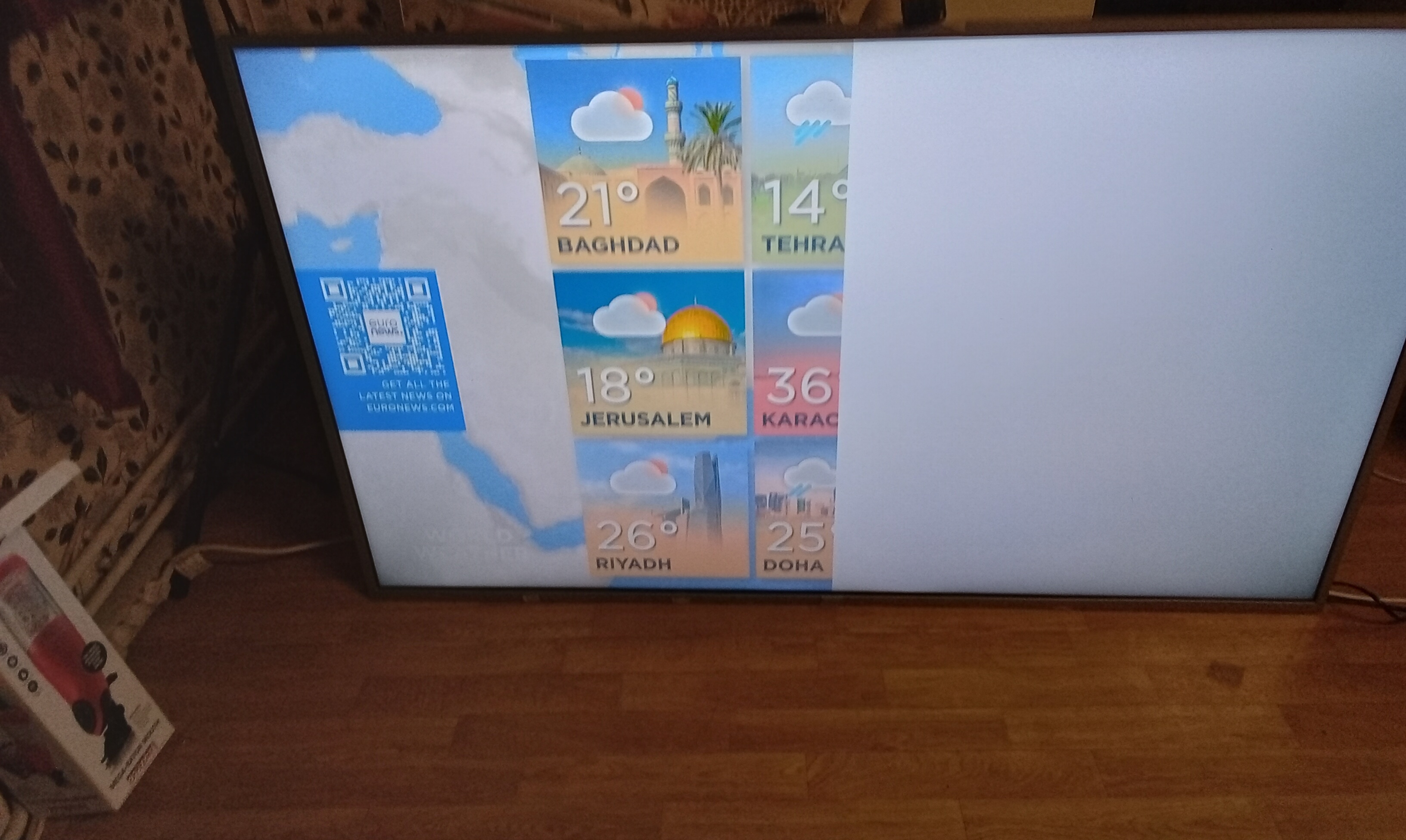

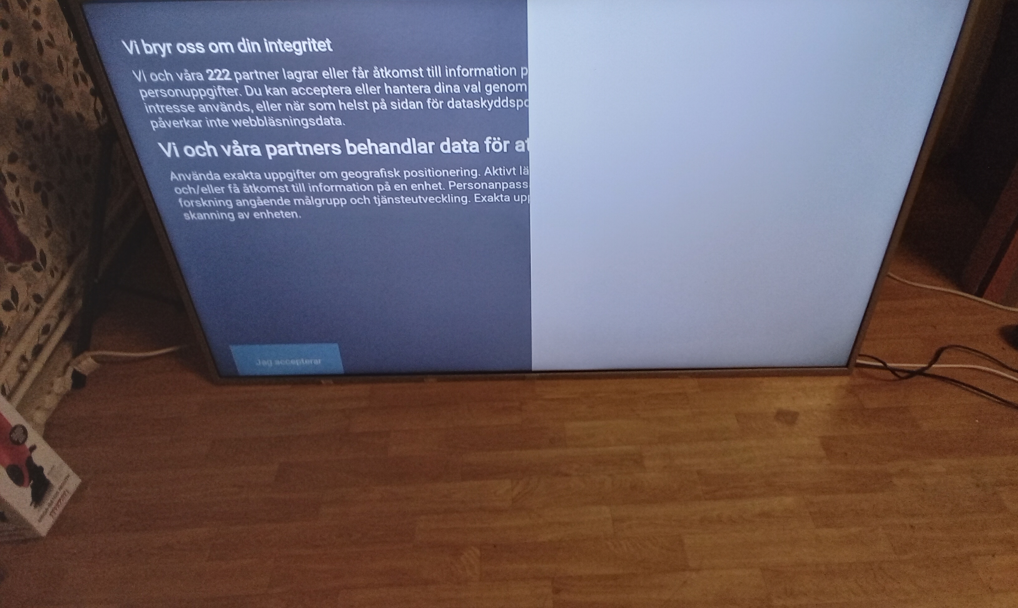

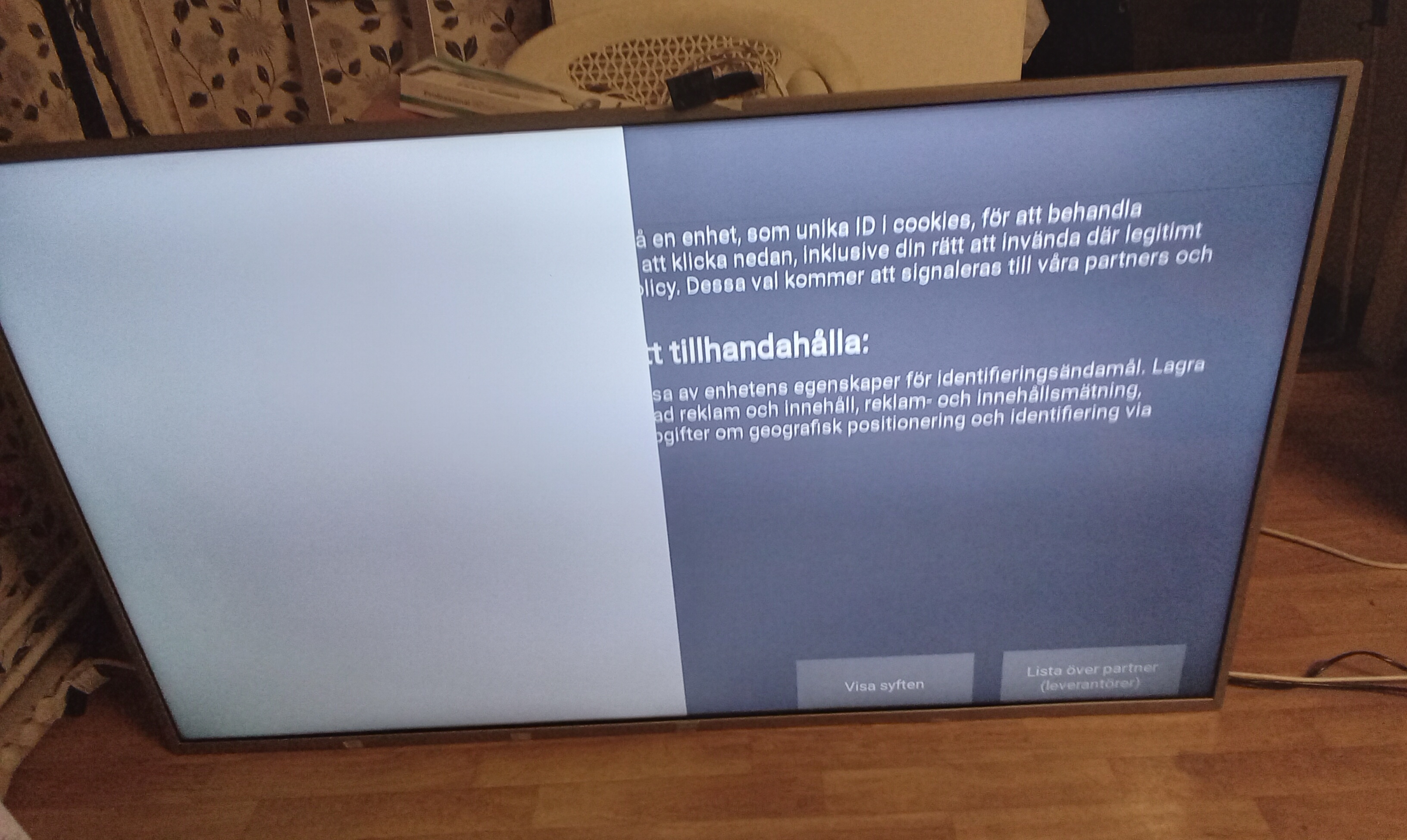

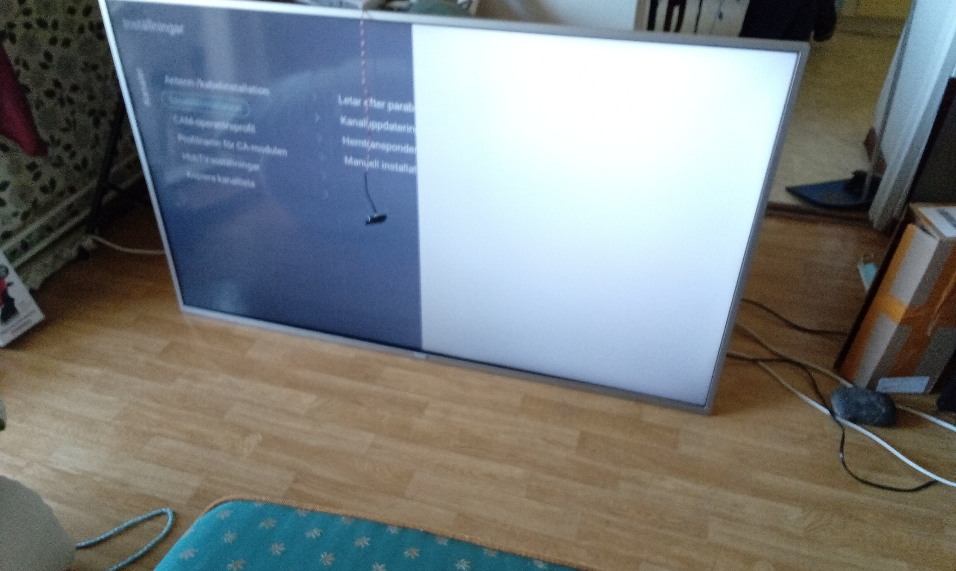

        Thanks for the reply Lotas I think the pictures I have presented are mistaken taken from a bad point of view I put better pictures for a better assessment.
        and as you see TV works as it should but on each half separately

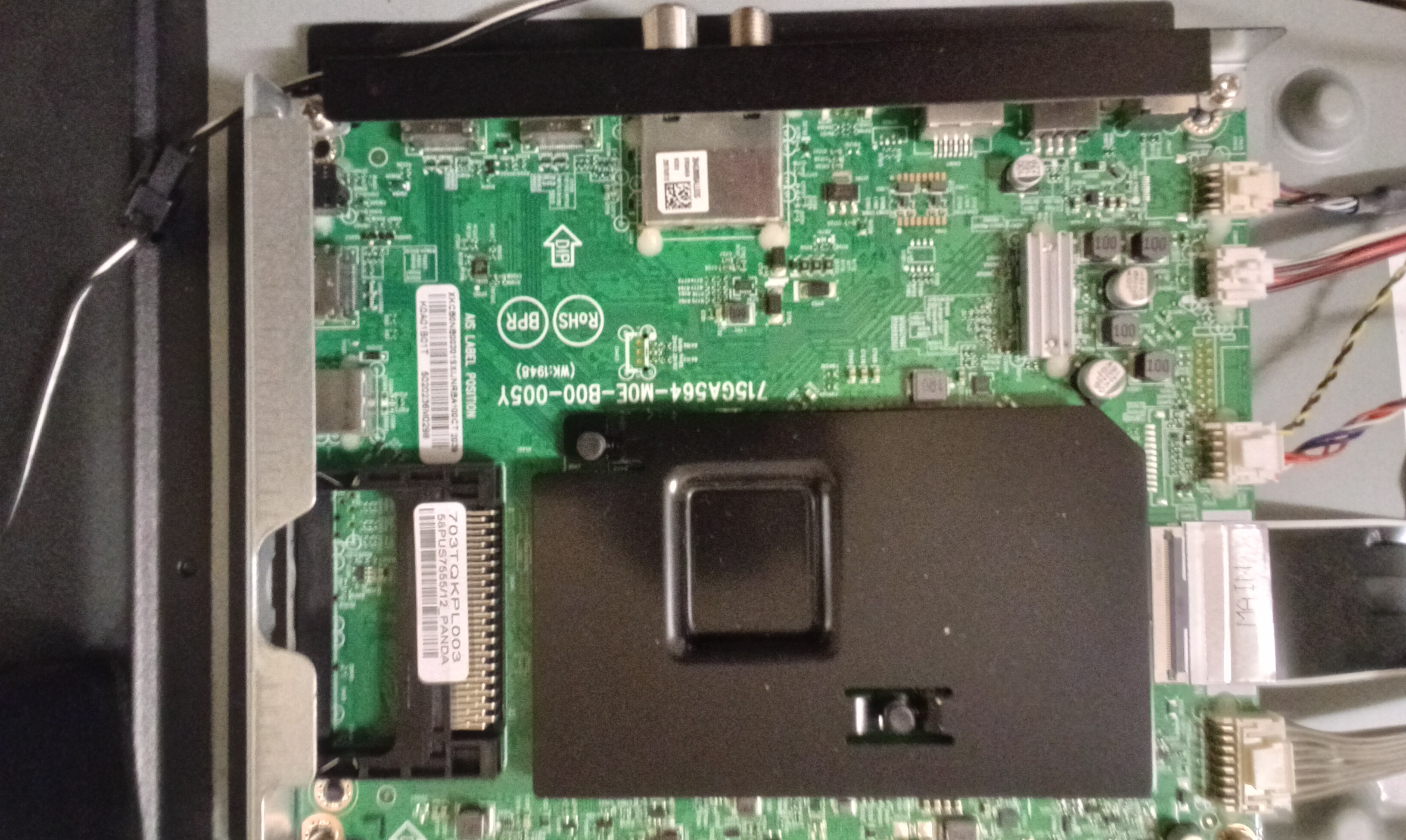

        now I wonder where to start looking to figure out the error maybe T-CON board ?​

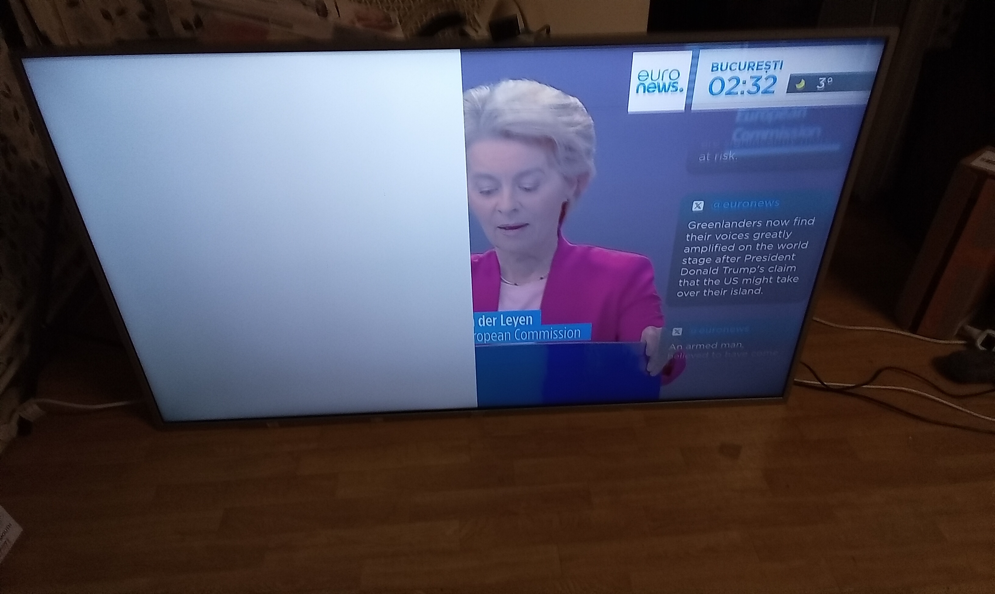

            This has nothing to do with software/firmware. This is a panel problem, try to block some datalines with some tape and the problem will be solved. The 58" with a Panda panel is known for this problem.
                Thanks William1967 your suggestion is pretty easy to make while waiting for Diah's answer but need to know which side to start with and can i do it directly on the Tcon side or on the panel buffer side and most importantly how much datalines should be covert?

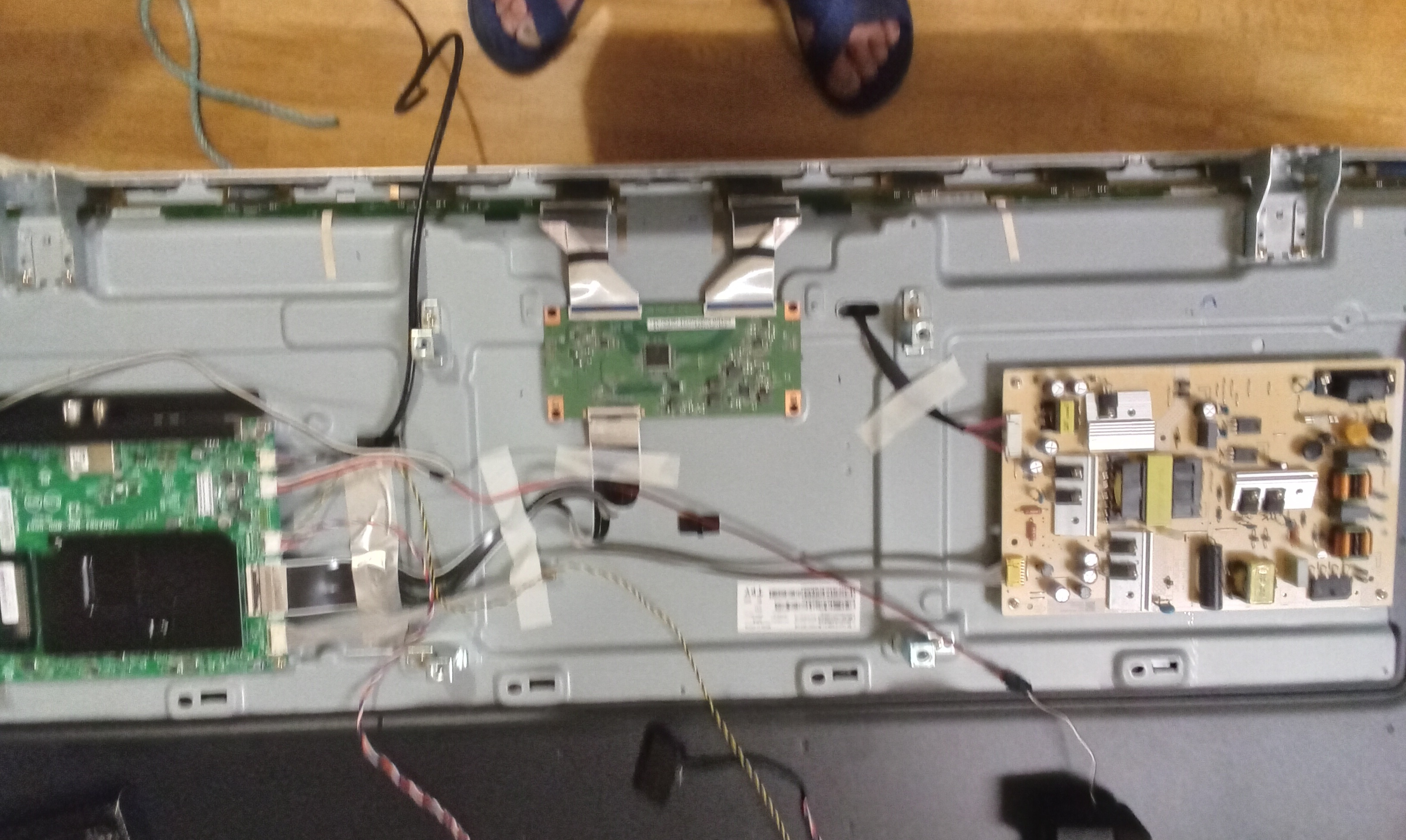

                • Andrew F. Ali
                  • Jan 2014
                  • 2450
                  • Trinidad & Tobago
                  Did you swap LVDS cables to see if you have the same problem?
                  If NO then the LVDS cable needs to be replaced.
                  If YES then replace or repair the T-CON Bd.

                    Hi I haven't done anything yet trying to gather all the info to start investigating this tv but its easy to fix what you suggest then I'll investigate Tcon a little closer thanks

                          Hi everyone who contributed to this thread I think the error is corrected with William1967 suggestion and with the first attempt kapton tape on the first four dataline on the left ribbon on the Tcon board seen from back thanks everyone

                            Well I think this was unusual, what I have seen mostly where taping worked was a flaw on one side, NOT a good picture on each but there it is.

                              Have you seen this often William 1967, with a good display on both sides?

                                I was also wondering if it was usual even it is a first time for me but as William1967 says it seems to be usual for the 58 hope he will se this
                                  I have seen that very often.
                                  Sometimes repairable with a little piece of tape but what sometimes appeared was a spot with less red than normal or thin lines running through the image from left to right.
                                  Sometimes clearly visible but sometimes not.
                                  The Panda panels are bad and come in many brands but especially the 58 inch is very bad.

                                      for me absolutely as new no problem at all so long hope it will last
