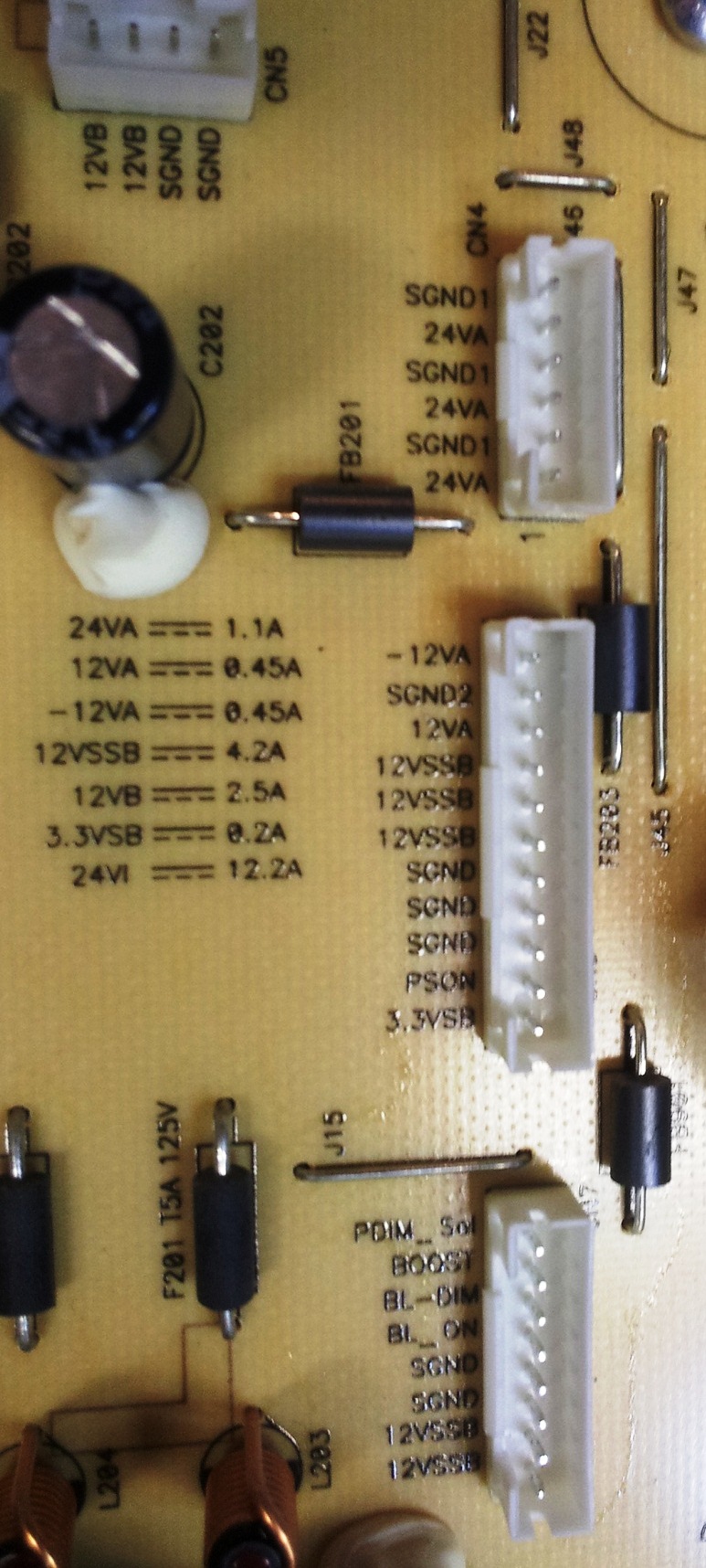

            • tibimakai
              • Jan 2012
              • 3680
              #66
              Re: Philips 52PFL5704D/F7 Sound and Backlight, No Video.
              I have forgot to measure those voltages. Tomorrow.
              I have measured yesterday and today again, just to be sure and something it's weird with the PS_ON.
              When it's off it measures 3.4V and when it's on it measures only, 0.0042V.
              What's up with that?
              The stand by voltage is 3.4V on this TV?
              3.4VSB is the standby? What is 12VSSB?
              Picture made with my phone.
                #67
                Looks like active low PS-ON, that is fine. Some PSUs, especially Samsung, are like that.
                12VSSB is for 12V for Small Signal Board, i.e. main board.
                Perhaps it failed due to the fuse being underrated?
