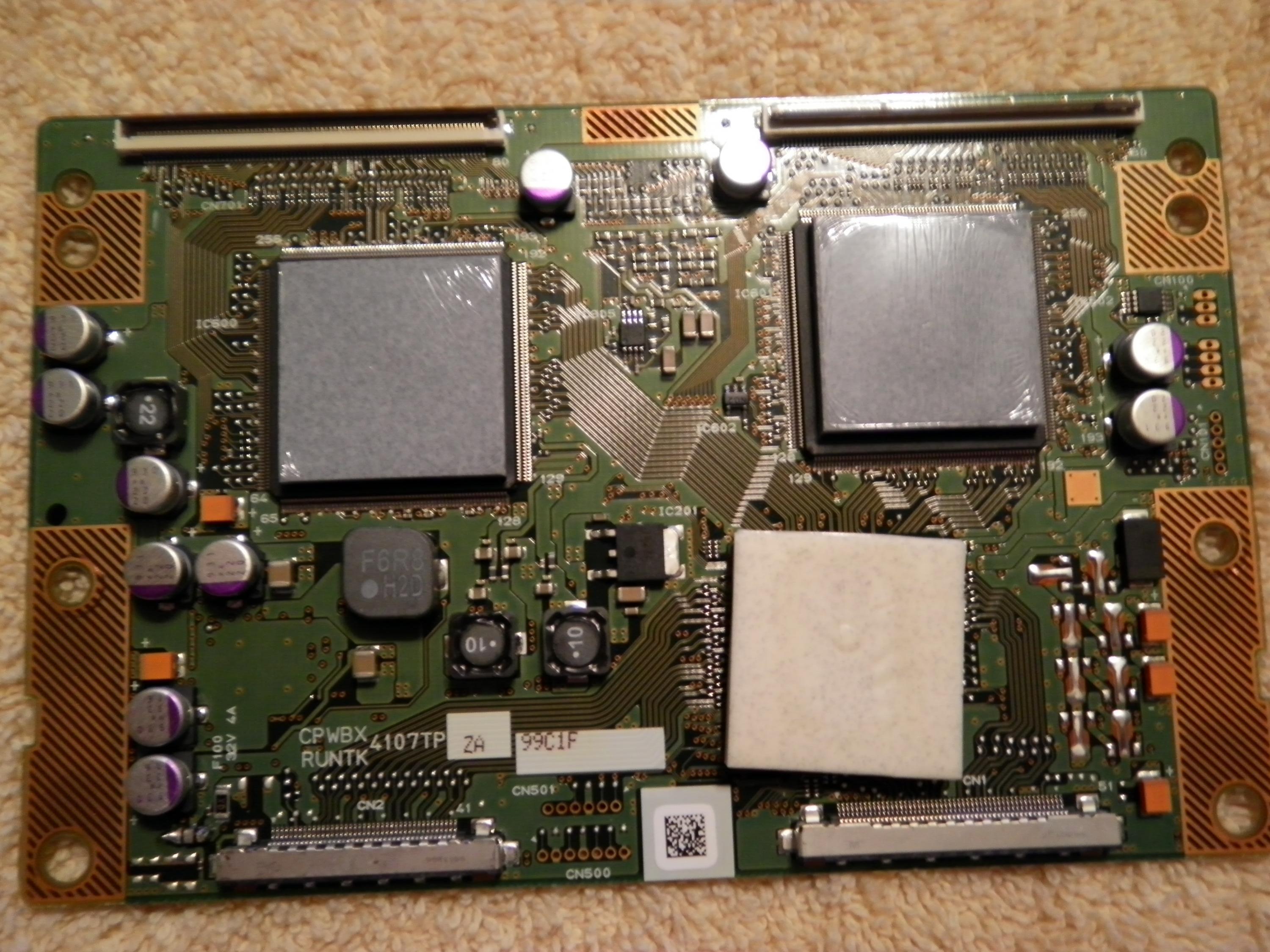

                    I wonder if this has any relevance...
                    • tibimakai
                      • Jan 2012
                      • 3680
                      #110
                      Re: Philips 52PFL5704D/F7 Sound and Backlight, No Video.
                      Kevin, check this out:
                      • tibimakai
                        • Jan 2012
                        • 3680

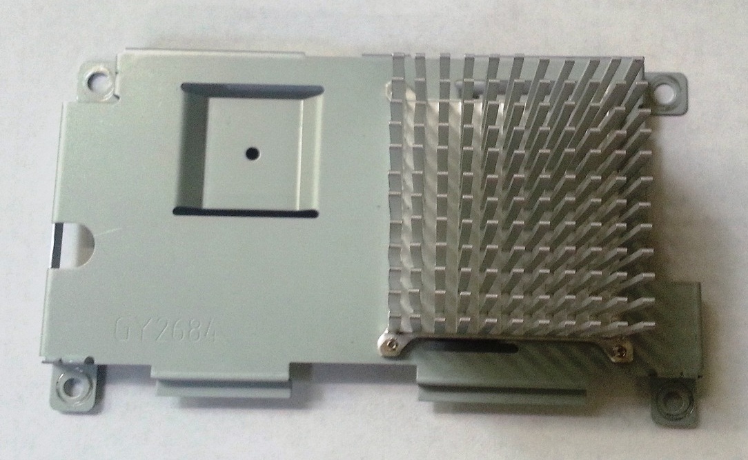

                        #111
                        Here is what I have done. (now at work )
                        I have to test it out when I'm home.
                        I have used a bad Intel Atom motherboard CPU's heatsink:
                        • kevinm34232
                          • May 2012
                          • 1884
                          #112
                          Nice... Will the back cover fit though?? Your TV still running OK??
                          • tibimakai
                            • Jan 2012
                            • 3680

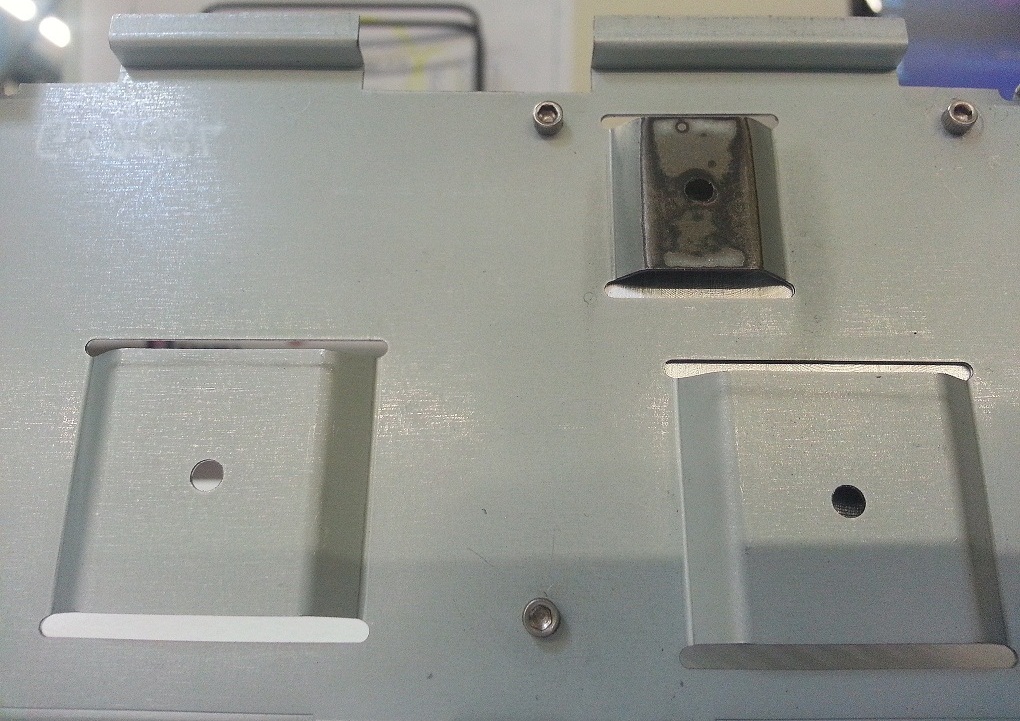

                            #113
                            You can imagine how hot it gets if it leaves that kind of dark spot on a steel plate? I have ordered a Black and Decker IR temperature gage from Amazon and I will check the temperature when it arrives.
                            I have found on the two gray pads nylon protective layers which in my opinion shouldn't be there.
                            It should fit because there are other taller parts in the TV, the T-con sits much lower.
                            Even with this mod it's still runs very hot. I may end up putting another heatsink next to the other one.
                            Yesterday I have left it running with the heatsink and no fan at least six hours and it was still running. Turned it off and back on a couple times and it was still OK.
