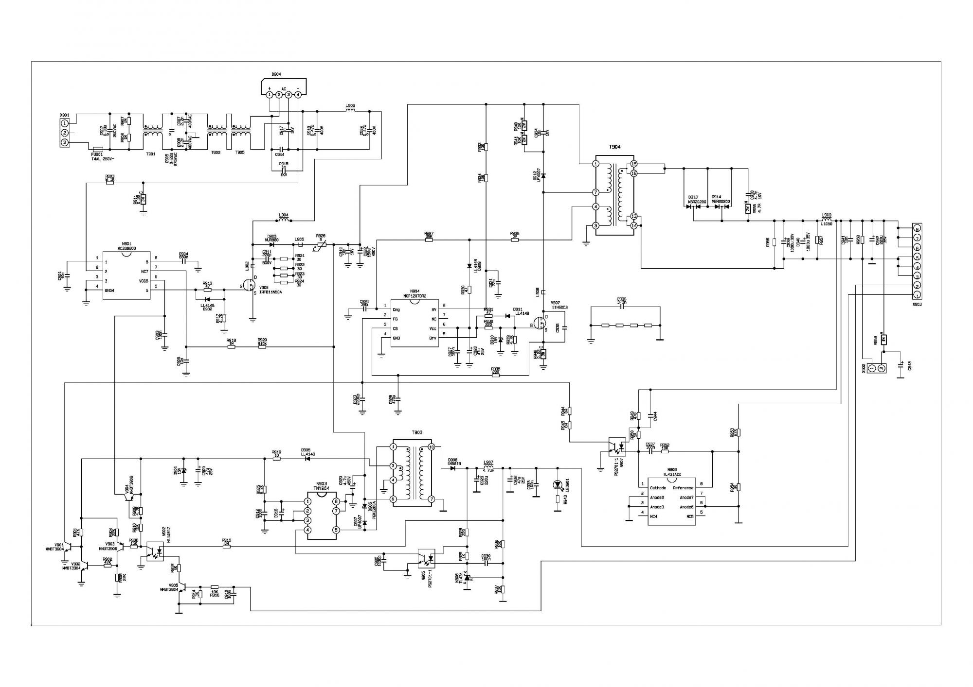

                          Hey drpj23, I have done work before on FLM-2601 power supply and I found the schematic for the power supply. I know this will help you. If you need this file in PDF format let me know

                              And thanks ecking767 for the schematic, a pdf would be great.

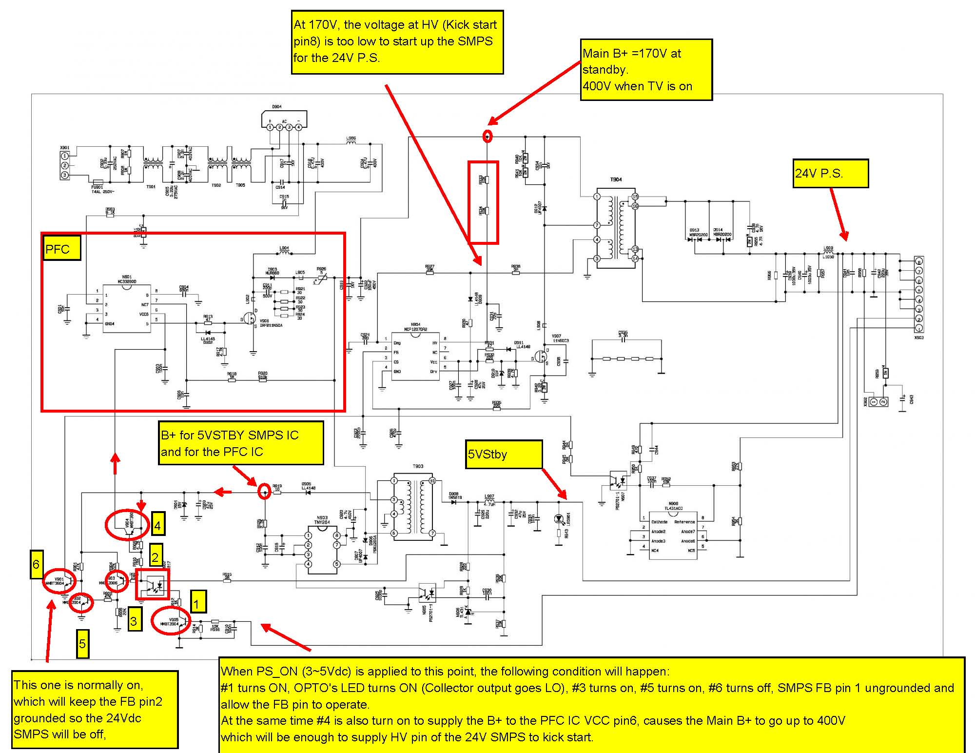

                                  It looks like the standby supply generates the power for the PFC when it is started up. Does the 386V remain reasonably constant or does it drop off? The Vcc for the controller is derived separately.
                                    #37
                                    Re: Polaroid FLM-2601 - Power Supply keeps blowing fuse
                                    Please see the attachment explaining how it works.

                                      Ok, the voltage on the cap remains constant but I have no 24vdc at all.
                                      And wow, I feel like I know nothing after reading that lol.
                                        #39
                                        OK , we now need to look at the SMPS IC and MOFET, but can you tell me which MOSFET you replaced as shown in the Diagram?

                                          #40
                                          I replaced V906 and V907. The V907 is the one after the SMPS IC and I replaced it with a 80C instead of 60C.
