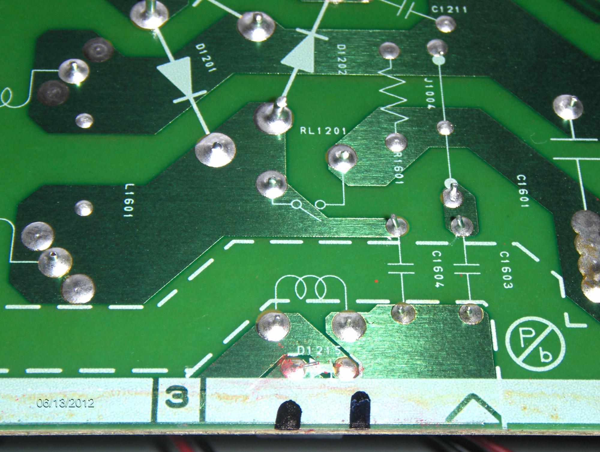

    TV was off during a lighting storm but wouldn't turn on after the storm was over. I opened up and to my suprise no dark spots and so far all I have found is a bad diode. Number D1215, but has no markings, it is in the power supply and is glass. Anyone have an idea what the replacement would be, or the location of a schematic? I can never seem to find the schematics I need

    Can you post a picture of where the diode is used - we may be able to guestimate the replacement type.

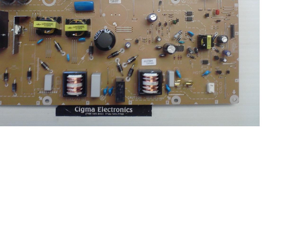

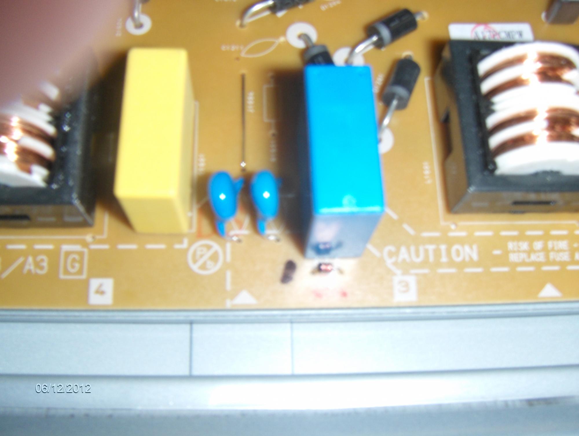

          The first pic shows the diode

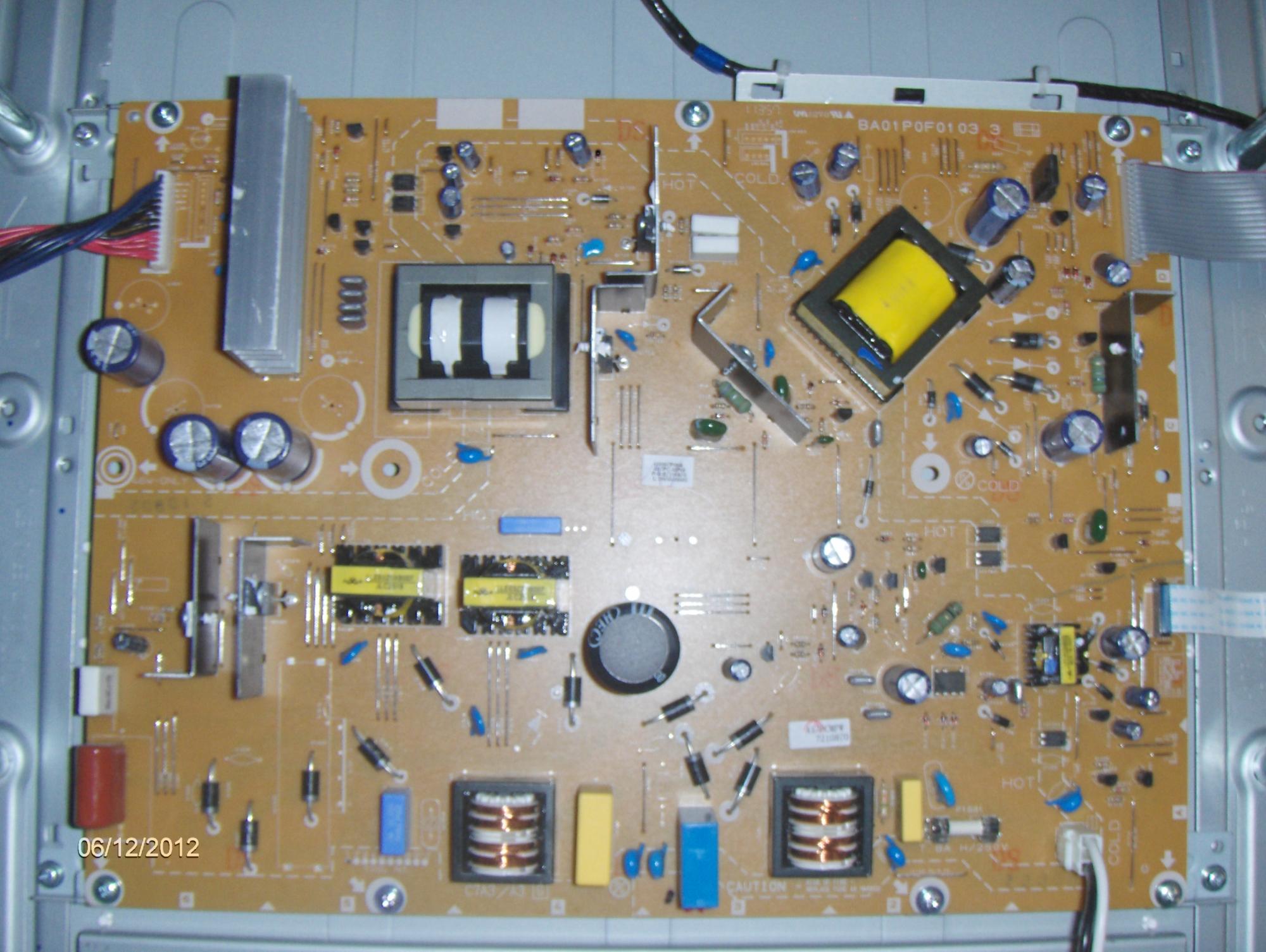

          the other two just show the power supply board
          Hope this helps

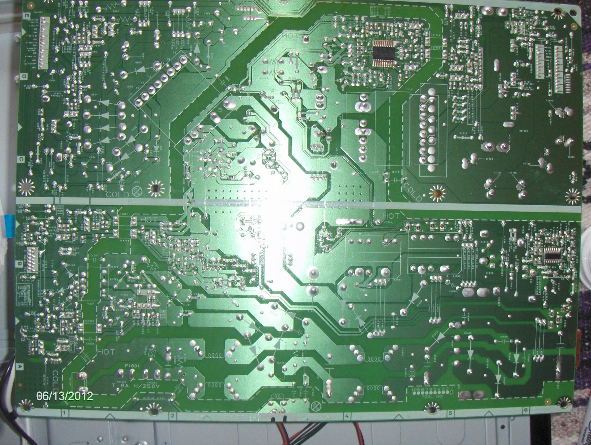

            Can we see the back side of the board so we can try to trace out the connections and figure out the function of that diode.
            Right now do you get any voltage on that large DC filter cap?

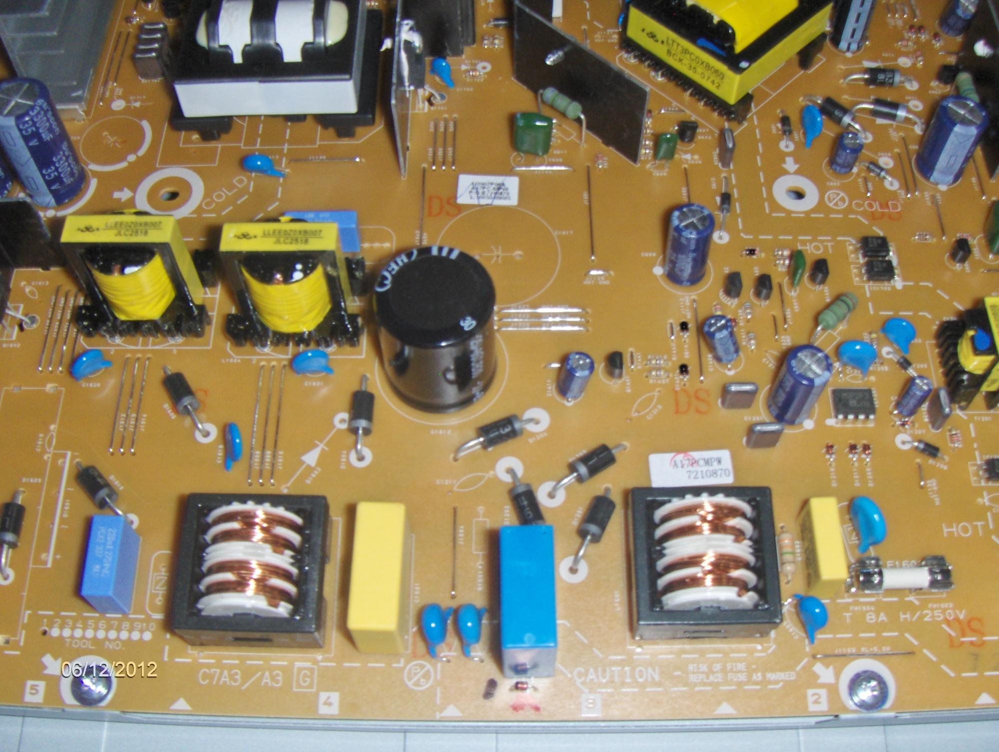

            By the way, is that big blue rectangular case next to the Diode a relay? Otherwise that may be the snubber Diode for the relay coil which are hooked up in parallel, then the Diode will read both way due to the relay coil is in parallel with the Diode.

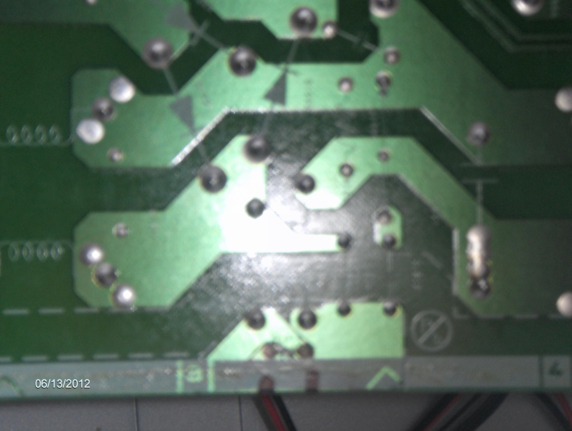

                      Pictures will need to be a lot sharper for troubleshooting - they should look like this - try outside in daylight.

                        I have been doing a bit of research on this- The blue box is a relay - see pic of another board.
                        Moving on it seems to be the same chassis as a Philips 40PFL3705DF7 chassis no PL10.5
                        The SM is here:
                        From that the diode is a 1N4148-F0021 ( Datasheet attached)which oddly enough used to be stocked by Sears as a spare part- the page comes up then says not found!! perhaps they still have them?
                        Anyway it stays on long enough to see it is a vishay 1N4148 - lots to choose from at digikey
                        I bet after all that the diode tests good.

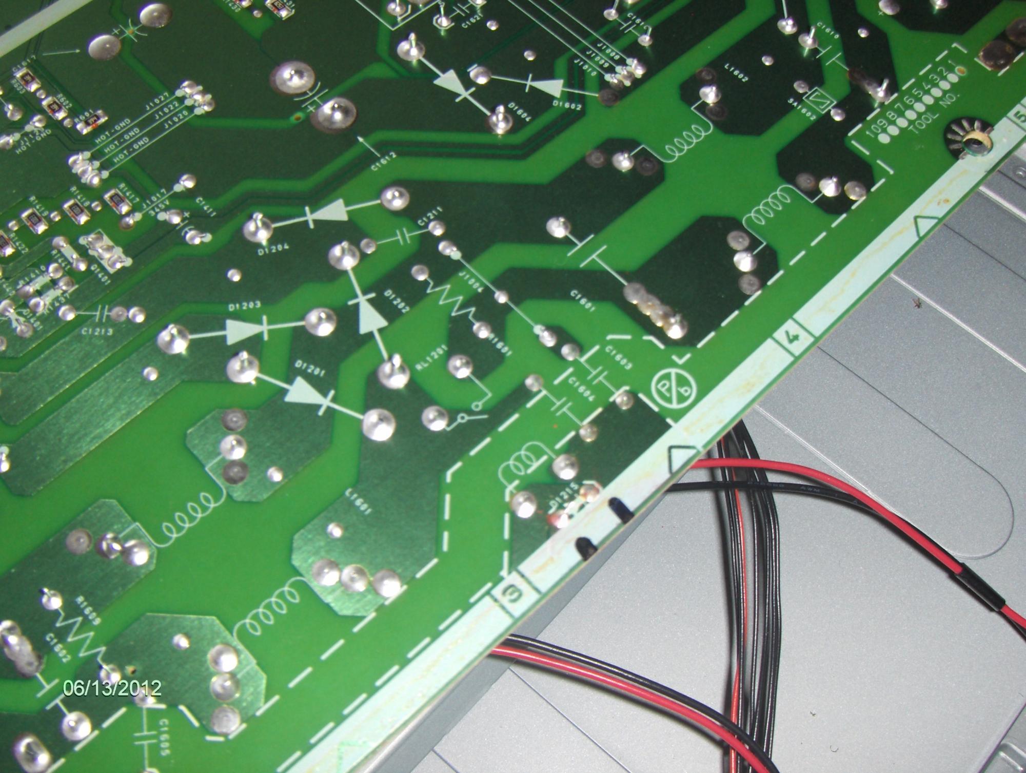

                            Here are pics of the bottom of the board. The two black lines indicate the leads for the diode.
                            I did some voltage tests and I have 79 volts AC accross the diode on both sides of it. No power to the inverter from the power supply board. I have two 5 volt and one 3 volt dc to the main board from the power supply. The set will not turn on and you do not hear any clicks whe the power button is pushed. I forgot to look for a standby light.

                              Gaining some ground. The diode was bad, and since I replaced it the TV will click when plugged in but won't turn on. I do not have a standby light but I have 5 volts for standby voltage on the IR board.

                                  The Diode is in series with the relay coil.
