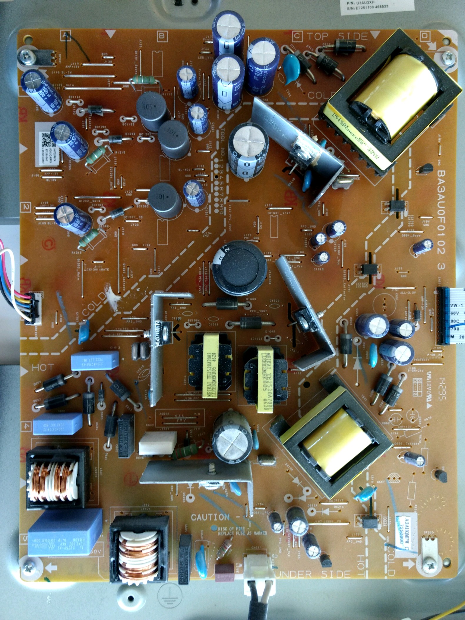

    First....board pix

      Re: Emerson LF501EM5F, turns on, logo appears, shuts off, the perfect storm?
      Ok here's what I am seeing:
      STBY_3.3..........3.31 steady, 0V boards unhooked
      P-ON+21V.........14.40 steady, 13.8 steady boards unhooked
      AMP+13V..........7.95 steady, 8.14 steady, boards unhooked
      CN001 (to LED strings)
      Red..............80V decreases to 55V/ 80V, decreases to 55V PSU disconnected
      Yel...............23v, decreases to 1.5/ 0V disconnected
      Blu..............79.3 stays within 10%/ 80 decreases to 55 disconnected
      Gry.............6.2V, decreases to .7V, increases to 6.2V/ 0V disconnected
      Blk..............78.2V, decrease in lamp intensity, increases to 78.6V/ 55V, jumps to 80V, decreases to 56V disconnected
      Wht.............13.8V, decreases to .7v, decrease in lamp intensity, increases to 7.5V/ 0V disconnected.
      Capacitor C1305 rating: 100uF, 100V, not popped.
      Based on that thread, the voltages seen and required at P-ON+21V and AMP+13V and the voltage values at CN001 I'm thinking bad LED's and something bad on the power board? My guess is when the LED's went something on the PSU may have also been damaged?
          So with all the boards are connected back in place, what DC V do you get at P-ON+21V and at AMP+13V when power switch is activated?
              Those two Voltages are at the standby mode, when PS-ON is present then they will go up to the printed rated Voltage.
