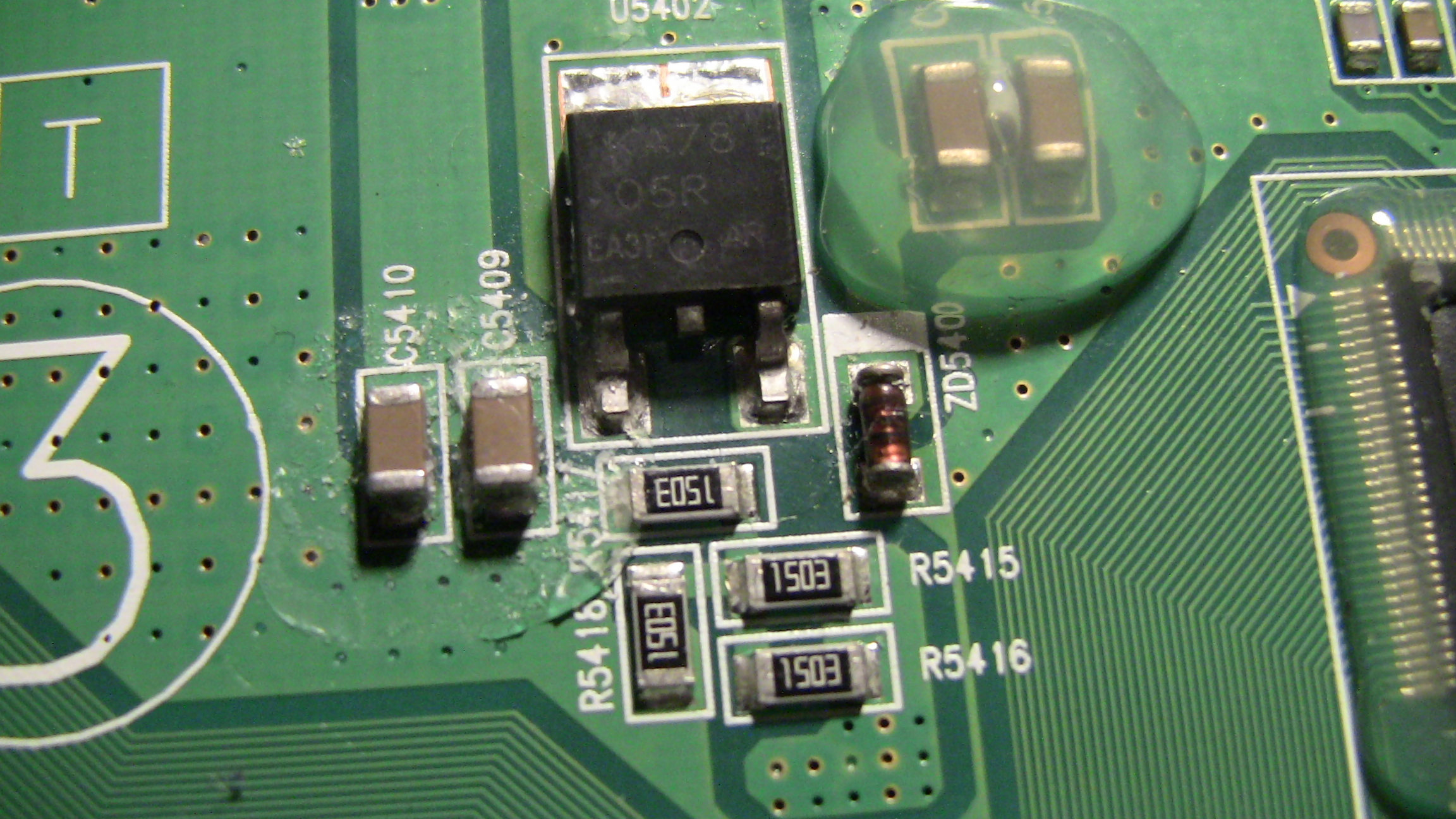

    #181
    Re: This guy has an RCA 42PA30RQ
    Oh by the way, I'm not sure if this was effectivepower but this is what I did with the old board. I connected 5v to the y board with my variable power supply. The board started Smoking from one of the zendiodes located near a power ic. It started smoking at 2 volts

          #184
          Have another Y-main on order. Seller refunded me my money. I hope this next board is not defective

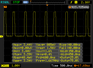

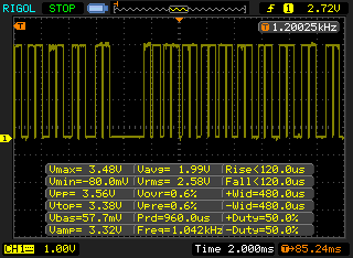

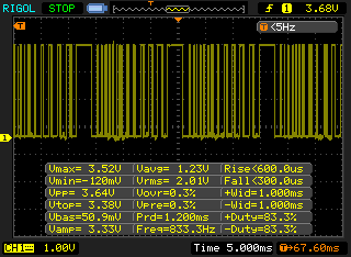

            #185

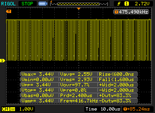

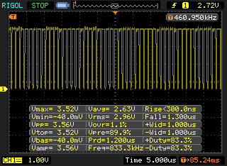

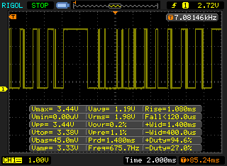

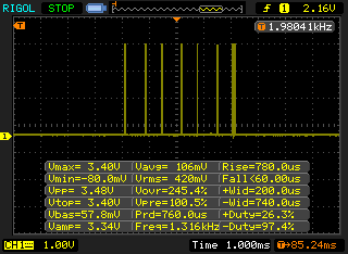

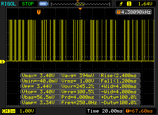

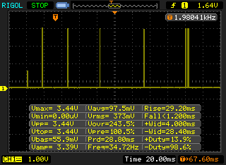

            waveform from control board y-main ribbon connection.

              #186
              A photo of the Zen Diode that smoked when I tested the Y-Buffer with 10-15V with my variable power suppply. The zen diode started smoking between 2- 4 volts...Upon applying power to the board, I immediatly noticed the current shoot up fast..clearly an indication of a short on the board.
