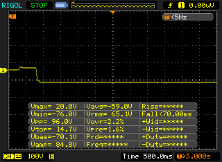

    same test and it didn't even budge..flat line with humming sound
      #102
      Re: This guy has an RCA 42PA30RQ
      So both Y-main and X-main would appear defective. Can you repeat testing on Y-main with X-main unplugged?

          with X-Main disconnected
            #105
            So... more or less the same. I would try replacing Y-main first. The one you got appears defective.

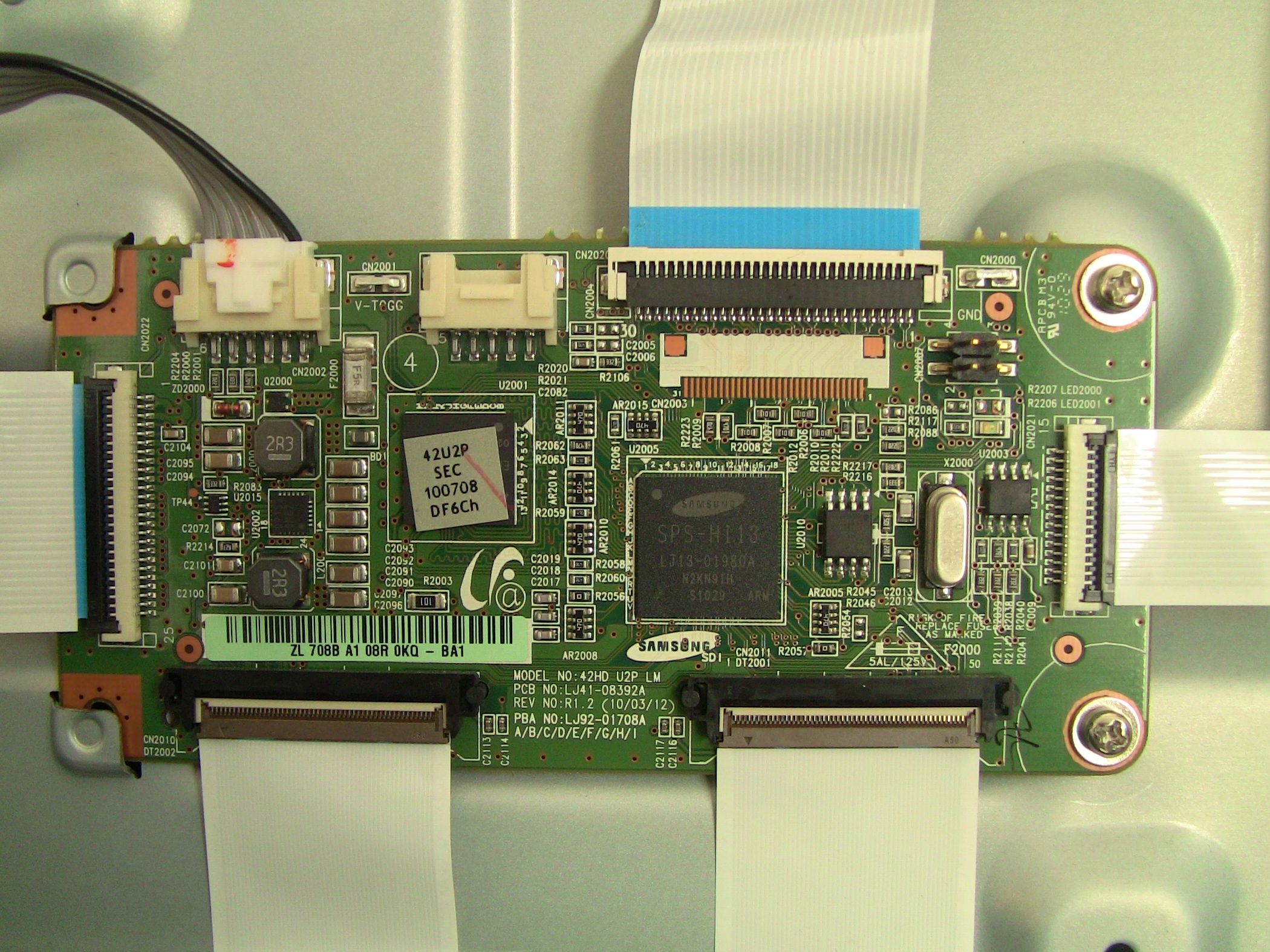

                  #108
                  It is actually a surge arrestor and shouldn't normally light.

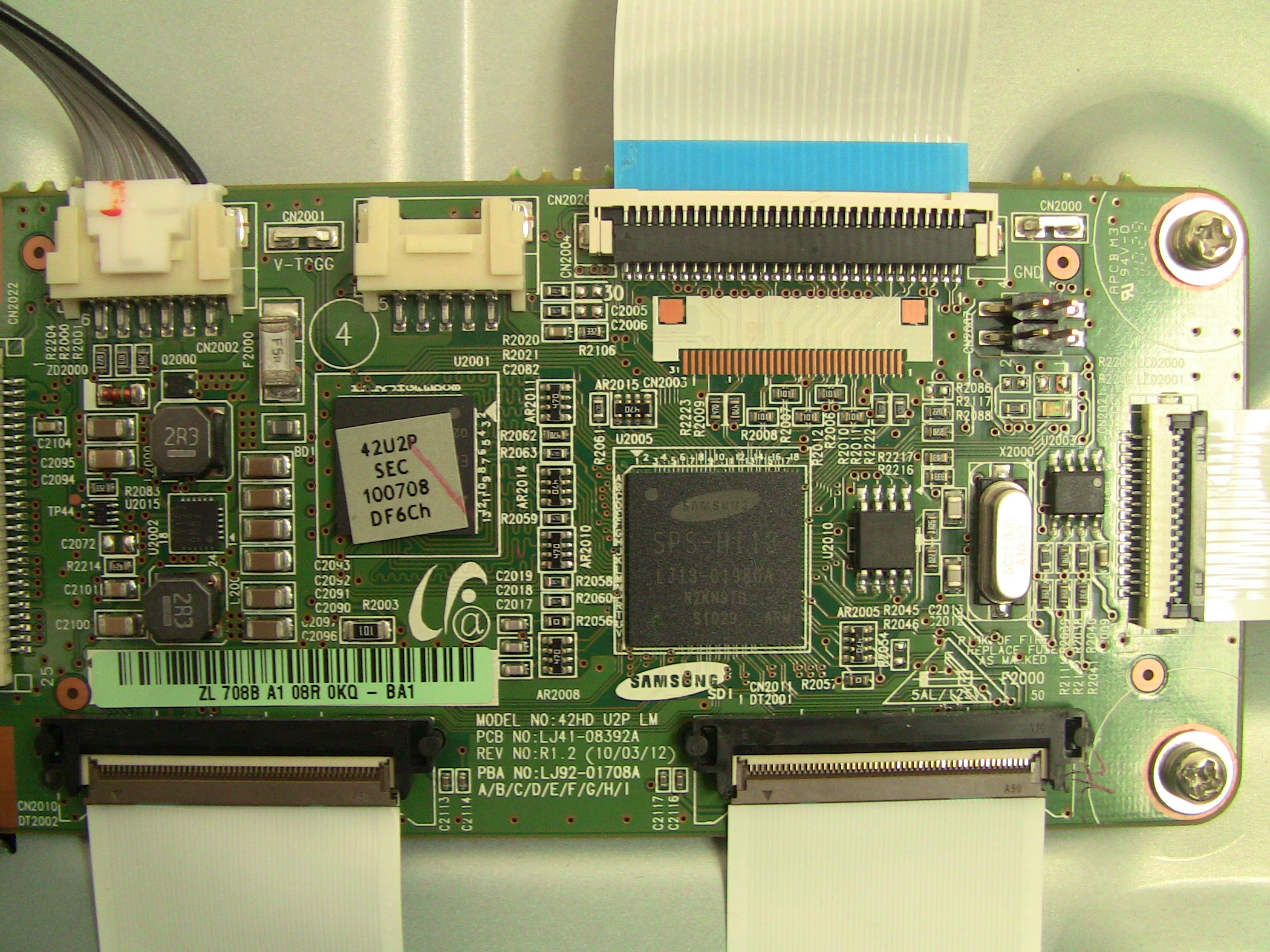

                  One thing I did not immediately consider was the possibility of the control board being bad.
                  Can I see a picture of the control board on your TV? I think it's under the main board on this mode.
                  • Bling23
                    • Dec 2012
                    • 153
                    #109
                    OK..coming right up

                        #111

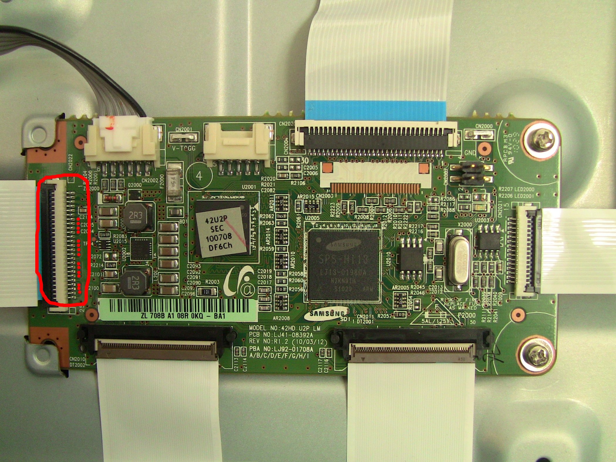

                        OK, can you check along this connector on each of the points I mark.
                        Set scope to 100us/div and centre horizontal (press the "HORIZONTAL POS" knob.)
                        If you see no waveform (more or less straight line), note that.
                        If you see a waveform, please take a picture or screen capture.

                              #114

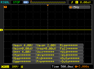

                              NO waveform ....and how did you do the drawing on the photo?
                                  I used GIMP image editor, it's free software and works great.

                                    #117
                                    Ok Tom..looks like I only get waveform when I power up and then it goes flat
                                      #118
                                      I suspect the control board.
                                      Have you tried this test?
