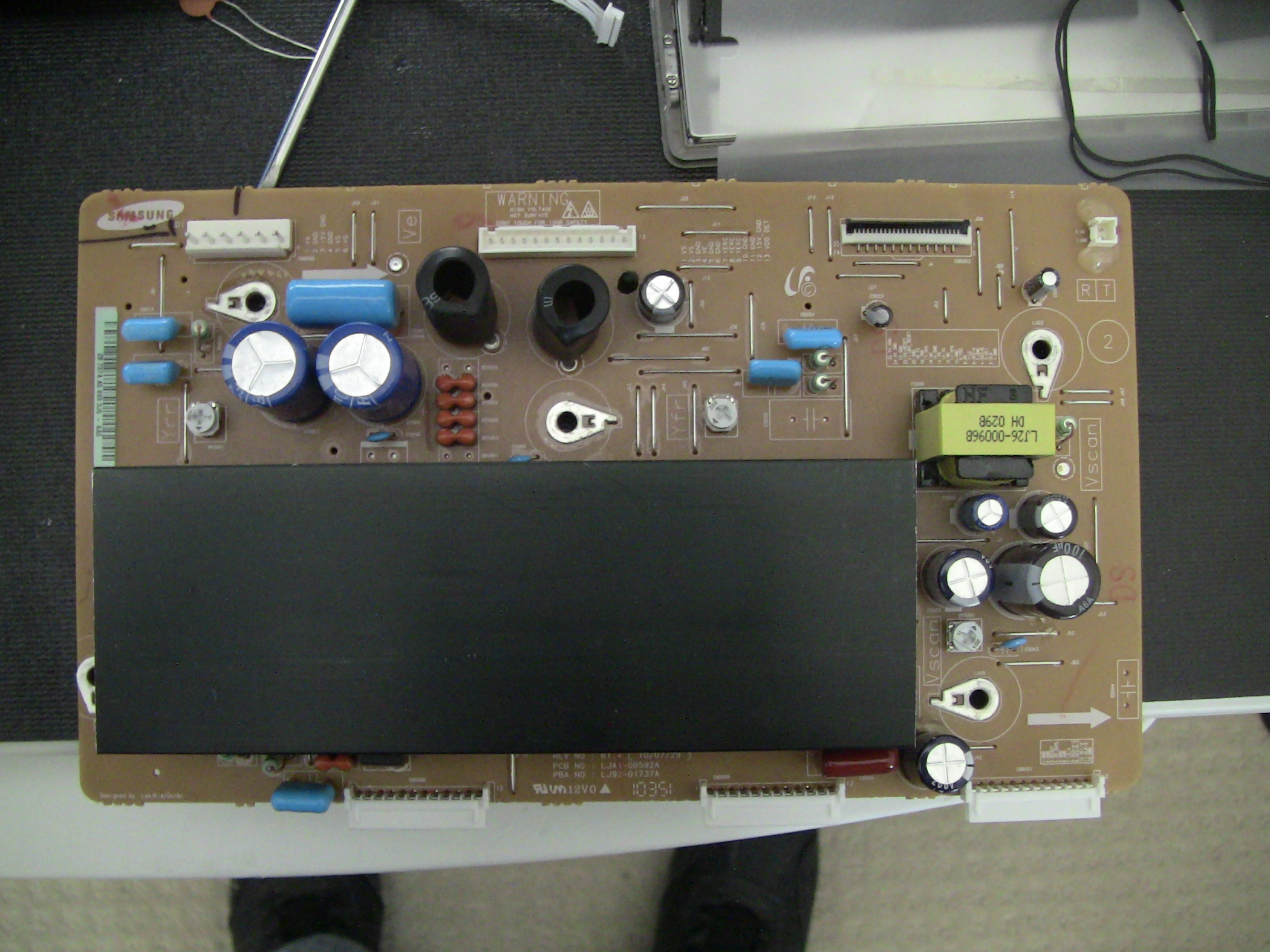

            Re: This guy has an RCA 42PA30RQ
            On the Y-main and X-main, yes, they are isolated from the mains power.

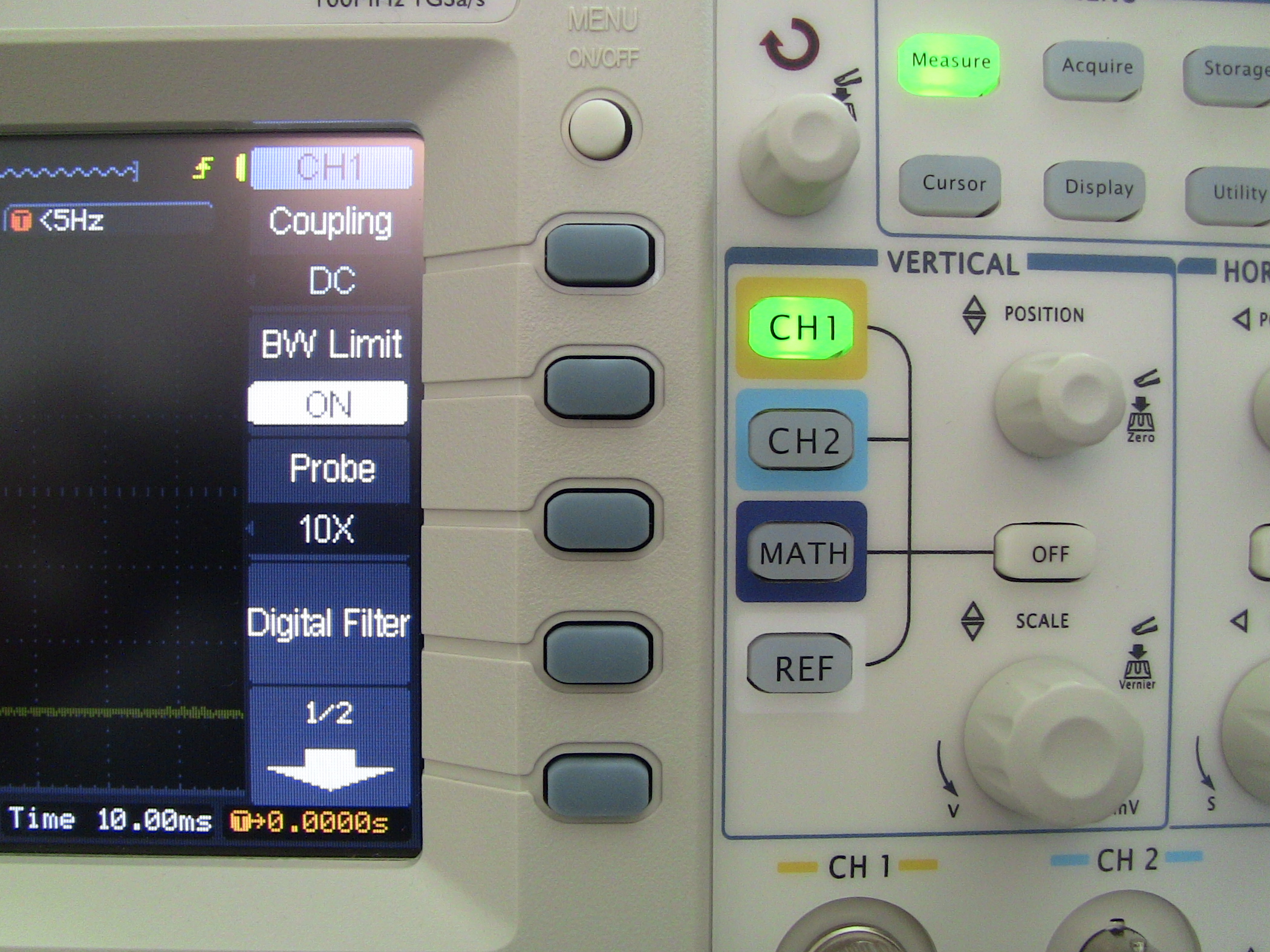

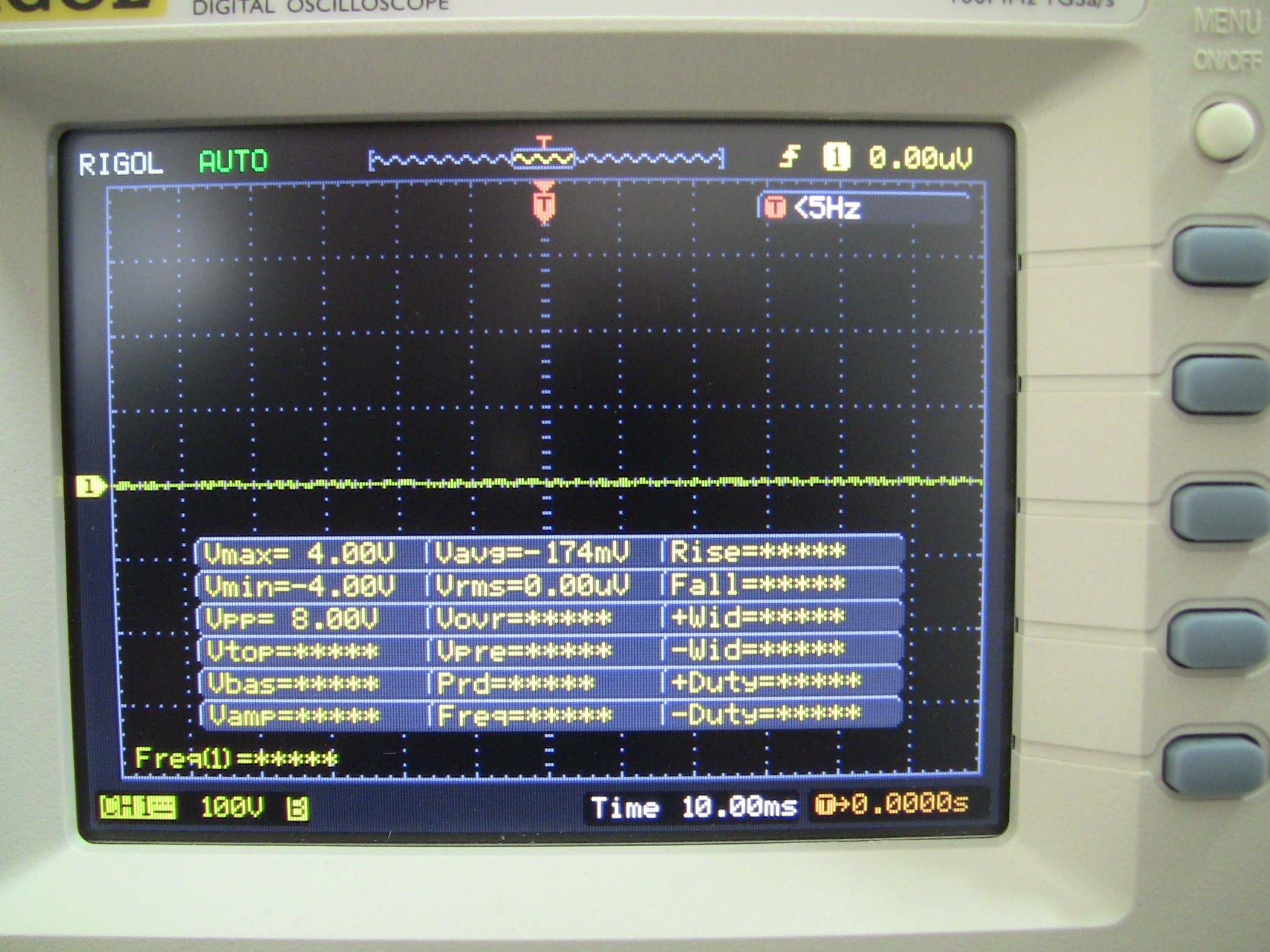

                Scope:
                - CH1 ON, CH2 OFF
                - DC coupled
                - BW limit ON
                - 10X probe
                - 100V/div
                - 10ms/div
                - Acquire mode: Long Mem
                - Set trigger to a few volts above VSCAN (will be indicated on PDP)

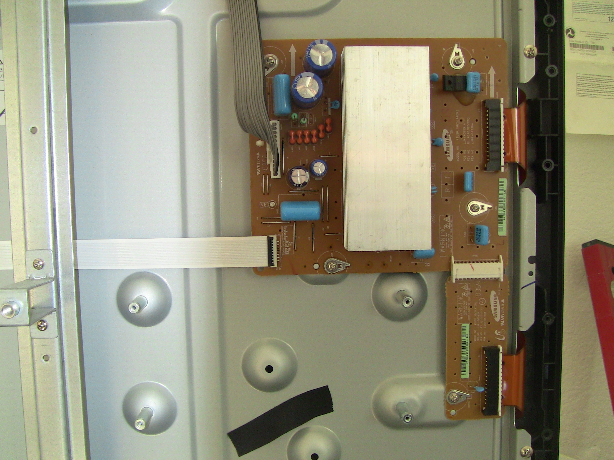

                Probe:
                - Set to 10X. Do not set to 1X.
                - Probe topmost lead of C5035 on Y-main. It's a poly film cap near the outputs to the buffers. Topmost as installed in TV.
                Use the Rigol's screenshot feature and upload a pic of what you see when TV is powered on.

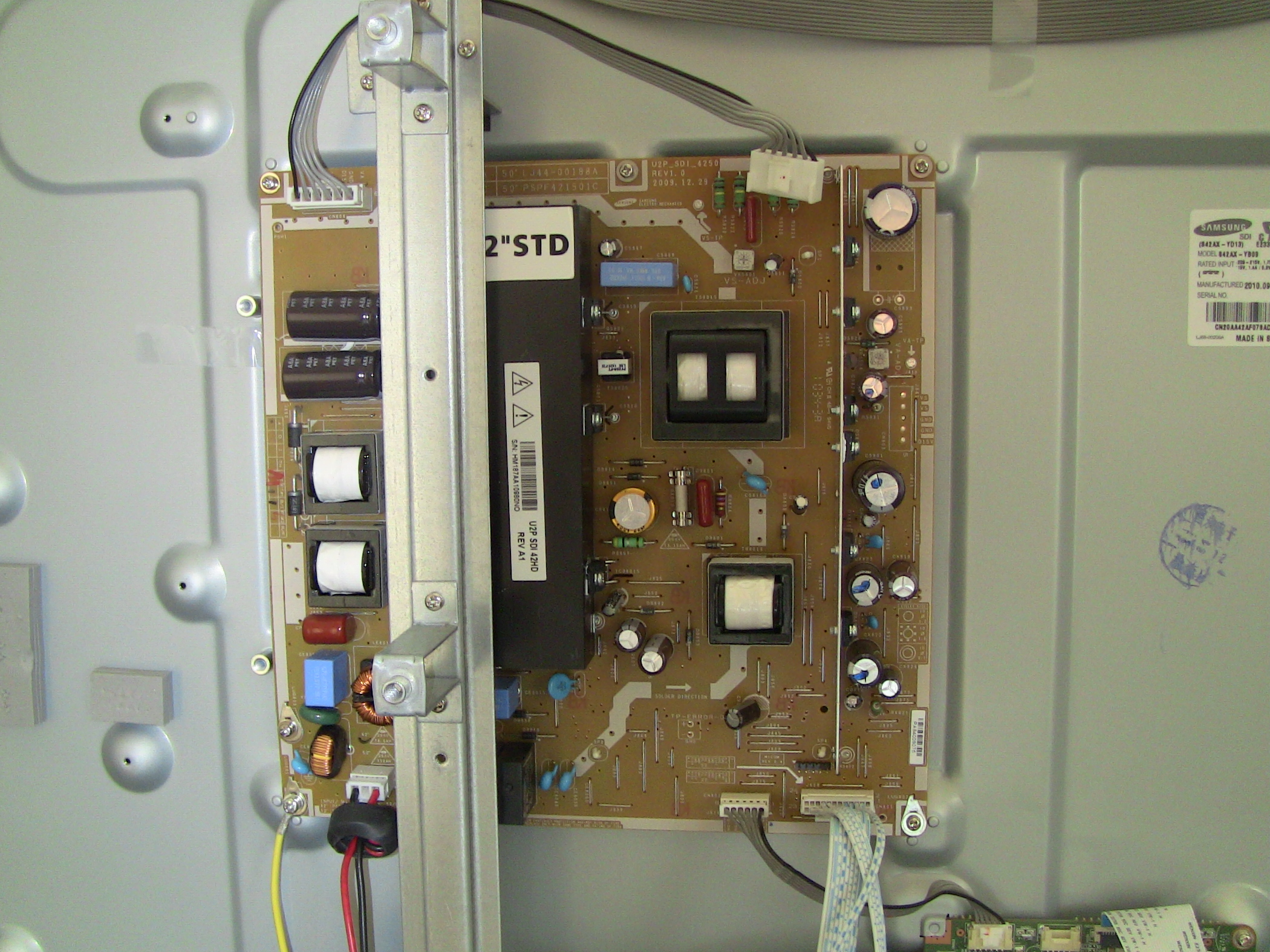

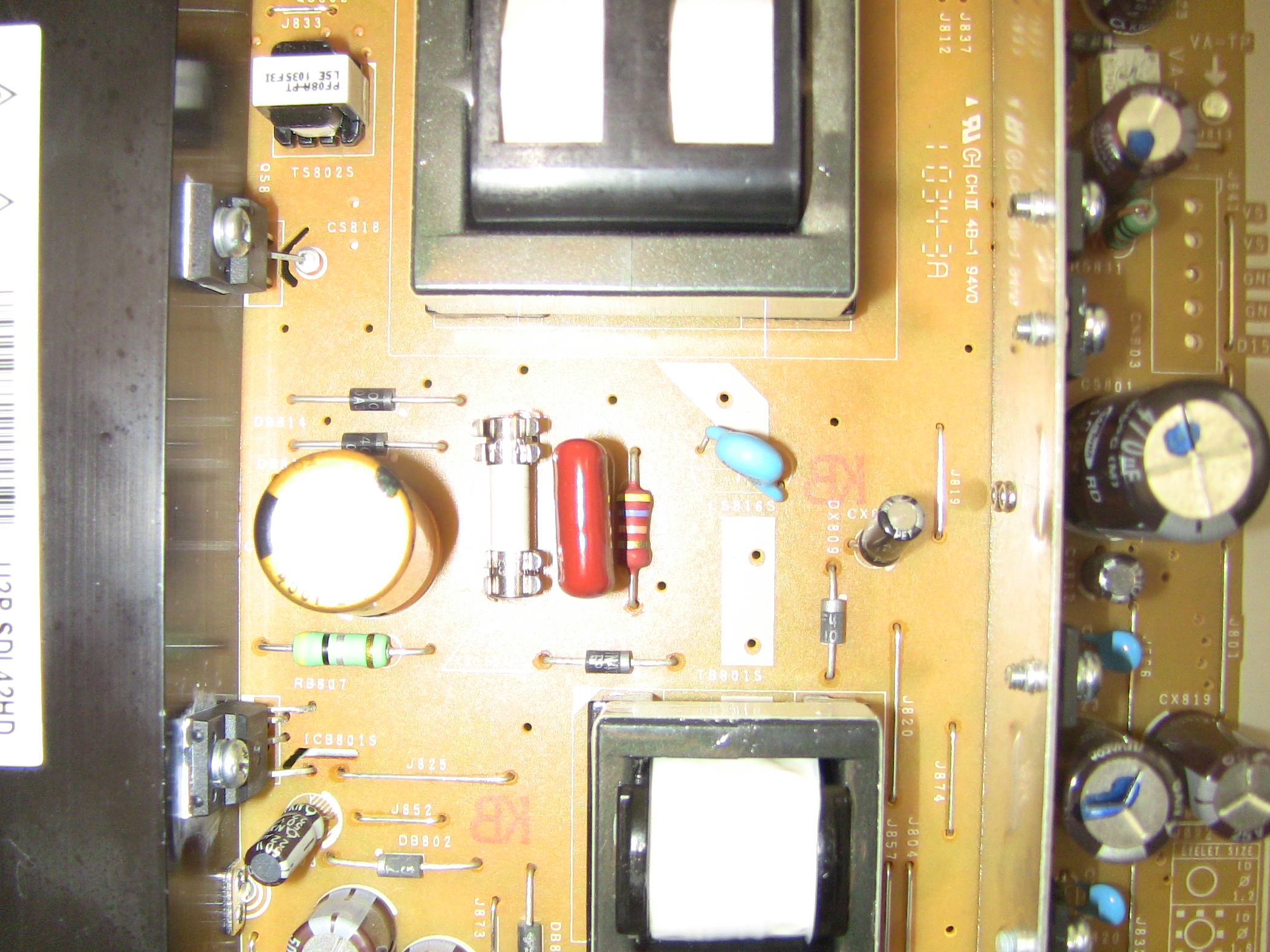

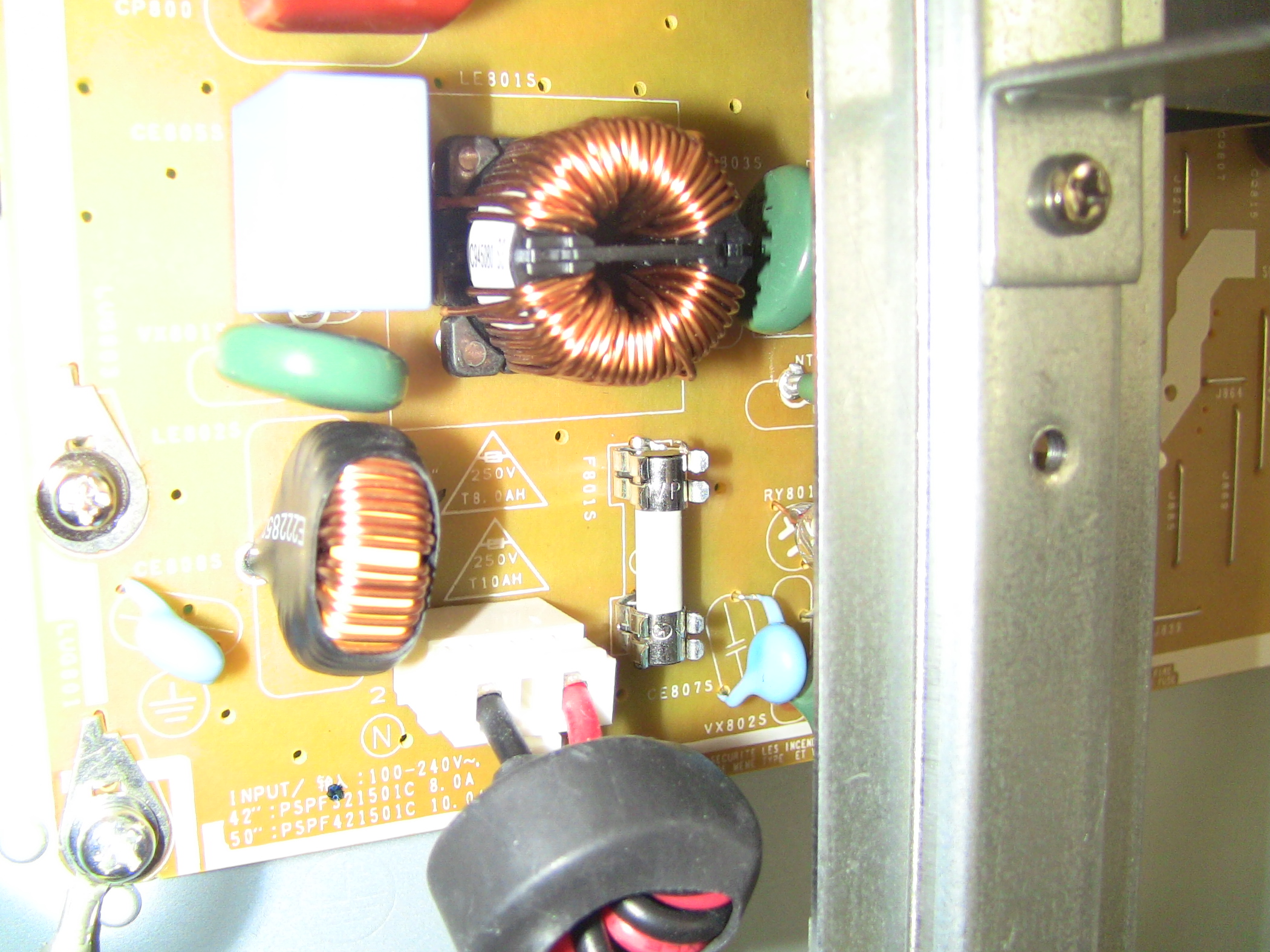

                  here are soem pics... the fuse on the PSU on the lower left side on primary side is the fuse that doesn't have any voltage reading

                    #29

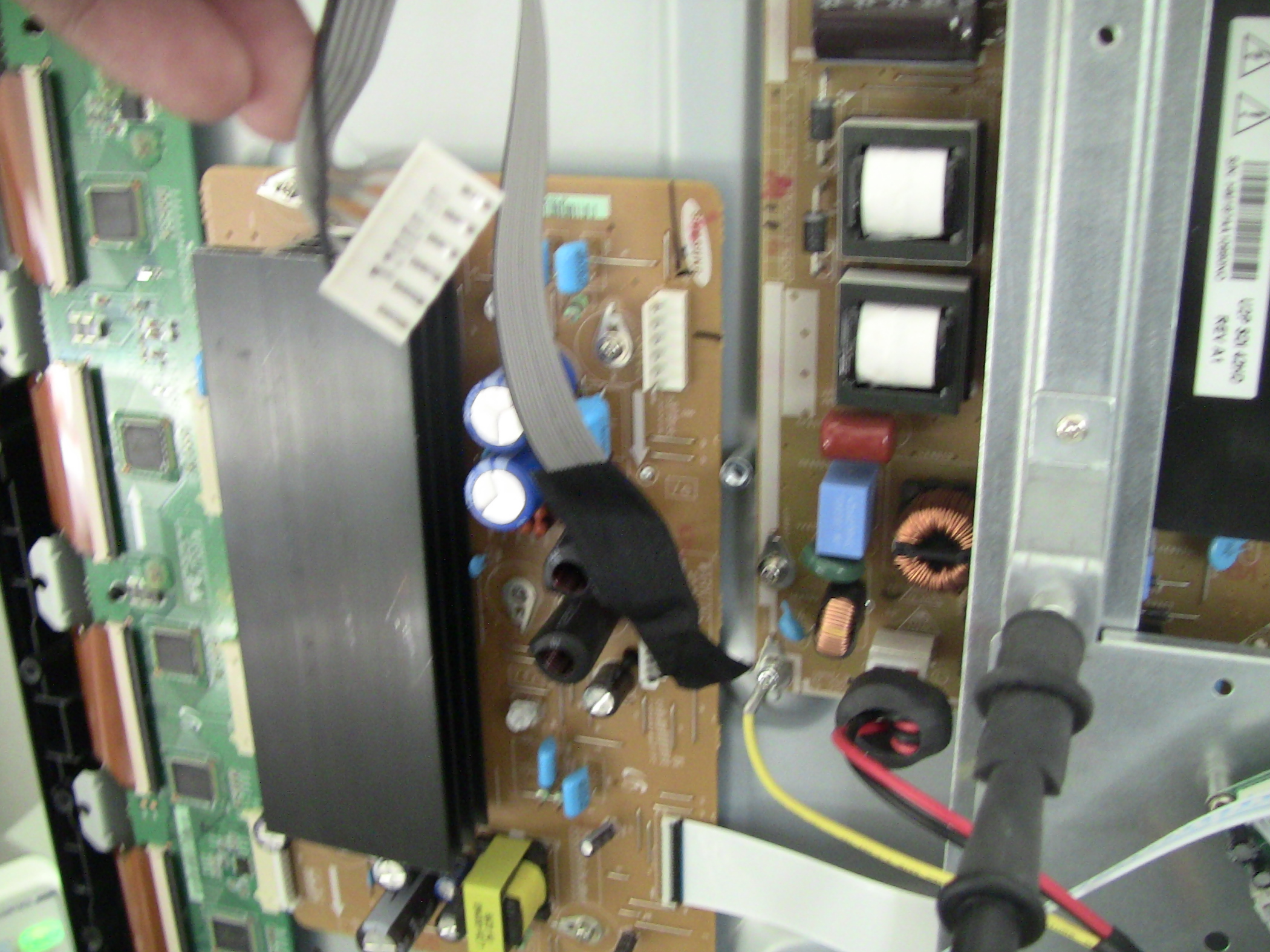

                    scope set and probe set....checking CN 5003

                      cn 5035 i meant

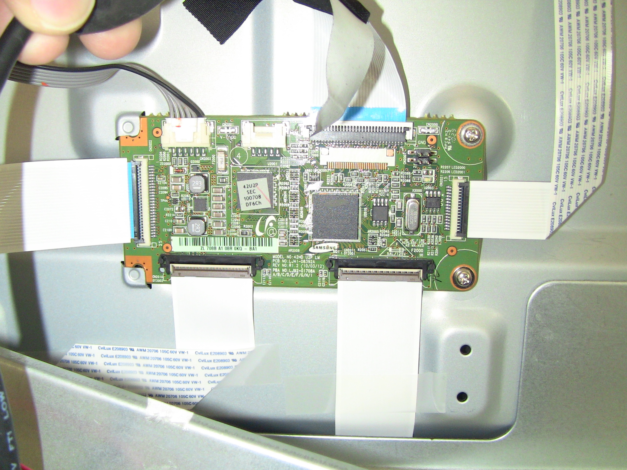

                        Looks dead to me. Logic board LED blinking?

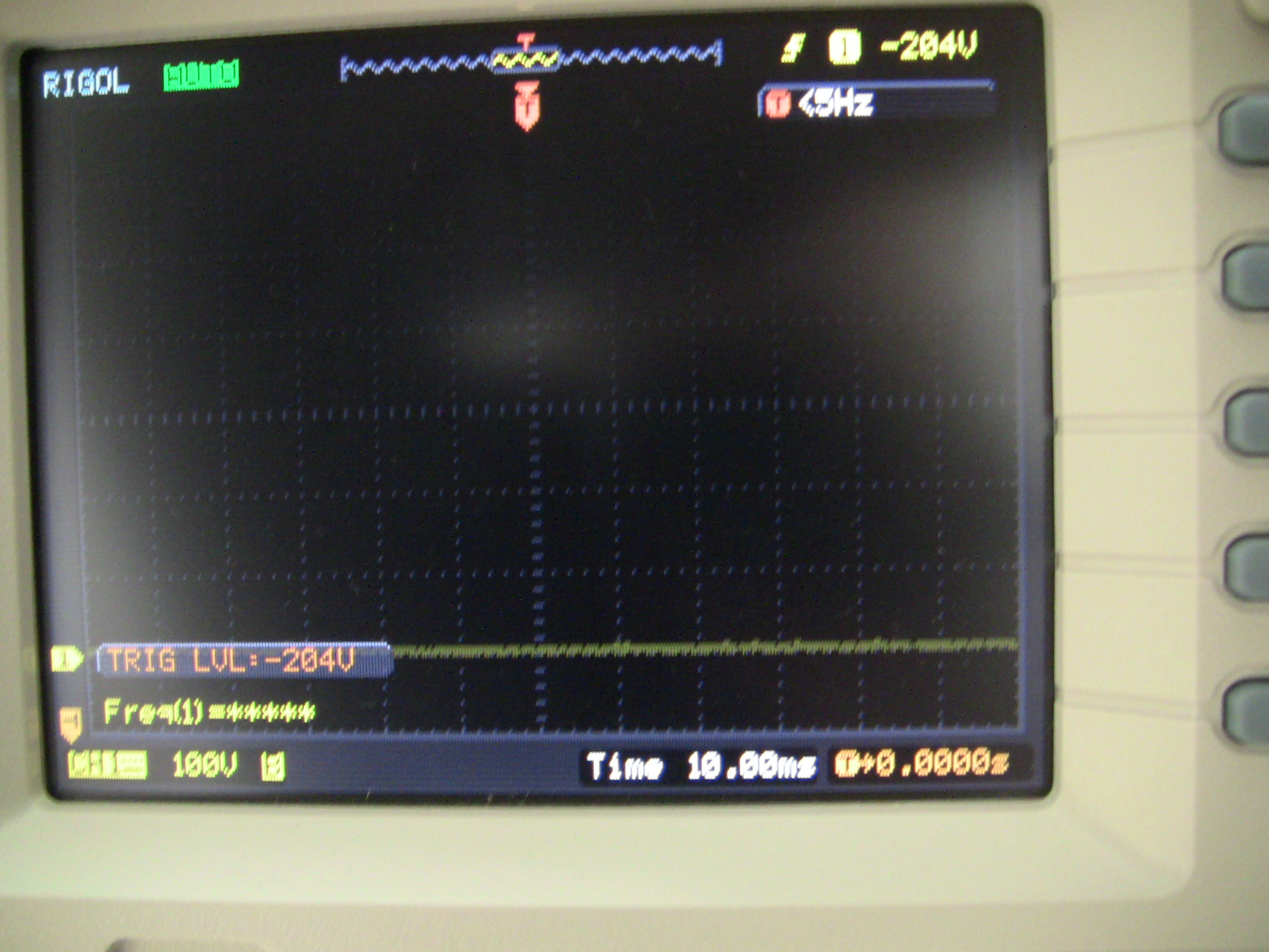

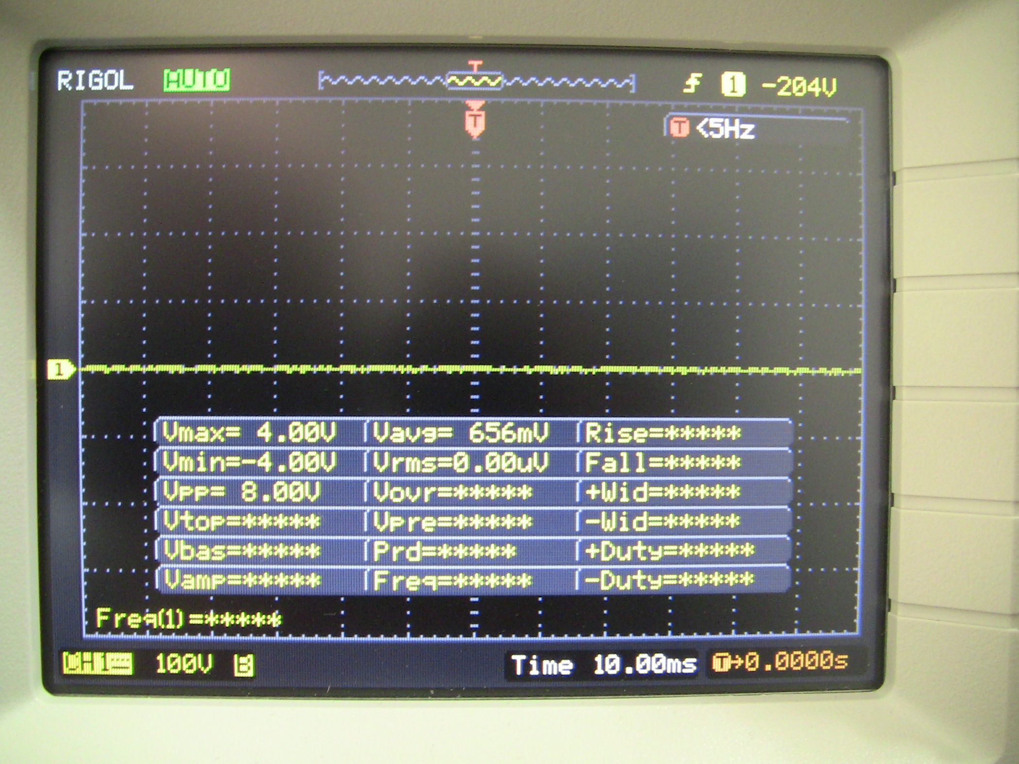

                          neg that was just a pic of the scope set up...heres what its doing..had to push auto to get a reading

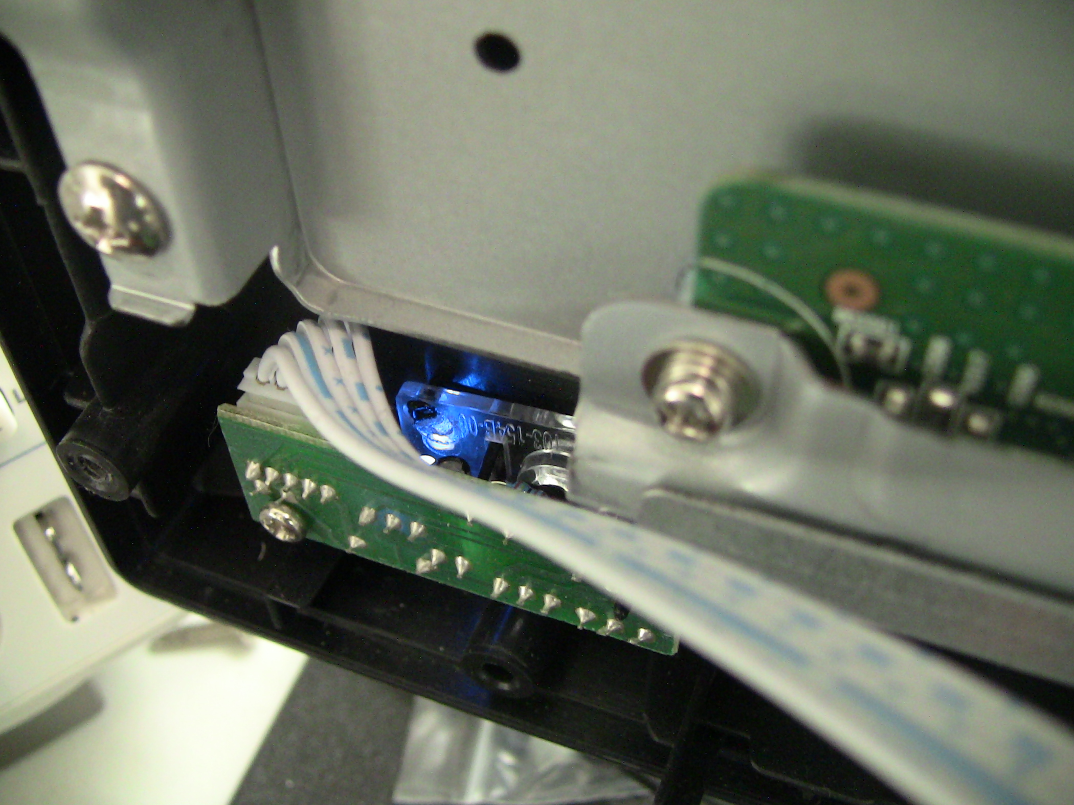

                            LED light is blinking on logic board
                              Leave it in the settings I said. You are seeing "essentially" zero.

                                ok this what it shows with your settings...

                                  i hear humming sound coming from the X-main
                                    #37
                                    Dead. Very dead. Vs/Va good? Check X-main too.

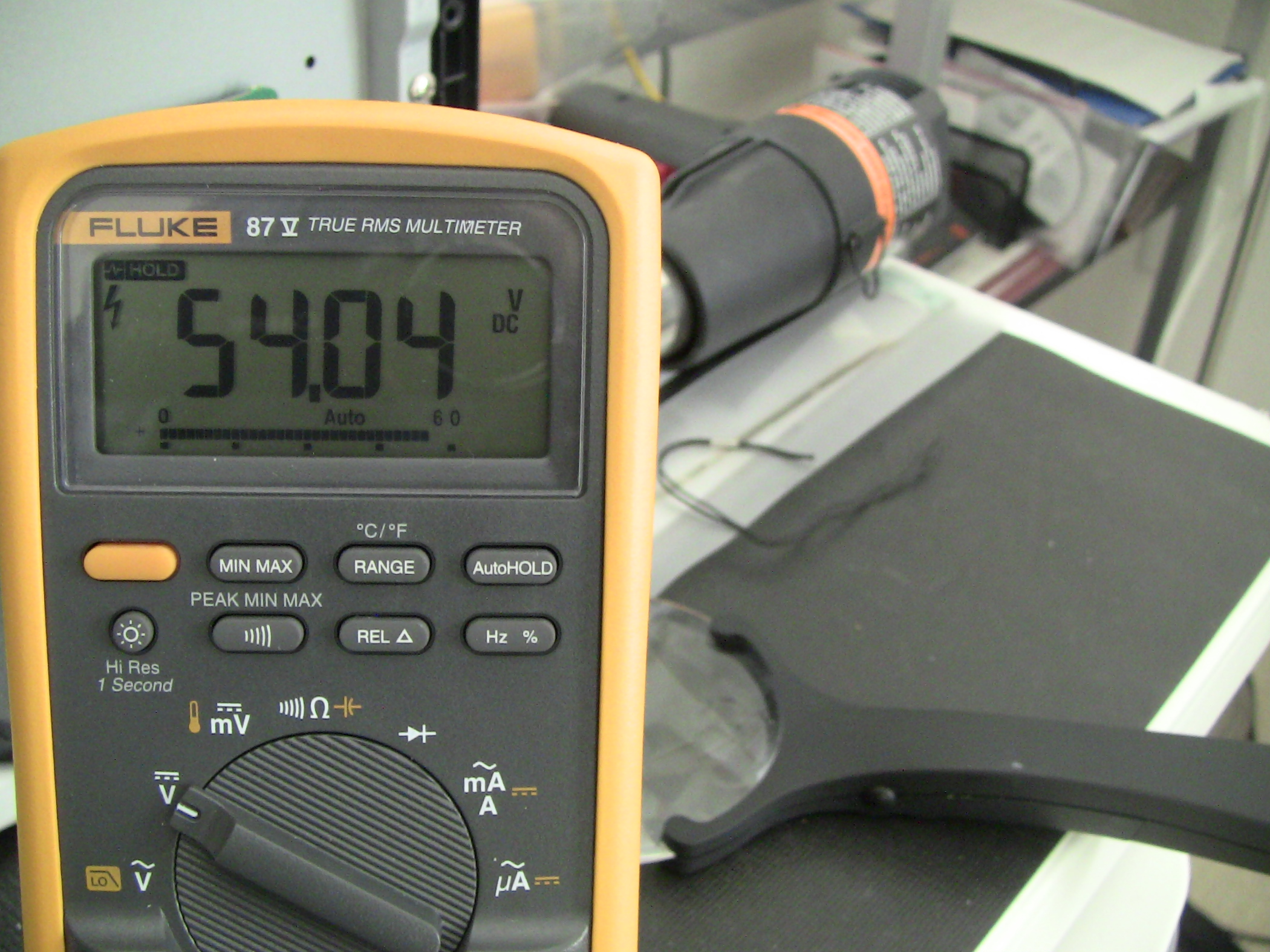

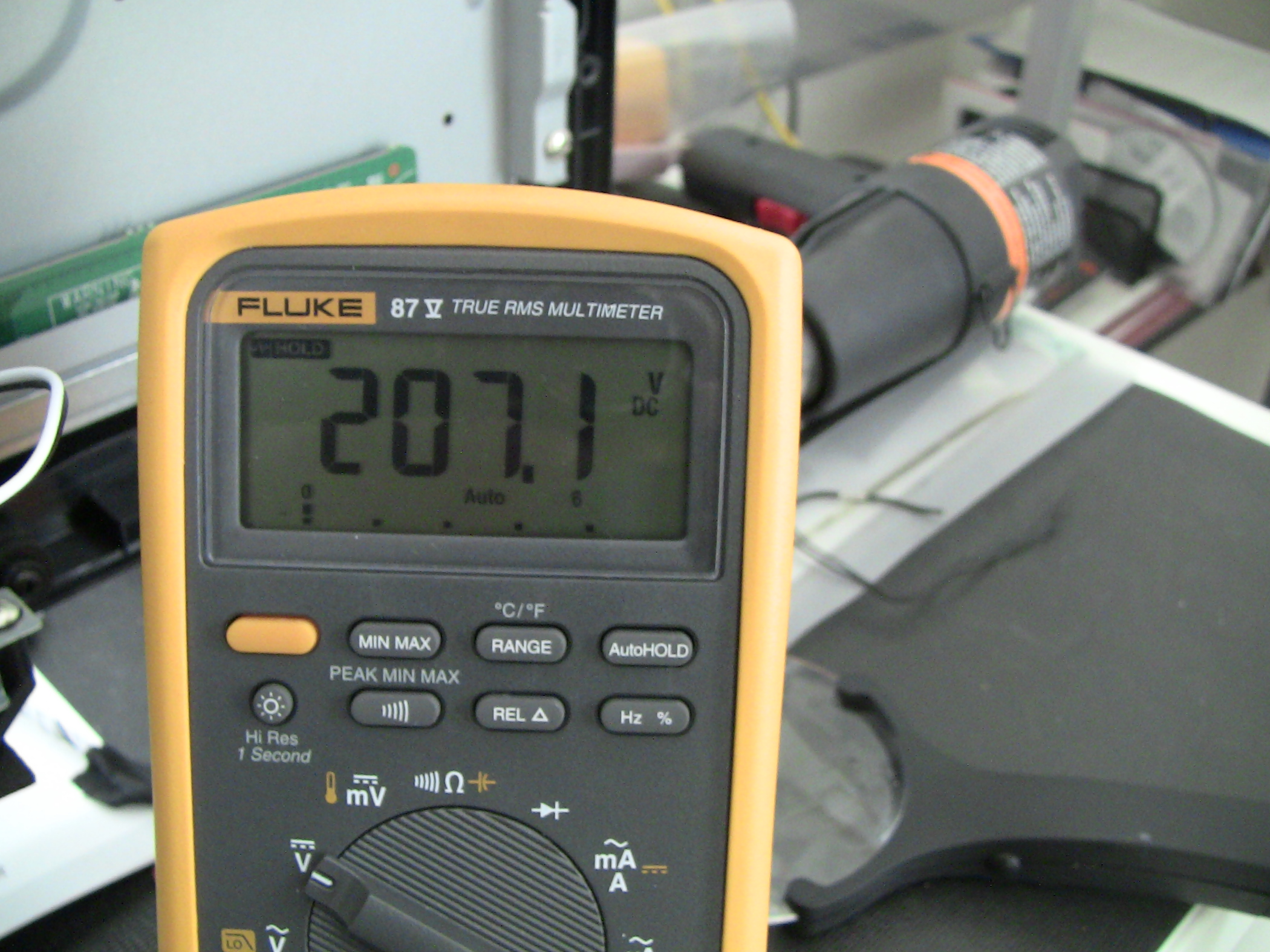

                                        Does Vs/Va rise with Y-main unplugged?

                                          it sure does...i get 207 Vs and 54 Va...blue LED light on....no mutliple clicking from the relays
