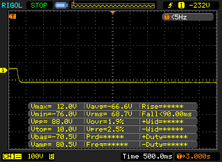

                  #88
                  Re: This guy has an RCA 42PA30RQ
                  y-buffer disconnected
                    #89
                    More or less the same. So Y-main or control board is failed. Can you repeat the test on the X-main side?

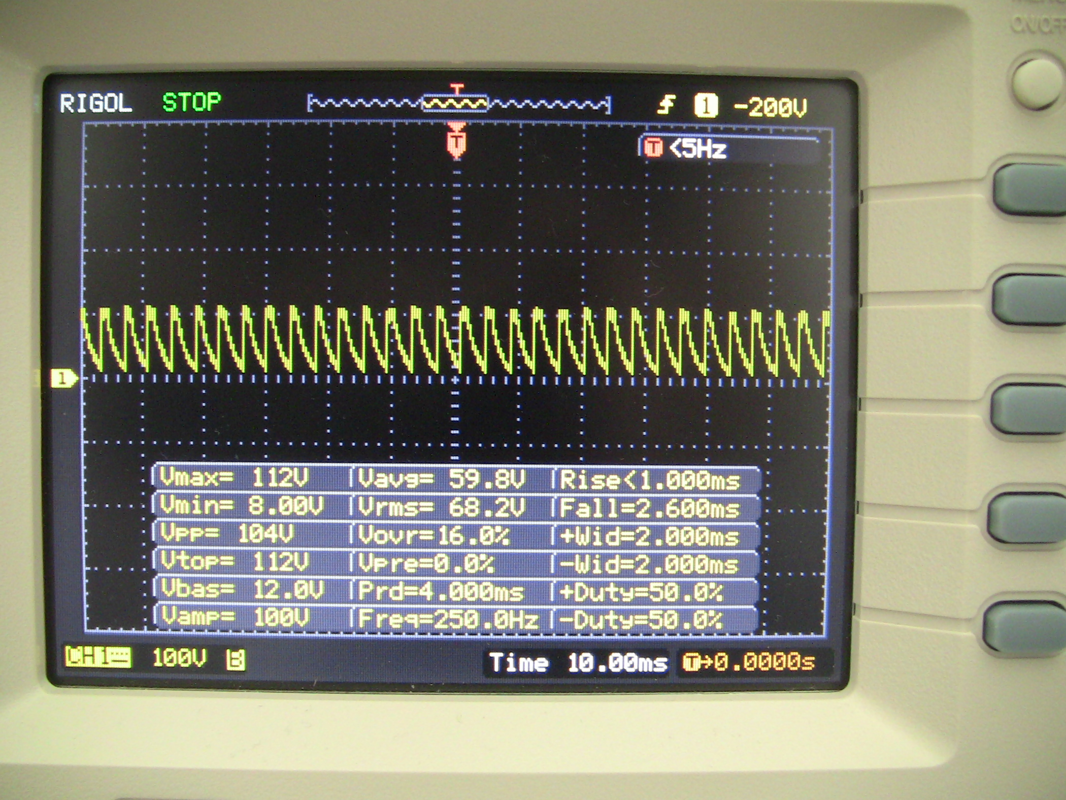

                        #91
                        this is the waveform when probing the VE testpoint on the y-main
                          #92
                          Interesting -- definitely something appear shorted. However, I meant to test the X output. This is what goes to the orange ribbon on the righthand side.

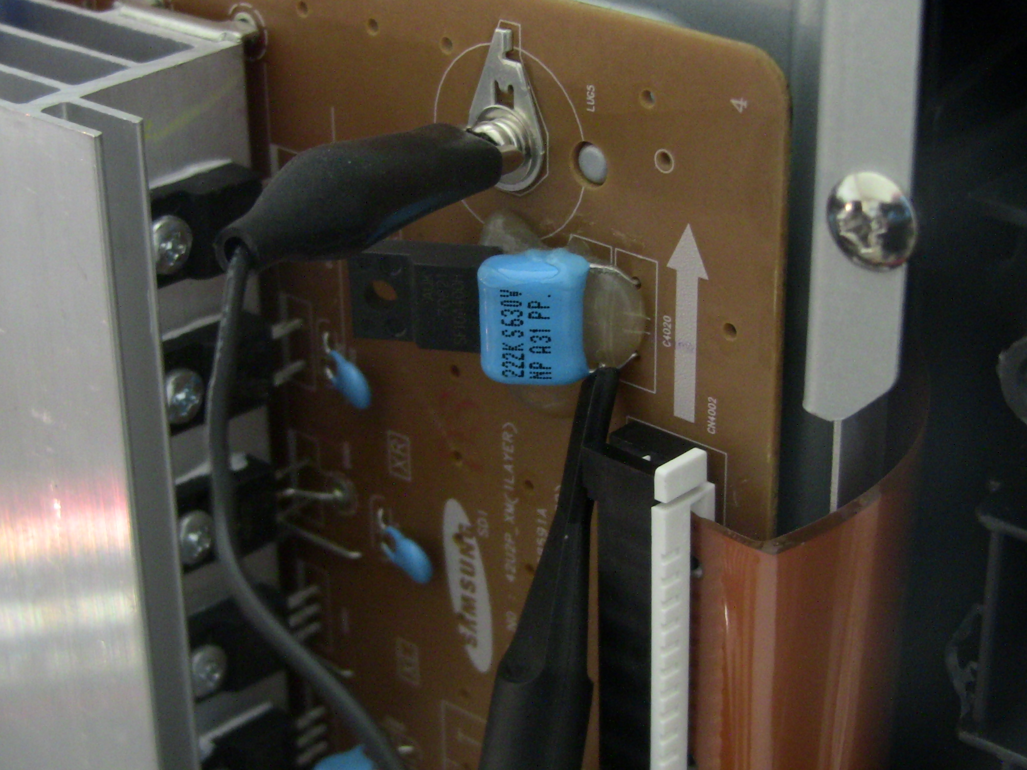

                                    #97
                                    where do you want me to hook up probes on the x-main..on the VE testpoint?
                                      #98
                                      On C4020, the leg closest to the black connector.
                                      • Bling23
                                        • Dec 2012
                                        • 153
                                        #99
                                        this is how i have it set up
                                          #100
                                          Looks good to me. Your X-main is slightly different to my spare one -- mine does not have that diode -- but it's similar enough.
