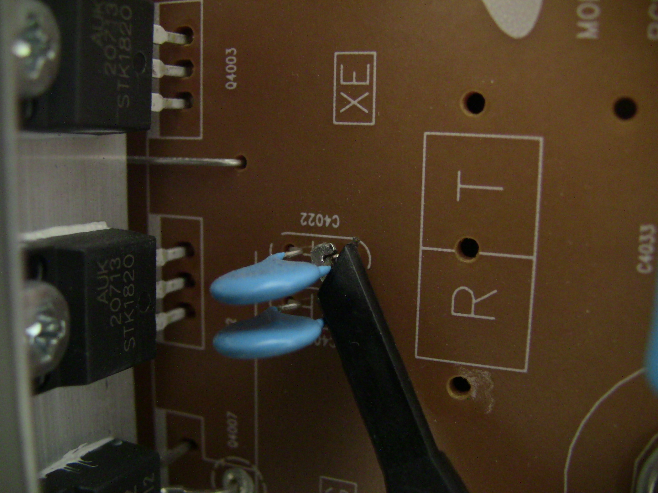

    Re: This guy has an RCA 42PA30RQ
    On the X-main test at bottom end of C4022.
    • Bling23
      • Dec 2012
      • 153
      #42
      c4022 is a small cap...but here is what i get
        #43
        My error. C4032.
        • Bling23
          • Dec 2012
          • 153
          #44
          LOL...got it but I get noting and i hear the humming from the x main

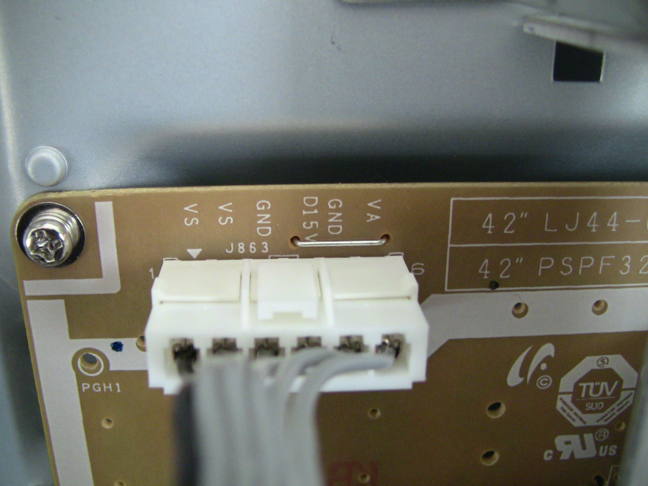

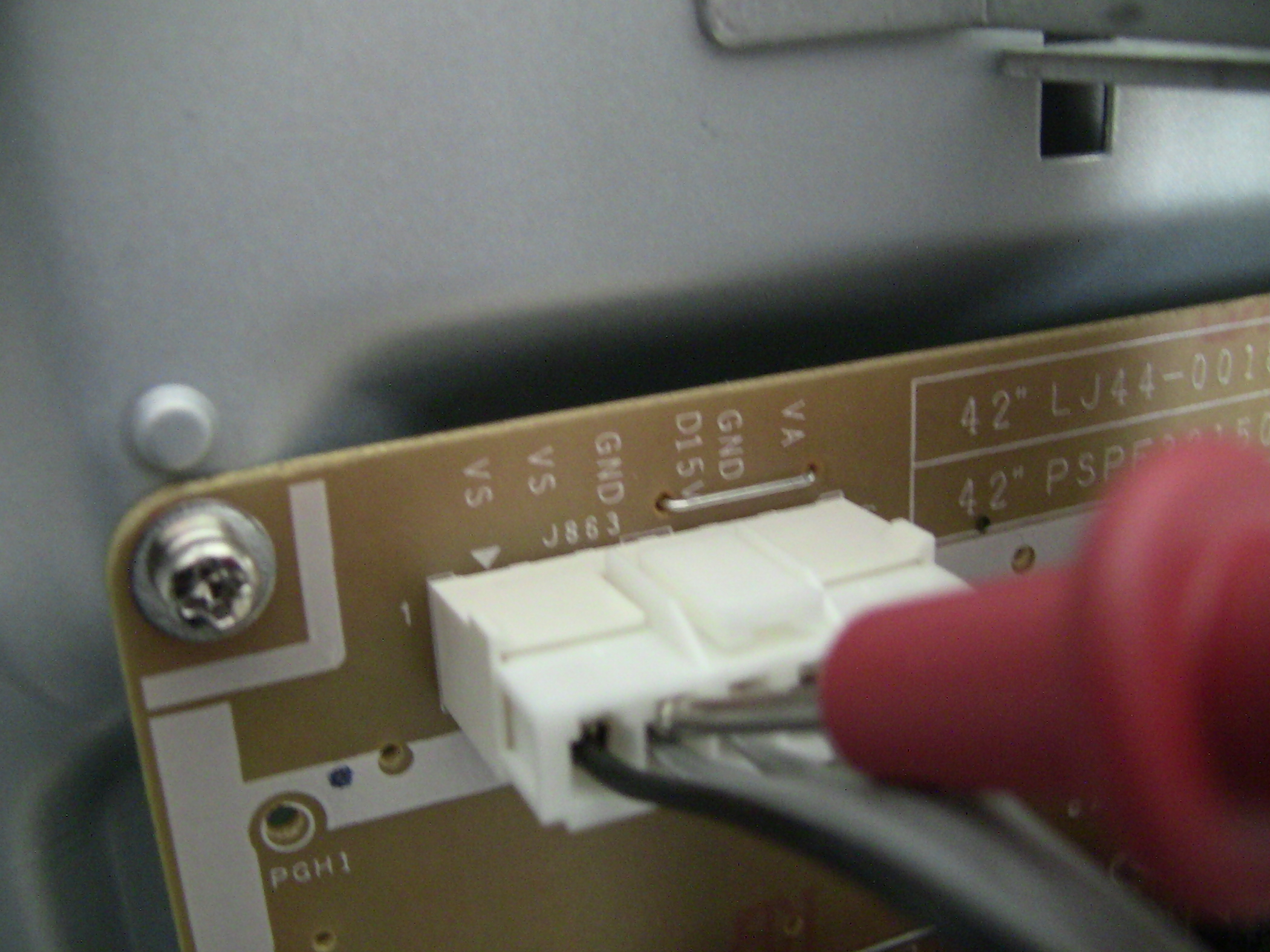

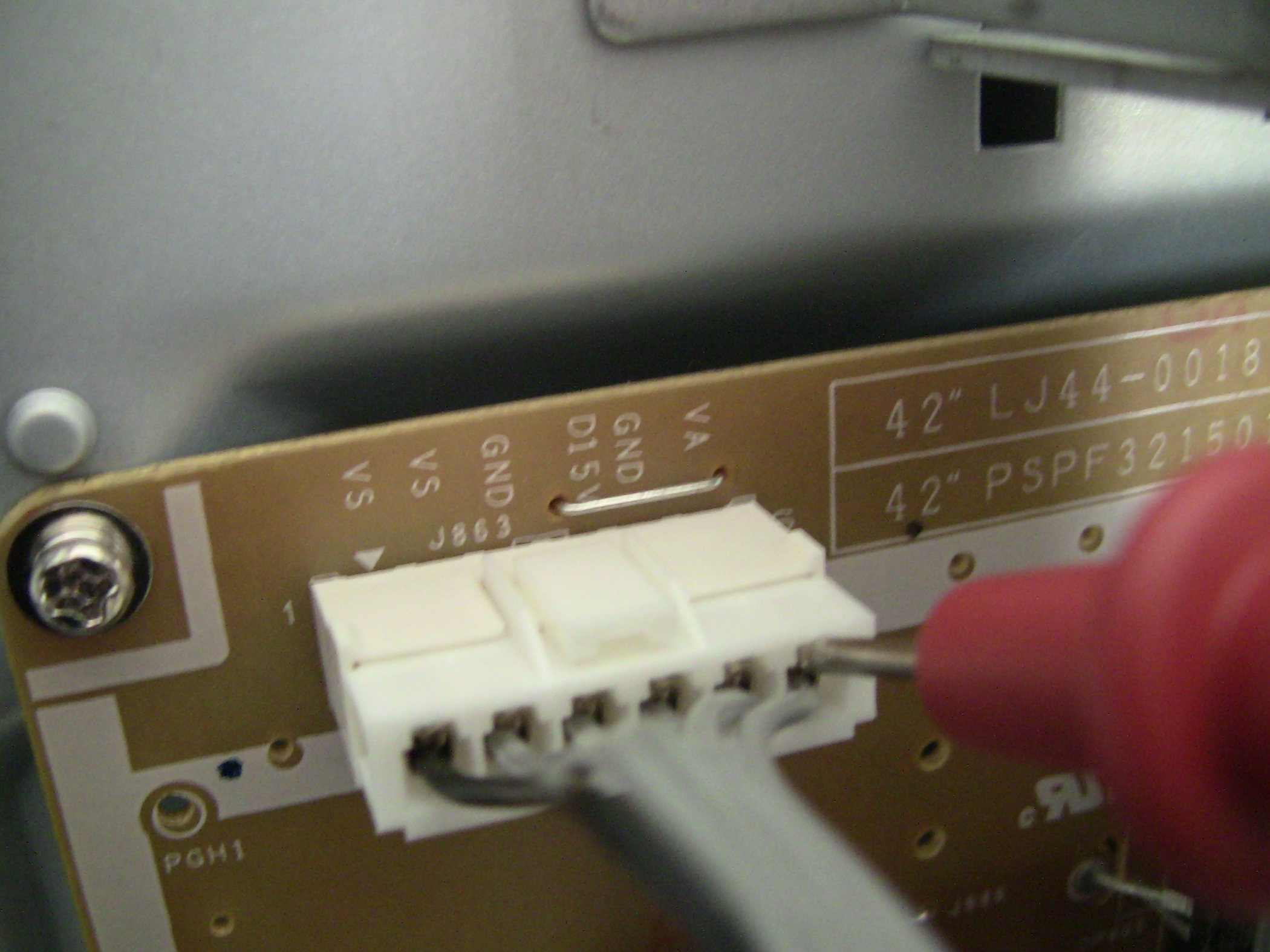

                          #52
                          Blinking light indicates control board is running.
                          When you removed the Y-main it's possible you damaged it from ESD...
                          • Bling23
                            • Dec 2012
                            • 153

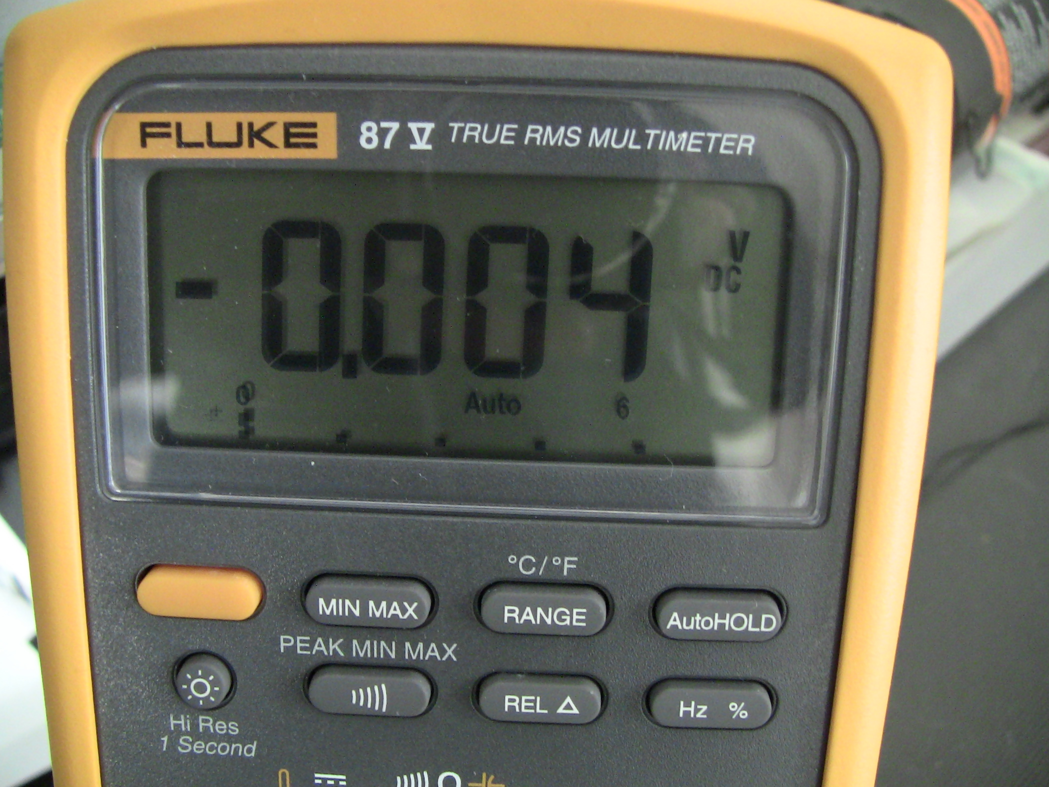

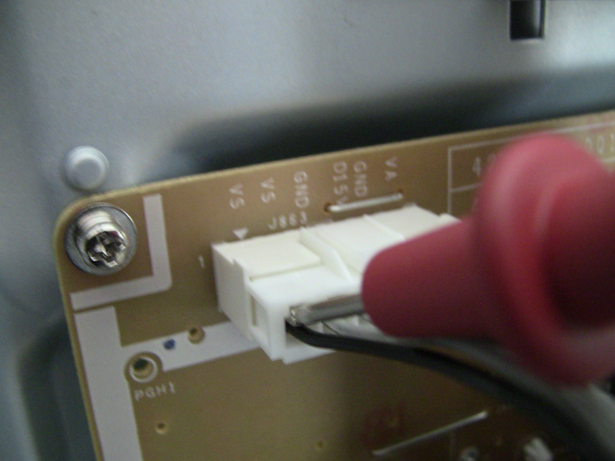

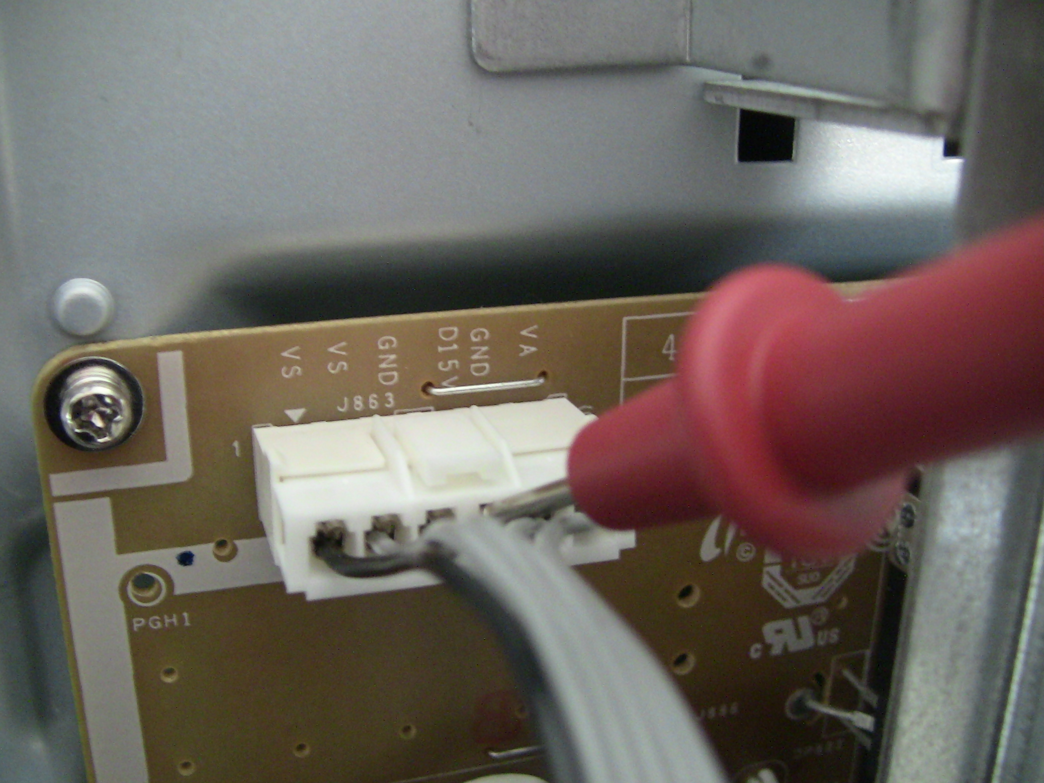

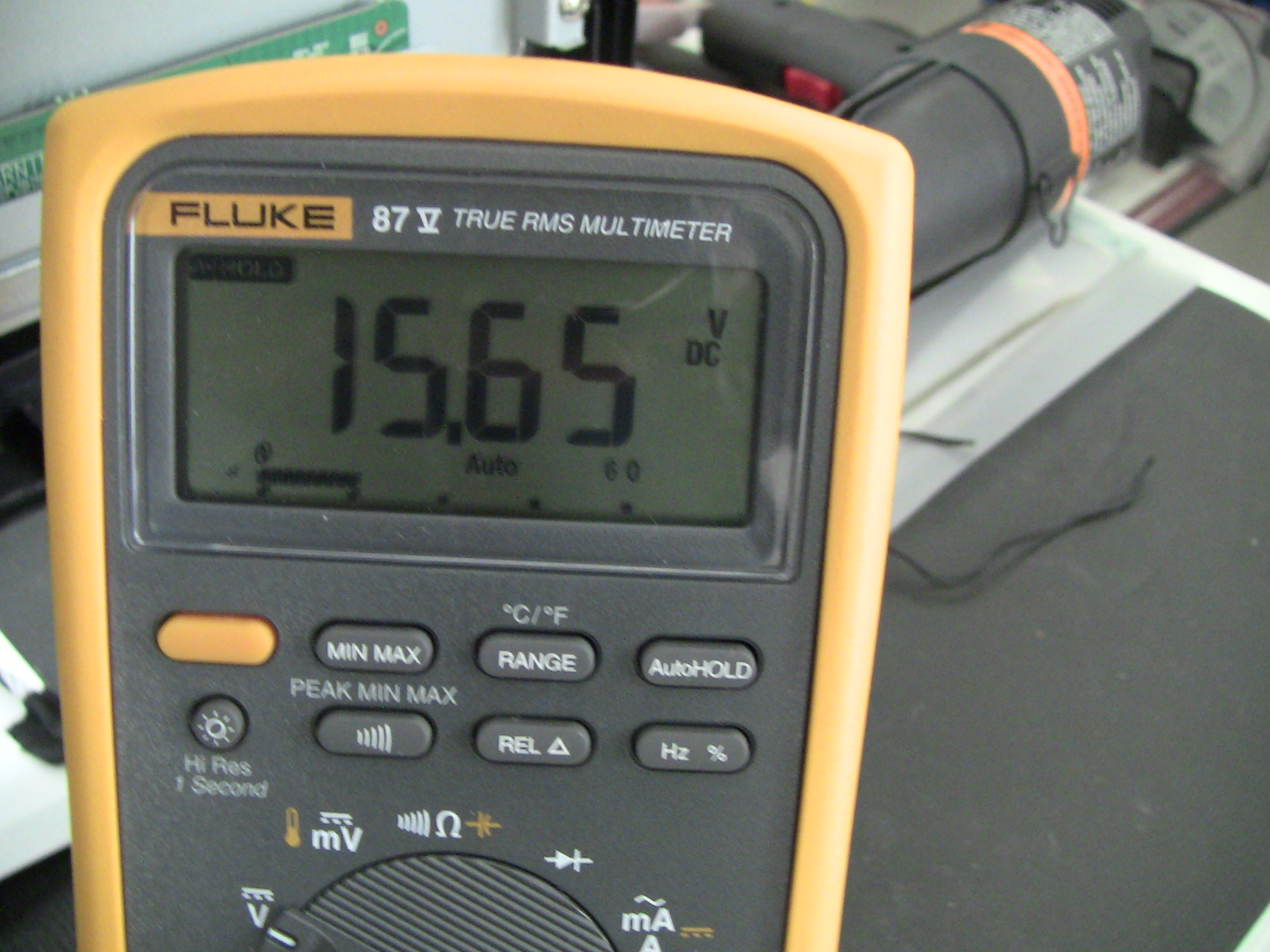

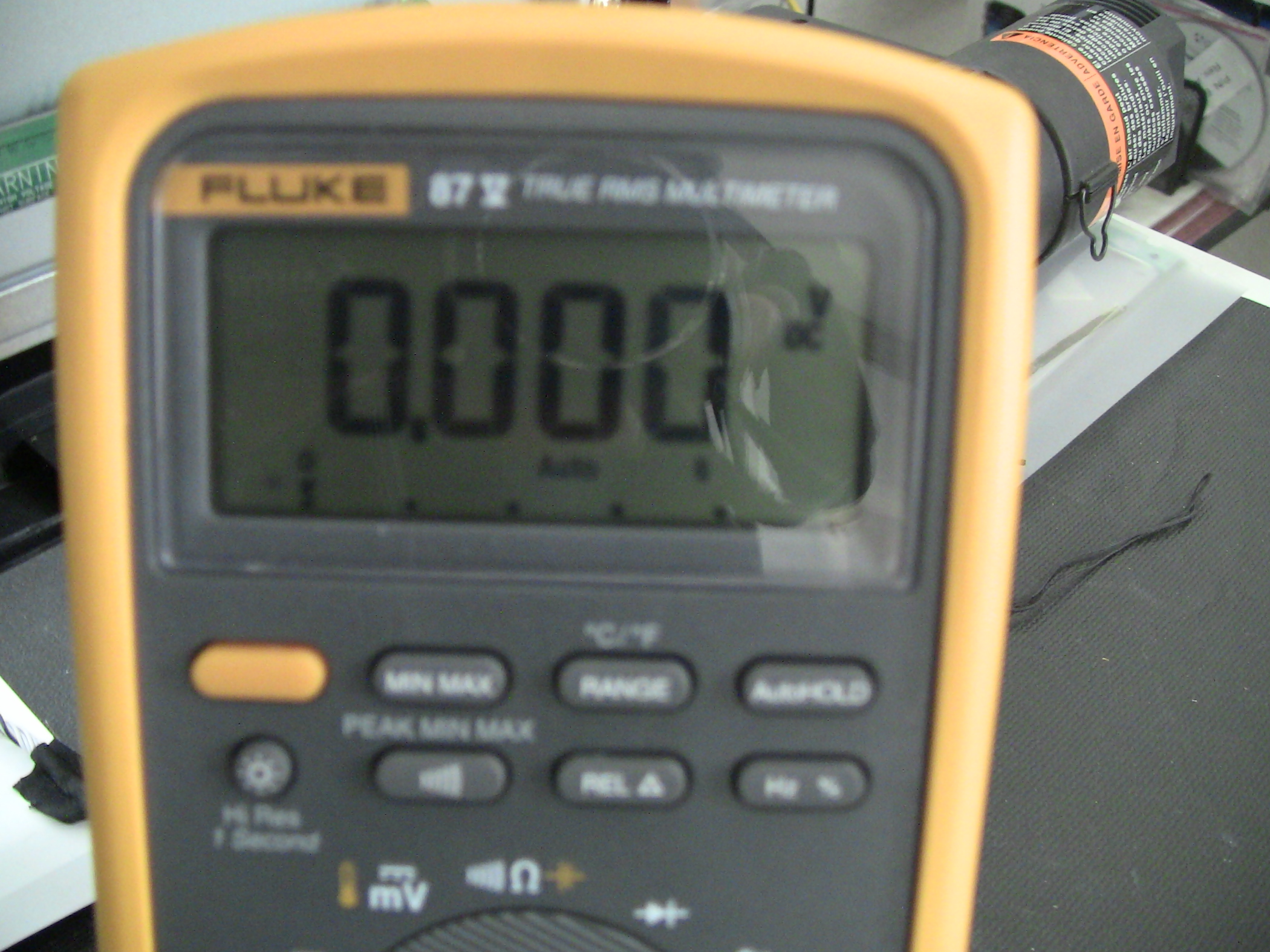

                            #53
                            with X-main unplugged from the Y-main...I get zero volts Va... 15 volts on the D15v pin an zero volts Vs
                            • Bling23
                              • Dec 2012
                              • 153

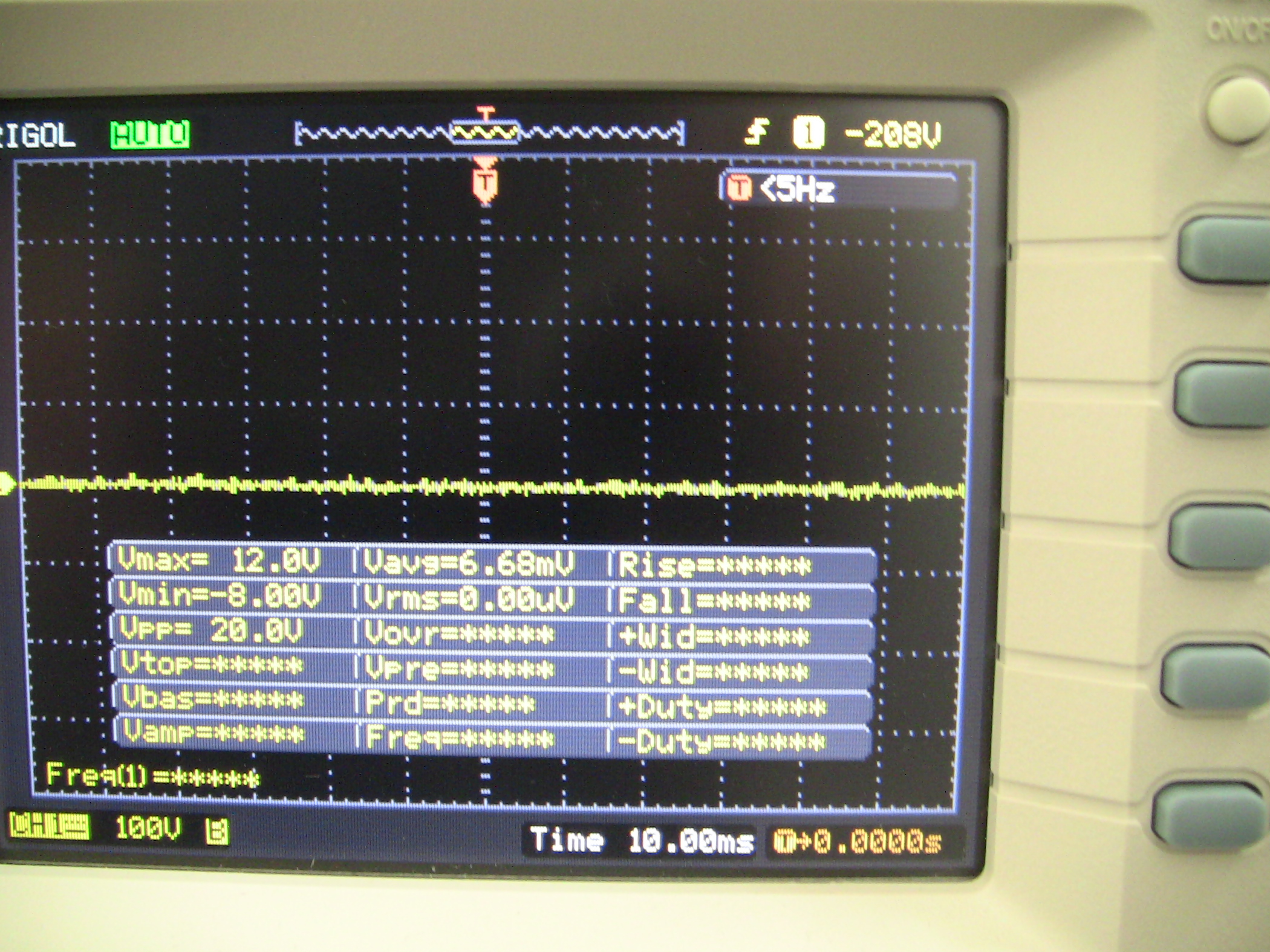

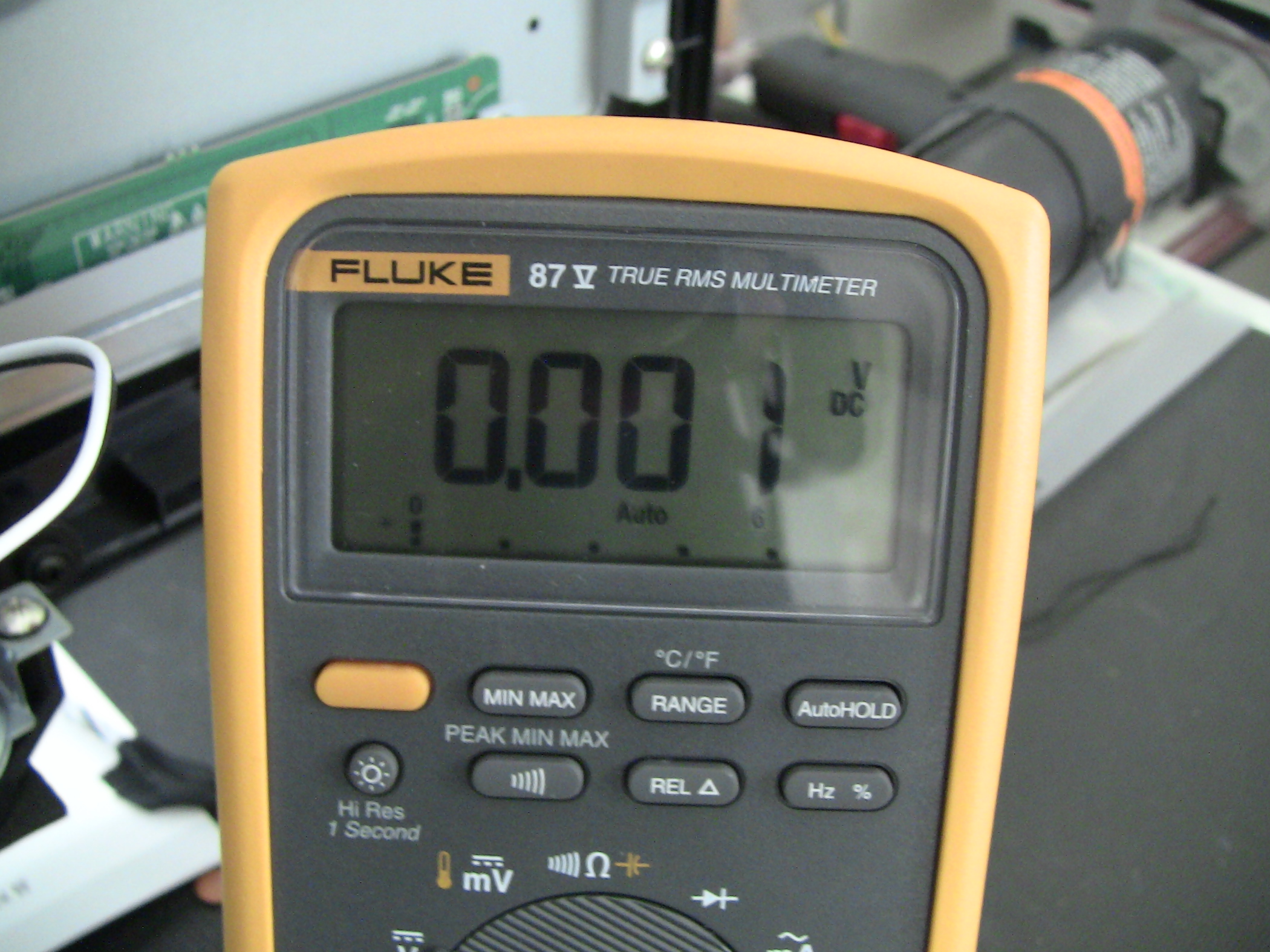

                              #54
                              here are the readings in order of the pics...
                                #55
                                The Y-main is most likely bad then.
