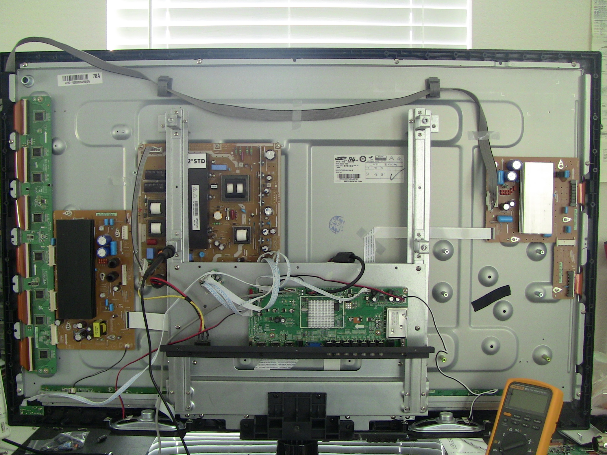

    Re: This guy has an RCA 42PA30RQ

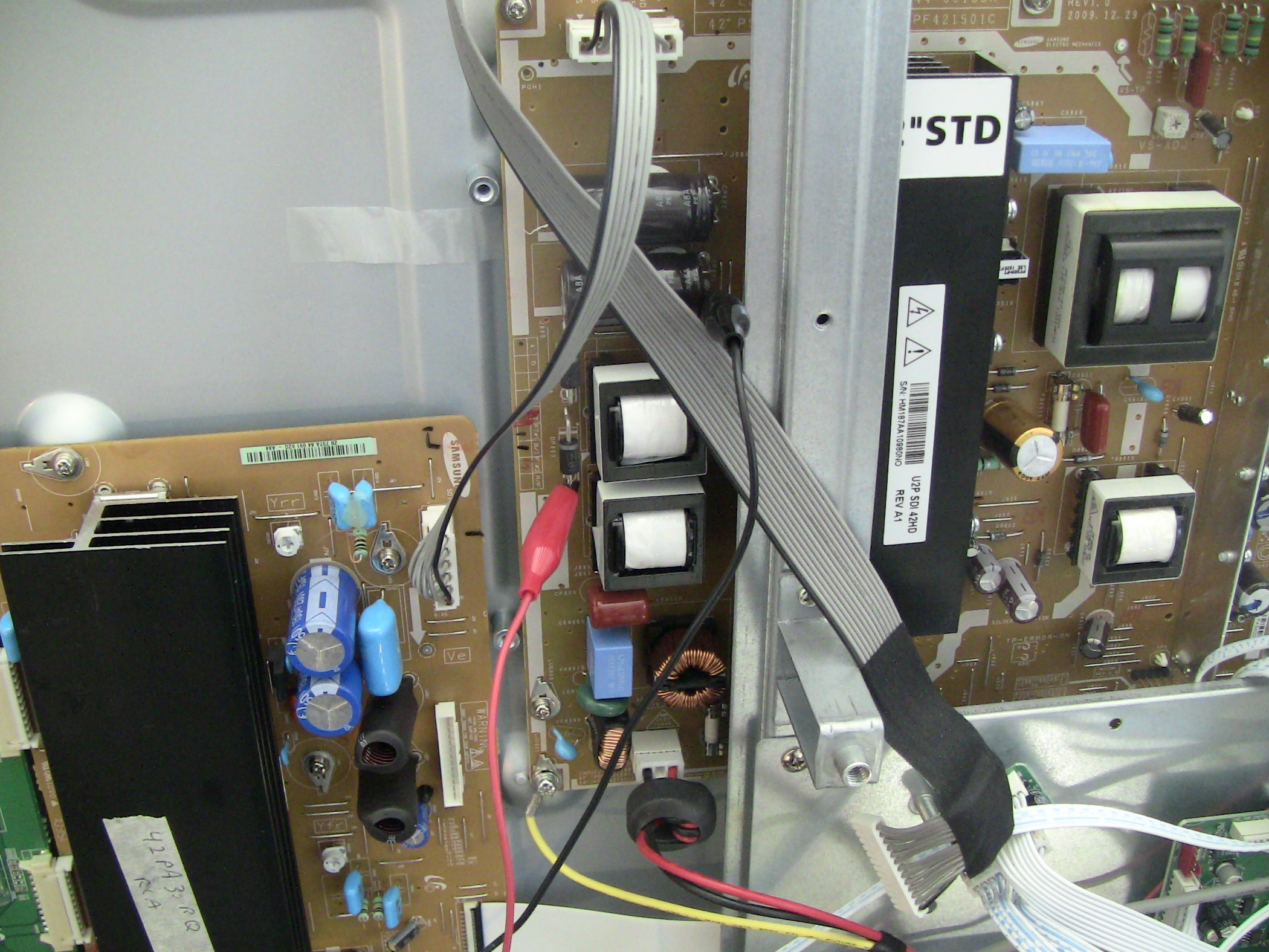

    I actually have the boards in front of me ripped out of a Wii victim
    • Bling23
      • Dec 2012
      • 153
      #62
      over view shot for all the viewers

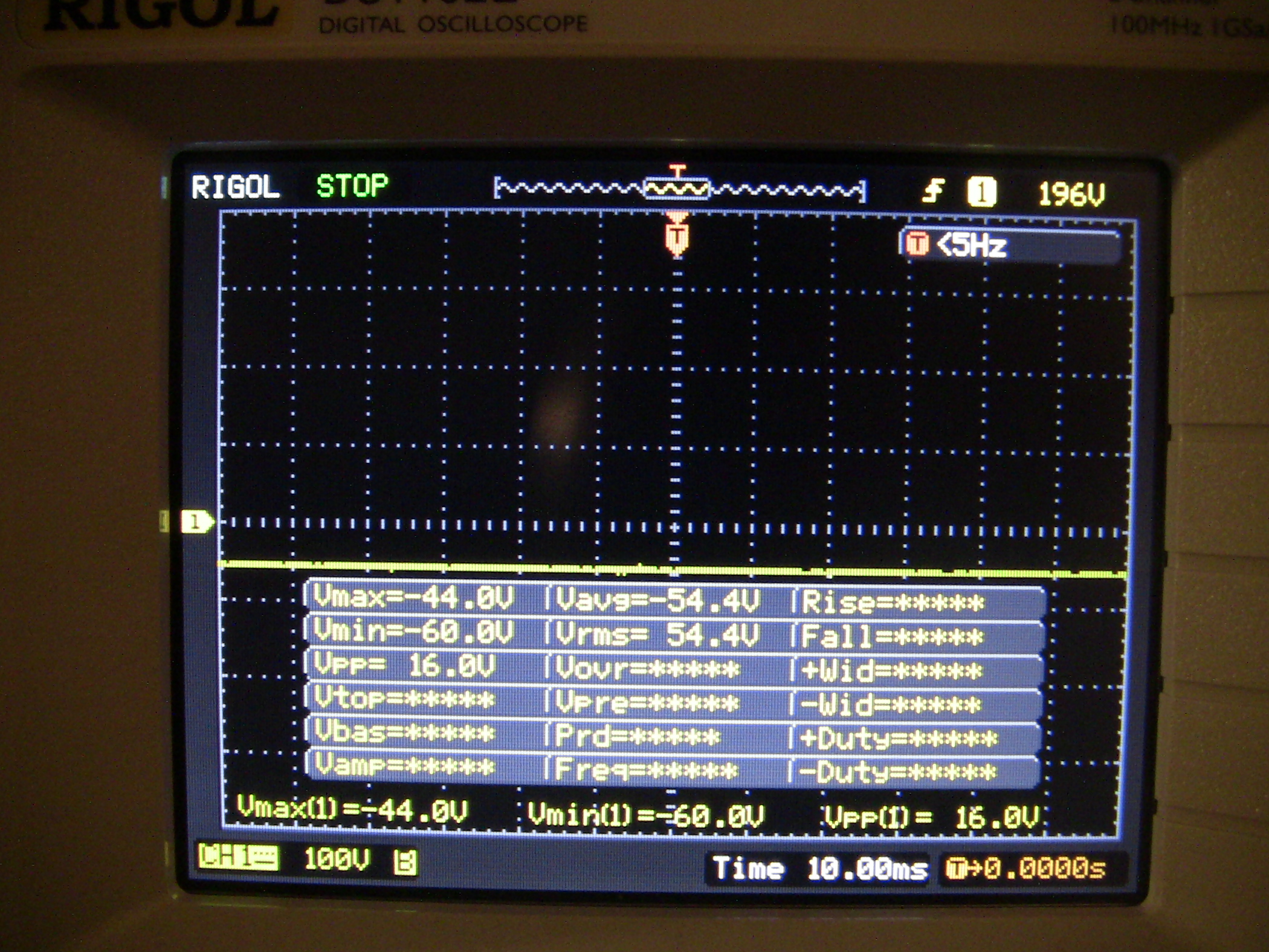

          Ok. So I replaced the Y-main and the Y buffer board today. With all the connectors in their appropriate places, I was still getting the multiple on and off from the power supply. Basically the problem had not changed. So I started my process of elimination by disconnecting the connectors for each board until I isolated the problem. Before the x-main and Y buffer board swap out, I was not getting any Va/Vs voltage at the PSU pin connectors. So, I disconnected the X-Main board first to see if I would get Va/Vs from the PSU with everything connected minus the X-Main...sure enough I am getting 207 Vs and 54 Va. Also now without the X-main connected, I don't get the multiple on and off from the power supply relays. So I'm going to try my hand at checking the X-main for any shorted components and try to repair the X-main. But as a back up..I ordered a replacement X-main board. Oh I connected my oscilloscope up to the new Y-main board as Tom66 explained and I'm getting Vmax =44.0V....Vmin =-60.0V Vrms=54.5V Vavg =54.4V Vpp= 12-16V

            Photo of the voltage readings from Oscilloscope
              #66
              Definitely not working. You should be seeing a wave not a static DC voltage. I am aware that these boards will give out a DC voltage just after they are turned off. This may be your problem - a protection circuit tripping. Or the y-main is faulty.

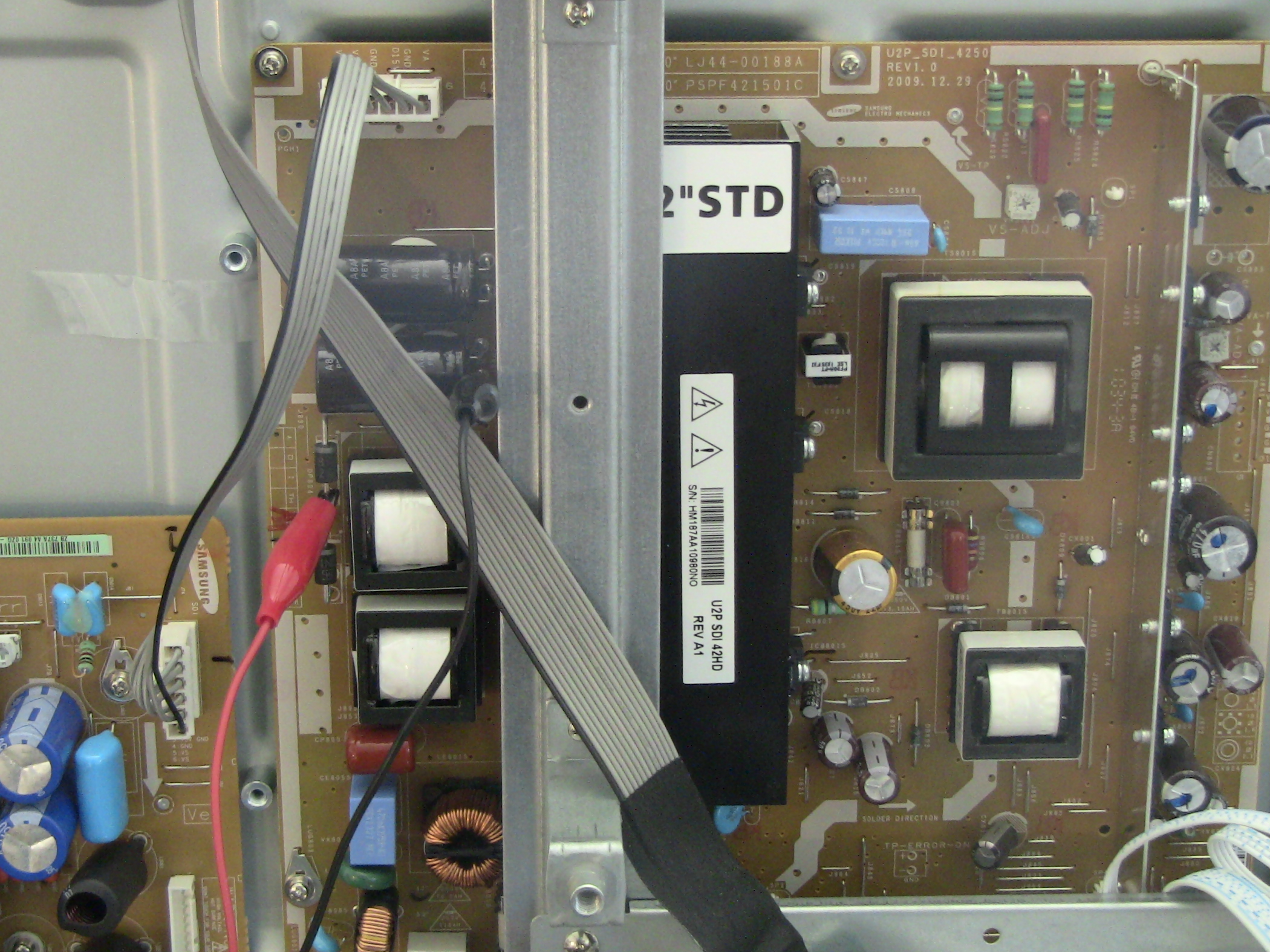

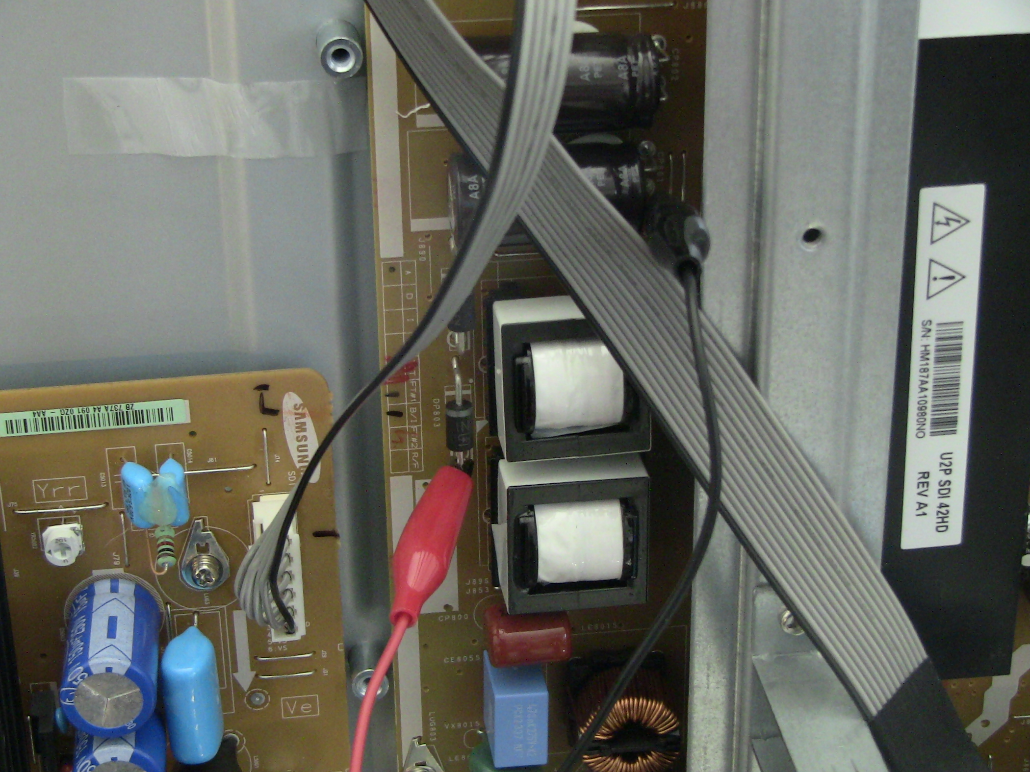

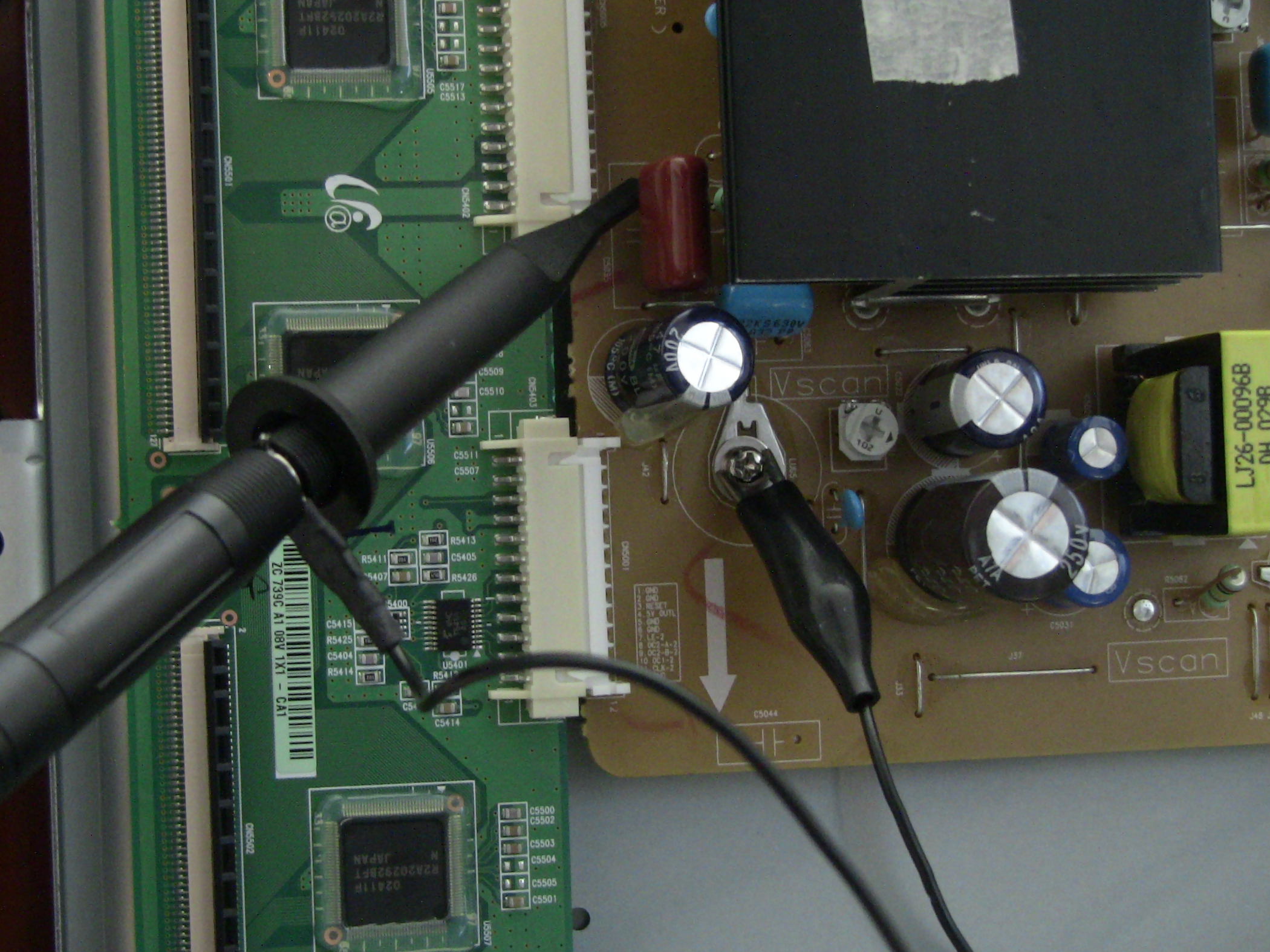

                        Maybe I'm hooking up the oscilloscope wrong on the cap. I attached the probe to the topmost lead as its installed on the board. Confirm I'm to take the ground clip and attach it to ground on chassis ? Or don't connect to ground?
                          #72
                          Scope should be grounded. Can you show me a pic of where you are attaching it to?
                          • Bling23
                            • Dec 2012
                            • 153

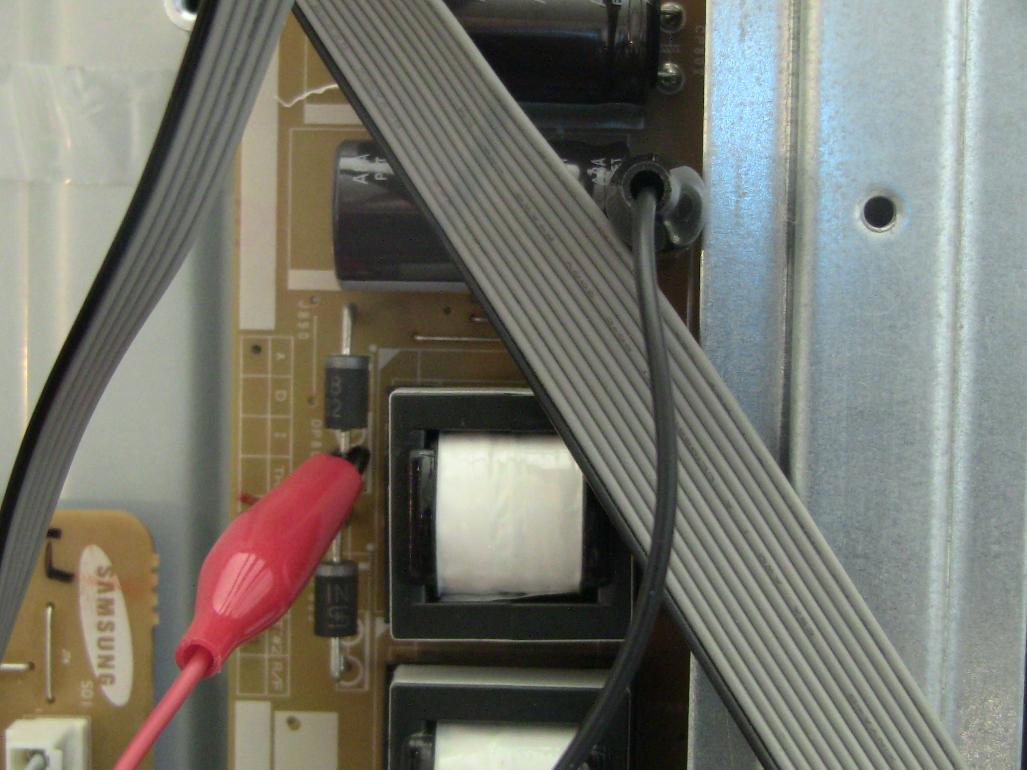

                            #73
                            sure can but can i was just probing around the primary side of the PSU and this is what I have on the two diodes
                            • Bling23
                              • Dec 2012
                              • 153

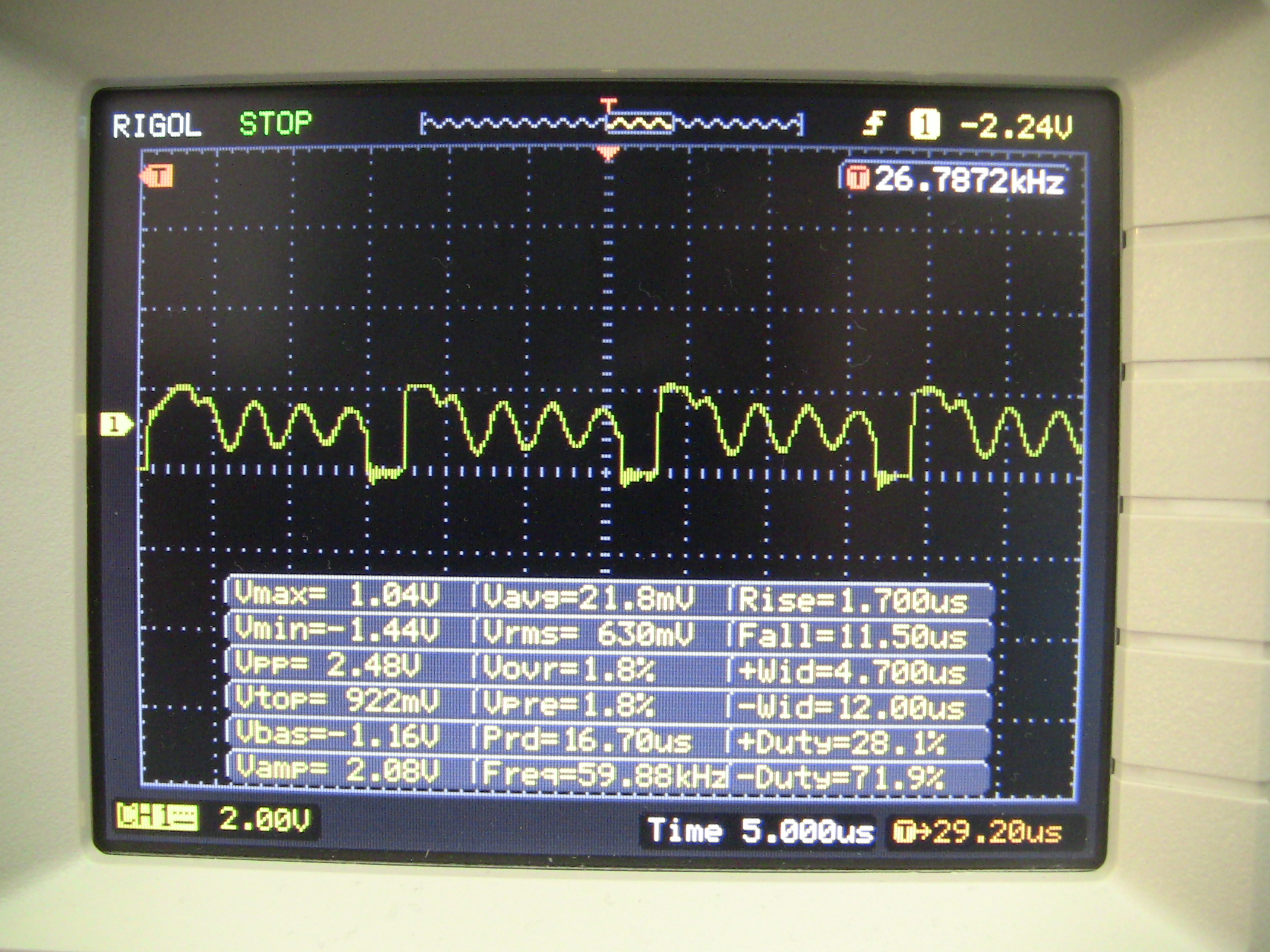

                              #74
                              also when i plug the tV power in, this is the wave from from the transrfomer on the Y-main before the second power of click happens and then it flat lines
                                #75
                                Were you on 1X or 10X?
                                • Bling23
                                  • Dec 2012
                                  • 153
                                  #76
                                  i was on 10x
                                    #77
                                    Were you probing on the primary or secondary?
                                    • Bling23
                                      • Dec 2012
                                      • 153
                                      #78
                                      That wave from was by me just placing the tip of the probe on top of the transformer on the Y Main, and this how I set up the probe to to ground when checking the cap
                                        #79
                                        That indicates the transformer's being driven, which more or less means that it's working. Please can you try the measurement for the capacitor on 500ms/div. Set the scope up so trace sweeps left to right (put horizontal position on the lefthand side.) Press STOP, plug TV in, then press RUN immediately after doing this, then once the trace nearly reaches the end, press STOP, and show me what it looks like. Note that the Rigol has a USB port, so you can upload the bitmaps it makes directly instead of taking a picture.
