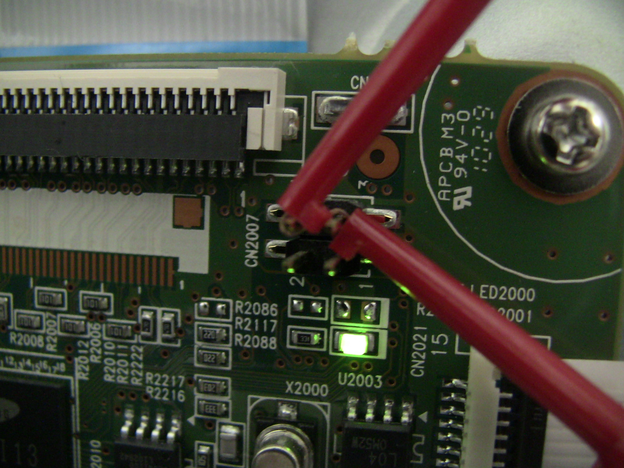

    The boards LED flashes on for about five seconds and goes off for 2 seconds. but what am i looking for with this test? waveform after hooking the jumper wire?
      #122
      Re: This guy has an RCA 42PA30RQ
      You're looking for a Y-main waveform yes, and when you hook up all the boards (except the X-main) you should see dim test patterns cycling on the display panel.

            #125
            ok this is how i hooked the jumper wire. LVDS ribbon disconnected. So no change.. when I turn on the TV I get a quick waveform and then it flat lines. it happens to fast to get a snap shot
              #126
              The problem I have is I had a PS43D450 to repair and it would shut down with the X-main failed or missing. This made it hard to isolate the fault. BUT, an older PS42B450 did let me run with the X-main missing, and I'm fairly sure this TV is based off the same plasma panel. As far as parts go, what have you already replaced?
