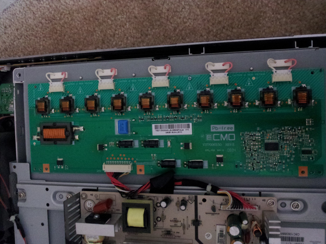

Please Help Have a vizio va26lhdtv10t with not picture
  • sam55555
    • Apr 2012
    • NC
    So i have a vizio va26lhdtv10t with no picture and I read that this happens because of the backlight inverter but I just want to make sure thats the problem before I buy a inverter for $40.
    Re: Please Help Have a vizio va26lhdtv10t with not picture
    You should up that brown stain off the main board. You need to check F1 (20) black fuse on the inverter board and also F2 (7A) White fuse also on the inverter board. More likely to have blown F1 fuse.
    I have 28 pictures so I am going to post them here, you can see them at:
    http://s807.photobucket.com/albums/y...cpZZ1QQtppZZ20
    By the way, please use advanced/ attachment to post the pictures.
      Hi welcome to the forum - pictures are not really good enough for trouble shooting.
      We should have been able to see the fuses budm refers to. I attach my standard greeting should you need more advice.
      Welcome to the forum-
      We can help a lot more if you please post good clear pictures of the whole chassis, and then pictures of each board, front and back and close up of connectors, (max resolution 2000x2000 and 2MB) using the manage attachments button, which is found by clicking "go advanced" under quick reply.
      Examples of what is needed
      https://www.badcaps.net/forum/attach...1&d=1290283049
      https://www.badcaps.net/forum/attach...7&d=1280167246
      It will be useful if you can say what the supposed fault was and a bit about yourself - skills tools etc.
