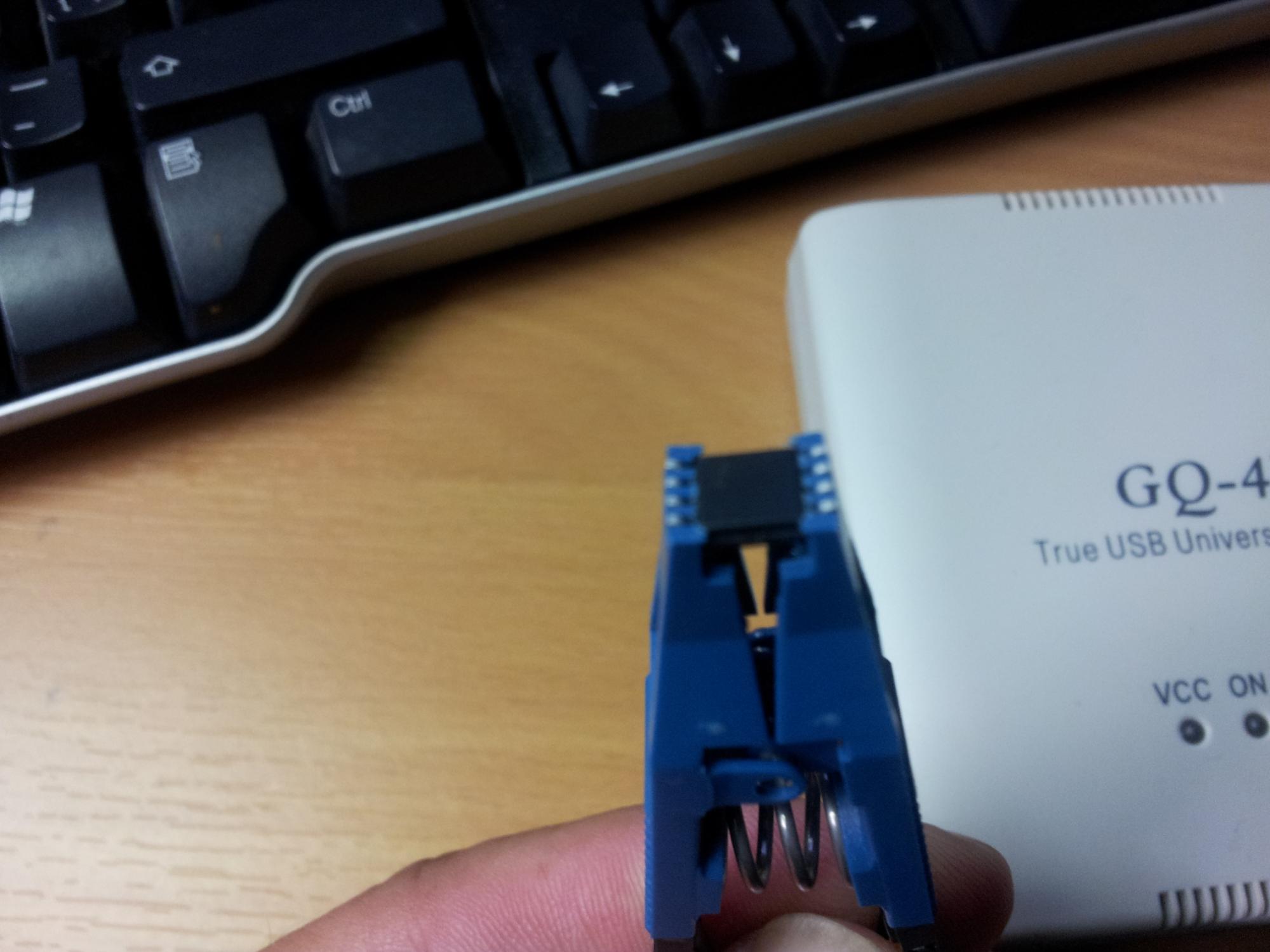

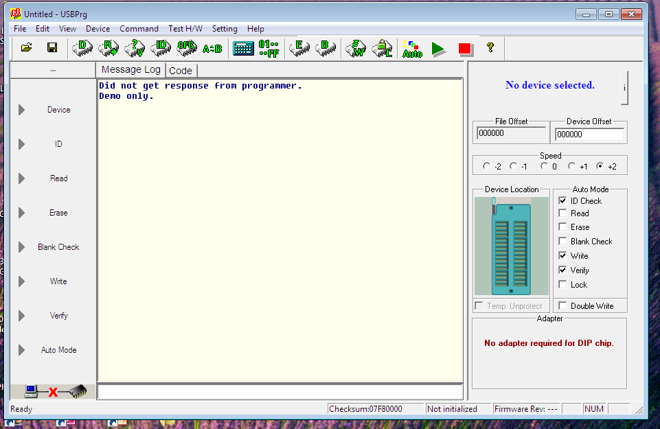

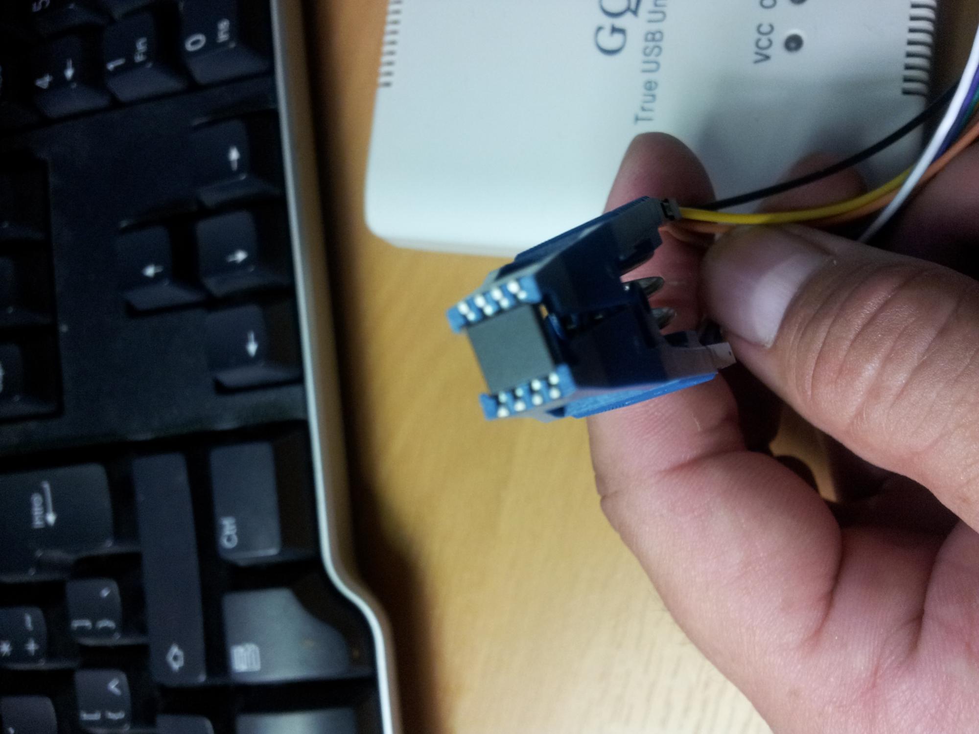

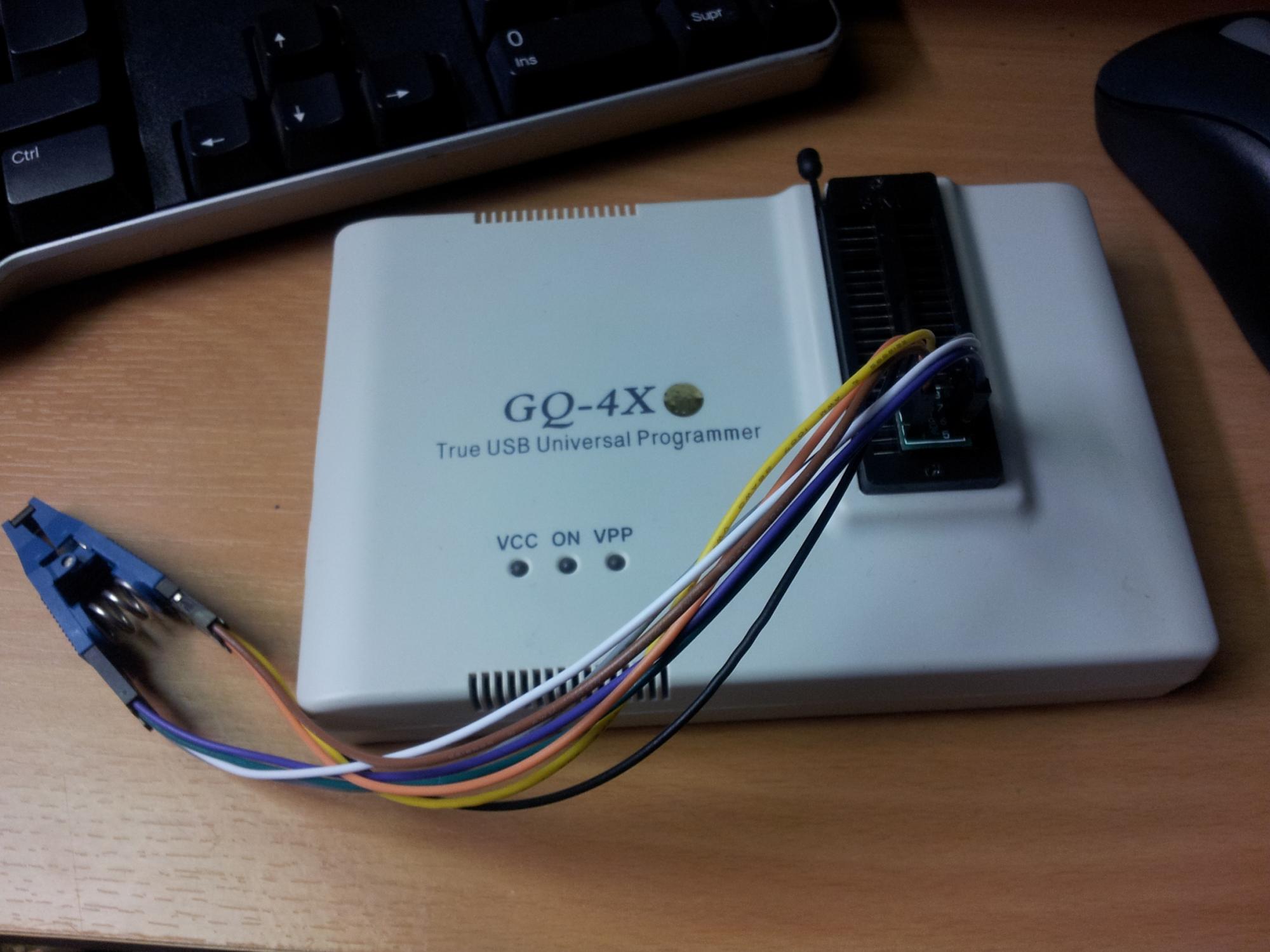

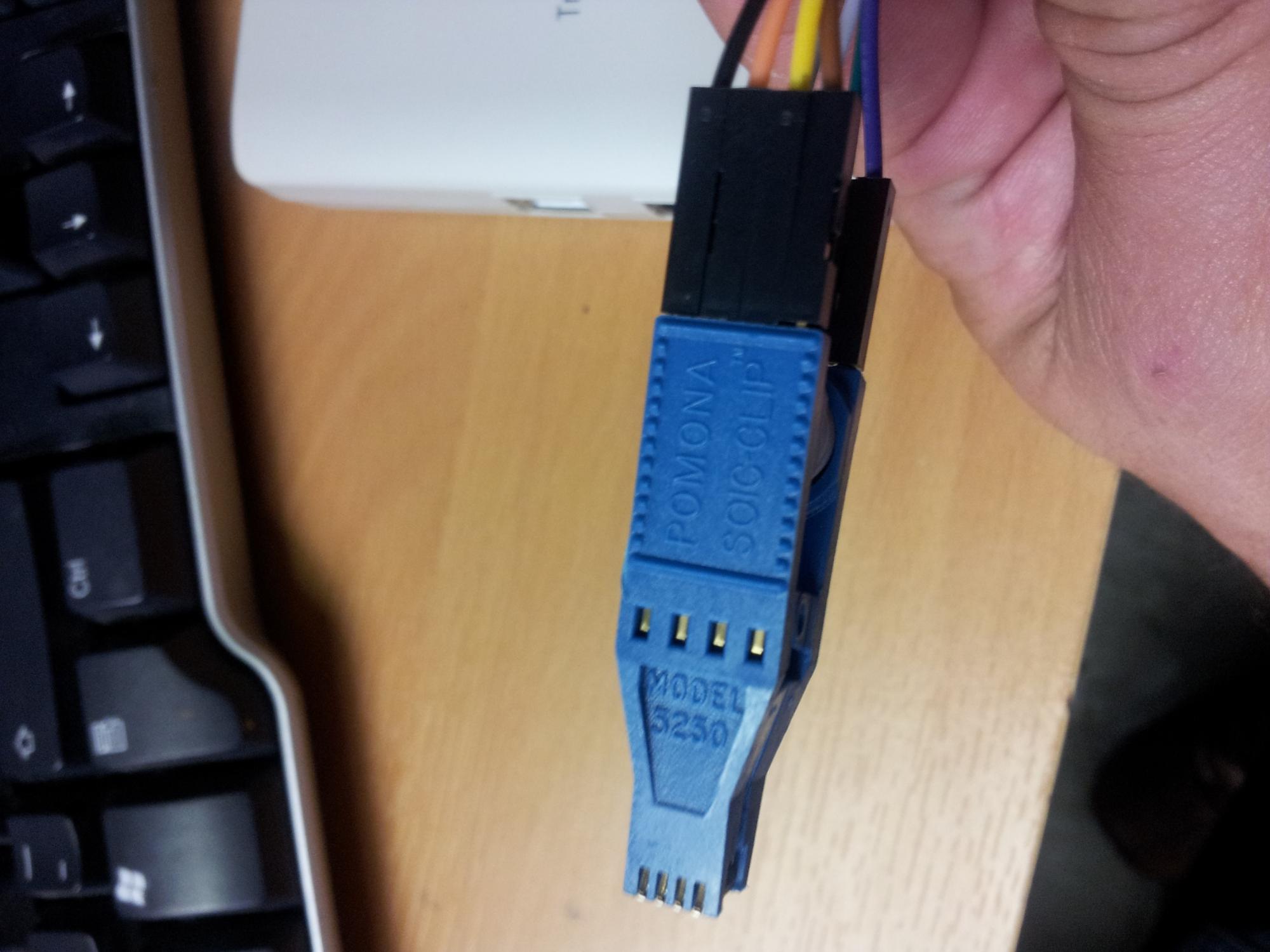

                                    Hi here are some pictures of the eeprom programmer and program that came with it. this is an entry level programmer
                                    i bougth this at this website:
                                    www.mcumall.com
                                    is good enough for me but the professional programmers are like 1000.00 or more.
                                    here are the pictures
                                    Miguel Garcia
                                    www.itvrepair.com

                                        Thanks Miguel, so the chip is just a 8-pin chip?
