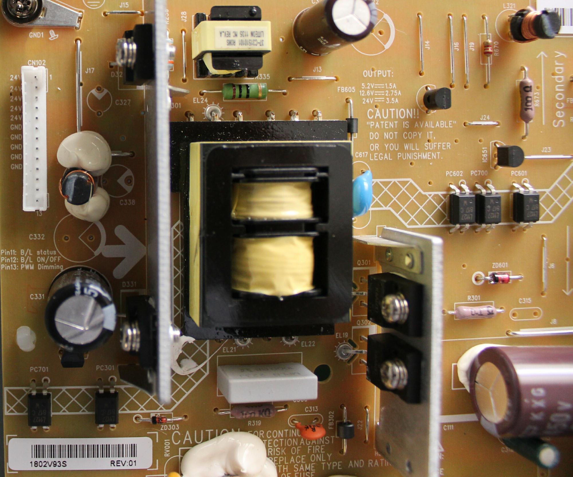

    Total noob here...Have a vizio E321VL thats has just the amber light on. The power button does nothing .....have 5 volts stand by only and no 12 volts going to the power supply.The power supply works...where to start need help? Here are some pics of the main board.

    Please post the good clear pictures of the power supply board, especially where the connectors are, both top and bottom sides of the board.
    The power supplies for 12vdc and 24 vdc are switched on the the PS_ON command from the Main board, no PS_ON then there will not be any 12 or 24vdc.
    We need to find out if you do have the PS_ON at one of the pin on the power supply connector first.

      Ok here is the power board..
        Re: vizio amber light E321VL
        OK, per your picture, pin 4 of CN101 is the PS_ON receving pin from the main board, Check the DC voltage of that pin when the TV is OFF, and when the TV is ON. Black probe of the meter can be on the chassis. We need tof ind out if the main baord is sending out 3.3~5vdc to this PS_ON pin first.

          There is no power on pin 11 thats the PS_ON pin...the only ones that have power are pin 1,2,3 they have 5.2v .
            OK, I look at the label again , pin 11 is the PS_ON. So it is nothing there when you hit the power switch.
            Can I see more pictures on how the main board is connected to the power supply board since the main board looks so small and I cannot see which connectors are connected to the power supply board. I can see some voltage regulator IC's on the main board.

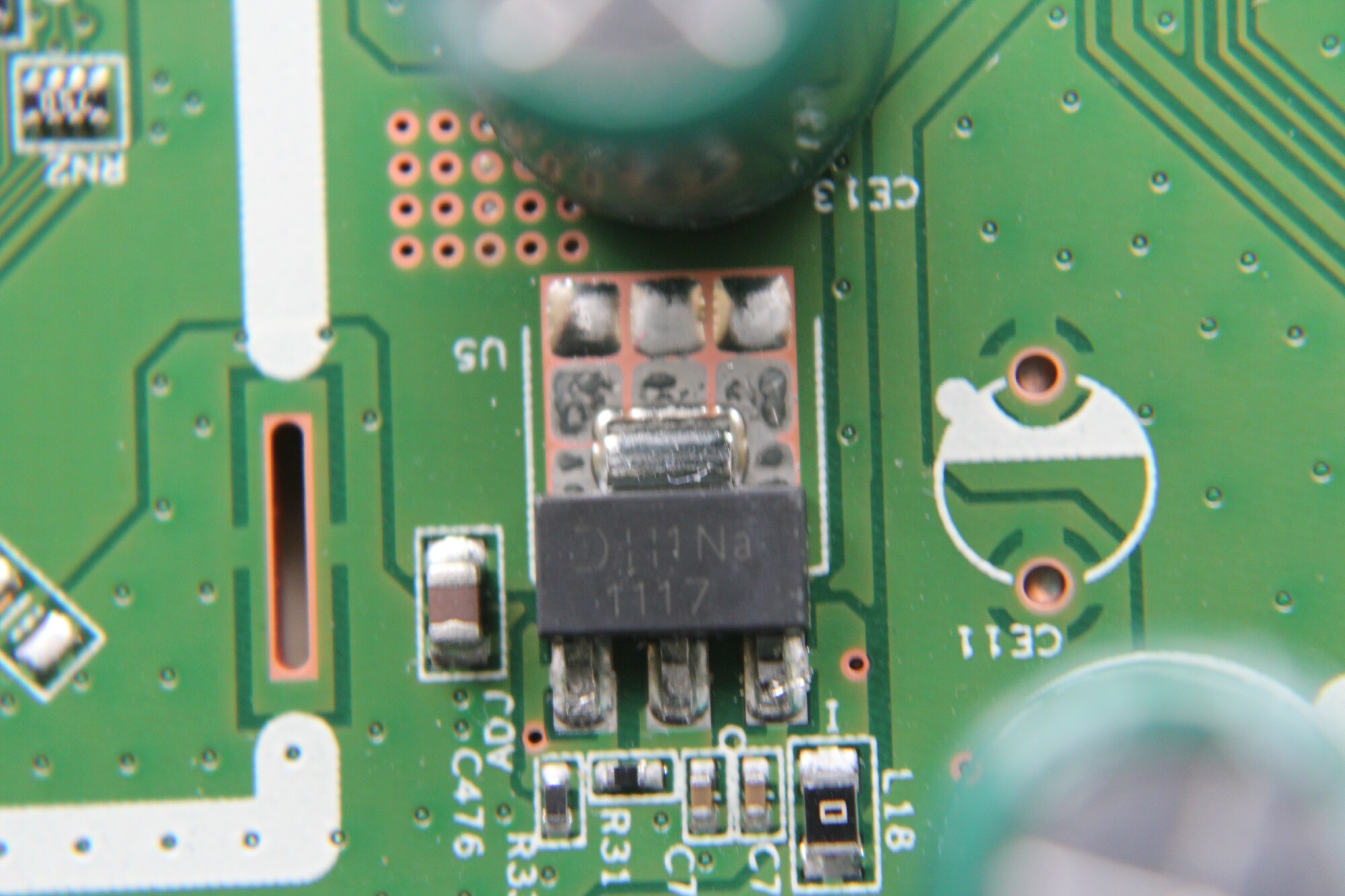

                    Please also list the part number of those two regulators that budm circled so we know what the proper output voltage should be.

                      Ok...fuses read 00.2 both...Now i used the multimeter set at 200 VDC ..hope thats right ..with the power pluged in and the vizio light amber.
                      --Pin1 Pin2 Pin3
                      U4 2.0 3.2 5.2
                      U8 0.0 1.2 3.3
                      U5 0.5 1.7 3.3
                      heres some pics of them

                        Retest with multimeter set to 20V DC (twenty) so we get better resolution (more digits). Most voltage regulators have a +/- 1% tolerance so we need to see more resolution in your measurements to see if they are good or bad.

                          ok here goes ---Pin1 Pin2 Pin3
                          -------------U4 2.04 3.30 5.27
                          -------------U8 0.00 1.24 3.40
                          -------------U5 0.55 1.80 3.40
                            The readings above (pin 2) are "normal" common voltages and your regulators are likely good.
