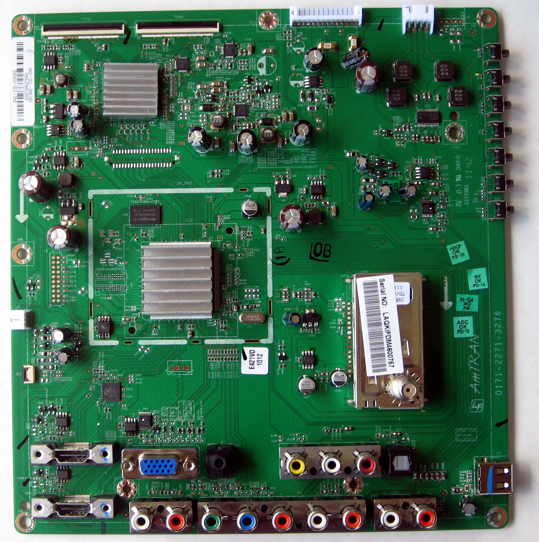

        I just changed another Vizio board in my friend's tv this morning with my reworked board and he is up and running again. I will recycle his board and use it again. I'm telling you that this solves the issue. Yes, I'm adding heatsinks to the BGA Ic's also as an extra precaution. If you have no expert soldering skills, this is not a project for you.

          can you post pics of your work?
          • richpart
            • May 2012
            • 42
            #45
            Re: vizio amber light E321VL
            Just started using this site. How do you attach pics directly to the post. I have one on the desktop at high quality if you can explain how.
            • richpart
              • May 2012
              • 42
              #46
              Figured out how to attach a photo per your request
              • richpart
                • May 2012
                • 42
                #47
                My board is out of a 42 inch and more complex but the same pricipals apply. Same Amtran crap.

                    infringer, I don't disagree with one bit of your statement but my talks with Vizio yesterday only proved that they simply don't care.
                    Trying to get eeprom data from them was a joke. They simply would not give it or acknowlege that a corrupted eeprom would stop the set from coming on. They insisted the set would update itself though a lan connection when my model didn't even have that port or wireless card. So much for that theory, they don't even know their own models lol.
                    It sounds to me like you have great familiarity with computers so what happens to an eeprom when data transfer is suddenly halted? The loss of these connections is causing just that to happen.

                      The question is not what did I solder, but what didn't I solder? There is about two hours of patient rework in the photograph.

                            Update, the reworked board I installed in my buddy's tv yesterday morning has lasted all night. Even as his son fell asleep with the set on and is working again today whereas; before it wouldn't come back on after about 20 minutes of heating up. It requires patience to do this job but, is much more solid than the factory solder job. I'm satisfied with how things are looking.

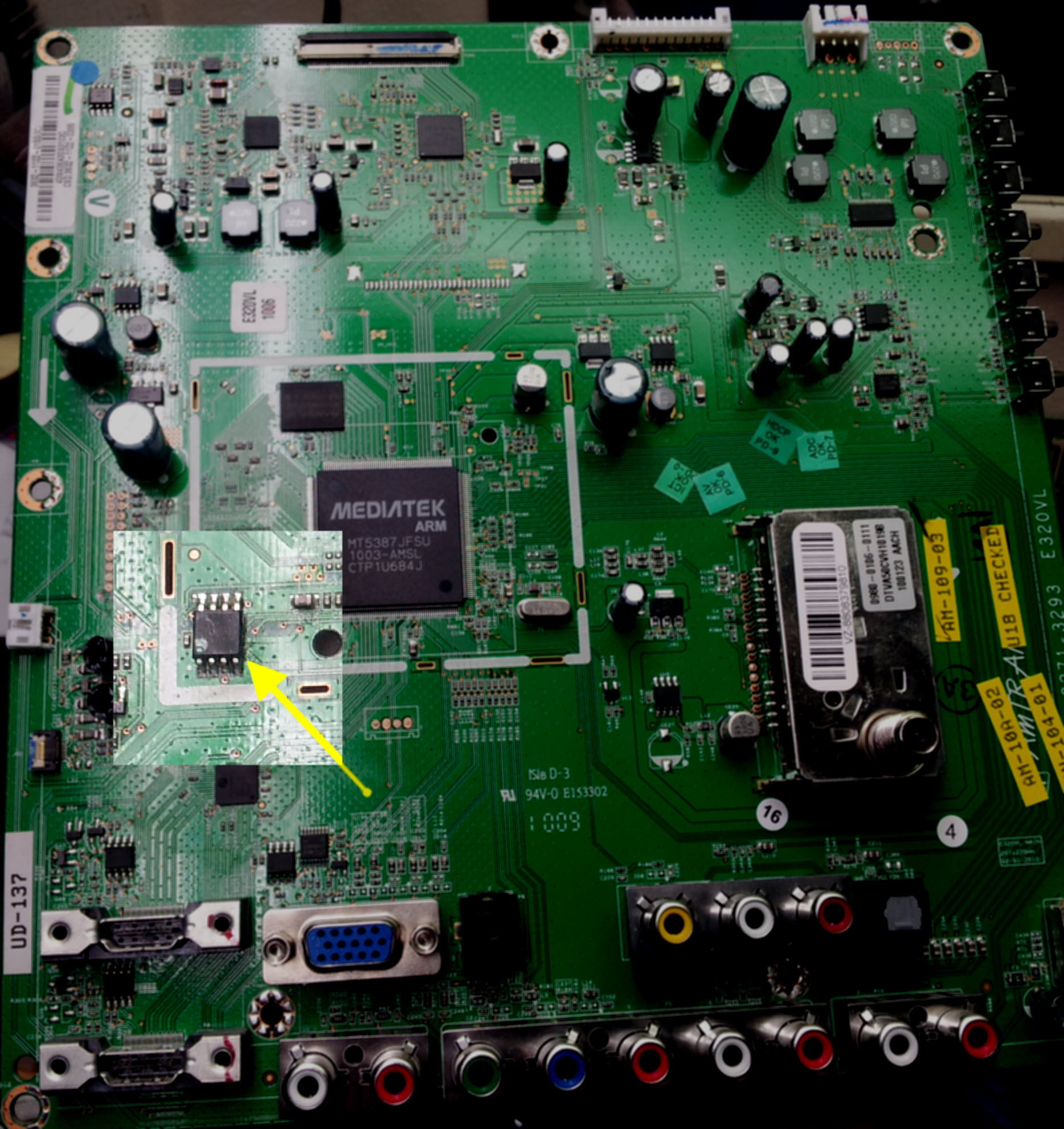

                                I found the location of the eeprom it is u18 i swap from a good board to a bad board and bad board worked OK .
                                I don't have a eeprom programmer right now but i think it can be cloned from a good on to a bad one.
                                I took some pictures and i will upload today .
                                My name is MIKE
                                p.s. I did't re solder anything on the board i just swapped eeproms
                                some people say you have to re solder everything i checked with my microscope and on my board everything look normal.
                                if any body has more info on what kind of programmer we can use will be nice to share the info.
                                And if we can help i work for http://www.itvrepair.com

                                    I would say it's the mx25L6405 chip I took 2 bad boards swapped chip between them & they both work now.(P.S. Thank you Mike)

                                        the eeprom was the problem on my board with the amber light symptom
                                        and no power when you press power button nothing happens.
                                        i order an eeprom programmer and we will now if we can reprogram the mx chip.
                                        it will take at least one week to get the programmer.....
                                        i didn't re solder anything on the board except of swapping eeproms between boards..
