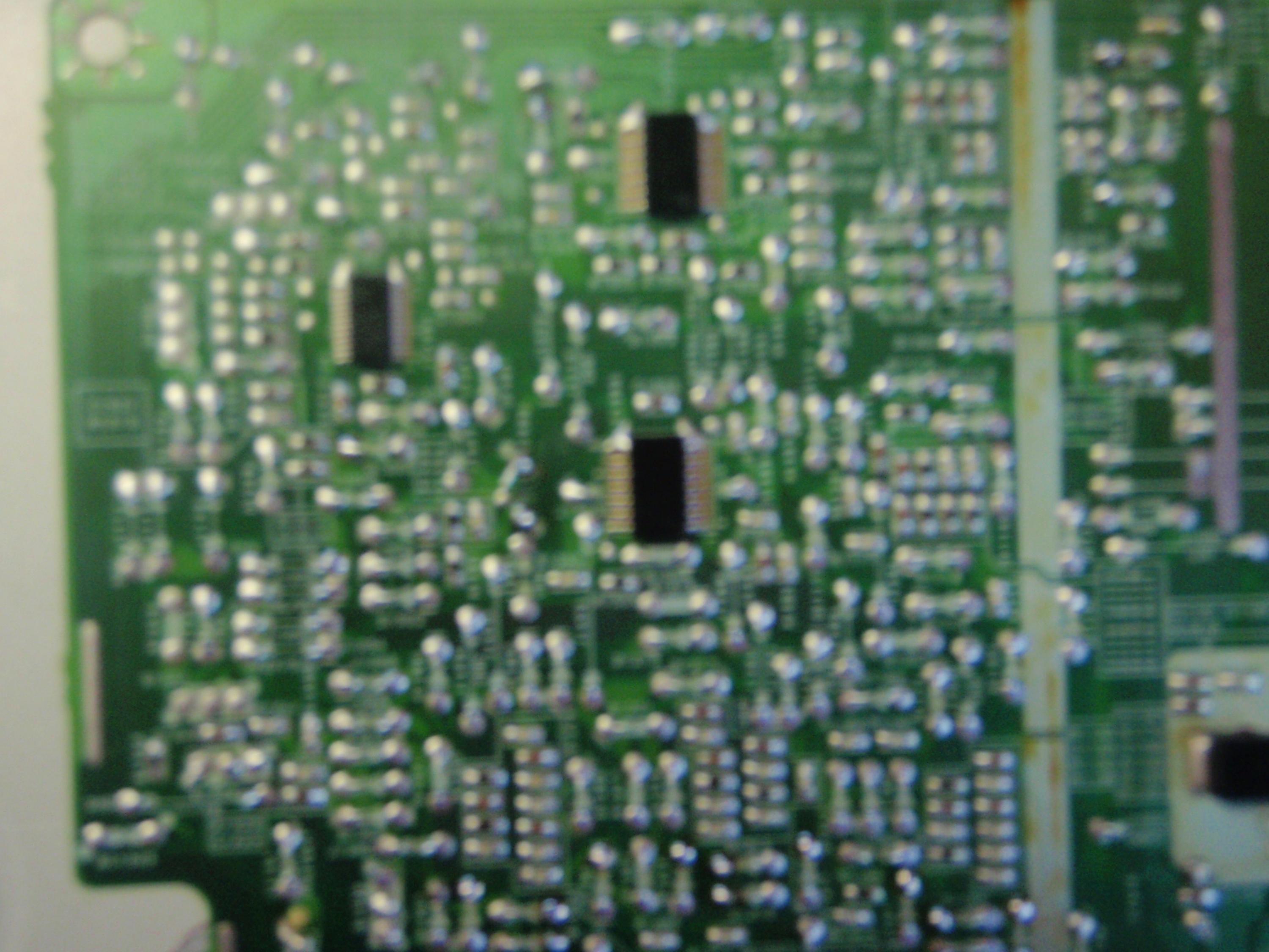

      Re: Sylvania LC320SS9 Flashing Green LED
      best i could get camera sucks at best....
      • heavymachines
        • Mar 2011
        • 1028
        #43
        hey jerry you got a better camera to take pics with so budm can help us? my camera sucks i can see why budm has not replied and i don't blame him those pic's sucks....sorry budm i will see if a friend of mine has a better camera....
          #44
          Boy! There are lots of parts on the bottom of the board, a lot more than I expect.
          So right now, the backlights flashes on then go off?

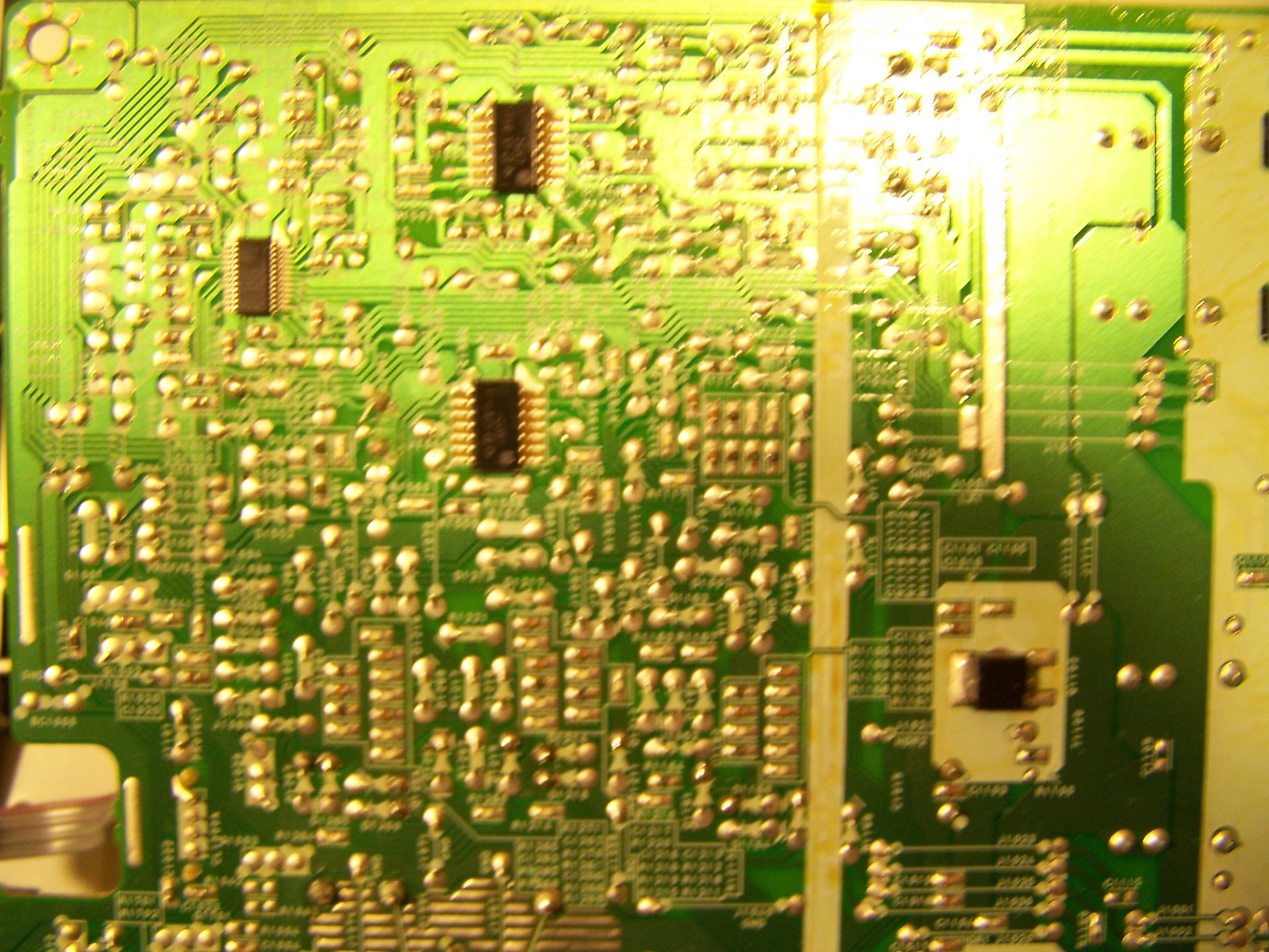

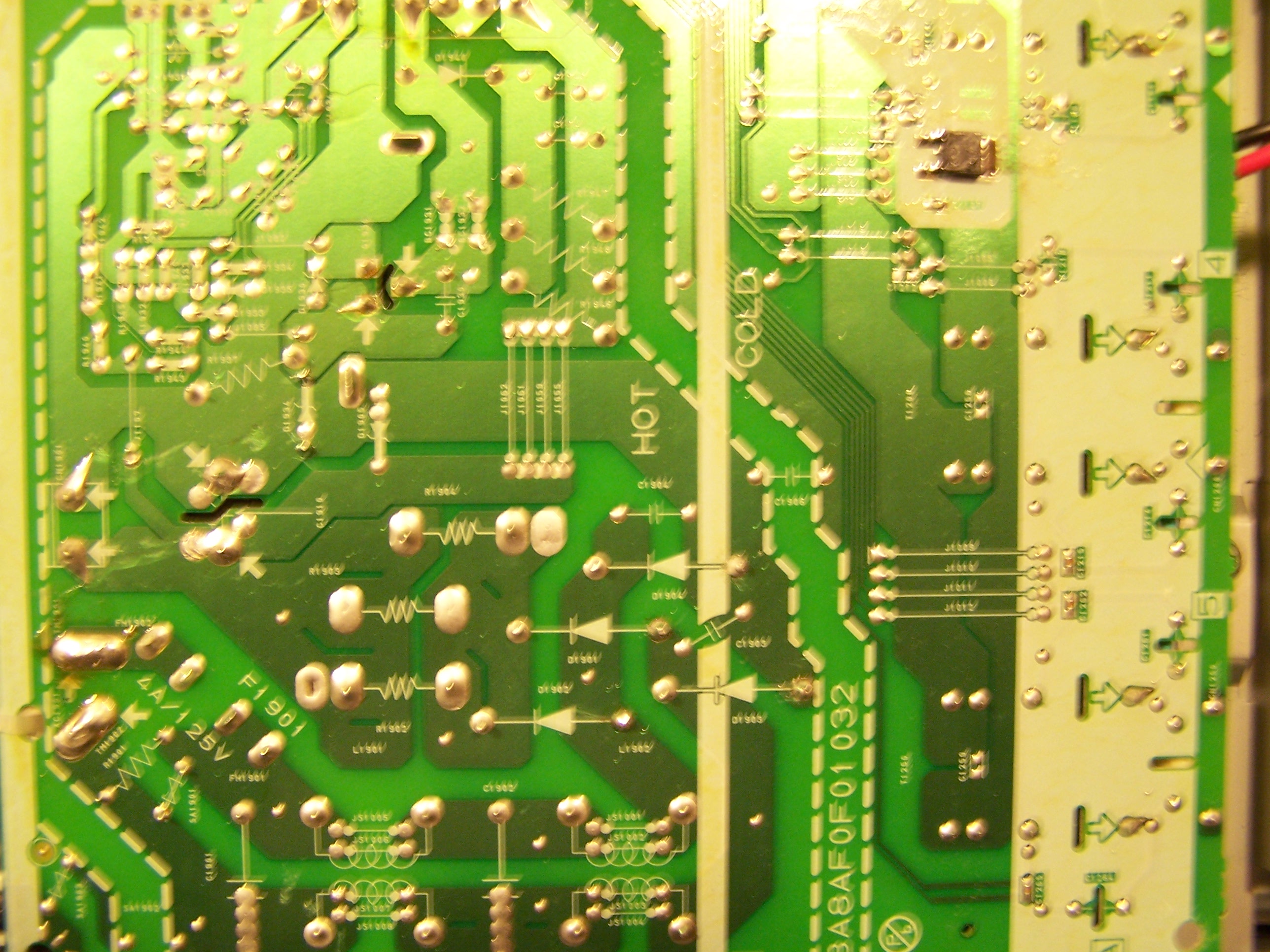

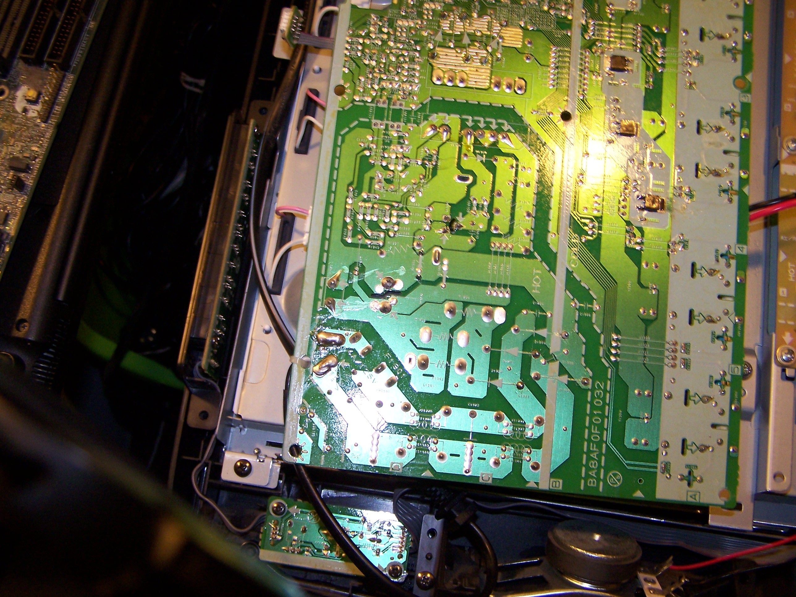

                  #48
                  here u go. There terrible guys sorry
                  • Jerry7591
                    • Aug 2011
                    • 30
                    #49
                    I took one more but it's still crappy. Next time I will put white in the background.

                                  #56
                                  new pics hope you can work with this budm....
                                    #57
                                    Hate to say this, but pictures #1~3 (100-2059~1002061) are out of focus.
                                    There are 3 IC hsown on the first picture, do you have the P/N printed on them?
                                    • heavymachines
                                      • Mar 2011
                                      • 1028
                                      #58
                                      yeah different camera still sucks...
                                      ic starting from top
                                      ic#1.....87 a3 95km
                                      lm324
                                      ic#2 0z9926asn
                                      mb4334 2g
                                      0827c2
                                      ic#3 same as ic#1
                                      • heavymachines
                                        • Mar 2011
                                        • 1028
                                        #59
                                        ic#1.....87 a3 95km
                                        lm324
                                        ic#2 0z9926asn
                                        mb4334 2g
                                        0827c2
                                        ic#3 same as ic#1
                                        and ic # 1 and 3 are Texas Instruments parts
                                          #60
                                          LM324 is the Quad Op-amp.
                                          OZ9926 is the PWM IC made by O2 MICRO.
                                          I need to study its function first.
