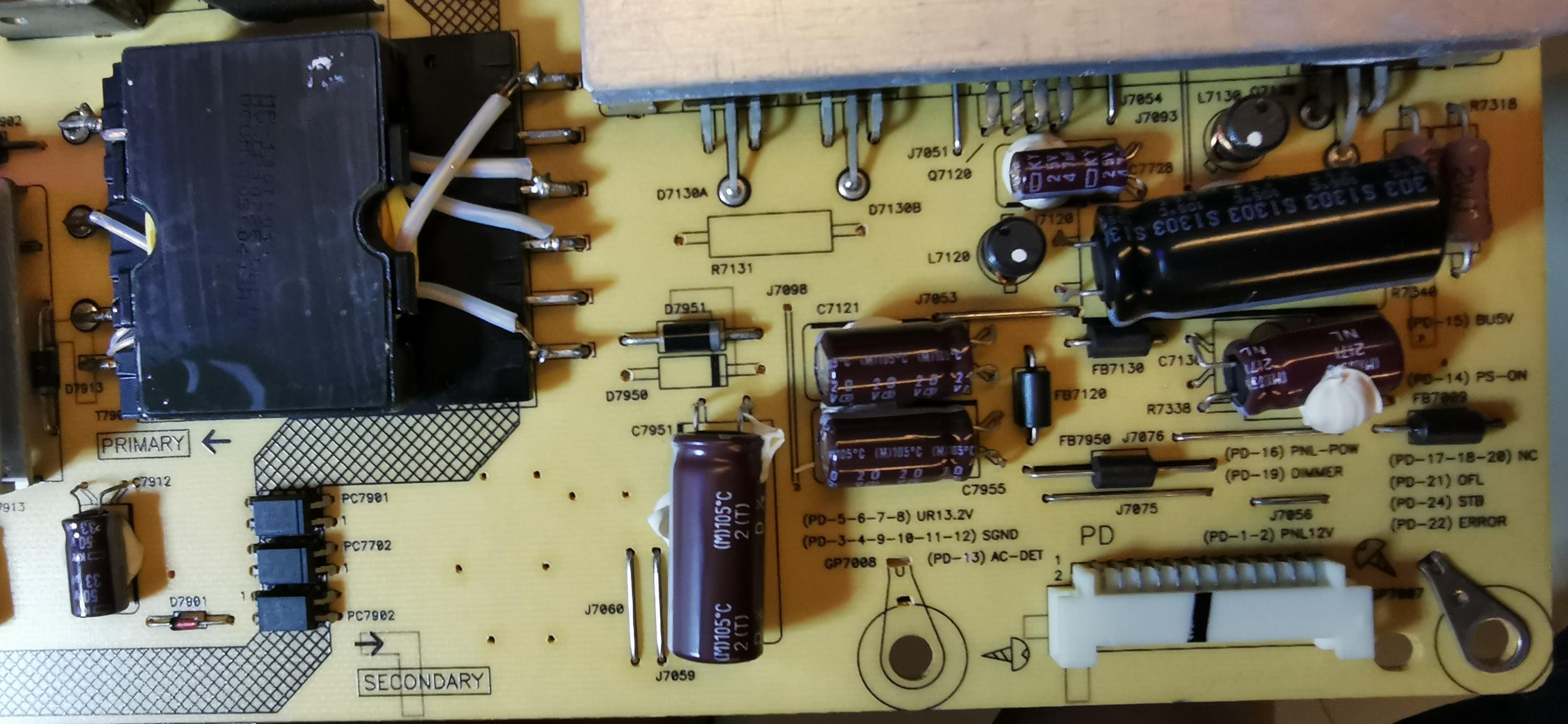

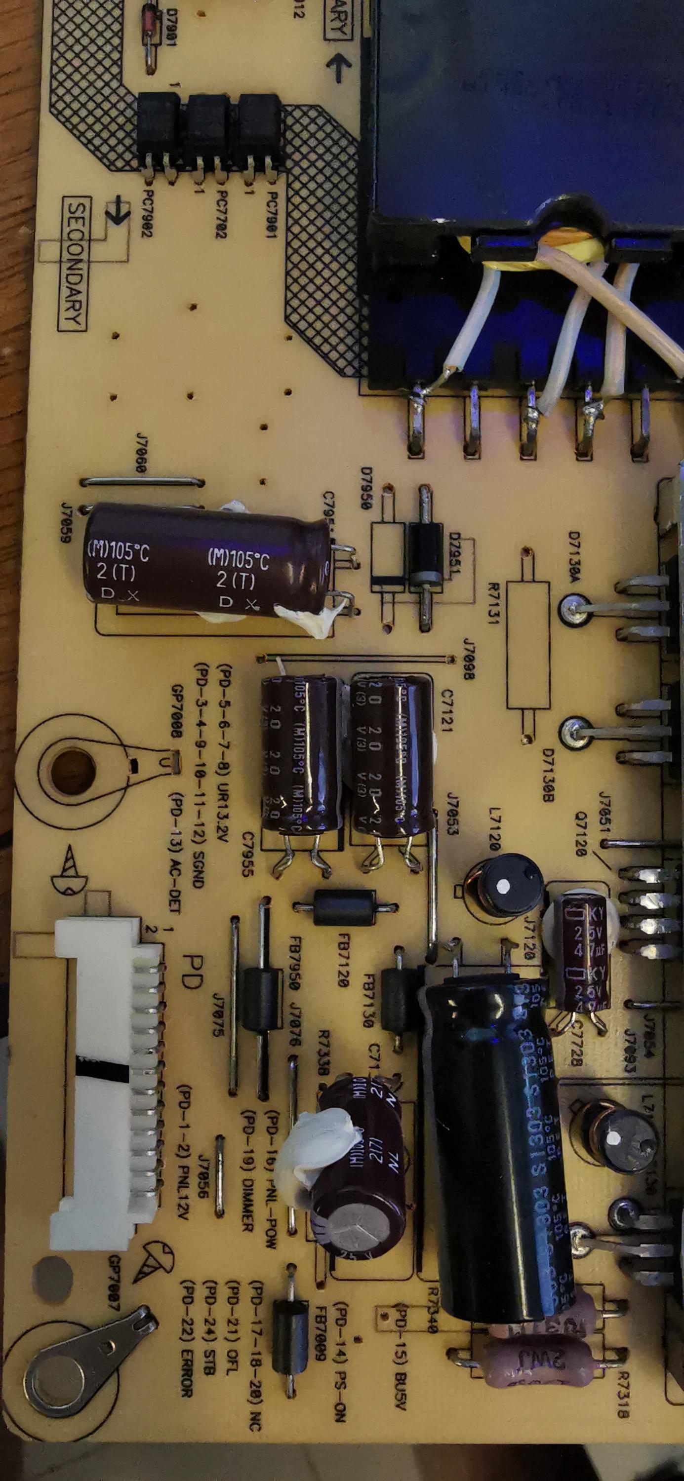

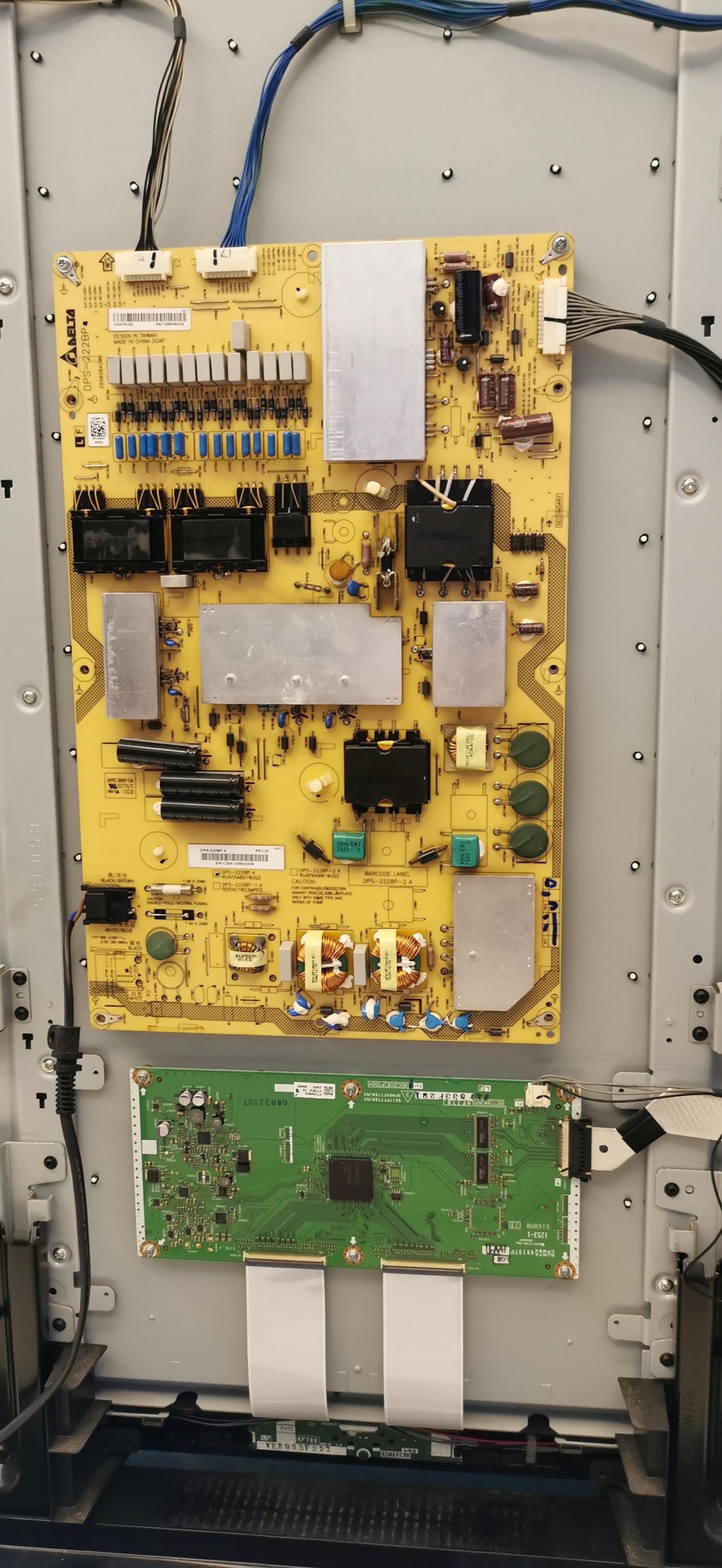

    Sharp TV flashing green light 2x per second at constant rate. Various reset methods do not have any effect on it. Search here and found flashing green 2x per second indicate bad power supply, which I am quite certain now.
    I am seeking help with basic trouble shooting to find the short-circuit on the secondary side that I believe is the cause:

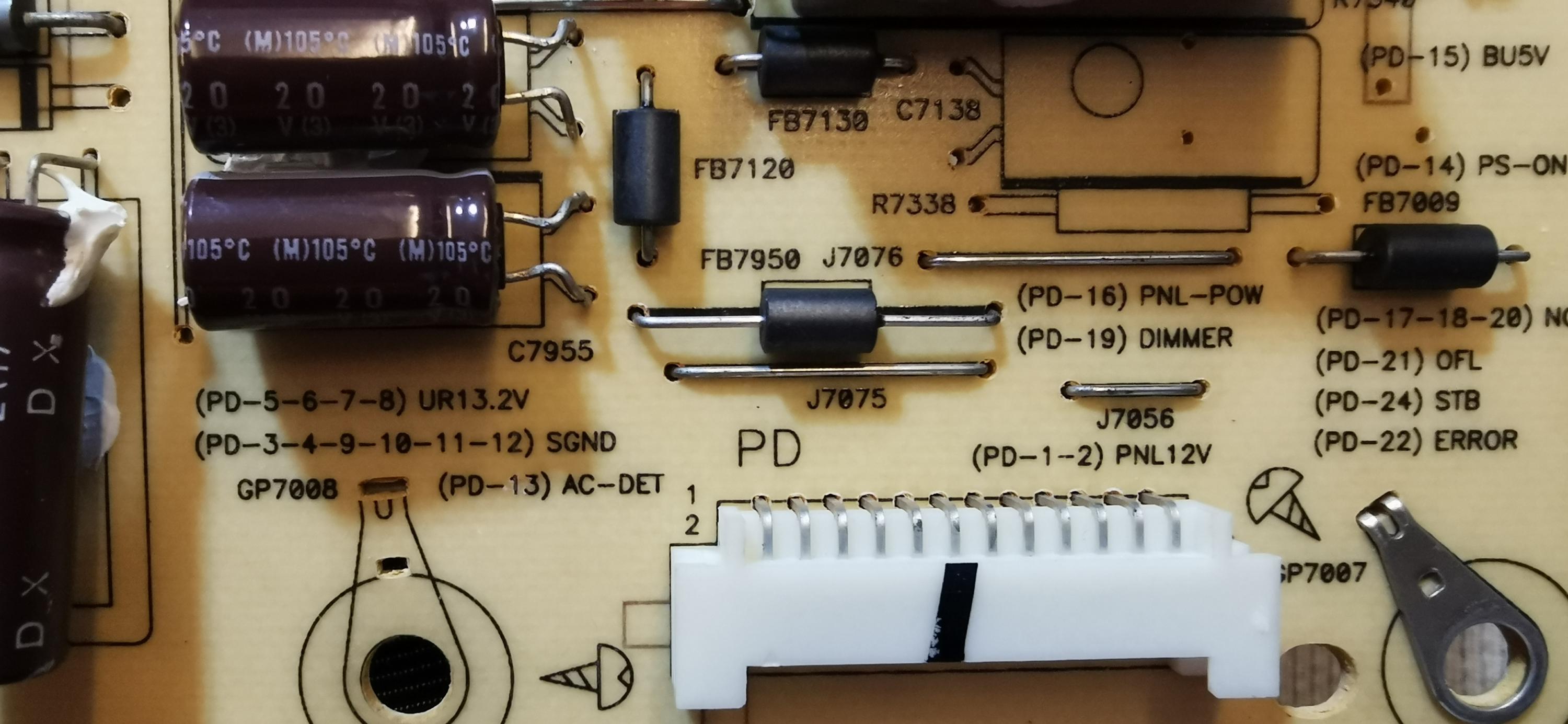

    The main PD connector:
    PD-1 (PNL12V) : 0.02V
    PD-2 (PNL12V) : 0.02V (fluctuating)
    PD-3 (SGRN) : 0V
    PD-4 (SGRN) : 0V
    PD-5 (UR13.2V) : 0.05V (fluctuating)
    PD-6 (UR13.2V) : 0.05V (fluctuating)
    PD-7 (UR13.2V) : 0.05V (fluctuating)
    PD-8 (UR13.2V) : 0.05V (fluctuating)
    PD-9 (SGRN) : 0V
    PD-10 (SGRN) : 0V
    PD-11 (SGRN) : 0V
    PD-12 (SGRN) : 0V
    PD-13 (AC_DET) : 2.5V (fluctuating widely)
    PD-14 (PS_ON) : 2.5V (fluctuating)
    PD-15 (BU5V) : 3V (fluctuating widely)
    PD-16 (PNL_POW) : 0.1V
    PD-17 (NC) : 0V
    PD-18 (NC) : 0V
    PD-19 (DIMMER) : 0V
    PD-20 (NC) : 0V
    PD-21 (OFL) : 0V
    PD-22 (ERROR) : 0.05V (fluctuating)
    PD-23 (NC) : 0V
    PD-24 (SBY) : 0V
    3x Opto-couplers input: 2.5V (fluctuating widely)
    3x Opto-couplers output: 2.5V (fluctuating widely)
    Searched here and learned that fluctuating output voltages and feedback circuitry generally means shorted components causing PWM chip to power-cycling up and down..
    If this is the case - need help to find the short(s).
    I have tested all the capacitors, diode and resistors around the PD connector, all seems to be normal reading on and off circuit.
    What else and where else do I start?

    run the PCB as stand alone... with out any connect to it... it sound the short outside the PCB

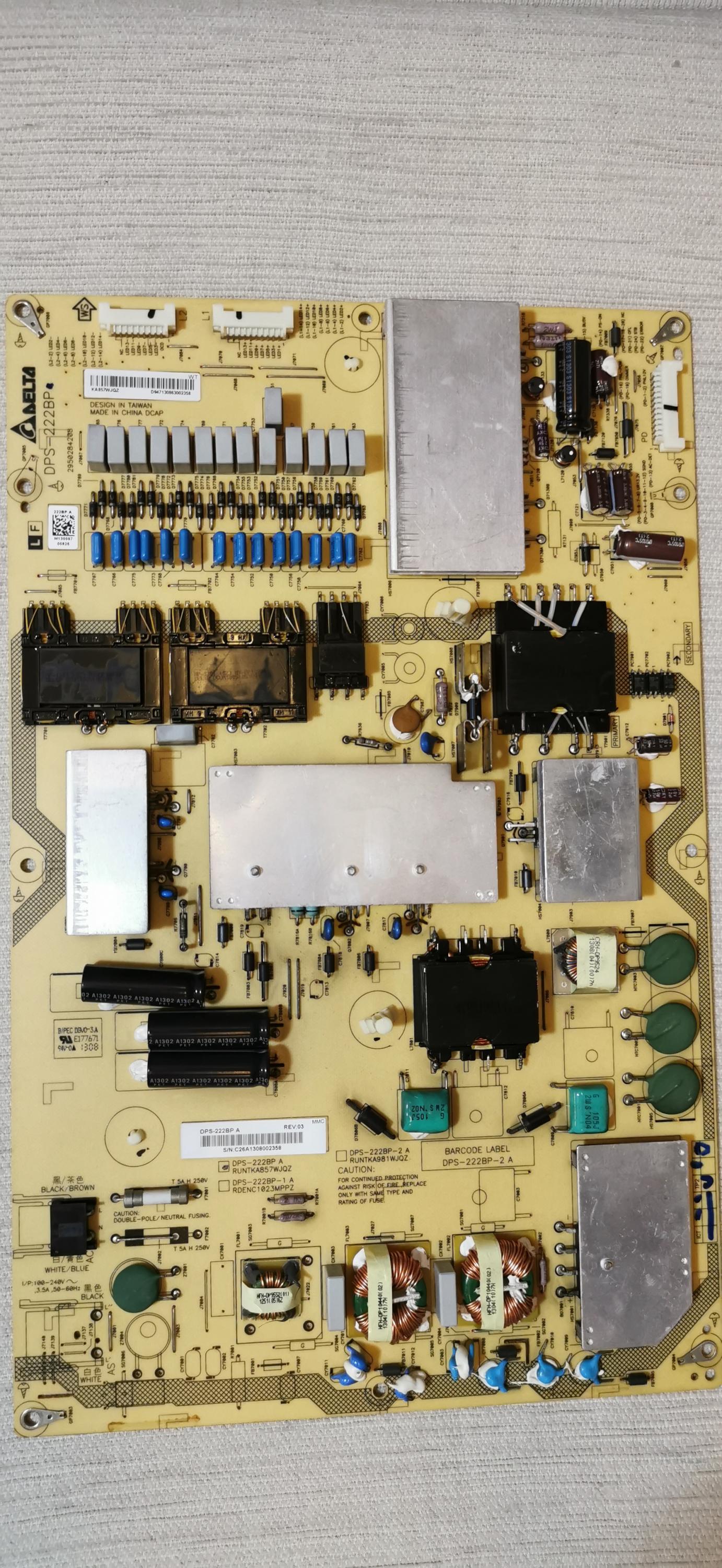

      This is power supply stand-alone:

      So confirmed the short(s) in the mainboard? If so is it possible to attempt tracing it on the mainboard?

        you need feed the PCB PS_ON pin from the V. you have at the socket present as STB ( (BU5V) : 4.95V ) then this will be stand alone. runing the PCB with out LED BL and MB
        • beetle1303
          • Jul 2019
          • 279
          • Singapore
          Re: Sharp LED TV flashing green 2x per second - LC-70LE735X, DPS-222BP, RUNTKA857WJQZ
          Is it safe to just jump PD15 to PD-14? or must have a ??ohm resistor in between?
          • Diah
            • Feb 2013
            • 6499
            R considered just in case people missed the pin No. so ab to you.

                    good so we do have 13V. ur PCB okay... now you add another jumper use R1K from pin 15 to pin 16 PNL_POW to turn on PNL12V.

                        better scout 2 more then, you will need to jump ps-on, pnl-pow, ofl and dimmer to bu5v, then you can see if the backlights come on and stay on, if they do then your backlights and powerboard are ok.

                          Jumped PD-15 to PD-14; and PD-16, PD-19, and PD-21, each with a 800ohm resistor:
                          This is power supply stand-alone, without any connection:
                          PD-1 (PNL12V) : 11.92V
                          PD-2 (PNL12V) : 11.92V
                          PD-3 (SGRN) : 0.02V
                          PD-4 (SGRN) : 0.02V
                          PD-5 (UR13.2V) : 13.05V
                          PD-6 (UR13.2V) : 13.05V
                          PD-7 (UR13.2V) : 13.05V
                          PD-8 (UR13.2V) : 13.05V
                          PD-9 (SGRN) : 0V
                          PD-10 (SGRN) : 0V
                          PD-11 (SGRN) : 0V
                          PD-12 (SGRN) : 0V
                          PD-13 (AC_DET) : 3.27V
                          PD-14 (PS_ON) : 4.95V
                          PD-15 (BU5V) : 4.95V
                          PD-16 (PNL_POW) : 4.58V
                          PD-17 (NC) : 0.04V
                          PD-18 (NC) : 0.04V
                          PD-19 (DIMMER) : 1.34V
                          PD-20 (NC) : 0.04V
                          PD-21 (OFL) : 1.64V
                          PD-22 (ERROR) : 0.12V
                          PD-23 (NC) : 0.04V
                          PD-24 (SBY) : 0.01V
                          Opto-couplers 1: input: 0.99V / output: 2.78V
                          Opto-couplers 2: input: 1.08V / output: 0.14V
                          Opto-couplers 3: input: 0.15V / output: 0.84V
                          Mounted PS back onto TV, connected LED backlights, powered-on, but nothing happens - no backlight on TV...
                          A quick checked - the big cap shows 403Vdv but all the transformers above it shows no voltages in all the output pins... With a LED tester - all the 14 led strips are mostly 175V, with 2-3 showing 173-174V.
                          What/where else to check?

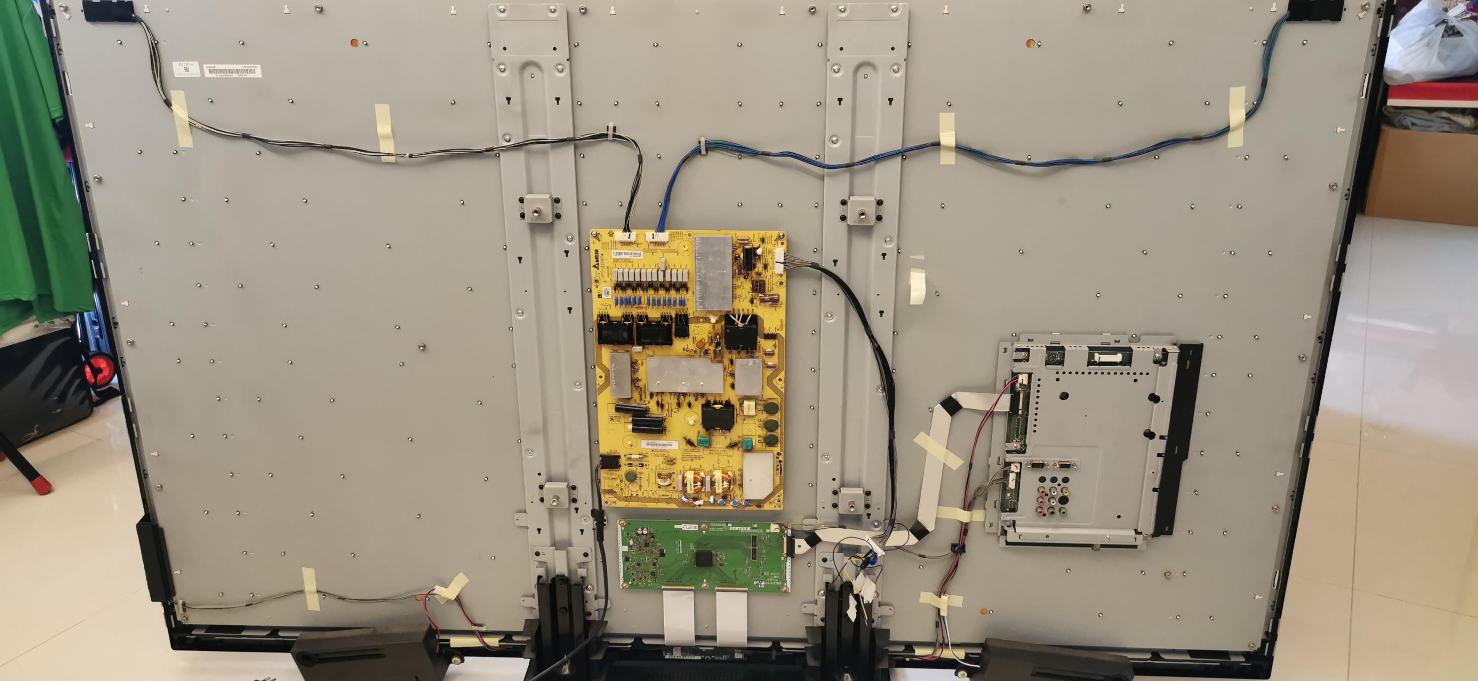

                            yours PCB are fine dont touch it any more.. put it back and show us whole photo of TV back showing how boards connected and photos on your MB and it chassis lable.
                            • beetle1303
                              • Jul 2019
                              • 279
                              • Singapore

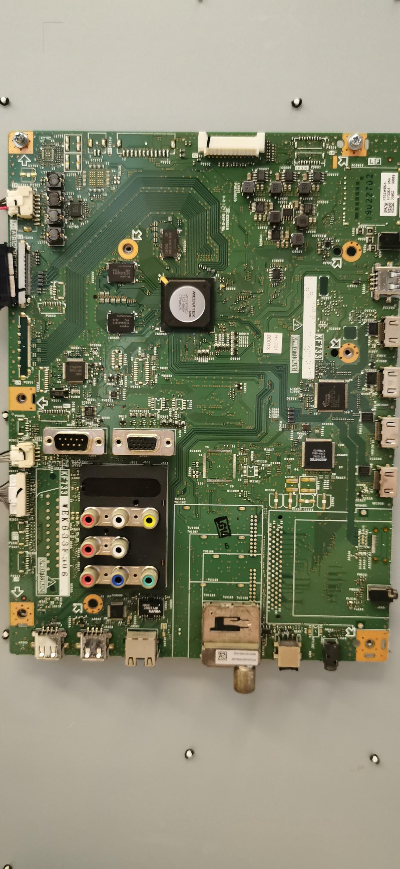

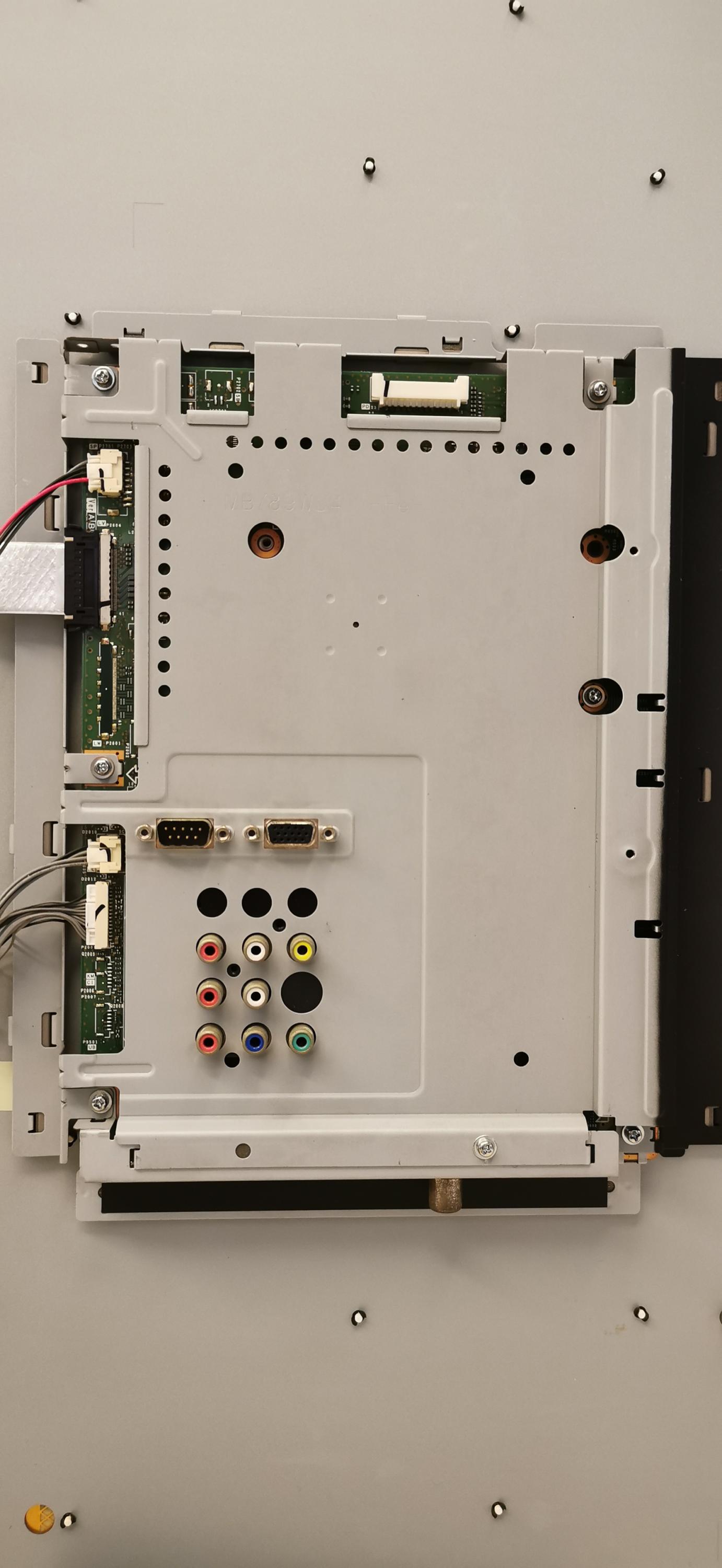

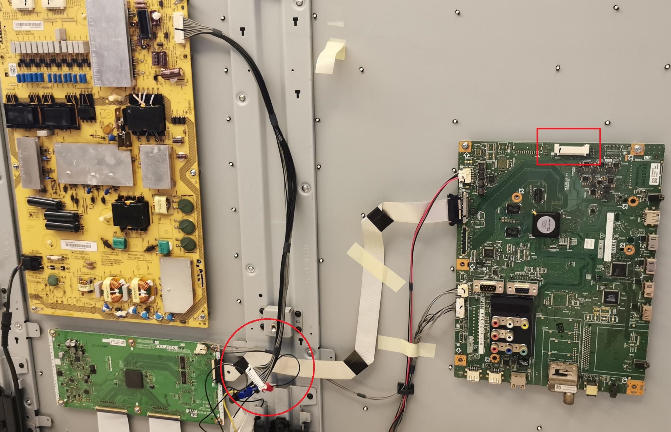

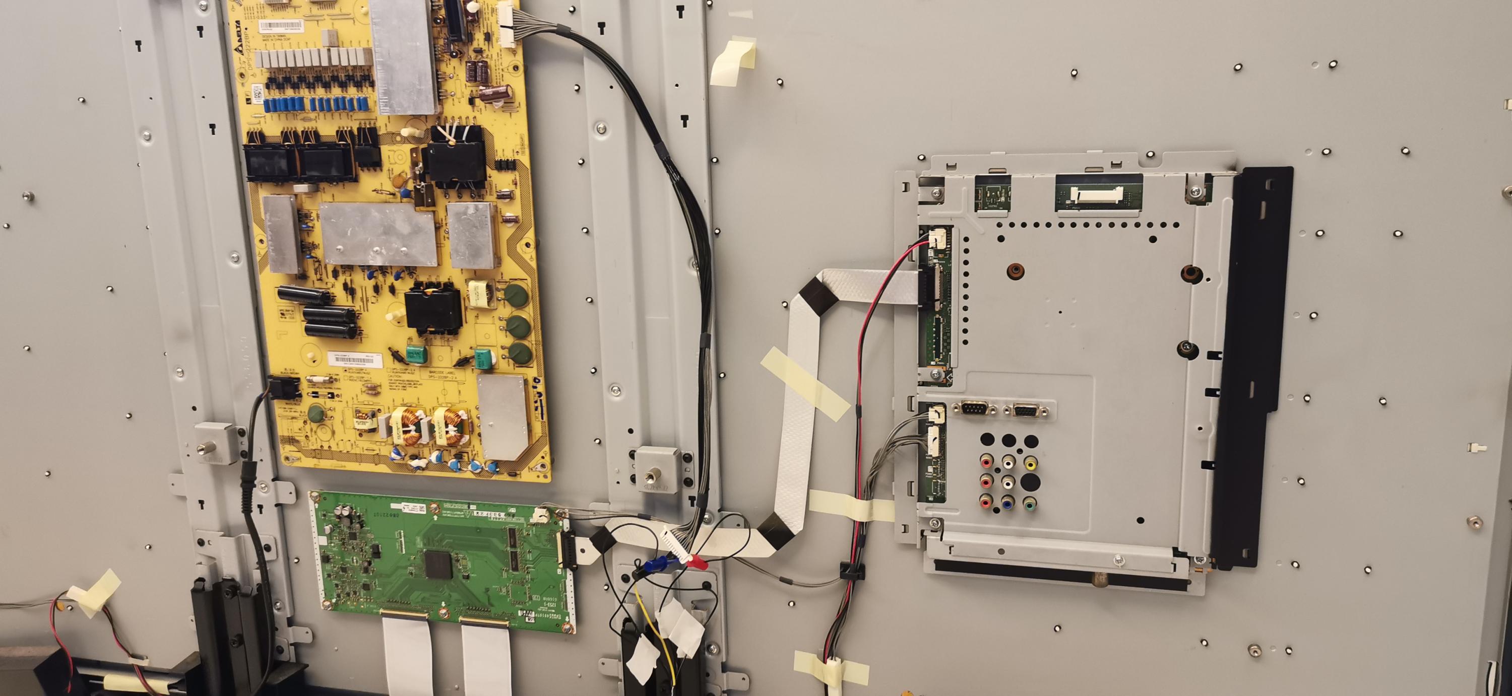

                              Please see attached - TV Back, MB, and Chasis Label.
                              • Diah
                                • Feb 2013
                                • 6499
                                is this DIY TV ??? why the socket which it should be at MB go down and had DIY cable ..
                                you should put every things back as opriginal so you can troubleshooting the MB .

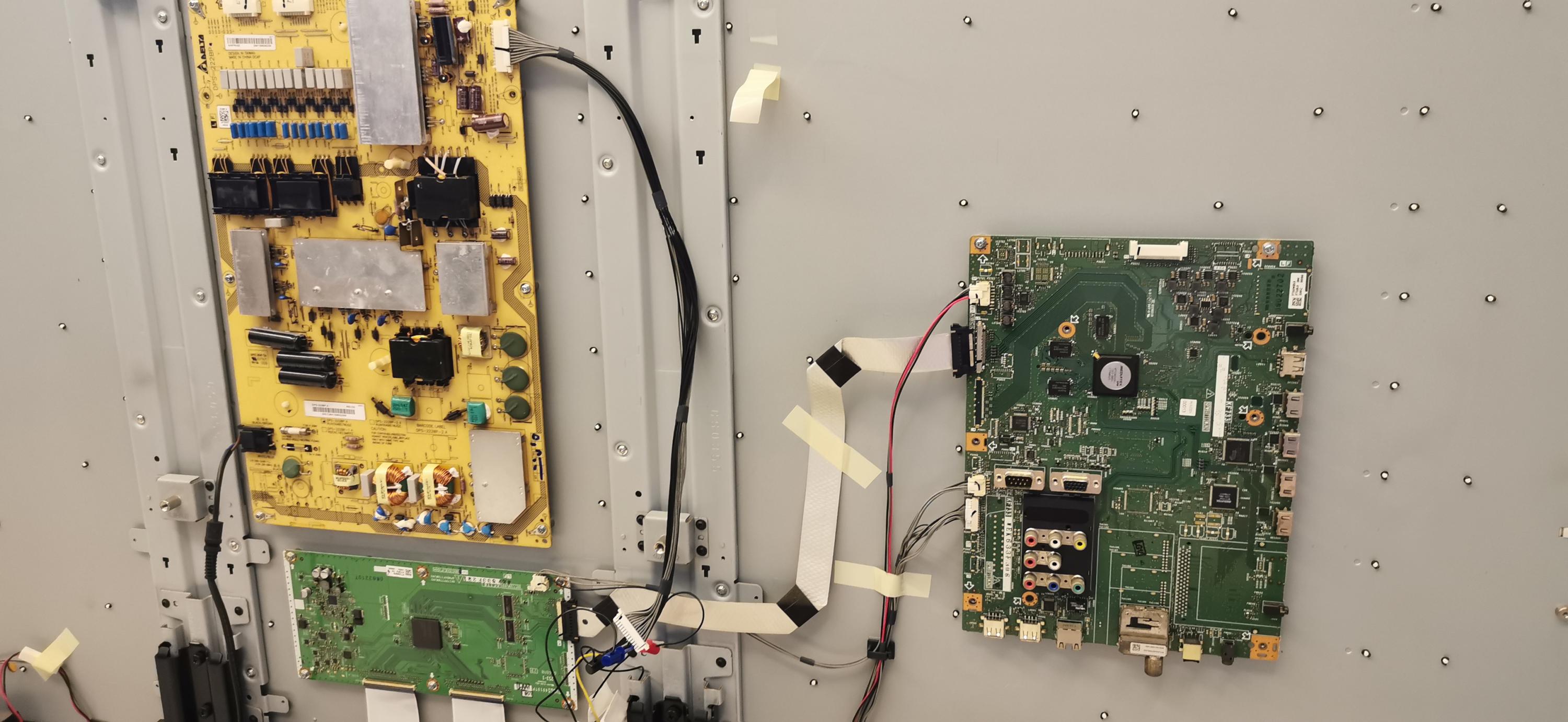

                                • beetle1303
                                  • Jul 2019
                                  • 279
                                  • Singapore

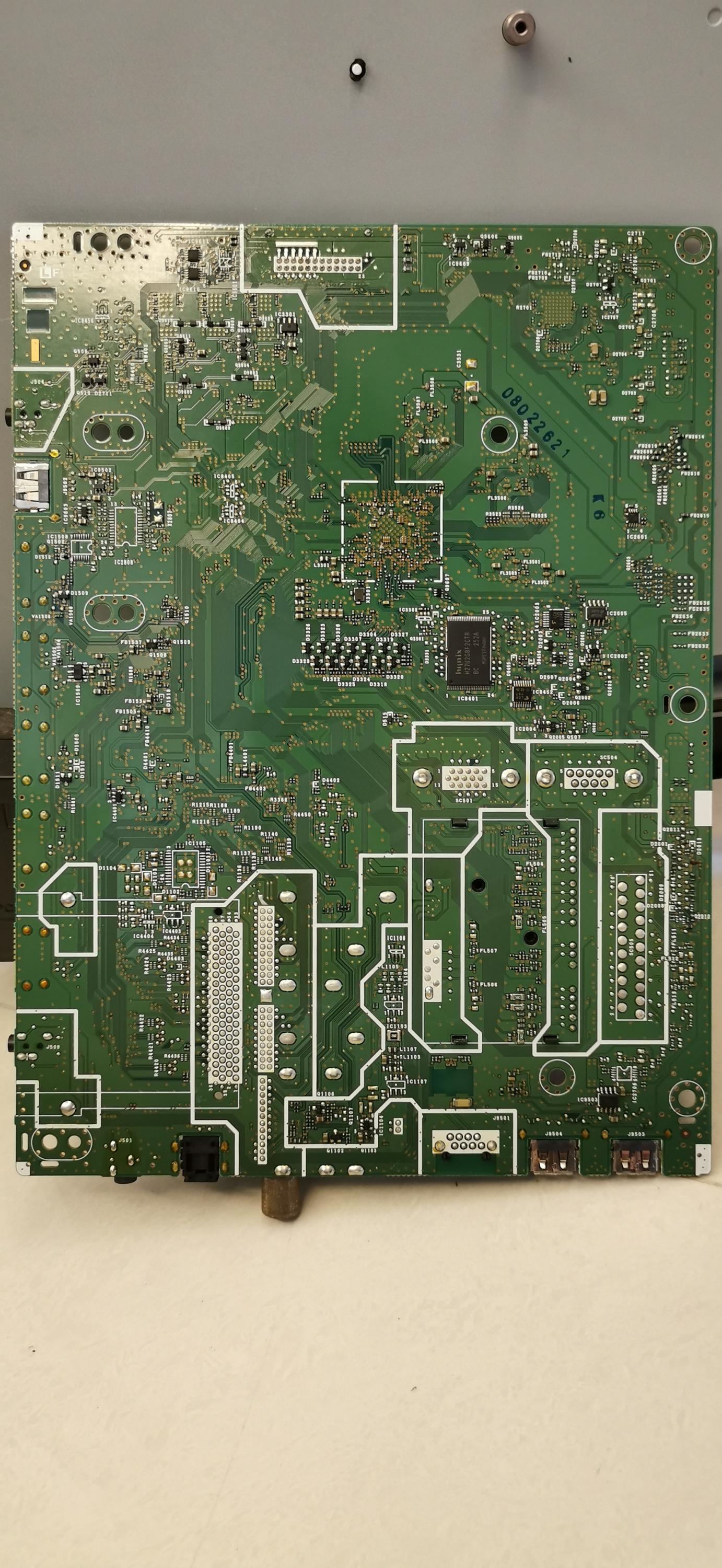

                                  This is the same PS board that we're working on to check if it is working, with all the jumped wires to measure the voltages of PD connector. When mounted back onto the TV, I kept the jumped wires to see if the TV backlight comes on when powered up.
                                  MB metal plate cover removed just to show how cables are connected.
                                  You want to see the PS to MB cable connected?
                                  • Diah
                                    • Feb 2013
                                    • 6499
                                    put every thimngs back as original. and remove load from the MB , mean speaker socket out wifi module if you have also out.. turn on and check if you have the 13V at start up.. if no you need MB in case your BL are 100% fine.
                                    • beetle1303
                                      • Jul 2019
                                      • 279
                                      • Singapore
                                      With only PD cable connected - now the power led indicator flashing 2x red, constantly.
                                      I connected the display & power cables to T-con board - same flashing 2x red light.
                                      I was curious about LED tester show mostly 175V per strip but I didn't see any led light at the back of TV. So I test again and watch the TV screen - no visible light also even though LED Tester show 175V. Possible to have all the led strips shorted?

                                        With only PD connector on MB, only PD-15 showing 4.96V (and not fluctuating), the rests are 0V... I connected Display and power to T-Con, same readings on PD connector, and everything connected back to MB, still same readings - only PD-15 has 4.96V.
                                        Seems like not connect to MB at all? Or MB is dead?
