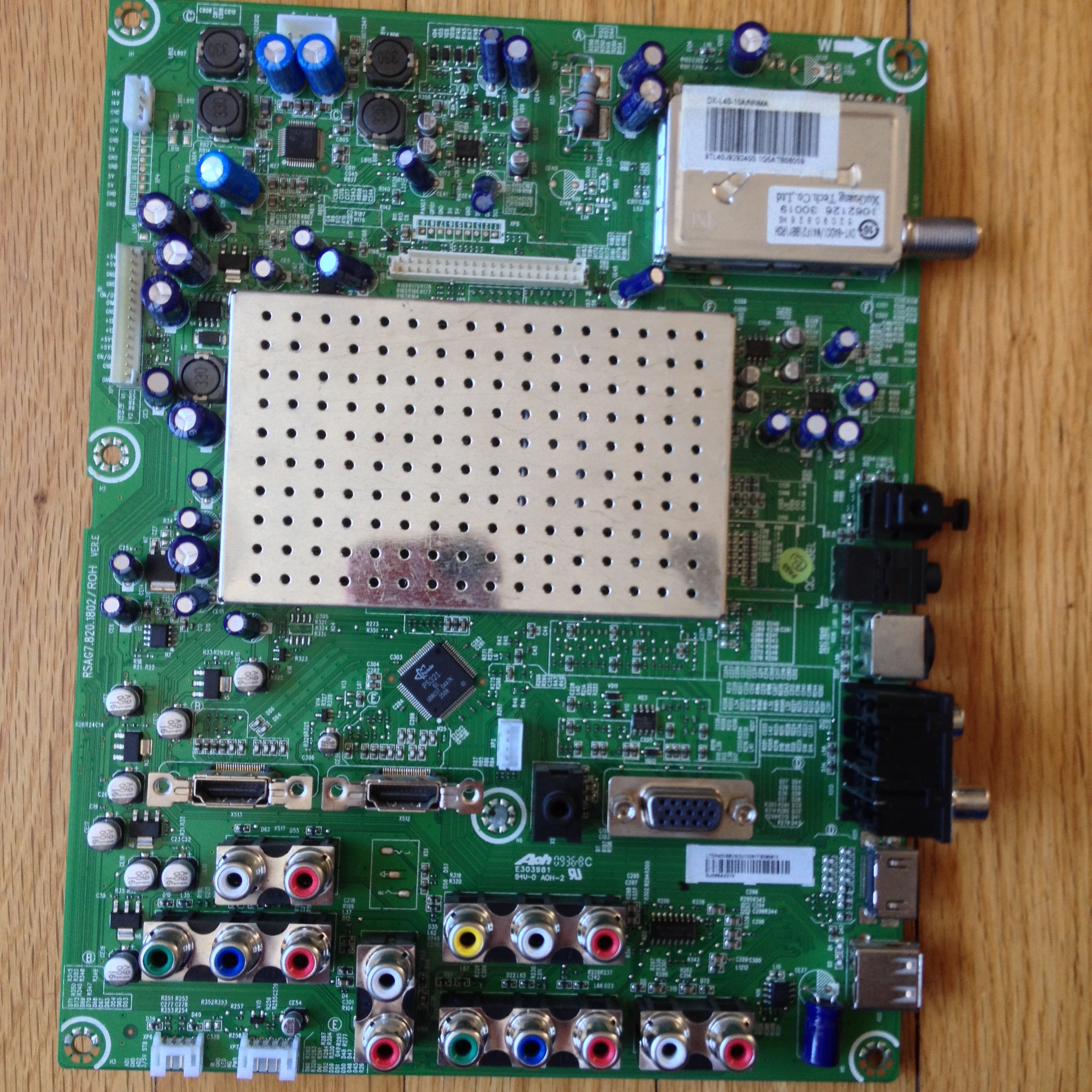

      I've been reading this thread to repair a Dynex DX-L40-10A tv. Had the same power supply problems described, ordered new caps from Mouser and replaced all the electrolytic caps and the film cap on the board. Put it back together and it powered right up. Unplugged it to move it to a cable outlet and back to the red LED and no picture. After opening up and testing the voltages on the main board I'm getting the following:
      Main - DC Volts
      +5V - 5.27
      +5V - 5.27
      GND - 0
      GND - 0
      BL ON/OFF - 0.05
      DIMM - 4.06
      GND - 0
      +12V - 11.81
      +12V - 11.81
      +5VSB - 4.96
      +5VSB - 4.96
      ON/OFF - 2.87
      GND - 0
      GND - 0
      I'm guessing its the main board not sending the signal to turn on the backlight. Anyone have any luck with repairing the main board?
      Thanks,
      mk
        #103
        Re: Voltage level on LCD power supply board.
        You are correct, I myself never have any luck fixing the Dynex/insignia main board. Typical part to check will be the voltage regulators, check the the caps, look for burnt or damaged parts.

            Measured the voltages on the regulators.
            N1
            pin 1 - 2.09
            pin 2 - 3.33
            pin 3 - 5.26
            N7
            pin 1 - 1.37
            pin 2 - 2.63 - stub
            pin 3 - 5.25
            N10
            pin 1 - 9.38
            pin 2 - 0 - stub
            pin 3 - 5.03
            N5
            pin 1 - 2.09
            pin 2 - 3.34
            pin 3 - 4.96
            N3
            pin 1 - 2.11
            pin 2 - 3.37
            pin 3 - 5.25
            N6
            pin 1 - 0.71
            pin 2 - 1.42 - should be 2.6
            pin 3 - 5.25
            N8
            pin 1 - 0
            pin 2 - 0.42 - should be 1.25
            pin 3 - 1.42
            I don't see N9 on the board, it must be under the metal cage.
            Looks like N6 and N8 are not reading the correct output voltage. Any suggestions on repairing? Should I try replacing the capacitors associated with these regulators as well as the regulators? Some I can replace, others are so small I don't think I would be successful.
            I'be been looking for a main board on eBay but not much luck. There's a repair service but they don't guarantee that they can fix it.
            Thanks in advance,
            mk
              #106
              I would replace the N6. N8 gets it input voltage from N6 output which is too low for the N8 to work, so you need to replace N6 first. I would order 5~6 of these regulators since one is already bad, other may fail sooner or later.
              • mpkozar
                • Dec 2013
                • 4
                #107
                Thanks BUDM. I'll give it a try and report back.
                • mpkozar

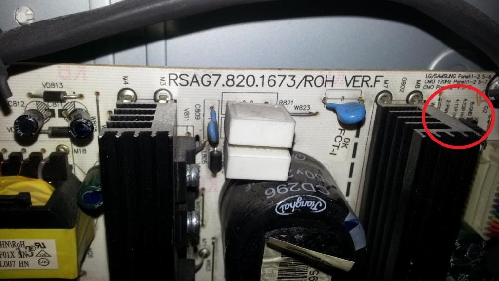

                  • Dec 2013
                  • 4
                  #108
                  Success! I replaced N6 and put the board back in and if fired right up! Now lets see how long it lasts.

                          Hi there. I finally got the power supply installed, the TV turns on and all inputs work well except for the TV tuner. There were no issues with the tuner before the new power supply.
                          I noticed that the jumpers in this pic were set differently than the new one. Is there any chance that this could be the issue with the tuner?
