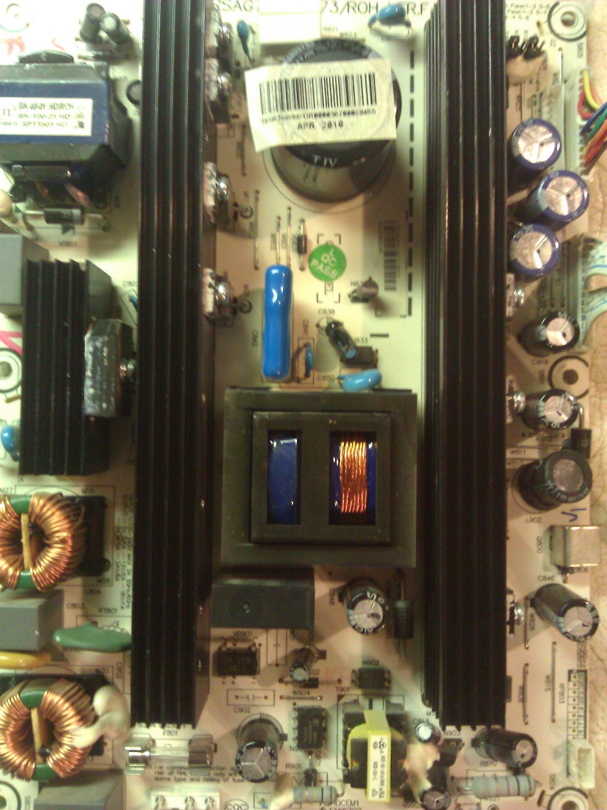

            Re: Voltage level on LCD power supply board.
            Here are a few pics

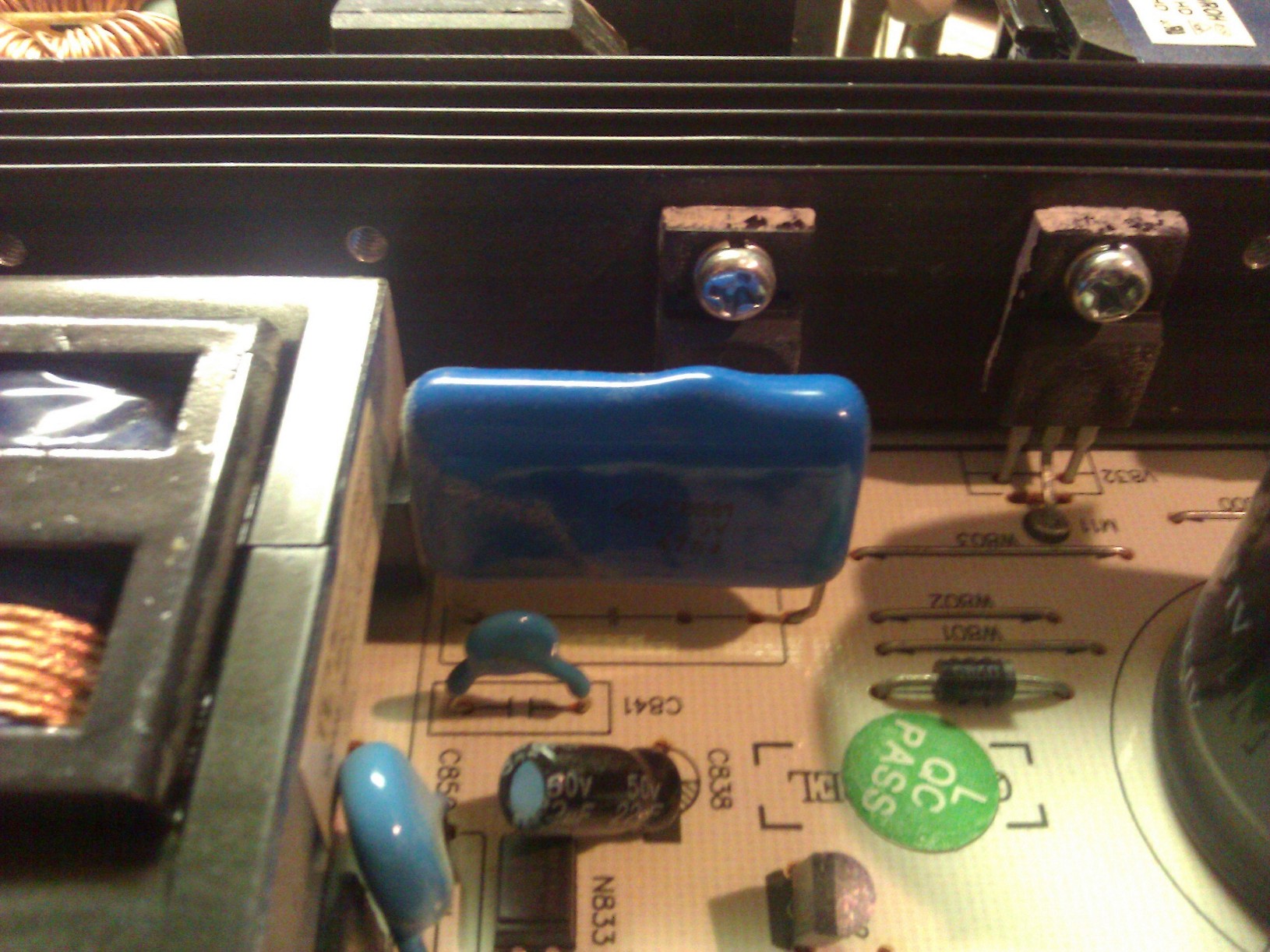

              Originally posted by lilmonk3
              Here are a few pics
              Does that blue dipped cap look odd to any of you??

                #67
                A little, but they usually rarely fail.
                It seems others have fixed this PSU by replacing it, so, go ahead and get a new one, its a 47n 1000v capacitor. If you want, you could use a 1500v cap for some extra headroom (perhaps that is why the 1000v ones got bulged?).

                  #68
                  Those caps can and do fail and bulging like that is a common sign something is wrong.

                    #69
                    Indeed, I have overvolted one myself, and it bulged. It popped too, looked like a big popped zit :P:
                    Is that infact 47n 1000v? I cant tell from the pic. But, thats the value others are saying the cap is.
                    Muh-soggy-knee

                        #71
                        Yes its 47/1000
