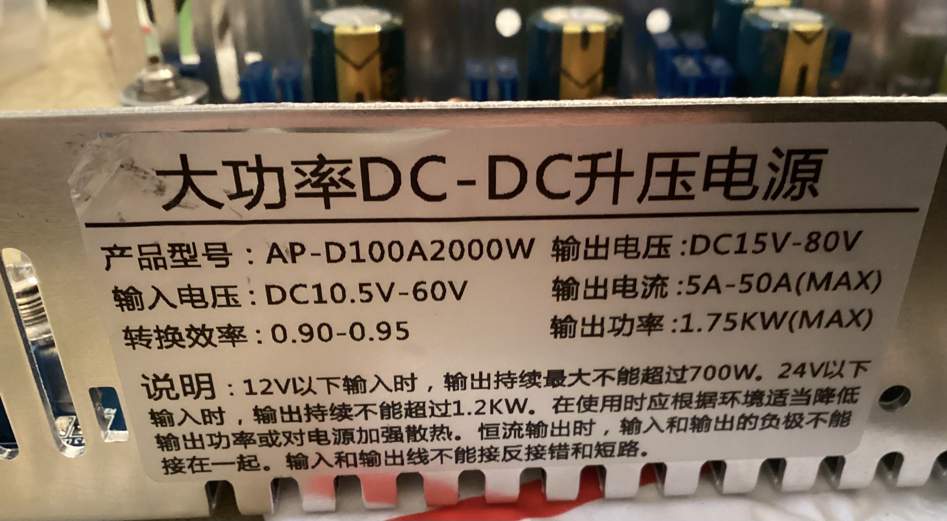

    I want to know if I could hook up a solar panels to this boost converter would I have any issues doing and I would have issues what would they be
    Adjustable Boost Power Supply DC-DC Constant Voltage Current Charging Module
    https://www.ebay.com/itm/116497313155?var=416785404161
    Here are some of the description from the eBay seller
    The main parameters:
    1. Product name: High-power non-isolated DC boost module power supply.
    2. Product model: 100A2000W.
    3. Input voltage: DC12V-60V.
    4. Input current: 100A (maximum).
    5. Input power: 2000W (maximum).
    6. No-load power consumption: less than 2W.
    7. Output voltage: DC15V-80V.
    8. Output current: 50A (maximum).
    9. Output power: 1850W (maximum).
    10. Conversion efficiency: 92-96% (efficiency is related to input and output voltage and current).
    11. Working temperature: -20~50℃.
    Very important question I have do I need a solar controller to be able to use this setup if so what type do I need to use
    I have some battery packs that I have tested so far and will work nicely with with what I have in mind doing I just need to find some higher voltage and about the same current output that I have now solar panels but do not want to pay an arm and leg for them

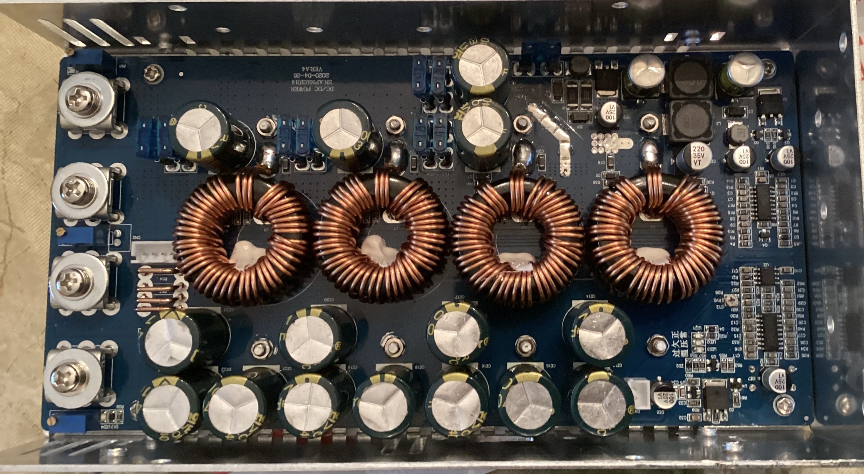

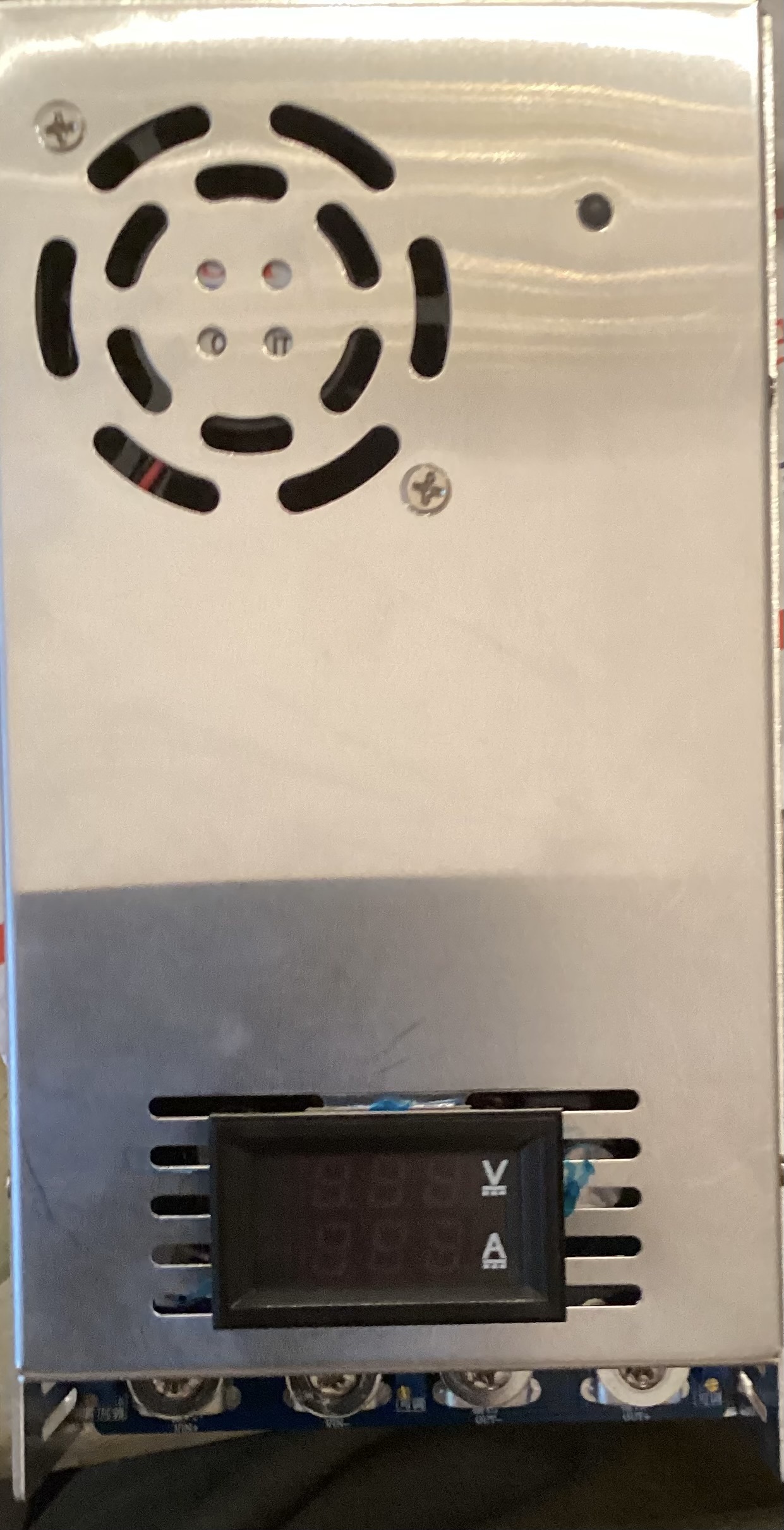

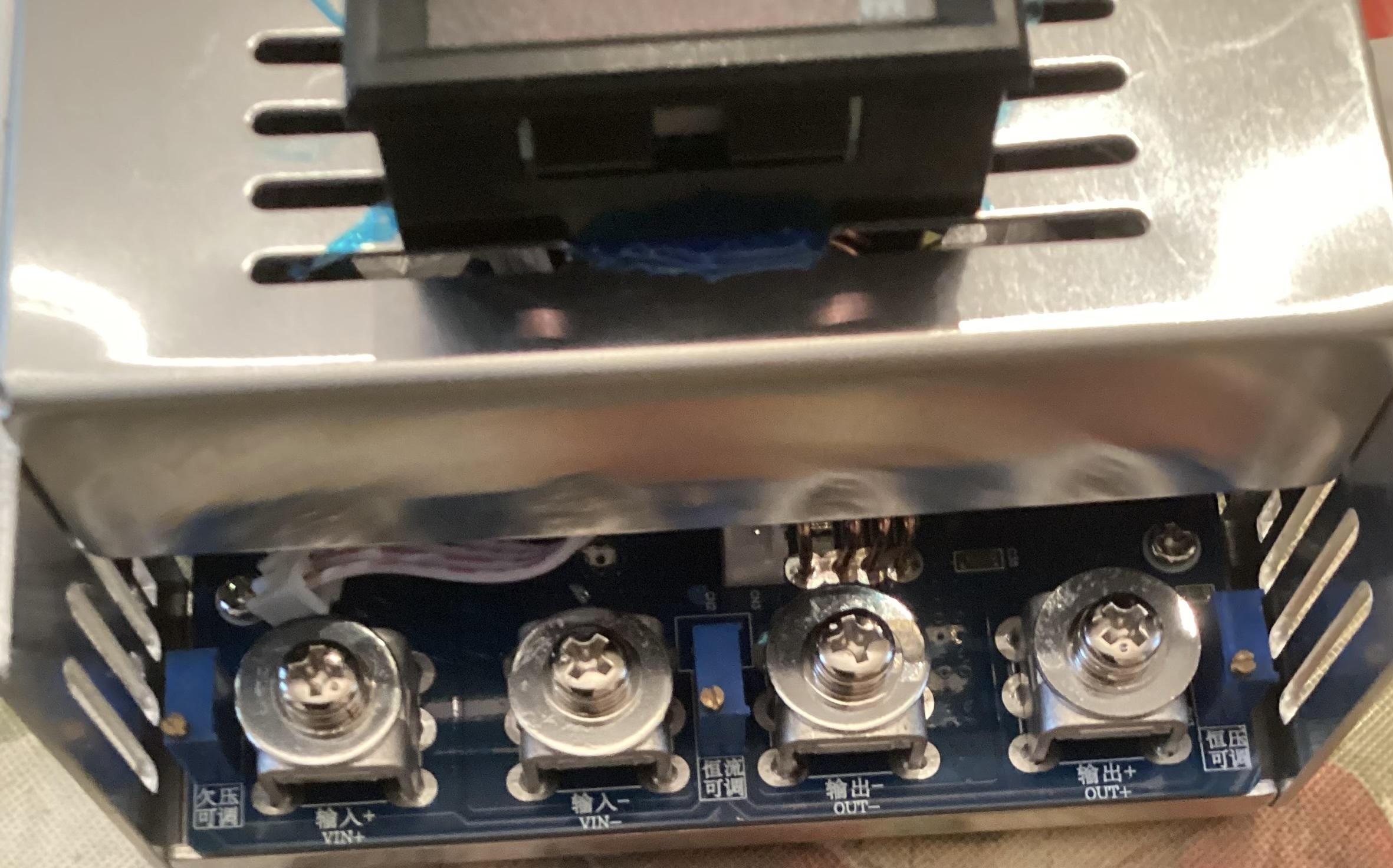

    Here are pictures of this boost converter
    One note this device has some weight to it
    What do you think of this boost converter it's design and the quality of it
    And like always they use Chinese made capacitors which will be replaced after some testing has been done

      hmm... interesting... it can actually pass 500W through each of those cores? Wow. Will have to see if I can get that much power going through a homemade boost from 24V to 36V though i wonder how many mosfets I'll need.
      I tried boosting 24V to 120V with a much larger core, maybe it was overkill though only passed 10A through or so, peak. The 120V was only around 2A...

                    I read that listing. These is no effing way this boost converter does 2000W continuously. Way too small for that.
                    Here is the problem I am having with it:
                    A: the rated wattage is not going to be anywhere near 2000w continuous.
                    B: Just think about it… as wider the input and output voltage and the current drawn and boosted from this unit as much harder it has to work.
                    C: what do you do when a cloud comes and blocks the sun? Probably it would be better to put a lead acid battery and a charge controller in between.
                    I think Sam wants to charge different type of battery pack sizes that go up to 48V with one solar “charging station” where he doesn’t want to rip the panels on a roof apart and rewire it for every different battery size charged.
                    Supposedly you can use it as a boost or as a buck converter, but note the lowest output voltage of 15V. Could it be used I suppose hooked up as a buck converter and the solar panels (3) in series, yes… but you also have to watch the grounding and adjusting the current sense correctly.
                    This being said, kind of waste of solar panels as your not getting to do anything with the extra generated power that way.

                              Well I did some testing on this boost converter with just one solar panel
                              one note it will not charge a 24 volt battery pack on just one solar panel you only get barely one amp ( which is not acceptable for what I want to do I want at least 3 amps or better )
                              In coming amperage is 5.1 @ 16.5 volts ( on the MPPT controller that I used I got 6.1 amps out put but went by the meter on the controller )
                              Out going into the battery pack 3.54 amp @ 20 volts ( 5.1-3.54=1.56) loss of current from going into the boost converter versus output of the boost converter equals 1.56 amps not sure exactly how to figure out its efficiency
                              I know that you loose some amperage when you boost voltage but the question is the result acceptable for efficiency results
                              Battery voltage extremely low on charge on a battery pack that the battery cells are way out of balance and the battery charger refuses to charge anymore
                              It will not charge a 12 volt battery pack even though it says that it can at least not when it almost charged I will have to run this later on a discharge battery pack which I do have at the moment
                              Unfortunately the sun wants to play hide and go seek so it hard to get accurate amperage reading even though I am using a dc clamp meter which is pretty decent
                              One note this boost converter does not behave the way other boost converter that I have tested before so I am not sure how efficient this boost converter is in the long run but I plan on testing it on a battery pack and see how it behaves in this setup as well

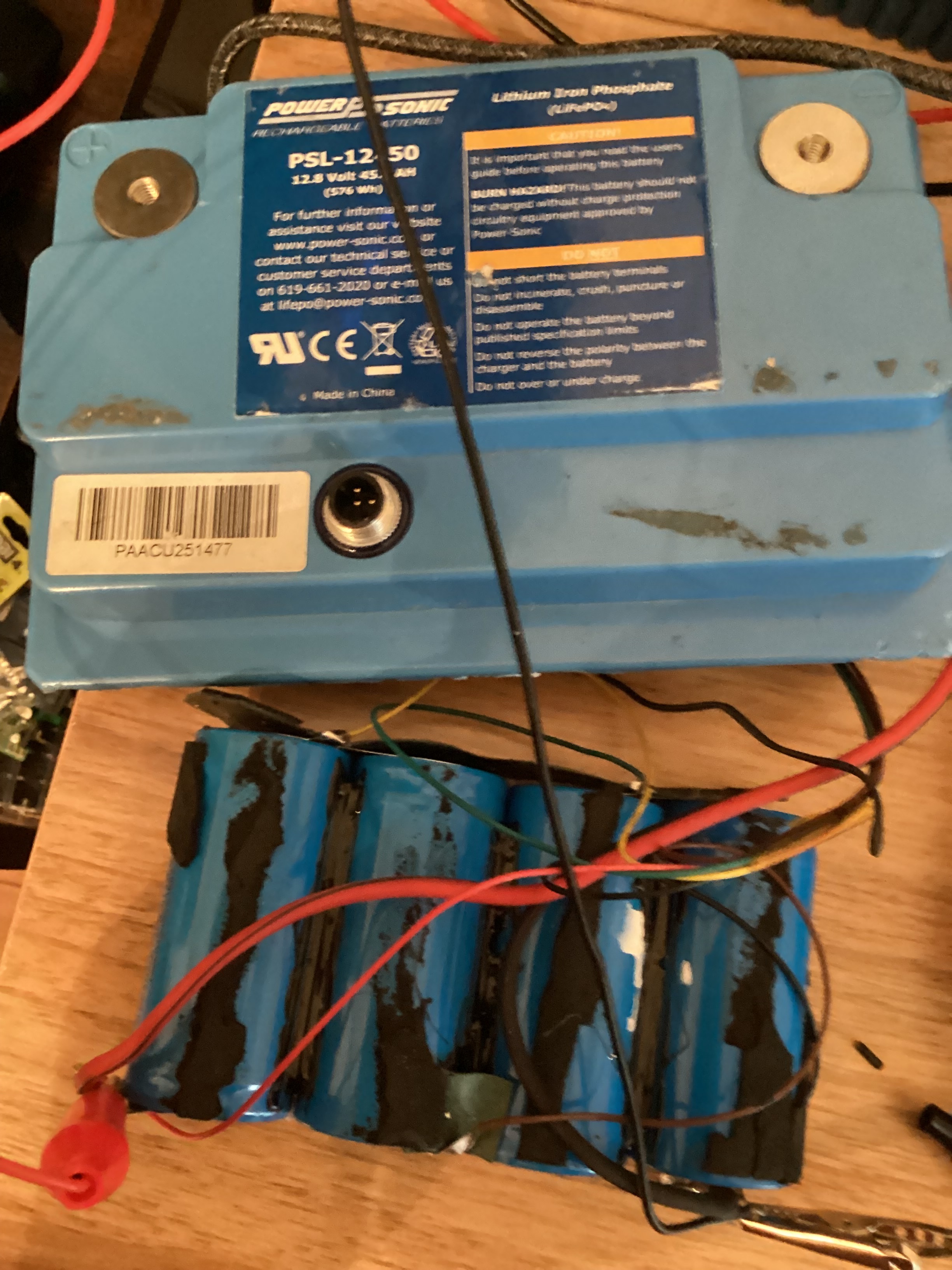

                                  I am testing a 12 volt Lipo 4 battery pack that has a enclosure with battery post that was for parts from BH a couple of years ago and I just got around testing the BMS board and it seems to function correctly turning off the charging voltage at 15.2 volts a little higher than I would like but it does not take long to get there
                                  The original battery pack cells were good except one rail which was totally dead no voltage at all
                                  Here is the battery pack that was referring to that I going to make a 30 amp hour battery pack out of it
                                  The battery discharge cutoff voltage 8.45 is a little bit lower than I would like but this not the troubling thing about it is that it turns back on again and you discharge more but it goes down extremely fast and shuts off again it just keeps repeating I guess one reason is that I was testing it at 10 amp load so of course your voltage is going to drop when you get to 90% of your amp hours
                                  it got to 5.85 amp hours and it is rated at 6 amp hours so I can not complain about the battery amp hours that I am getting
                                  The BMS protection board mosfets barely got warm to the touch at a 10 amp load very good results from this BMS board
                                  I just have to use a device that has a low voltage cutoff or put a board module that can do this function and be done with the issue with BMS and turning back on when it should not do this
                                  If the sun is out playing tomorrow I going to use this battery pack and see if I can recharge with this boost converter
                                  I can do a 20 volt battery pack with one solar panel lets see if I can do a 12 volt battery pack as well and do I get basically the same amperage as I did with the 20 volt battery pack or will it be higher or lower like I saw today with the battery pack almost fully charged
