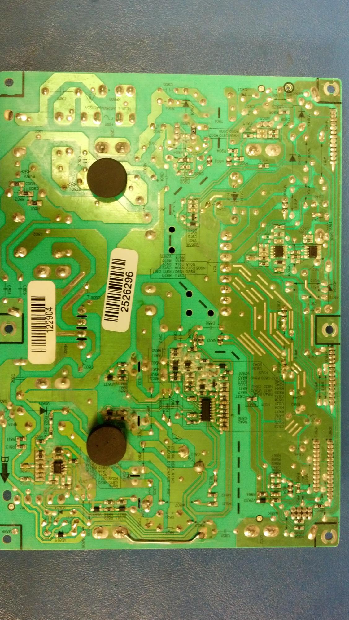

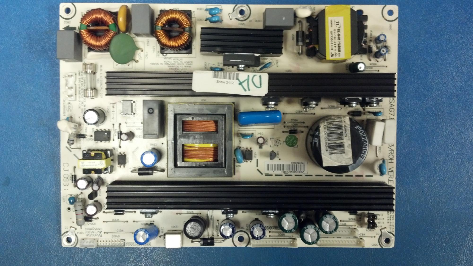

                    i hope these pictures may help a bit more like i said a previous owner may have taken it upon them selves to attempt fixing it not sure yet

                      On the picture of the back those two larger round objects look like fuses. Are they plastic and do they have a amp and volt printed on them? Also on the bottom of the picture what is that wire thing soldered to the board? What are the connections the wire is connected to are they solder joints for something on the front of the board?

                        The black things are spacers to keep the bottom from touching the tv metal shell i also repaired a trace with buss wire that is what i am guessing you are talking about yes they are for parts on the fron of the board

                          Ok, thought I could see numbers etc on round spacers. It would be a very funny place to put that type of fuse.

                                        Much better pics - thanks.
                                        On the top of the board two of the caps have small marks is that leakage? C918 and the green one nearest the end near where it says w817.
                                        Also on left side middle there is a 7/8 legged component perhaps N901 - is the white dot just a paint dot or is it damage.
