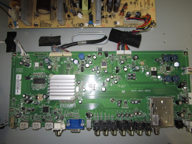

    I'm hoping someone here can help me with my problem, I have a vizio vw42l hdtv10a and I get no picture or sound out of the tv. I took off the back cover and seen the back lights are coming on but again no picture or sound. I can turn on and off the tv by using the panel buttons but thats it no menu channel up/down etc.. I have looked over several other threads involving similar problems and this is what I have replaced on the mainboard so far....
    Mouser #: 621-AP1117E18G-13
    Mfr. #: AP1117E18G-13
    Desc.: Low Dropout (LDO) Regulators LDO BI 1.0A
    used for u9
    Mouser #: 511-LD1117ASTR
    Mfr. #: LD1117ASTR
    Desc.: Low Dropout (LDO) Regulators LOW DROP
    FIXED REG
    used on u8, u2, u33, u7
    Mouser #: 667-EEU-FM1E221
    Mfr. #: EEU-FM1E221
    Desc.: Aluminum Electrolytic Capacitors - Leaded
    220UF 25V ELECT FM RADIAL
    used on ce75, ce8, ce7, ce14, ce16, ce91, ce2, ce1, ce5, ce6, ce23, ce11, ce27, ce18, ce25, ce26, ce20
    Mouser #: 667-EEU-FR1V471
    Mfr. #: EEU-FR1V471
    35VDC 470uF 10x16mm LS5mm
    used on the two inverter boards,
    I also followed the repair manual for this tv on the dc to dc converter trouble shooting guide (see attachment) after replacing all the parts listed above all voltage readings came out correctly as stated in the repair manual. and something else I noticed before doing repairs on the master inverter board there was a blue led on the pcb that would come on then go off, but after doing repairs it stays on so I guess I did something good just not good enough. thanks in advance for any help on this.

    I would look at the Tcon, I had the same model with a bad Tcon once.

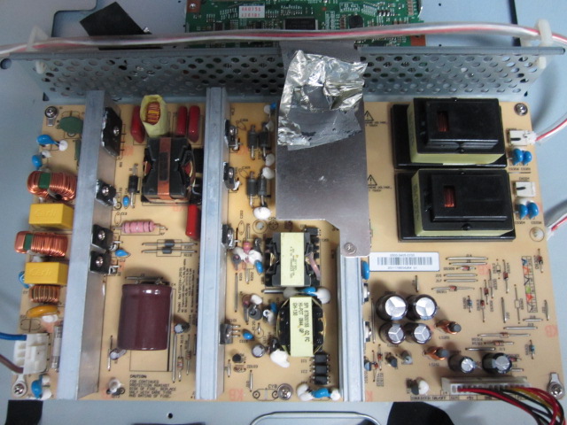

        Your main problem is consistant with that of an inverter board issue. There are multiple threads for this same TV set. If you search this forum for that tv model number you will find threads that tell you how to test these inverters and so on.

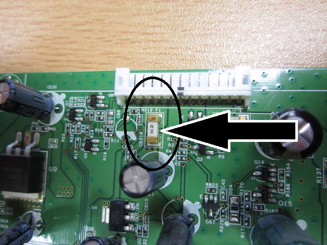

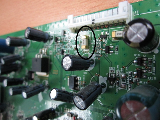

          check for power at the t-con (small tiny fuse upon cable input 12vdc or so)
          I would then go after the video board.

                rmoody, I just purchased a tcon it shows it arriving 9-15-11 I will post the results when it is installed.

                    your the man rmoody got the board in last night hooked it up and fired up like a champ. thanks for your suggestion.

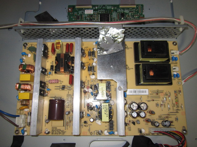

                                  • Aug 2013
                                  • 18
                                  Re: vizio vw42l hdtv10a no picture/sound
                                  I have a very similar issue with a VIZIO VW42L HDTV10A. I am fixing it for a older couple in our community and trying to save them from having to buy a new one. when I first got the TV it was not getting any power, the Visio light on the front would not com on either Orange or white. from another thread I found that the f1 fuse on the main board was bad. it had no power across the fuse and when I pressed the power button the F2 fuse did not get any power. I ordered and replaced the f1 fuse (3A) and now both of them get power when I press the power button and the f2 looses power when I turn the power off.

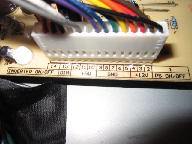

                                  However, the back lights do not come on still. so from another thread I was led to test the power on the J1 connector to the Main power/inverter combo board. here are the voltage readings I get:
                                  unit in standby
                                  Pin#
                                  14 0.0
                                  13 0.0
                                  12 4.7
                                  11 4.7
                                  10 4.7
                                  9 Blank
                                  8 0.0
                                  7 0.0
                                  6 0.0
                                  5 0.0
                                  4 0.0
                                  3 0.0
                                  2 0.0
                                  1 0.0
                                  unit turned on "white logo"
                                  14 1.5
                                  13 0.0
                                  12 4.7
                                  11 4.7
                                  10 4.7
                                  9 Blank
                                  8 0.0
                                  7 0.0
                                  6 0.0
                                  5 0.0
                                  4 12.0
                                  3 12.0
                                  2 12.0
                                  1 2.1
                                  When I turn the unit on, the blue lite on the tcon board comes on bright and then fades out. Is that normal.
                                  I have also checked the voltage at the connectors for the inverters by checking red to ground and white to ground and with the unit on none of them have any volts.
                                  I am at a loss now where to go form here. can someone please tell me what is going on. I have good pictures and can post them.
                                    We need to know what the pins are labeled as so we can tell if it is getting the correct signals. Does it have any kind of labels, I.E. ps_on, stby, etc.? Pictures of your board?

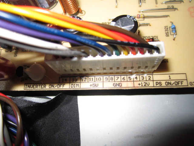

                                    • blmcamp
                                      • Aug 2013
                                      • 18
                                      Here are some photos of the connector. I have to sigh off for today but will check back tomorrow, thank you
                                      • blmcamp
                                        • Aug 2013
                                        • 18
                                        OK. I am back now. I had to go home and put our some fires
                                        I hope the pictures I attached help.
