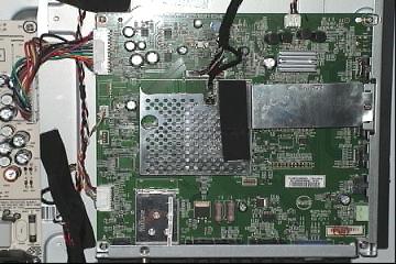

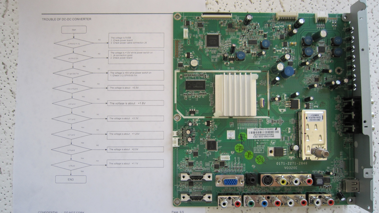

          see if this helps

            Hi Village Electronics, old pro, thanks for the picture, but my main board looks different than yours. Your help is much appreciated. It is very hard to find a service manual for this set. I will be posting some pictures of my boards.

                  The pictures are useless.
                  Take a look at the picture Village Electronics attached (ignore the troubleshooting guide, that's a bonus). Note that it is possible to see the entire board. That is important. It is big - 1600 x 900 pixels. That is very important because it allows me to identify 5 probable 1117 type voltage regulators, another that is possibly a 1084? type, and one more candidate that is possibly a 7800 type. I can also see two fuses and two probable buck regulators.

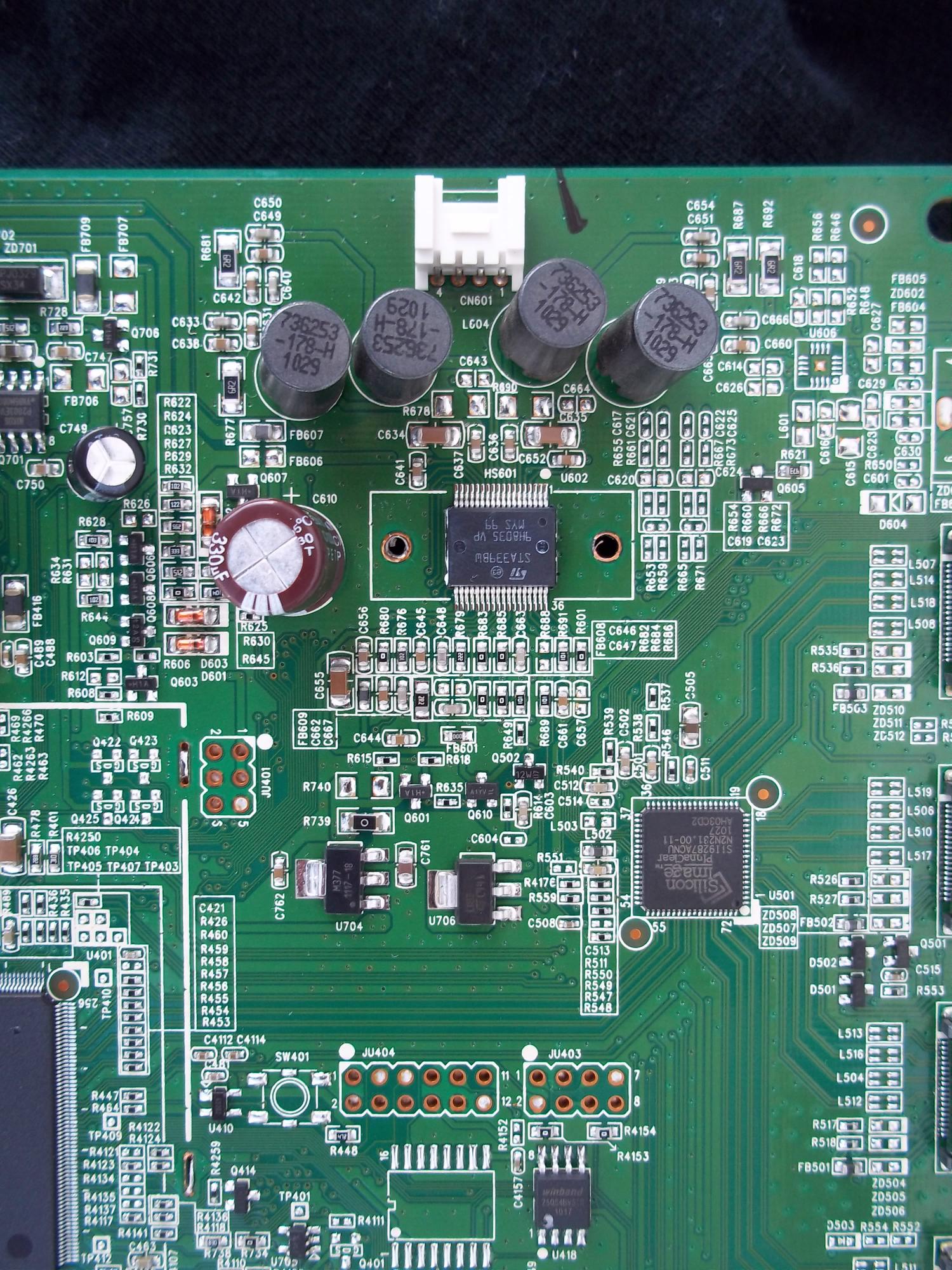

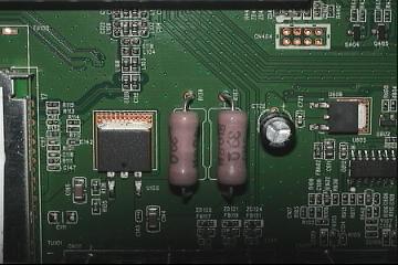

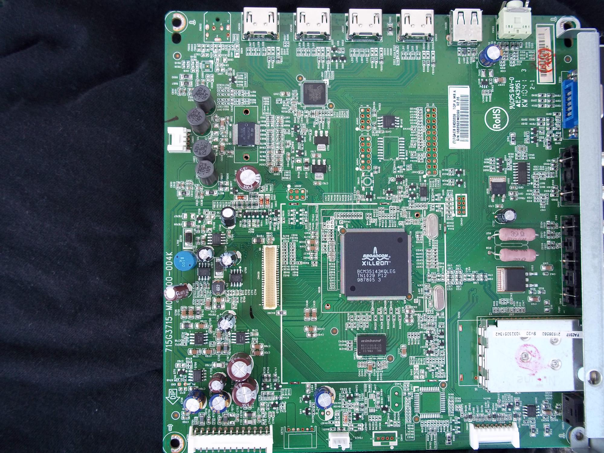

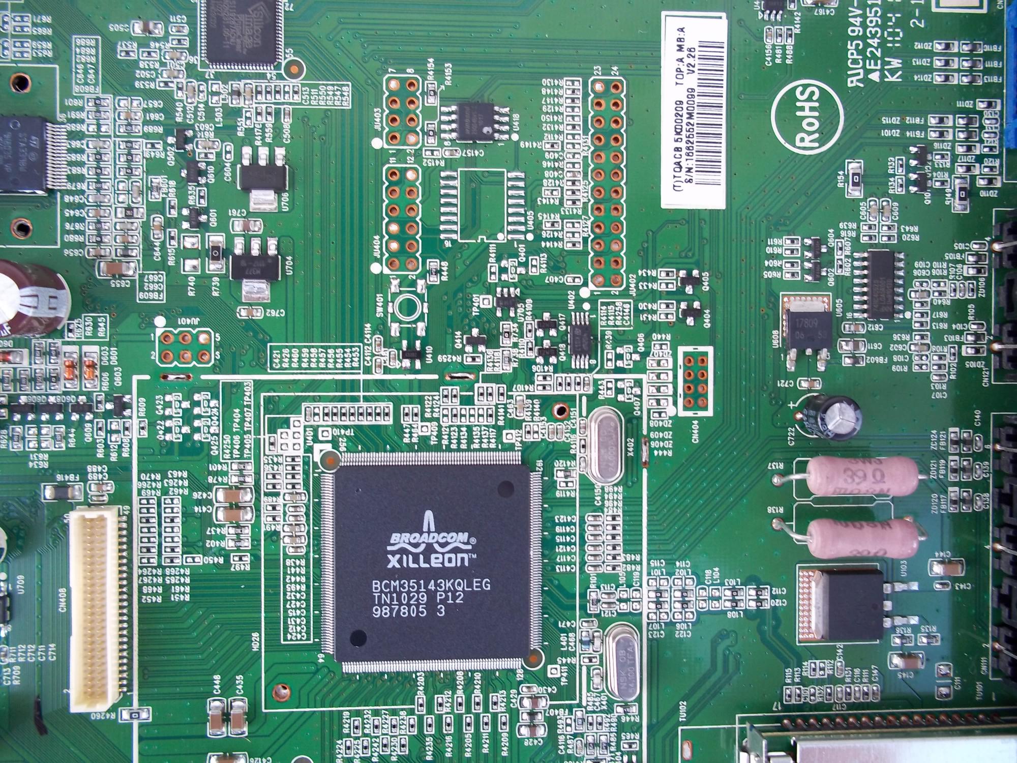

                    Thanks Plain Bill for the help. I am enclosing these pictures that I took with a 12MP camera. I hope they will be helping other people. The main board surely has a lot of surface mount fuses. I checked them all. All ok.

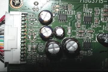

                      Re: Vizio E-320VL Turns on stuck with Vizio logo picture
                      More pictures of the main board
                      • elegey
                        • Jul 2011
                        • 12

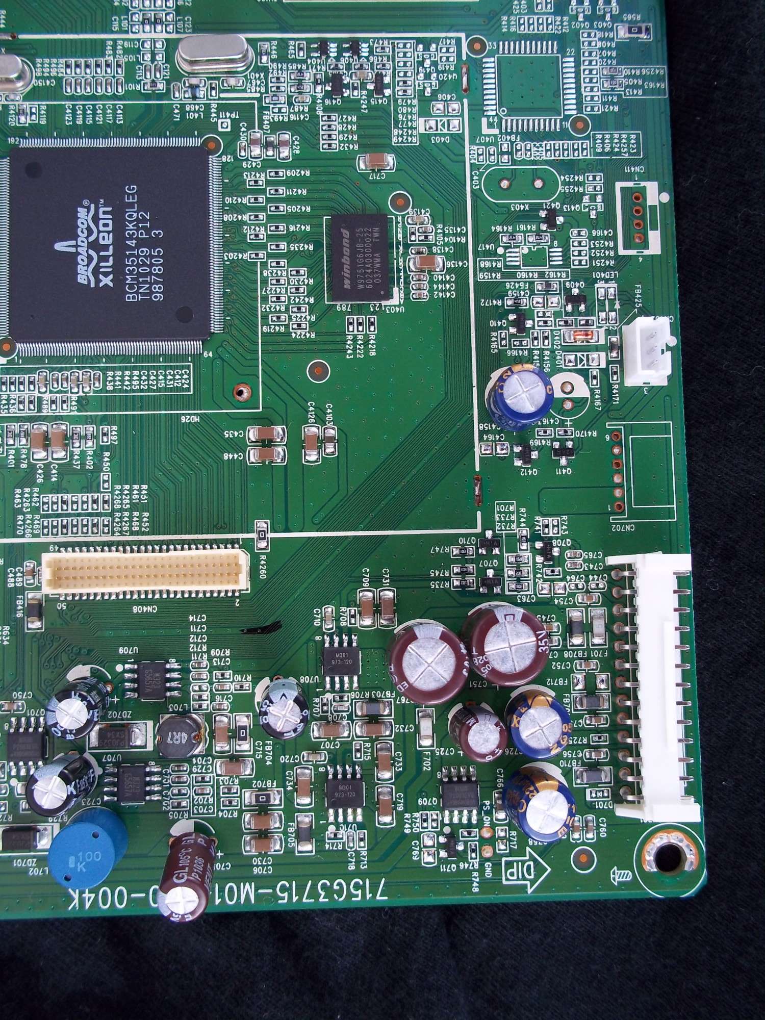

                        Ok Plain Bill, last picture. Thanks.

                          Wow!!! Excellent pictures. On the close-ups I could even read IC part numbers. I feel satisfied if I can read the silk screened identifiers. Interestingly enough, the pictures aren't all that much larger than some of the blurry ones I have to deal with.
                          I've identified a number of components to be checked. There are two fuses in the lower left corner; I'm pretty sure both are good, but it wouldn't hurt to check.
                          Just above the fuses I've identified two, possibly three bucking regulators. The caps in that area are critical. I would expect voltages like 3.3 volts and 2.5 volts out of these. That is best checked across the caps.
                          Further up the board is the Class D audio amp (which I haven't labeled). Just to the right of that are what I suspect are two LDO regulators. These can be checked by measuring the voltages on all three pins (the tab is electrically connected to the center pin, and is the output). Use a mounting screw for ground.
                          Of course, the Broadcom chip is the main processor and handles most of the video functions, I believe. To the right of that are two more LDO regulators. Again, use a mounting screw for ground and check the voltages on all pins.
                          Lastly, there are three chips that I suspect might be regulators. Two are above the Broadcom chip, one is in the upper right corner. I've identified them with ??. If lettering can be distinguished, what are the part numbers?
                          PlainBill
                            Thanks Bill for your research. Here are locations and part numbers on components:
                            U708: M301-973-120
                            U710: M301-973-120
                            Q709: NiKos P2003EVG VNB5M0B06
                            U709: M323G5657A
                            U707: M323G5657A
                            U704: M327-1117-18
                            U706: LD33C941
                            U608: 17809
                            U103: M281G9084
                            U410: 69282
                            U705: 9141K
                            U408: 50K13
                            I hope this will help us all. I will check voltages, but I need to replace the heat sinks before I do so. And apply new heat sink compound onto the top of components needing it. I will be happy to take more pictures of the main board.
                              U708: M301-973-120
                              U710: M301-973-120
                              U709: M323G5657A
                              U707: M323G5657A
                              U704: M327-1117-18
                              U706: LD33C941
                              U608: 17809
                              U103: M281G9084
                              U410: 69282
                              U705: 9141K
                              U408: 50K13
                              U708: M301-973-120 ???
                              U710: M301-973-120 ???
                              Q709: NiKos P2003EVG VNB5M0B06 Power FET
                              U709: G5657A - 3A step down regulator
                              U707: G5657A - 3A step down regulator
                              U704: M327-1117-18 1.8V LDO regulator
                              U706: LD33C941 ???
                              U608: 17809 9V regulator
                              U103: M281G9084 5A LDO regulator
                              U410: 69282 ???
                              U705: 9141K ???
                              U408: 50K13 ???
                              PlainBill
