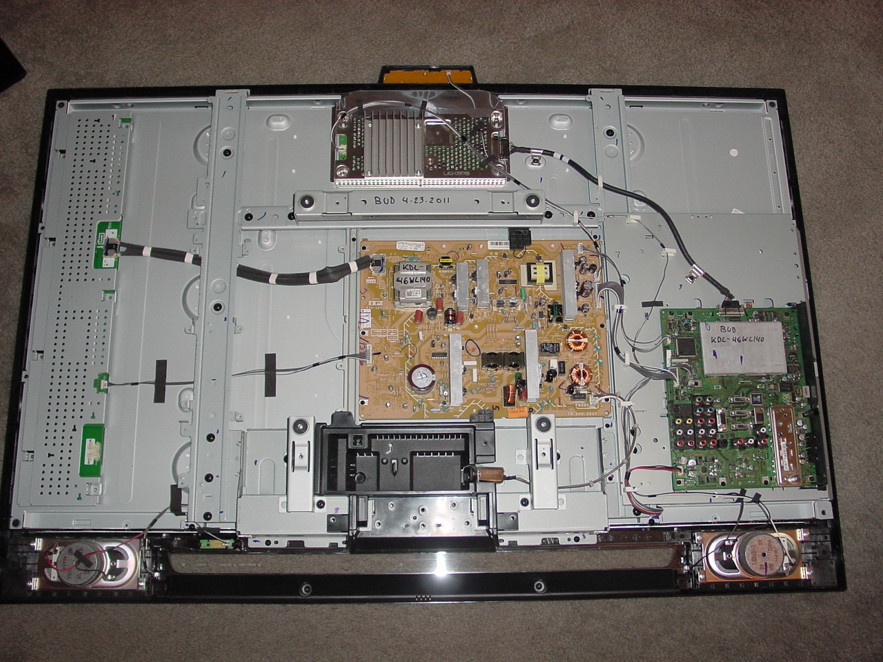

      i just gutted a 2009 built 46" sony kdl that still powered on but has a smashed lcd...
      i will see if its the same model#.. if so, ill make you a deal on all the damn boards if you want.

        krap.. its a kdl-46s4100.. prolly not the same... oh well worth a shot i suppose.

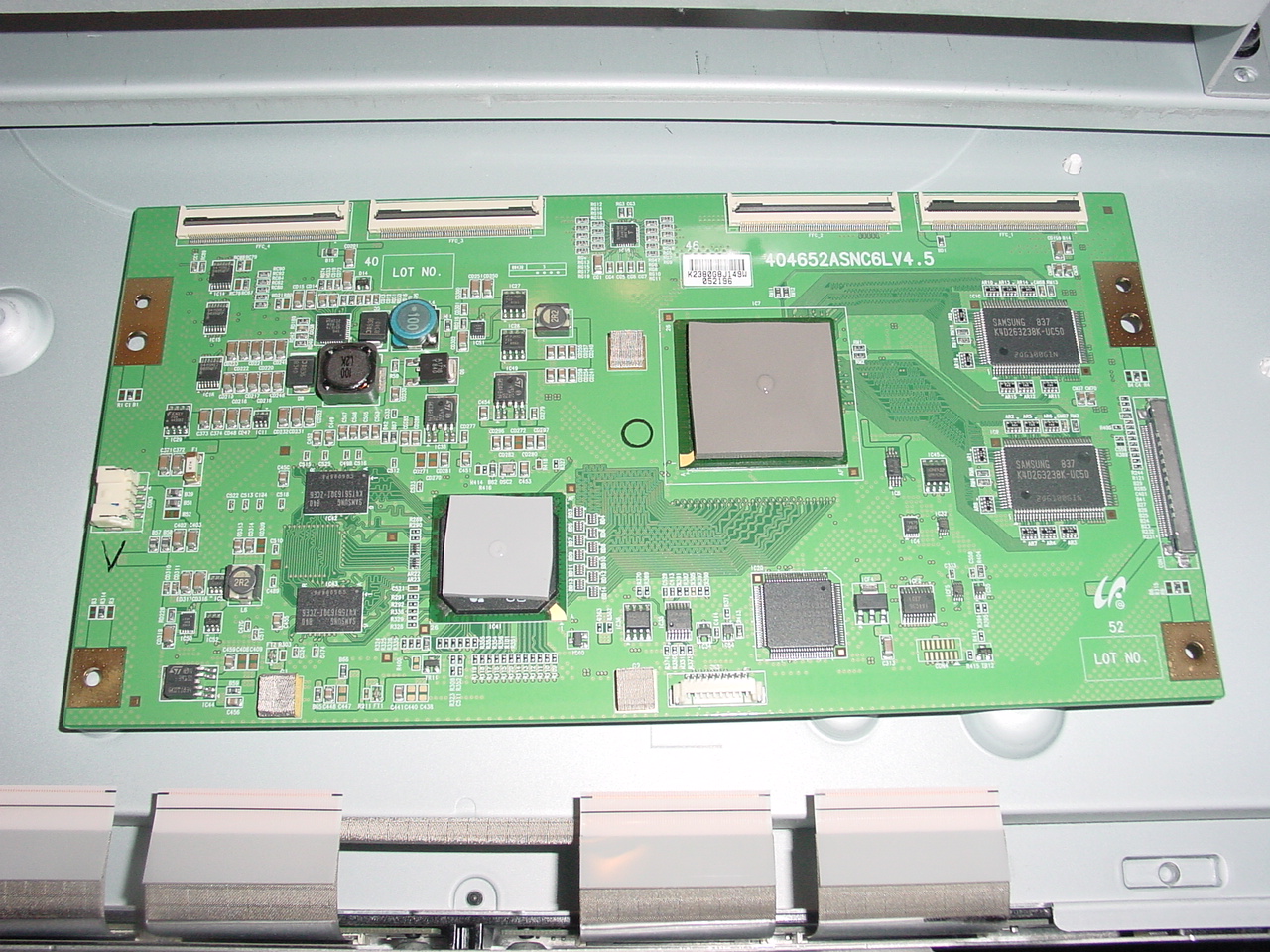

                        @cadillacman, does your SONY T-CON look like this with the same number? I am working on
                        KDL-46WL140 which has bad T-CON board and it supposed to use the same T-CON as your model. I will be interested. Thanks

                          MAbye.. Its going to be awhile. My tv tinkering and arcade games are on hiatus as my game/eletronics rooms are packed with books and crafting stuff. Im finishing part of my basement for the mrs so she can have a nic dedicated library and crafting area, so that means my stuff just became storage.
